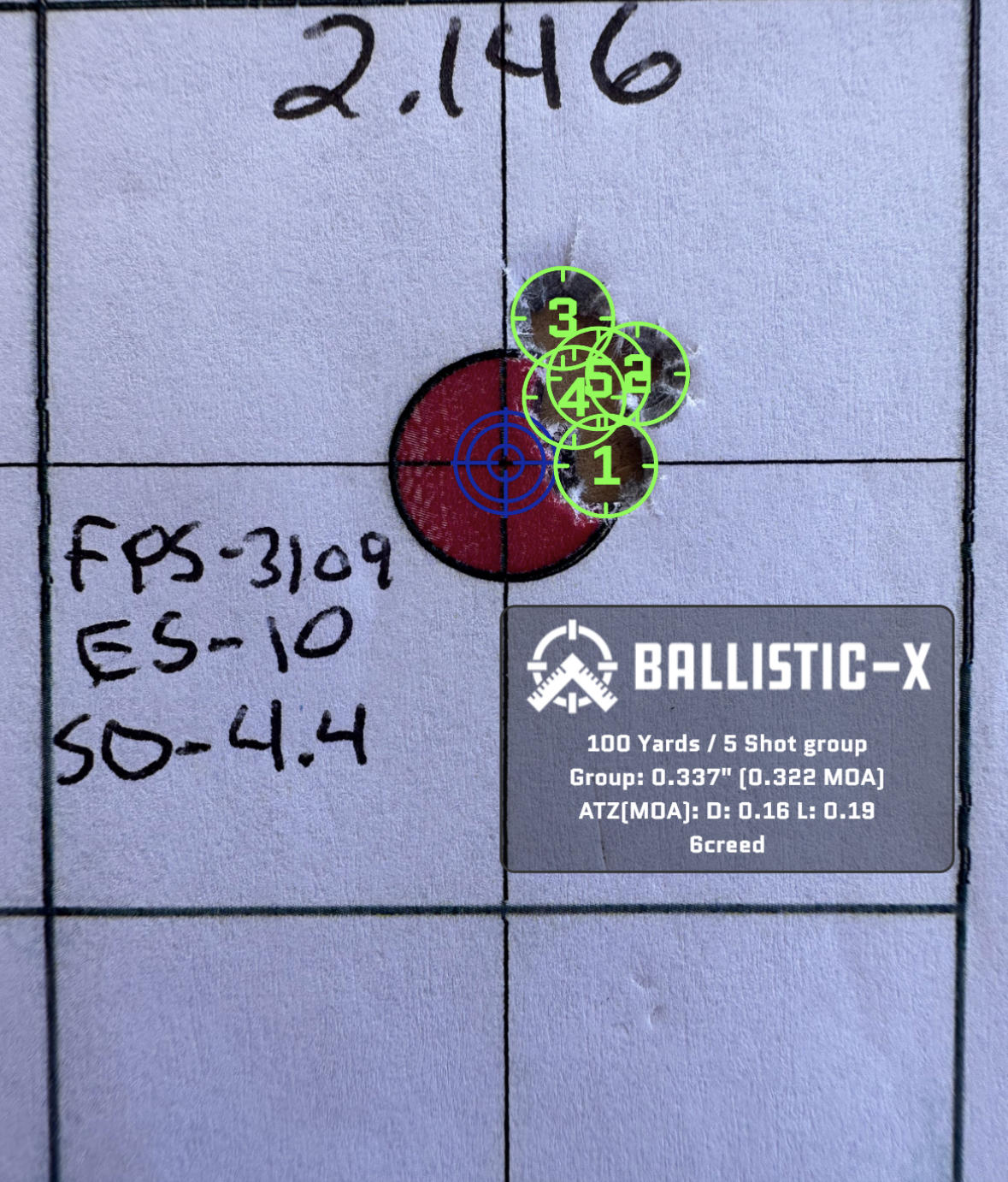

Anybody else liking R17 ? Im getting really good speed and accuracy with 42gr 105 Berger vld, average 3210 no pressure signs 8 twist 24” Carbon proof. Barrel only has about 60 rounds down the tube.
Running a 105 at 3210fps and the barrel hasn’t even finished speeding up after only 60rds… I hope you’ve already ordered your next barrel, because you’ll be lucky if you get 1000rds out of that one lol. 😝

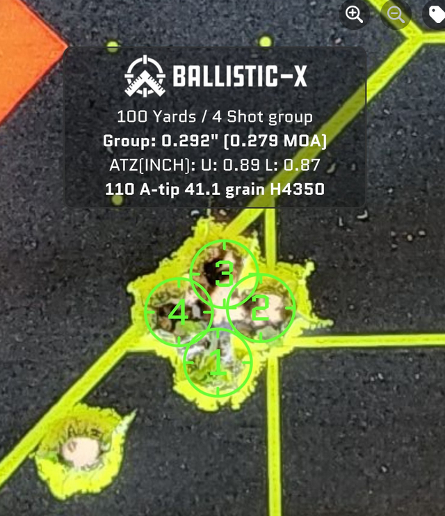

I just confirmed a new load using 41gr N555 with 110 A-Tips out of a 26” barrel. It was slightly disappointing that this was on the low end of the powder range I’ve been testing for this combo, but I’d rather lose 120fps for this kind of consistency.

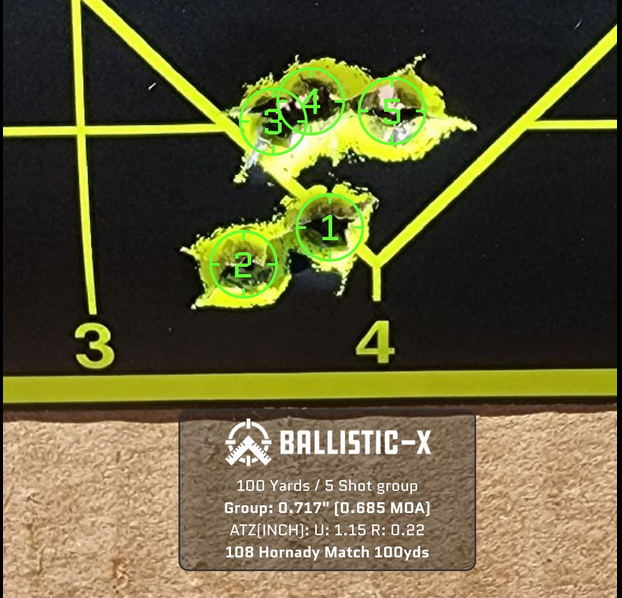

Bottom flyer opened the group to .790 I think. The A-Tip load was direct from the Guns & Ammo article about the rifle when it first came out. 41.1gr of H4350 loaded to SAAMI.
This is out of a new Custom Shop RPR. Temp was 96F, wind was negligible, elevation about 3K feet.
Surprised by the factory ammo but nice to know factory ammo actually does shoot well. First experience with that happening.

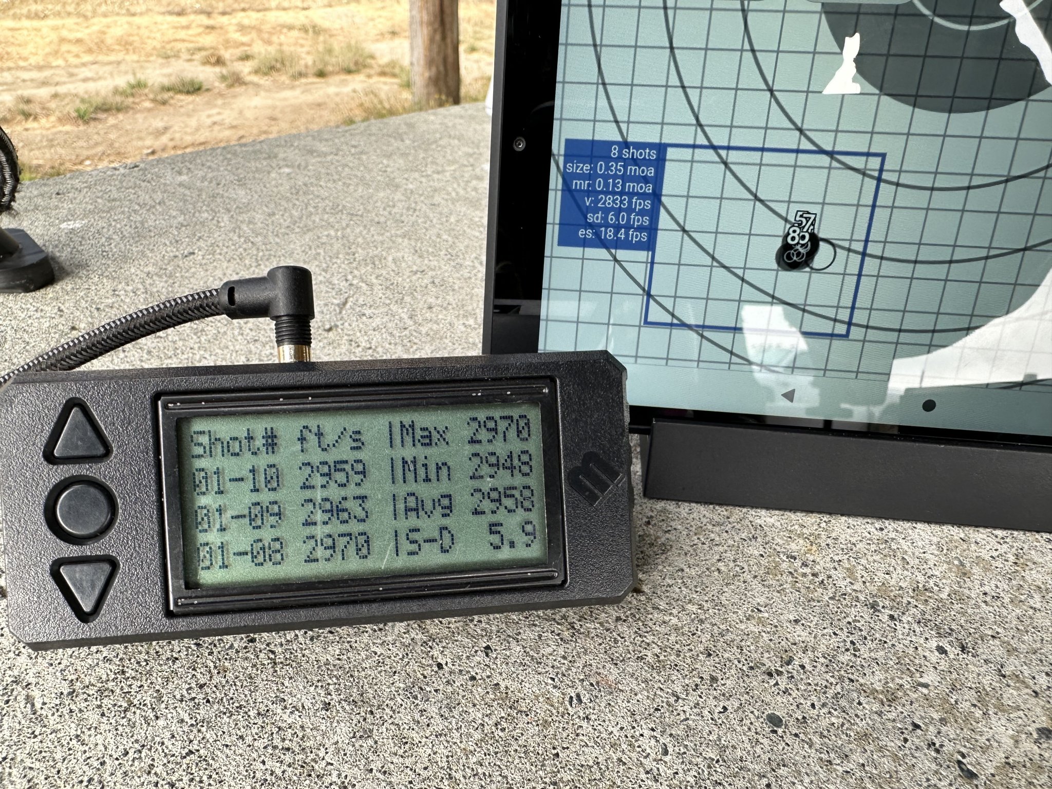

Yes sir. I shot mine again today testing some BSD and have about 450rds down the tube now. It’s speeding up a little. Today I averaged 3123 over 35rds shot. It’s still hammering though. Shot this .953 at 300yds.
