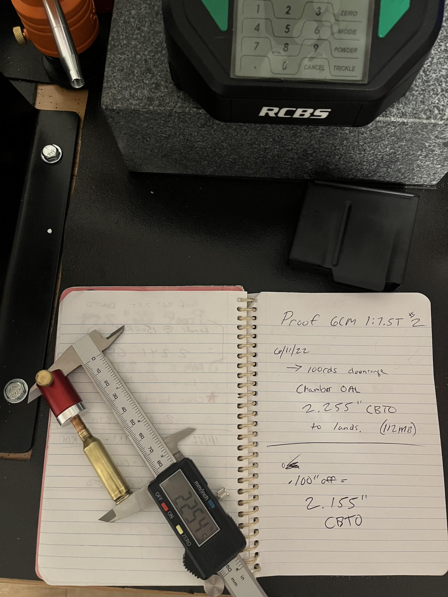

The barrel when new after 150 rounds on it: lands @ 2.2550". After 1500 rounds on it: lands @ 2.2545" (actually could be zero, really tough to call if I wasn't closing the calipers too hard once within a thou).

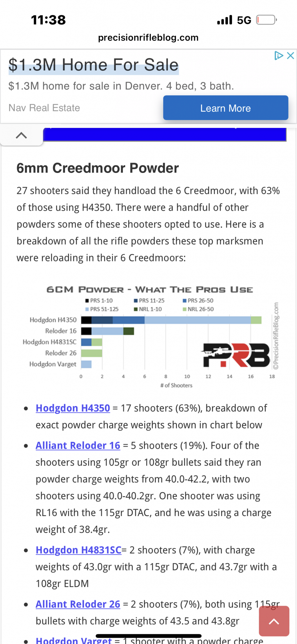

This is what I did when I got involved in 6 creed. And that load shot lights out in 3 different 6 creeds. A GAP 10/ Bartlein A origin /proof steel. And GAP tempest Bartlein

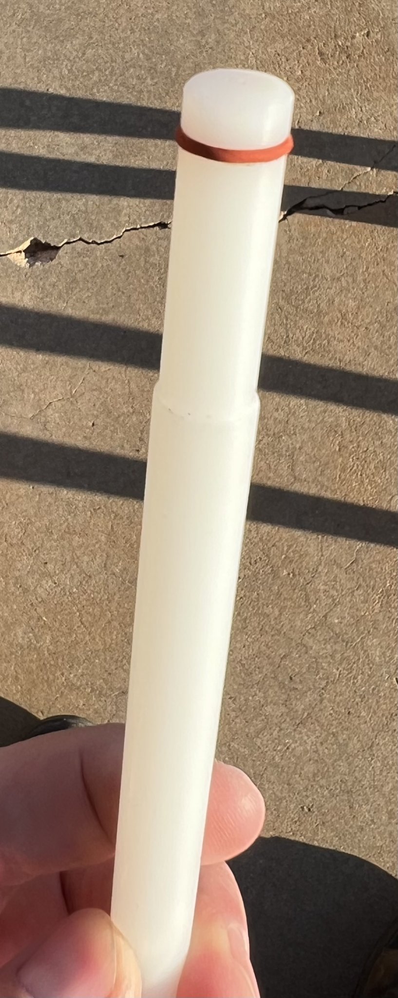

I use one of these 10" chamber rods and a decent-quality AR chamber brush, everyone should have one:
Amazon product ASIN B00LCT9WCK

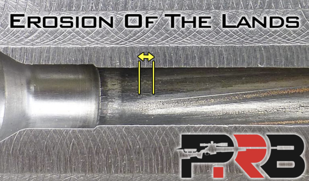

It's two different forms of the same thing. One is on the bore and lands, the other is on the beginning of the lands. That's why you can't have one without the other.
I don't see them as two forms of the same thing, I see it more like: erosion changes the relationship of when the rifling engages the projectile and also how much initial "bite" it has, while fire-cracking is more like how we describe the surface of the barrel becoming degraded to the point of inducing resistance/friction on the projectile to where they can't get a good "launch" straight down the rifling. We can measure erosion, for fire-cracking we have to use a borescope.
That said, and besides, IDK of anyone who's ever shot as many rounds as I have at .100" off and who's also monitored/measured/documented the amount of erosion that occurred to compare notes with... maybe this is just how it goes?

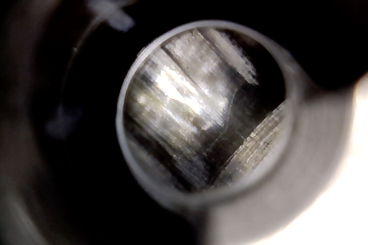

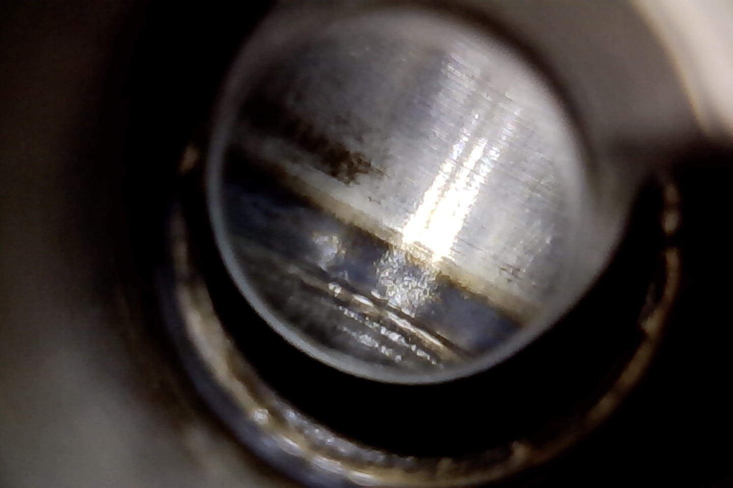

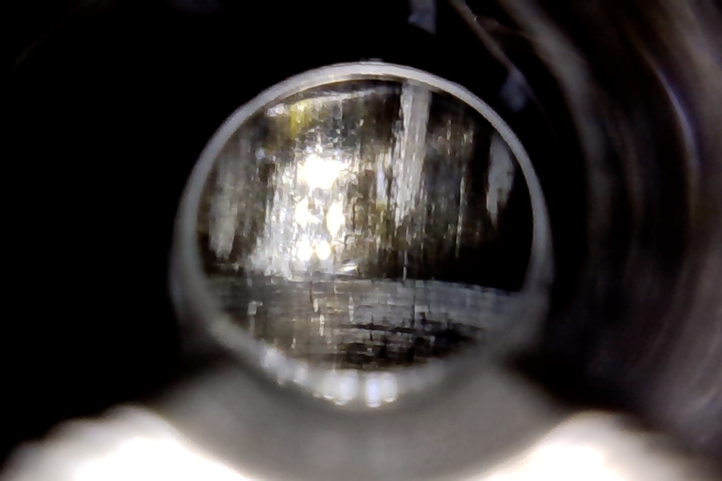

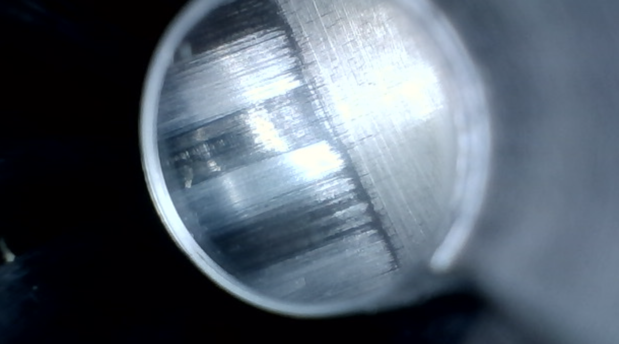

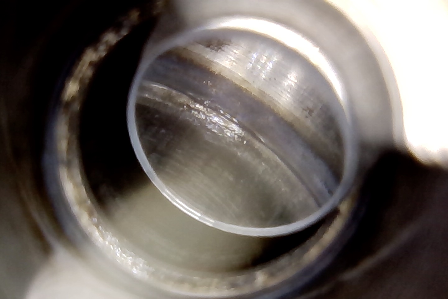

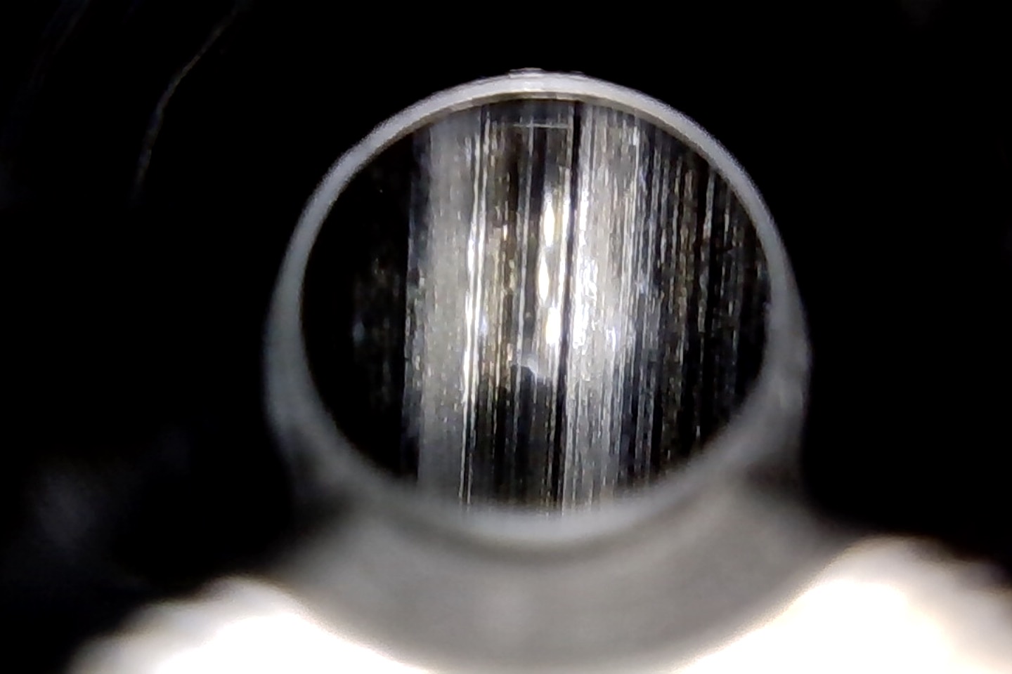

Here's what I got at my first attempt at using a borescope for 5 minutes...
The barrel looks fine to me, nothing jumped out at me, looks brand new 12" in front of the chamber. As expected due to using brass with short necks, there does seem to be a ring at the start of the freebore, but after trying to wiggle the camera around to look at it, the ring doesn't seem to be more than a "burn ring" with a thin layer of stubborn carbon, it doesn't look like it's impeading the projectile from seating into the chamber as it should or anything (and my bolt close is almost always buttery smooth using a 0.0015" bump).
I don't see anything wonky going on with the lands.
IDK?
Again, remember, I've had zero problems with the barrel, it still holds a .5" group or less at 100 (even with the trigger set twice as heavy as I like) and bangs 6" plates at 1000 yards.

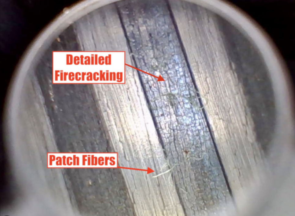

Edit: Even weirder... I found this: https://rokslide.com/forums/threads/is-it-a-carbon-ring.181410/
I don't belong to that forum, but that's another guy who was seeing nearly the same thing as me: lands aren't eroding much if any (if he was measuring correctly), shooting StaBall, pics look similar...
And there's this, where guys start going over the best way to clean it out before establishing whether or not it's even a problem lol (why I never bought a borescope hahaha): https://www.snipershide.com/shooting/threads/stubborn-carbon-ring-removal.7088935/

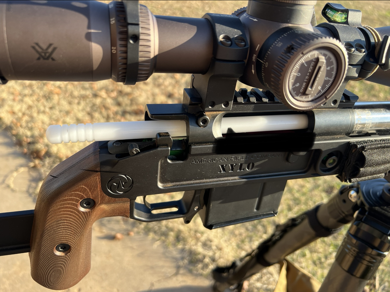

The guns I can't unscrew the barrel from while the rifle is assembled is a minority. Plus ARs. The guns I shoot a lot, I pull the barrel to clean and if I want to measure lands. So I do that with just the barrel and a dummy round. I get an empty, sized case, insert it into the chamber and ensure it fits without resistance. As in the shoulders are tapping audibly against the front of the corresponding chamber shoulder walls.
You should be able to feel the case slide freely and the hard stop of the shoulders in the chamber at headspace. You can also observe the case is fully seated in the chamber by the body being fully inserted.
Then, I'll seat a bullet in THAT case. Intentionally long so the case can't seat. You'll feel the lands bite the ogive. It will be a sticky or mushy feel. If you push the case in hard, the bullet will stick in the lands and you'll have a hard time pulling the dummy round out.
View attachment 8020920View attachment 8020922
I see the bullet 5 or 10 thou deeper each time and keep reinserting it into the chamber. Feeling for the shoulders to tap the front of the chamber. You will be able to tell when you are close because the majority of the case body will be inside the chamber. At that point, I seat in smaller increments so I don't overshoot. I also start measuring CBTO or OAL each time I see the bullet and stick it in the chamber. When seating the loaded dummy round is no longer sticky or mushy and you feel the front of the chamber walls, that's when your bullet no longer touches the lands. You should have a measurement from the last time that you felt the bullet touch the lands of you start measuring with each seat.

If anyone thinks I'm full of shit, cool, all they have to do to prove me wrong is: buy a barrel and enough of all of the exact same components to shoot the thing out without changing anything or adjusting the load at all, feeding it the exact same load for its whole life, and then do it again. Because when this second barrel dies, that'll be what I've done (and it's documented in this thread). Then we can argue about it.
It's your choice but your pictures tell the whole story.
I don't think so, if you're talking about that ring, the only thing that proves to me is that I was just fine not owning a borescope lol.
I'll measure it in a couple/few hundred rounds and see what I get, as it stands now, it measures 2.255" to the lands (give or take a half a thou), we'll see what I get later...

Here is how I deal with carbon rings and cleaning in general. Get a chamber plug from possum hollow, pull your bolt out, insert chamber plug, stand gun on butt stock, fill barrel and chamber with your favorite cleaner ( I use Patch Out or Boretech Eliminator) making sure it’s also on any carbon on the crown, let soak for a few hours, pour it out, run a stiff brush through to knock out loose stuff, fill it again, let soak overnight while I sleep and/or go to work, come home, dump out the fluid, run a brush and then some patches down it and it is likely clean. I may have to use an oversized brush on a short rod to clean out any carbon at the end of the chamber.
This is a very lazy and easy way to do it. You don’t have to remove the barrel or action from the chassis. I always pull the muzzle brake off so I can clean the crown.

Here is the chamber plug. It’s just an appropriately sized Delrin rod with an o-ring grove cut in it. It goes into the chamber maybe 1/3-1/2 the way? I stand it up in the corner and fill the barrel up with a squeeze bottle or syringe depending on what I’m using. Easy peasy.

@MilSpecOkie thanks for the suggestion about the Possum Hollow plug (I didn't know they made something like that, cool).
That said, that's as clean as my barrel is going to get, those borescope pictures were actually taken after me cleaning it lol. I'm going to stick to the regime I've been using: Boretech Eliminator, cotton patches, nylon brush, that's all. I know that many guys around here wouldn't consider that even close to "clean"... but it works for me.
I had picked up the borescope only to see what was going on with my lands (and their lack of erosion) out of pure curiosity, that's it.
In fact, I shot a ~.3" group at 100 earlier (5 shots touching), and was banging MOA & 1/2MOA plates at 1000yrds no problem with a 15-20mph cross-wind, the barrel still hammers.
BTW/FWIW, It's so nice to have a good trigger again! I had to pull my barreled action, then pull the trigger, to blow it out with brake cleaner and compressed air (per Triggertech's instructions, which reminds me that I need to update that thread...). Somehow, my trigger had crept up in pull-weight and increased to well over a pound instead of being at 8-9oz where I like it. Now hopefully it's fixed and will stay where I set it. Strangely, I didn't even have to re-zero... It was within a click, one way or the other, and it was too windy to bother trying to get it any closer than it already was lol.
As an aside, I was talking to a buddy who has a bunch more experience than I do with a borescope... and he pointed out that those pics I took look to him like my lands are a bit beat up and that my lands are indeed eroding, just not enough yet to show up measuring with a bullet. He pointed out that the lands in my pics look tapered and skinnier at their start towards the chamber, he was just bore scoping a new barrel with 100rds on it the other day and pointed out that the lands on a new barrel are more uniform in thickness and nearly square towards the chamber (see pic, not my barrel but a pic of a new one I found):

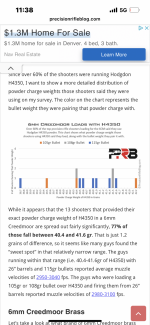

I have burned through two 6mm creed barrels, after my initial load tests I never changed the bullet
seating depth, first one started throwing fliers at around 1620 second one was still shooting in the low .3's at 100 yards
with 1600-ish rounds down the tube and put 5 rounds into a 8" group at 1K yards with 105 match burners.
Both barrels had substantial firecracking in the throat and I clean after every range trip almost.

If you strip your barrel of all the carbon you will see your barrel will look as your buddy described. Your carbon is filling in the edges of the grooves making them look skinny. Once you get down to metal you may find more fire cracking.
That said, I will say the the end of the chamber where the free bore starts looks damn good for having 3000 rounds on it. I just did a quick chamber clean tonight of my 6GT with less than half as many rounds on it and it looks 1000x worse than yours. Mine has been feed a diet of 105-115 grain bullets pushed by H4350.

This barrel only has 1500rds on it.
That 3000 number came from another guy throwing it around while trying to say that I'm saying something that I'm not.
I still don't really know what's going on with the lack of erosion on my lands, but I also haven't been able to find anything out there about anyone doing the same "experiment" (running slow and jumping a bunch for the life of the barrel) as I've been doing for this barrel and my last one.
