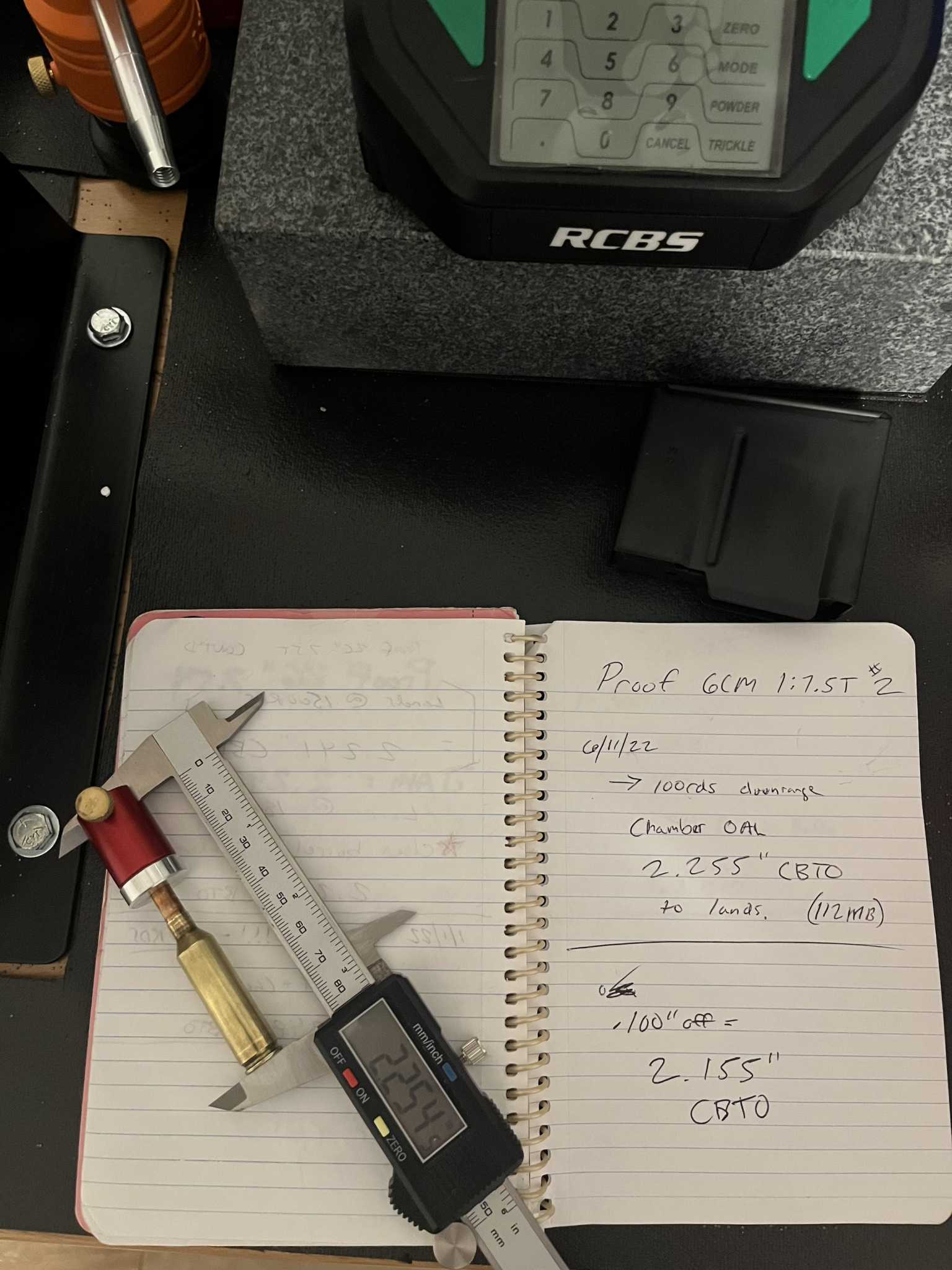

This is an update to post #1,017... in case anyone is wondering, this is a good chunk of the "why/how" a barrel and load using a healthy bullet jump stays so consistent (boring) over its life...
I was having more issues than usual holding a tight group lately, so I started checking my rig looking for a reason as to why (I mean besides me sucking at shooting lol). This meant going over the whole rifle to verify that everything was torqued to spec (action screws, scope mount, etc) and then looking at the possibility that my throat had eroded to the point where my load needed to be tweaked or even maybe me having to work up a new load.
Well, turns out it wasn't the barrel/load (my trigger pull-weight had increased on its own, doubled in weight somehow).
That said, decided to check on my throat erosion: I use/recommend the Deep Creek Method to find one's lands using a dummy round made up of the same ingredients, same brass, same bullet, prepared exactly like the real ones.
I'm jumping 0.100" to the lands (112gr Match Burners, also running "slow" at ~2900fps).
The barrel now has 1500rds on it.
The barrel when new after 150 rounds on it: lands @ 2.2550". After 1500 rounds on it: lands @ 2.2545" (actually could be zero, really tough to call if I wasn't closing the calipers too hard once within a thou).
Edit: Remember, loaded in closer to the lands (like the ubiquitous .020" off) usually means cooking off ~0.006" per 100 rounds!!! (https://precisionrifleblog.com/2020/03/24/how-fast-does-a-barrel-wear/)
Crazy.
I have seen this exact same thing with the barrel throat at .020. I shoot 109's and hit max COAL for my mag. So now I'm jumping .120! And shoot great. Same powder charge. 40.2 RL16, Hornady Brass, 210m
I lost .014 in 300 rounds

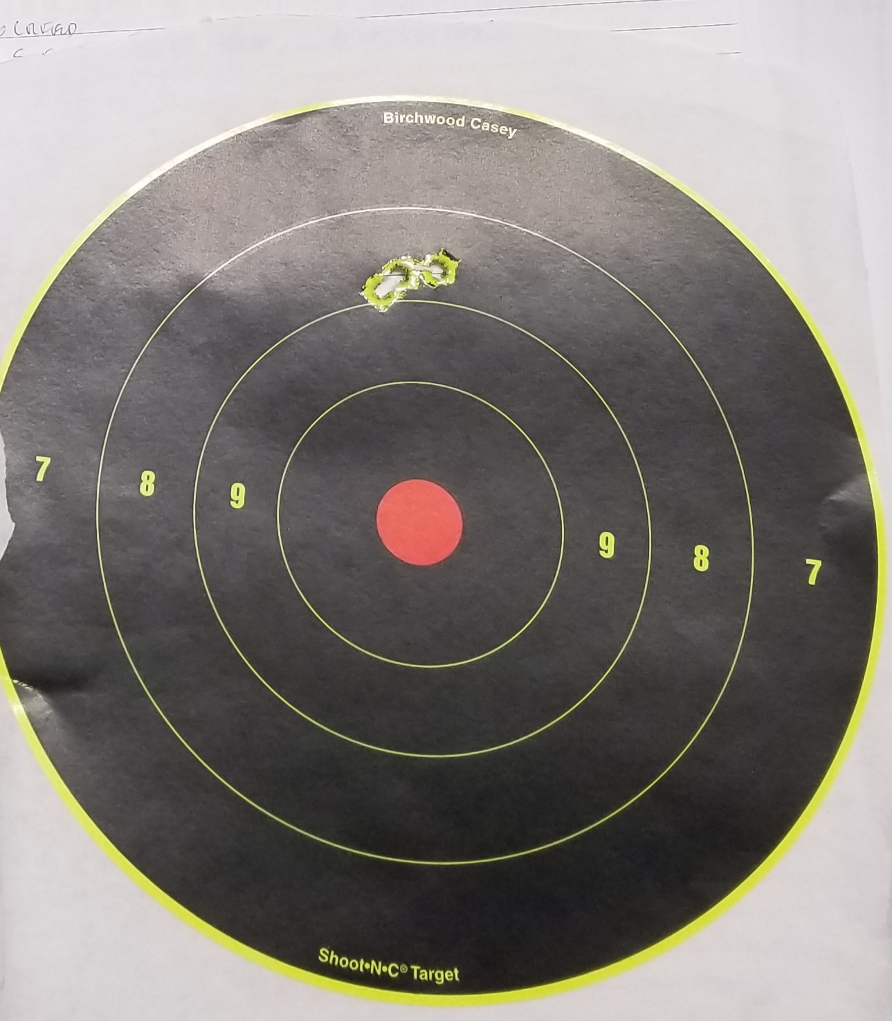

With a 108bt Berger, in Lapua brass, I initially started at 40 and went to 43.8, for pressure. I then narrowed it and went from 41.9 - 43.7 for POI testing. I settled on 42.65gr of 6.5Staball and it's good. You should be good to go starting at 40.0
I have been following the 6Creed for a good while and finally swapped in a CrownRidge 7.5 T 25" on a Savage model 10.
I am waiting for some heavy projectiles to come in and I had some 90 Gr ELDXs that were used in my .243. I noticed that several people asked about them in the Creed. Just because I have a lot of H100v I thought I would try it.
I used the Gordon's Reloading tool which seems good, but their data seems to be very fast compared to what I got.
I shot 41- 41.5-42 - 42.5
41=2090 FPS 42.5=3130 FPS
41.5 gave the best groups @ 3020FPS
according to the software the 42.5 is approaching maximum pressure. I never observed any pressure signs on any of the brass. With the reputation of being a barrel burner and the 90 ELDX being for plinking and Varmints my opinion is the 41.5 should work just fine.
If you would like more detail just message me.

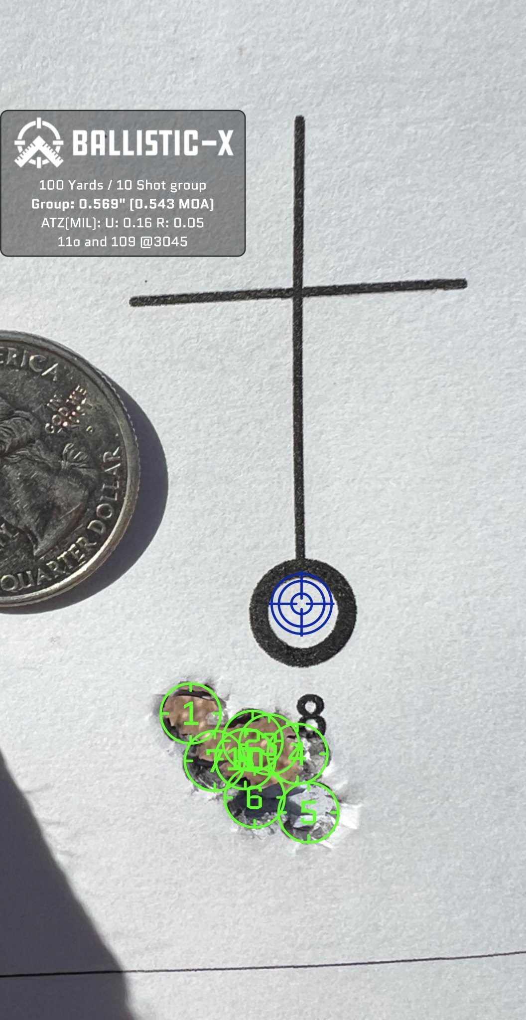

Just an interesting data point for anybody shooting 109s and 110 a-tips Loaded 10 rounds @ 40 grains of 4451, cci450, jumping.040, 5 eld m 109, 5 a-tip 110. 5 fps difference no shift in poi. A-tip 3040. 109 3045

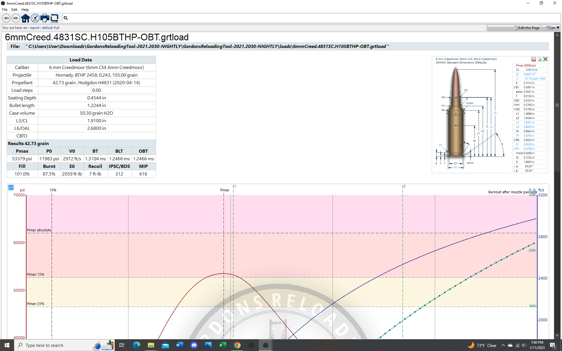

Not sure how many here use the Gordons reloading tool. Someone pointed out that there is a function called OBT. Optimum Barrel Timing,
I have been trying to duplicate the Hornady factory loading fornthe 105 Gr. Black load. Info on the box says FPS is 2960. It is stupid accurate in my rifle.
After running OBT the program said I was 1 Grain off from Optimum and the speed listed is very close to 2960

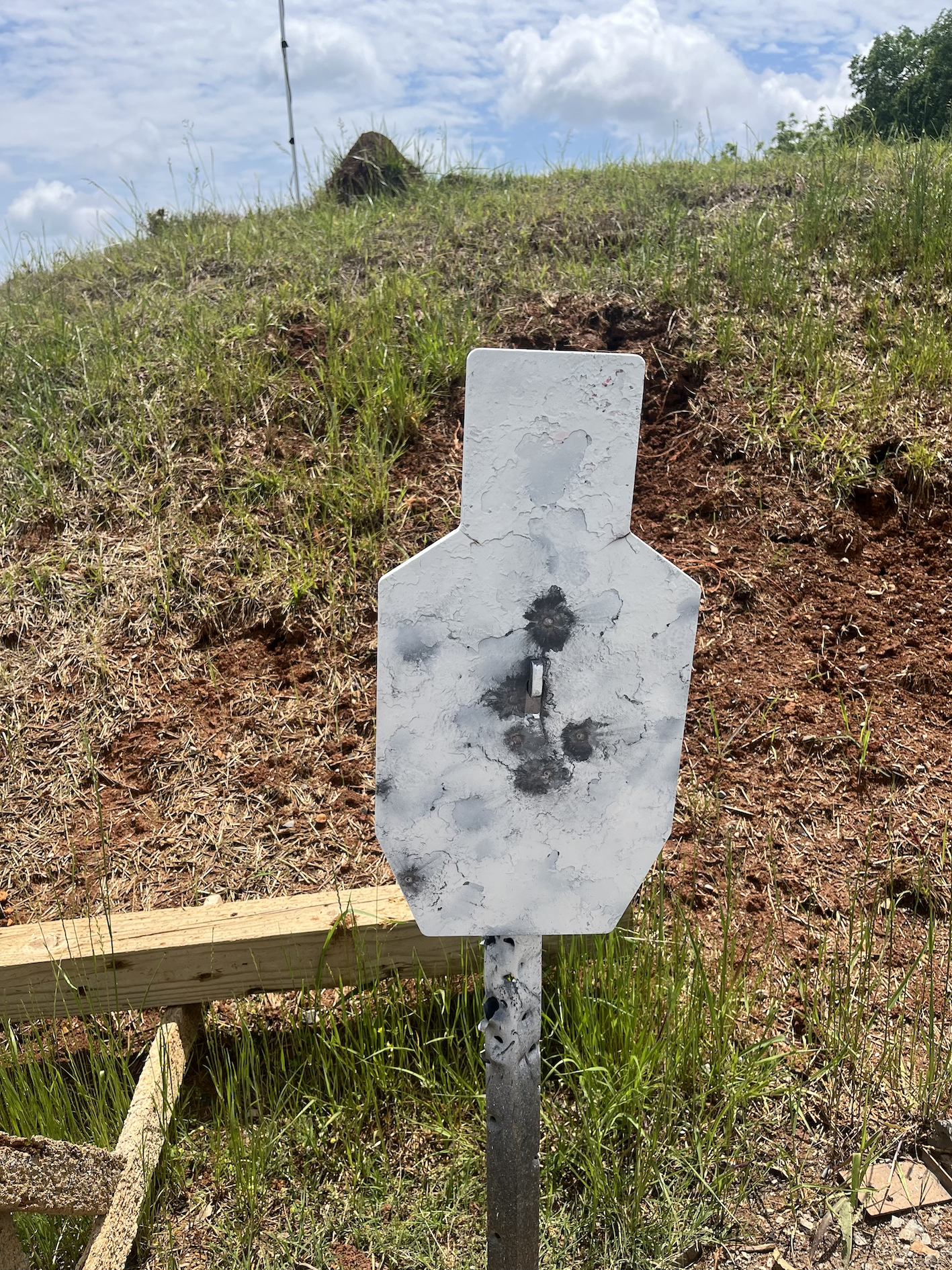

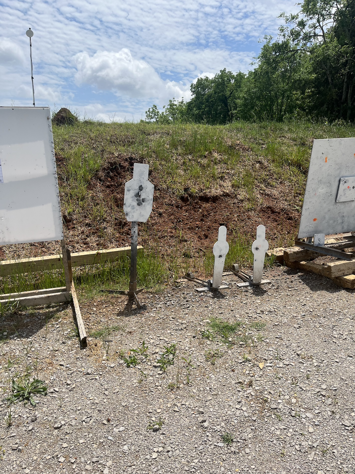

I going to call BS on those that say 6CM is a barrel burner and inherently has shitty barrel life. Keep the speeds reasonable and use a healthy jump and it's about like any other 6mm more or less.
Cattle gate and Shmedium, 35% IPSC, and a couple of poppers at 750 yards, 2875fps jumping 100 thou (not bad for a barrel that has 2900rds on it):
View attachment 8142138View attachment 8142139

That's not bad at all. What powder & bullet?
