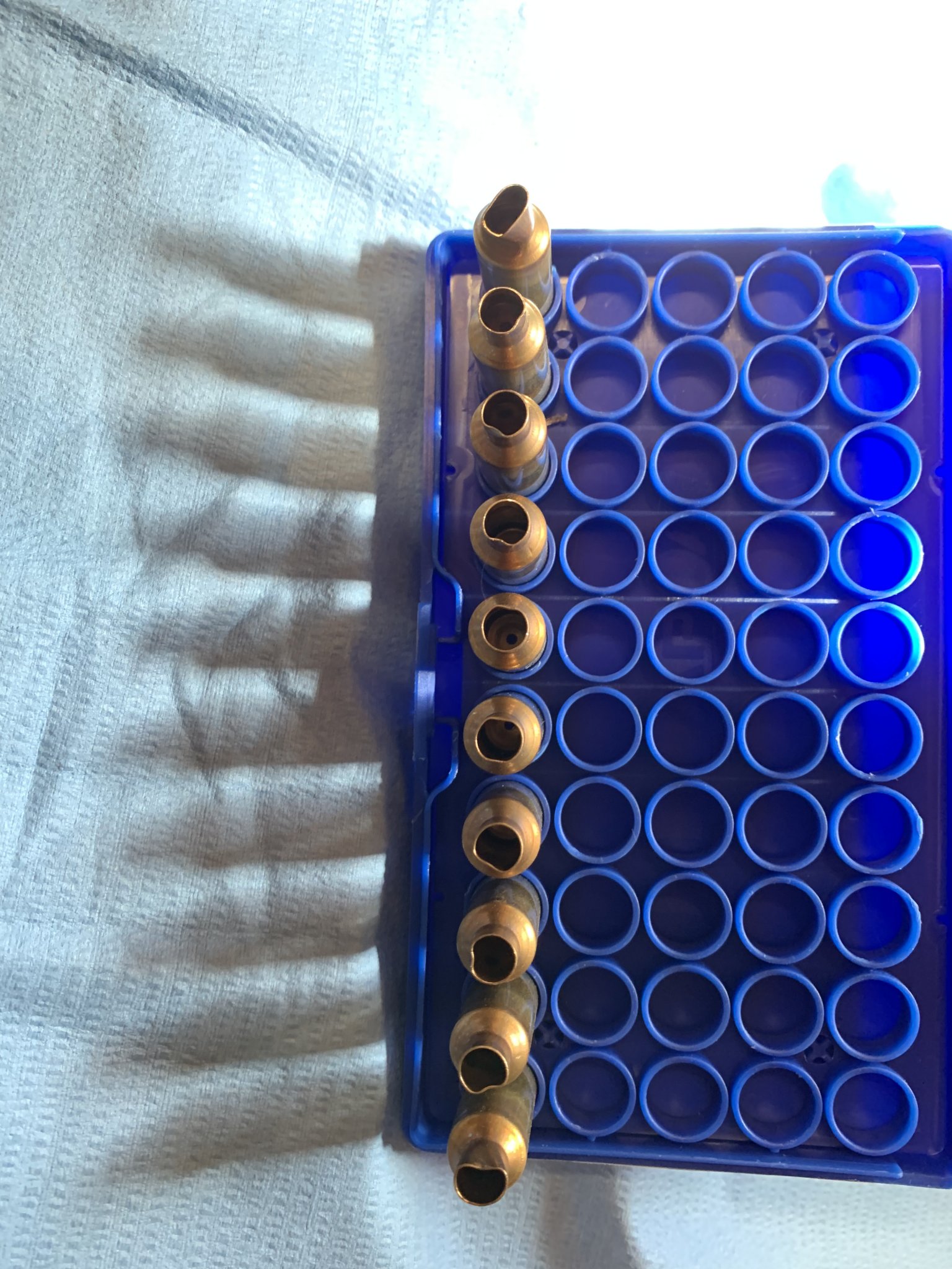

I won’t claim to be an expert on this as I know from reading up on it before making my decision there are much more experienced reloader’s for dasher than me. My fire forming experience is with 6x47 which is easy make a false shoulder when necking down 6.5 and load and fire. I would have tried the same on dasher by necking up and back down but didn’t have time this summer so I went hydro route as a lot of guys have had good success. I think for future I will try fire forming dasher and may dabble with a brx just because it sounds easier.
I don’t want to deter anyone from using hydro forming whether hunts or dj but think it’s totally fair for me to comment about brass loss in the process experience. Last I’ll comment on it as I’m not out to bad mouth or trash talk. Here is a picture of 10 out of first 100. Some may be salvageable others are trash. I threw one away before deciding to keep them so it’s 5-10% loss in my case depends on how many I can fix.
im not defending anyone but you hit those necks with an expander load and fire and they'd be just fine with the exception of the one at the top of the pic but id bet it would be fine to after firing it.
that said id agree that is pretty bad and im not sure how that happened from hydro forming...most common issue hydro forming is splits at the shoulder or necks...those look like they were stepped on.

What does it measure roughly at the top of the shoulder vs the base? There's barely any taper in the Dasher/BRA to begin with, like only 10-11 thou from top of shoulder to base. Not sure how much more taper you could remove. We're talking about human hair thickness at that point.
For context, posting a pic someone previously shared with me of Comet next to Dasher (Comet on the left). They are very, very similar.
