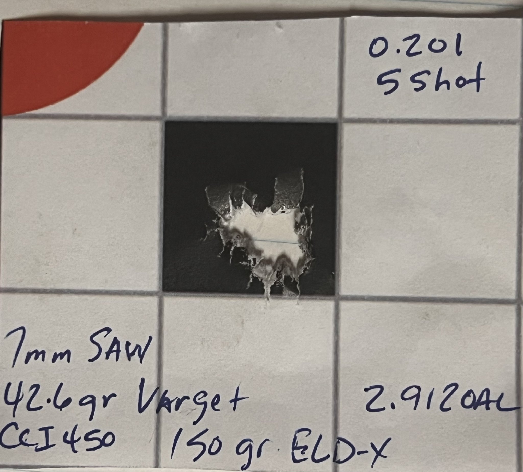

Anyone care to share their data using Varget for 22” barrels? I’m currently running 42 grains of Varget (22” cf proof) and getting about 2727 which seems slow compared to what I have been seeing from similar setups, but I am getting significant primer flow on some rounds and ejector swipes on some as well. I have some h4350 I could try as well, but it seems 4350 is generally slower than Varget. After my initial barrel speed up last year I had written down that I was getting about 2800 (my target velocity) with the same load of Varget, but I’m wondering if I wrote it down wrong
Im at 42 Sw Precision getting 2700 fps 60 degrees at with my 24" barrel. New barrel and hasnt had 20 rounds down the barrel.
22” proof carbon / virgin brass @ 2760fps. Started getting a slight sticky bolt past 43gr. Barrel isn’t broken in yet.

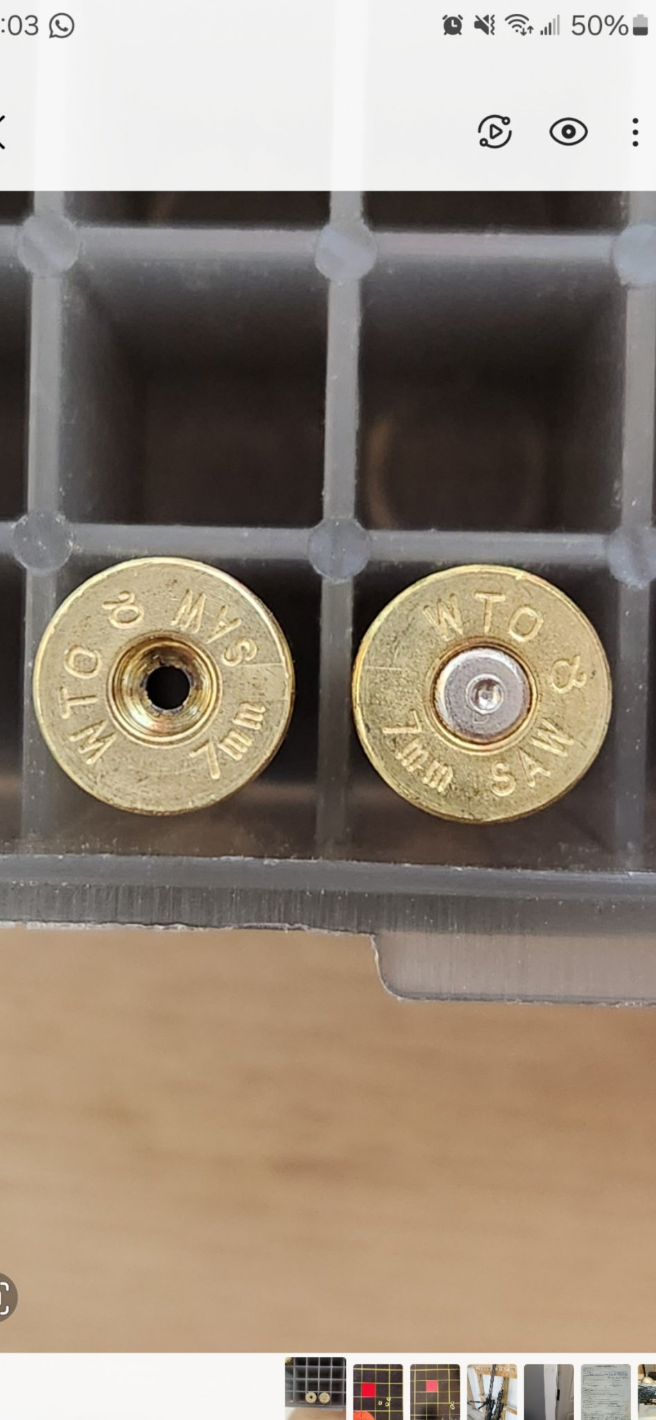

Loading up another 50 rounds tonight and more than half of them had loose primer pockets. Zero friction when seating primers. I take a look at the case and they had ejector swipes on them. Some of them with 2. There's been no heavy bolt lift or anything that would indicate high pressure otherwise. It's been close to 0⁰ C the last 2 times I've gone also, so I didn't think it would be necessary to look at the case head without a heavy bolt lift in colder weather. I'm pretty annoyed as the case of brass has 3 firings on them at the most.

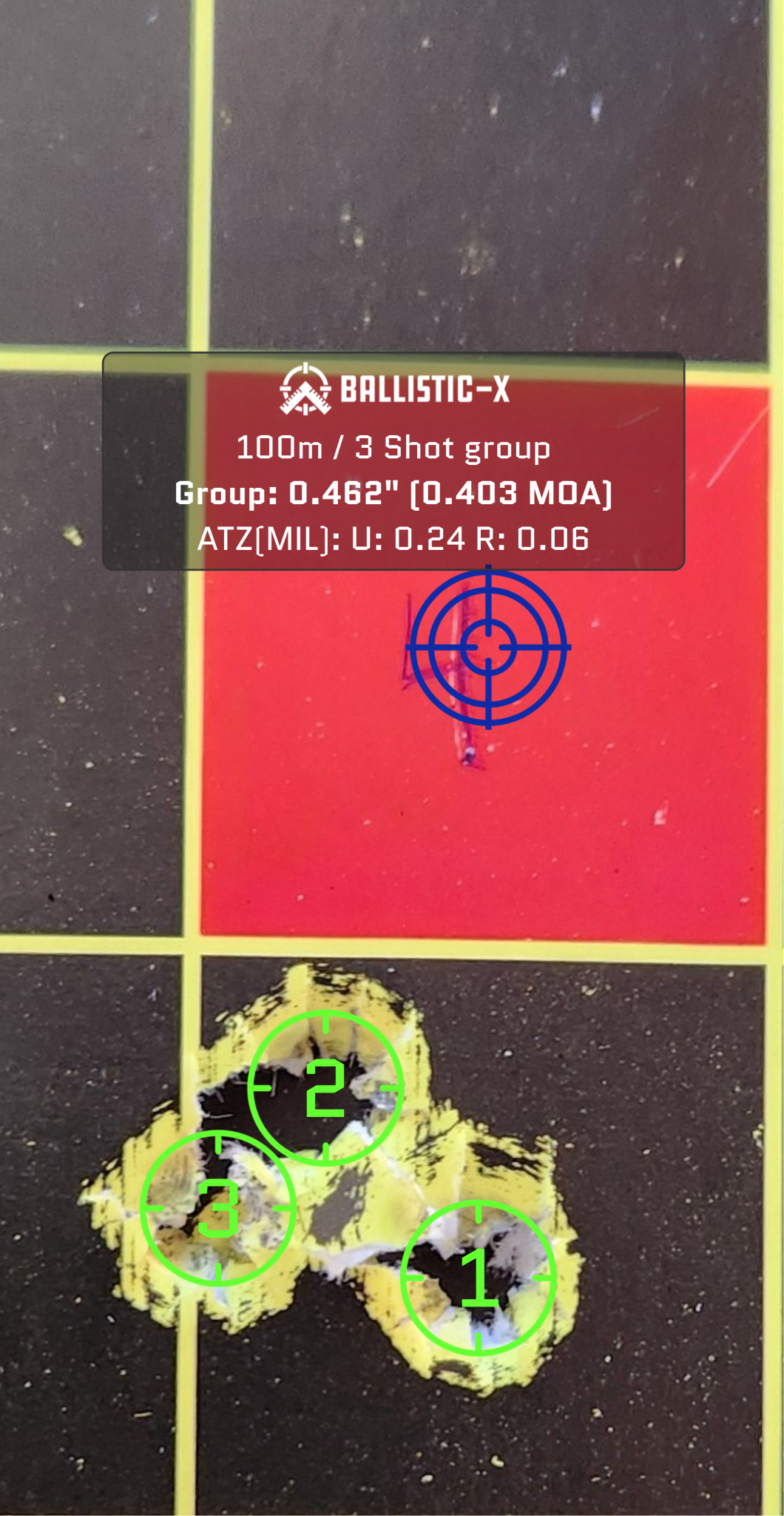

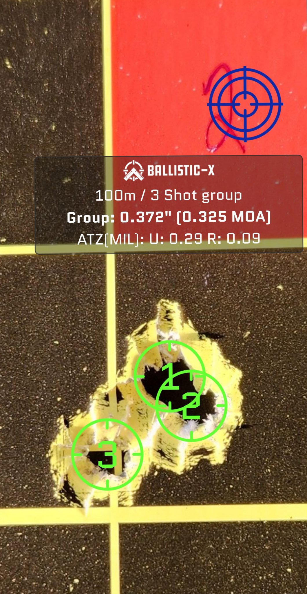

Just a follow up on my last post.
What I thought was ejector marks on the brass is actually from the slot in the bolt face for the mechanical ejector. The case head has been flattened a bit, except for a small part where the slot in the bolt face is cut out. See below picture at 3 o'clock and 9 o'clock for the left and right case respectively.
The case on the left was fired at 41.8 grs IMR 4166 and is part of the batch that had loose primer pockets. The case on the right was virgin, once fired at time of this photo, at 41.5 grs. 41.5 grs also produced some good groups, with the 2 best here:
Ballistic-X-Export-2024-01-05 17_20_41.861767.pngBallistic-X-Export-2024-01-05 17_19_33.927581.jpg
I want to load up more to shoot some 5 shot groups to confirm, but I'm wondering if I'm over pressure at this load or if it's a brass issue? I know there's been issues with non OCD brass in other cartridges. Velocity was about 2770 for both groups. I shot some more today at 41.2 and 41.3 grs but groups opened up. I'd hate to keep dropping the charge weight if I didn't need to.

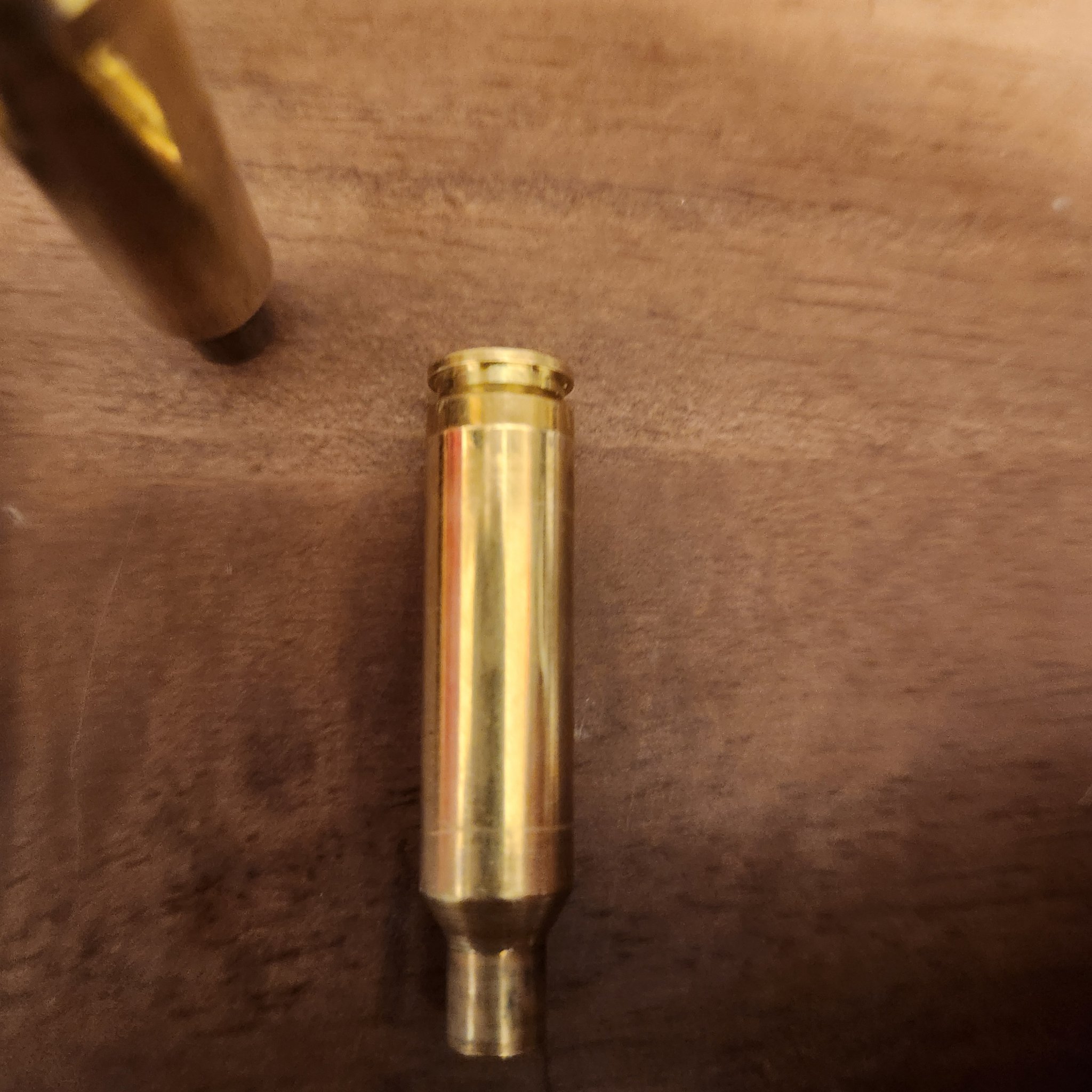

I did the 708AI thing last year...it was quite the learning experience.
308 Lapua brass sized to 708 for fireforming
708 fireformed brass to 708AI created a donut in the case neck
Had to neck turn the .016 thick case necks to .013 for enough case neck chamber clearance, and to flush out the donut.
I found no donuts formed in the step down from 308 to 708, just when 708 fireformed, so a 7 SAW is appealing.

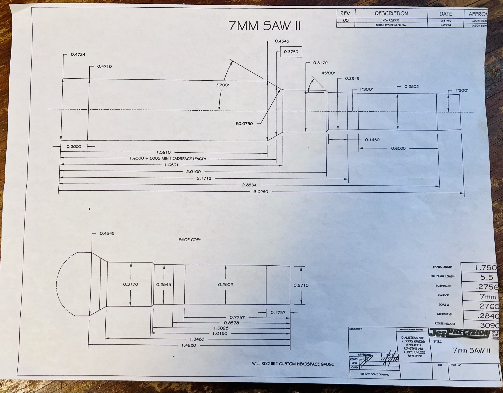

Anybody able to post a 7 SAW I and II reamer print?
https://westtexordnance.com/7mm-saw/

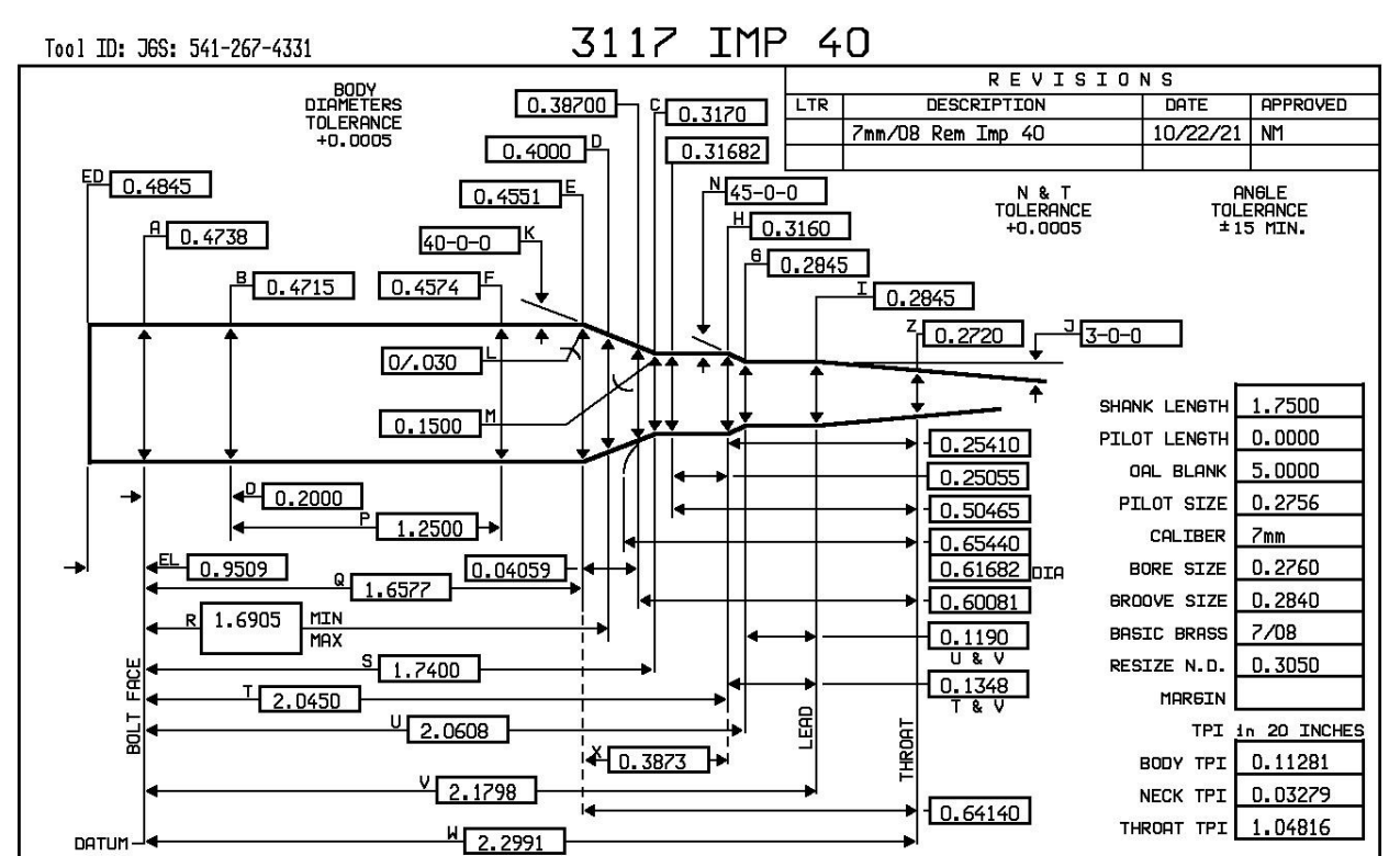

What I was sent from WTO:
Could you help me understand what the throat dimensions in this mean?
Coming out of the case area I see a .2845" dimension, I believe that's the .161" Freebore. Then a 1.5 degree lead into a .2802 section, then another 1.5 degree lead. Is this saying that it has what might be called a +P throat, or is the first 1.5 degree angle the Leade, and the farther 1.5 degree cut just a feature for the reamer?

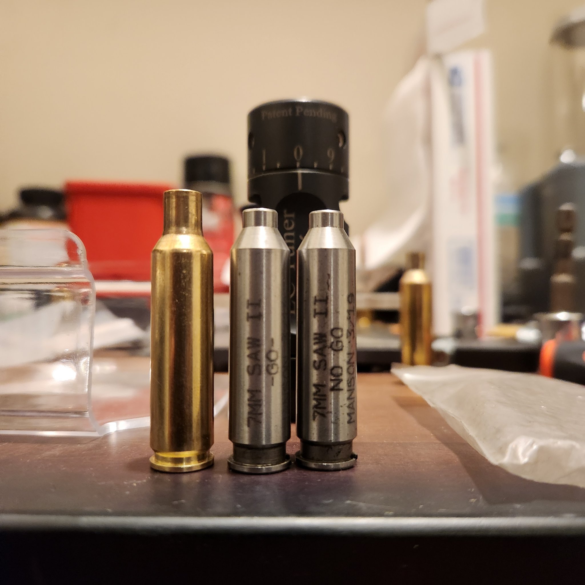

Stupid question. What headspace comparator is everyone using. For my 15 saw, Im sizing brass down in two steps. 289 281 then 257 expander ball. I fired a few shots with 42gr of shooters world long rifle. And getting this with 134gr eldm at 2875 fps at 55 degrees. I triple checked my headspace. Its all good. I will load a few at 40gr and see what happens. Definitely still have some case capacity left.
Stupid question. What headspace comparator is everyone using. For my 15 saw, Im sizing brass down in two steps. 289 281 then 257 expander ball. I fired a few shots with 42gr of shooters world long rifle. And getting this with 134gr eldm at 2875 fps at 55 degrees. I triple checked my headspace. Its all good. I will load a few at 40gr and see what happens. Definitely still have some case capacity left.View attachment 8350115
I use the hornady comparator set. Using the 375 on saw brass.
Yeah, that is some reamer specific measurements since they go smaller than bore diameter.
