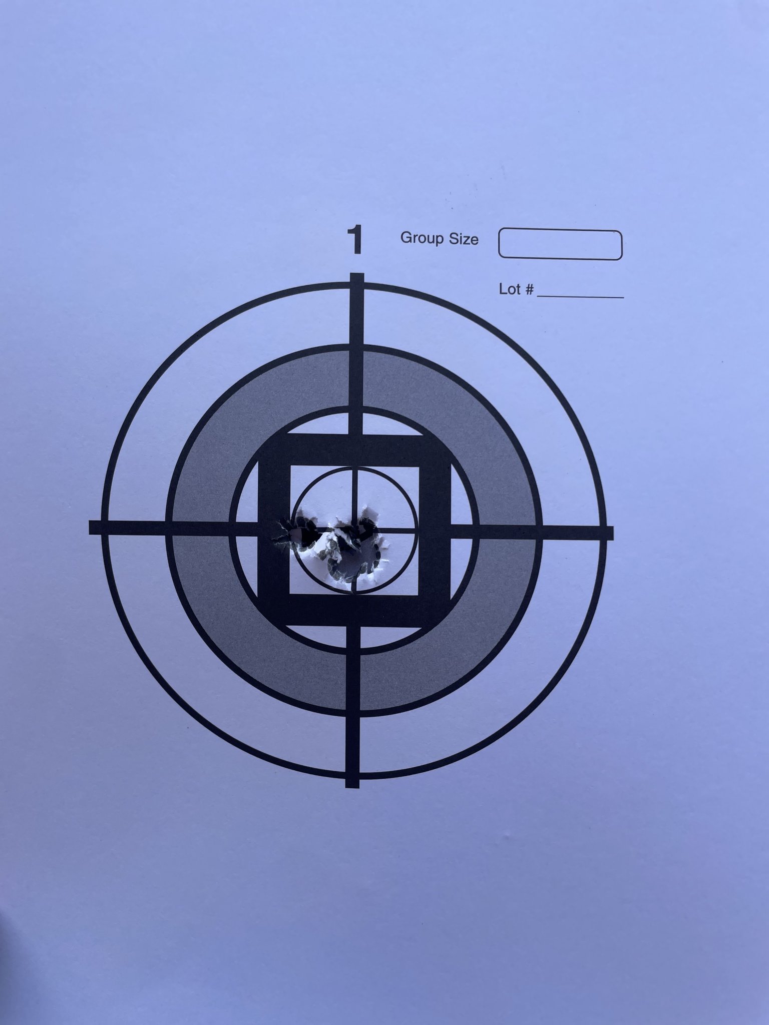

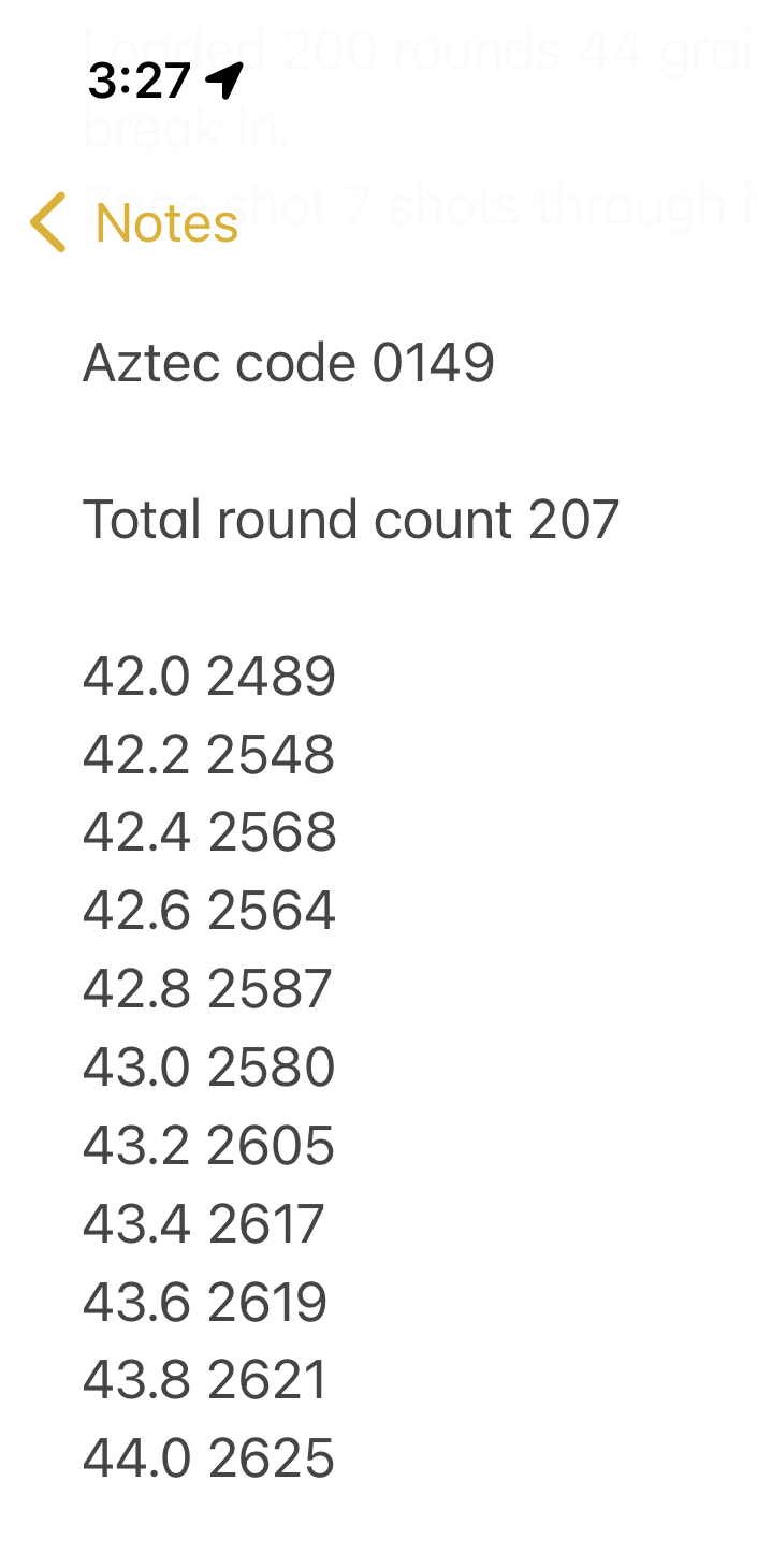

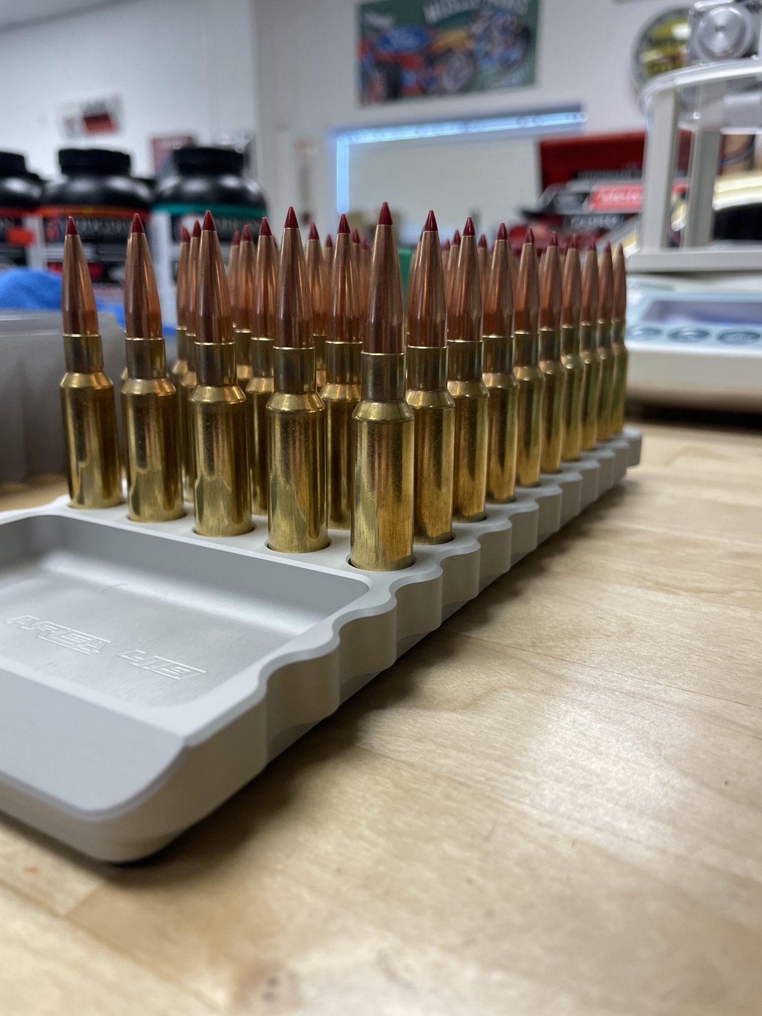

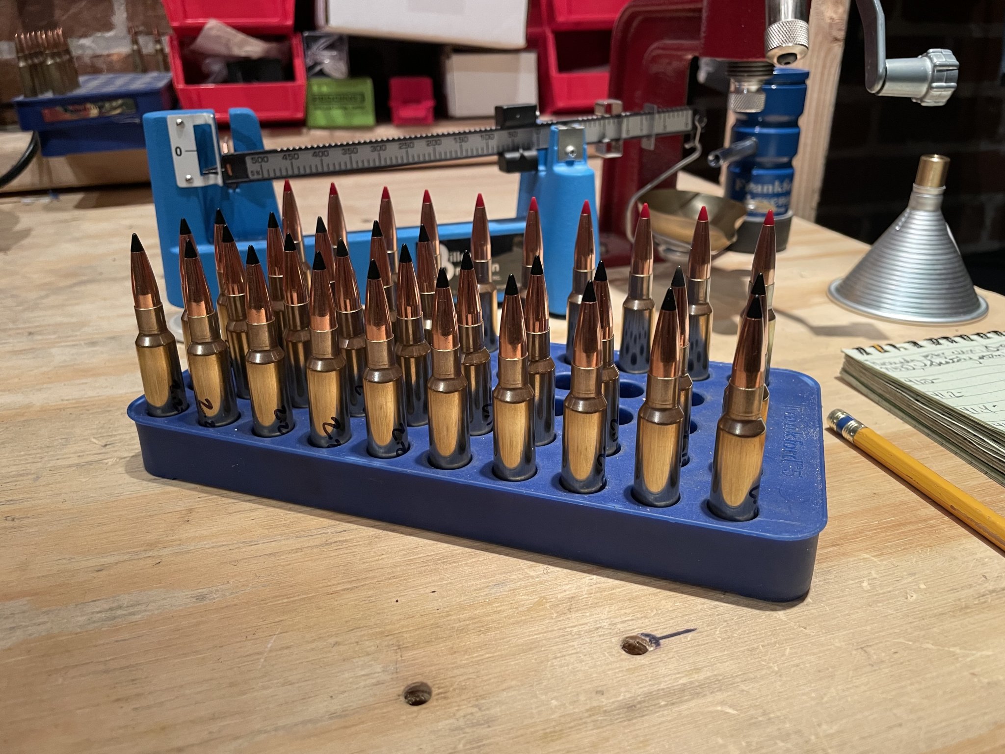

Loaded up 200 162 ELD-Ms at 44 grains of h4350. This seems to be WTO’s starting load so I think it should be a reasonable place to start. Will update as I shoot and load more!

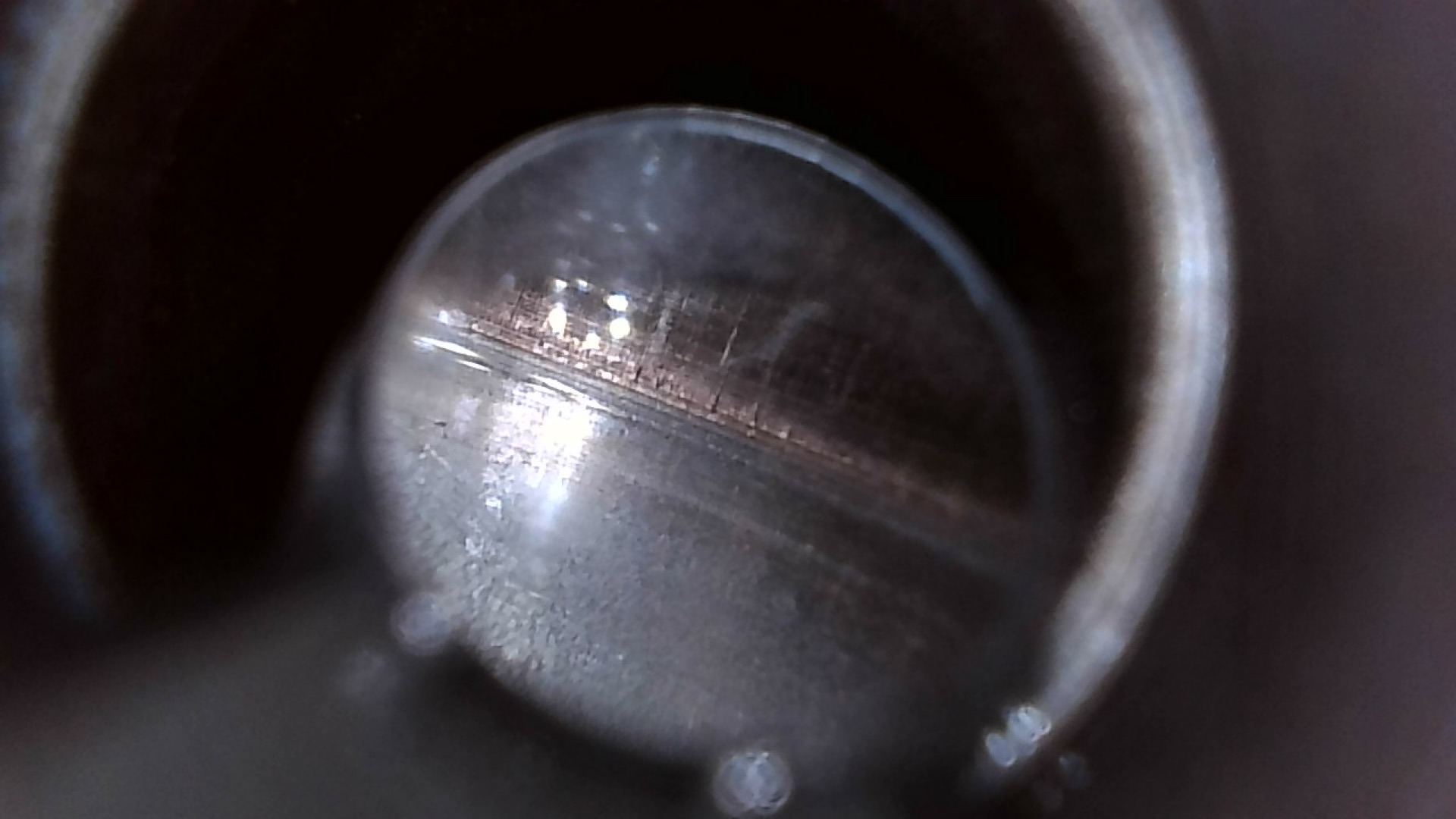

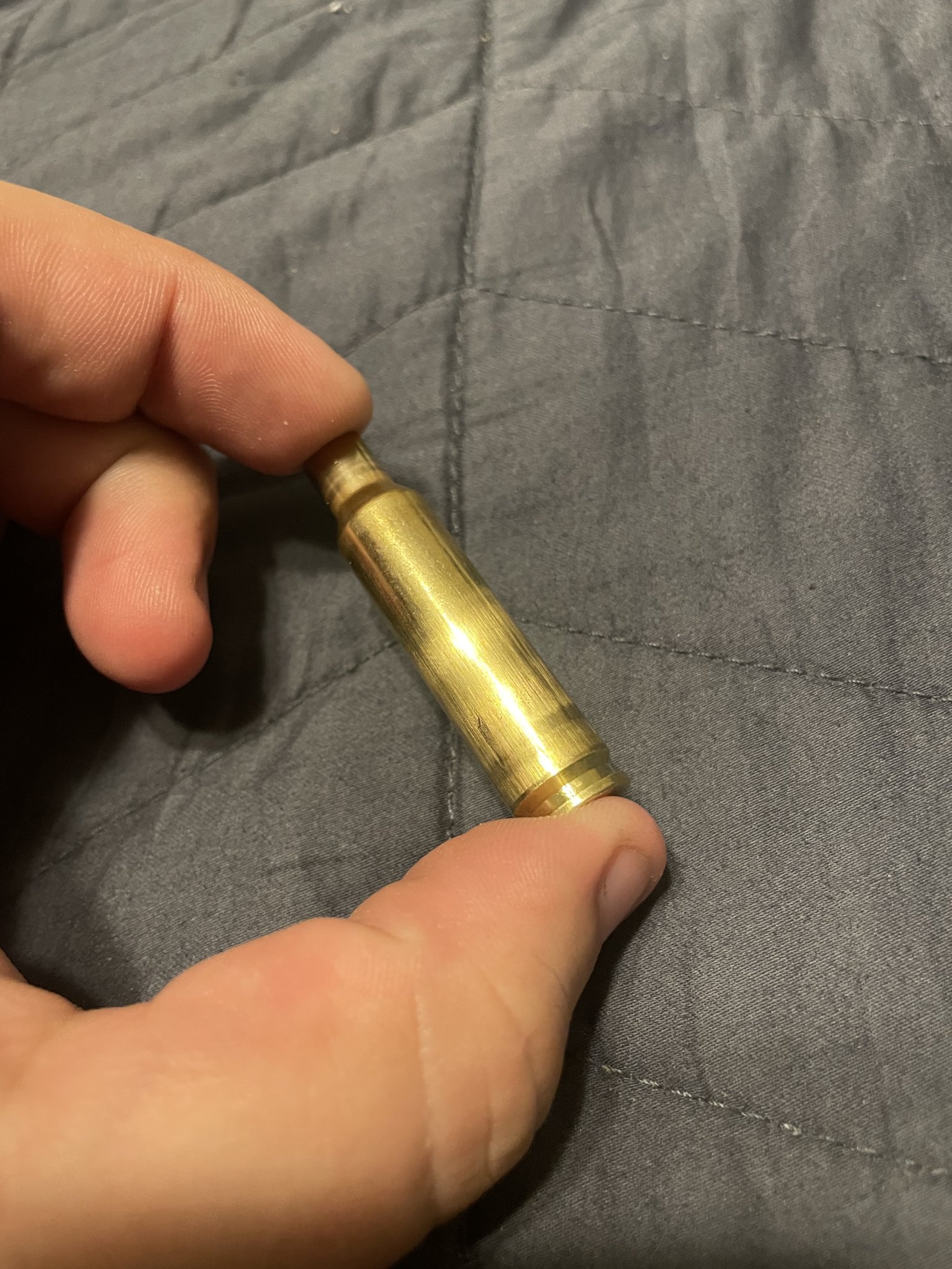

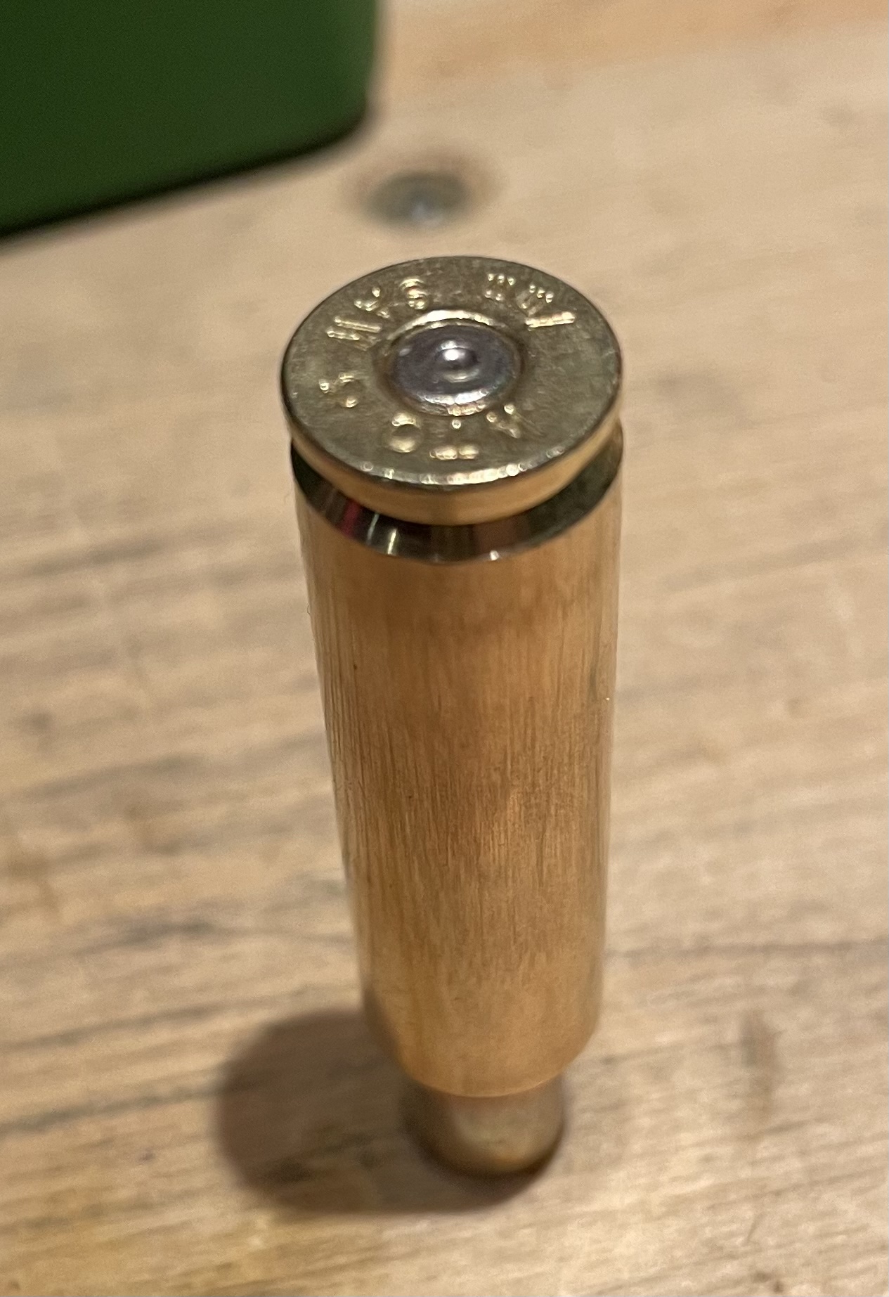

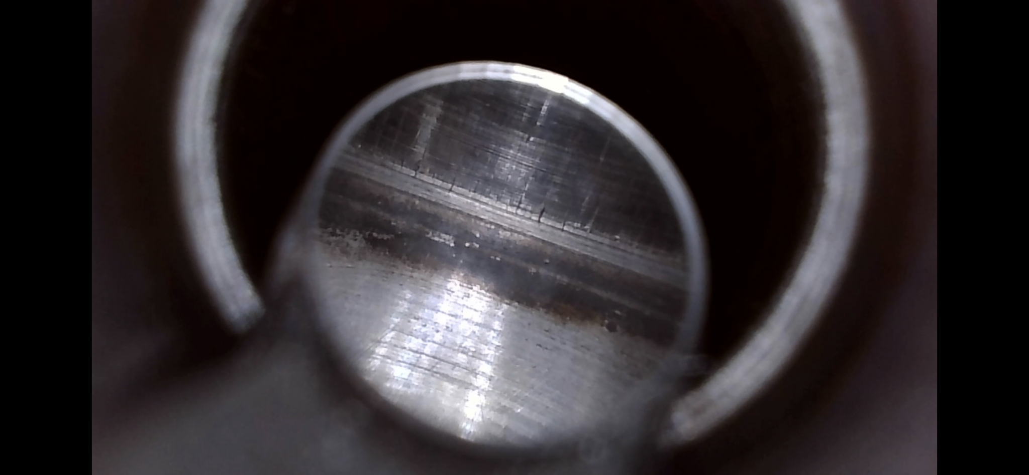

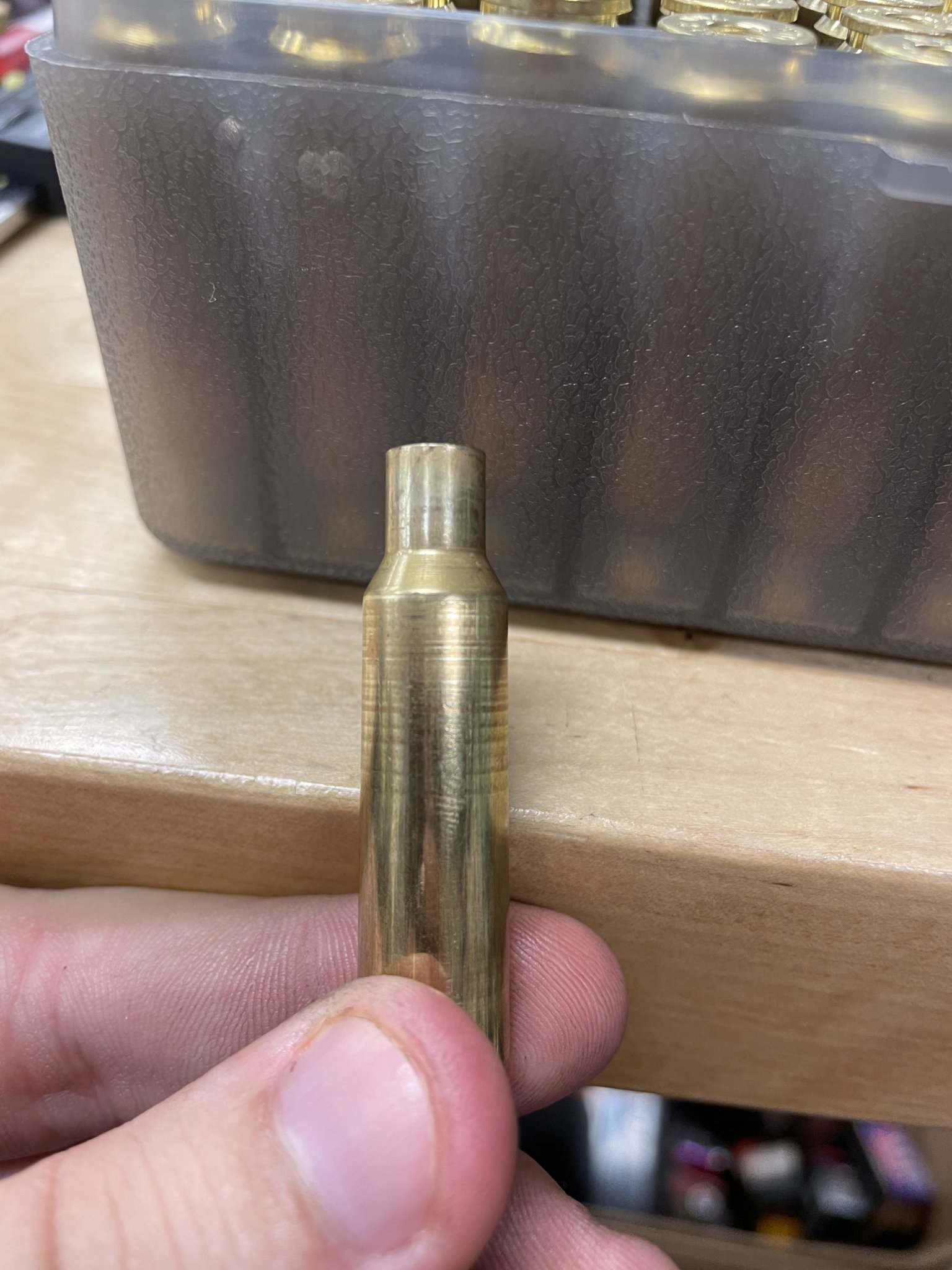

Well guys I’ve ran in to a couple of issues with my 7 SAW. First is that my fired brass gets these rings after sizing in my Redding dies. Even with generous die wax, it shakes my entire bench to even be able to size one piece. The rings may come from a chamber issue but that is not yet confirmed, I am getting a borescope tomorrow to check that out. The second issue being that my Redding die is over sizing and has a bad interior finish. I ran a Virgin piece of brass through the die and it left all types of scratches and looks like it sized the body. Here are pictures of the brass. However my 7 SAW loading will come to a halt for now. I will use what I have left to shoot a match next weekend but now I have to wait for Redding to make it right. Has anyone else had these issues with their Redding die set?
Well guys I’ve ran in to a couple of issues with my 7 SAW. First is that my fired brass gets these rings after sizing in my Redding dies. Even with generous die wax, it shakes my entire bench to even be able to size one piece. The rings may come from a chamber issue but that is not yet confirmed, I am getting a borescope tomorrow to check that out. The second issue being that my Redding die is over sizing and has a bad interior finish. I ran a Virgin piece of brass through the die and it left all types of scratches and looks like it sized the body. Here are pictures of the brass. However my 7 SAW loading will come to a halt for now. I will use what I have left to shoot a match next weekend but now I have to wait for Redding to make it right. Has anyone else had these issues with their Redding die set? View attachment 8087810View attachment 8087811
I had the same problem with a forester die, but never Redding. I’m sure they will make it right, they have always had good CS from my experience.

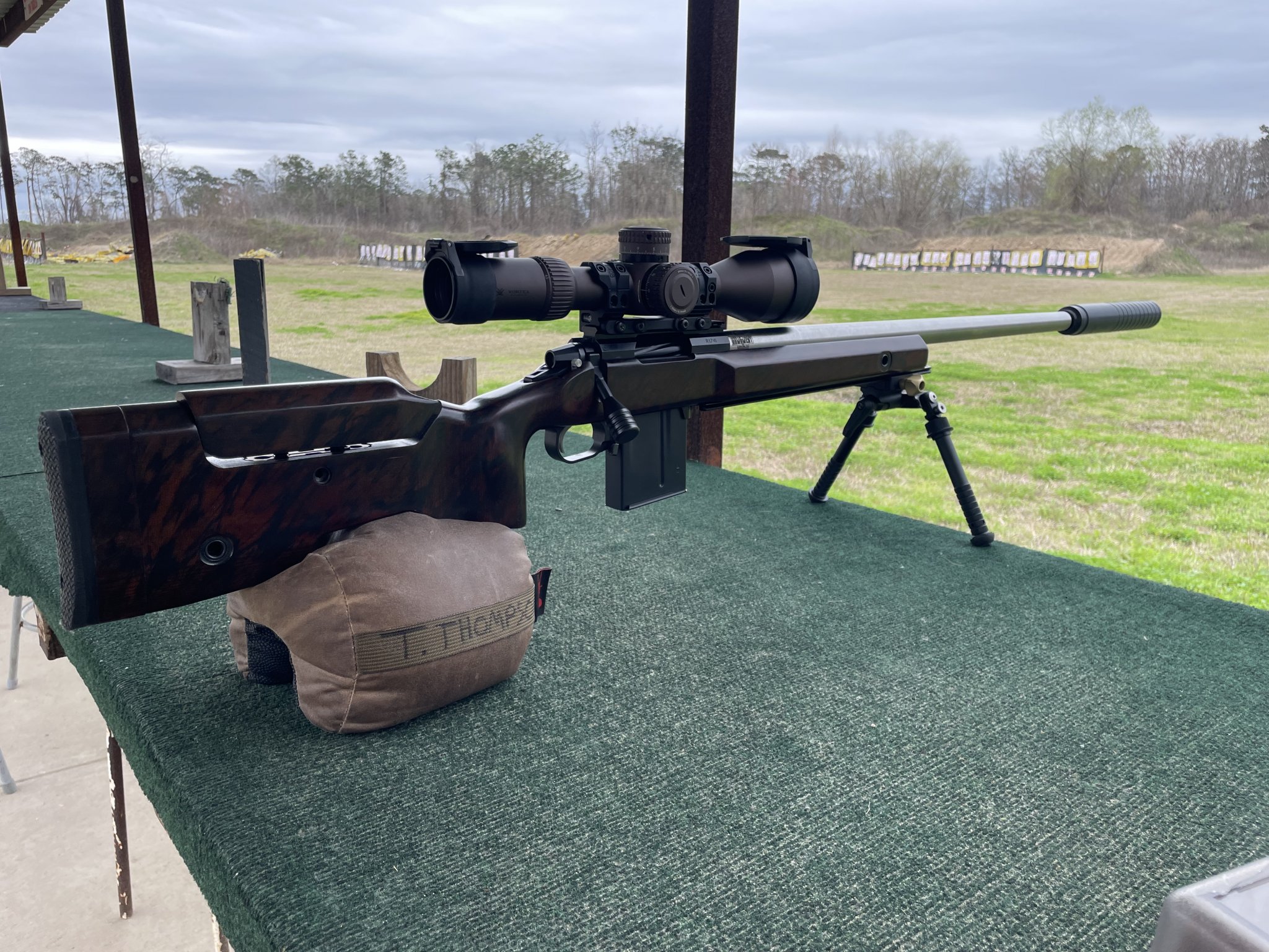

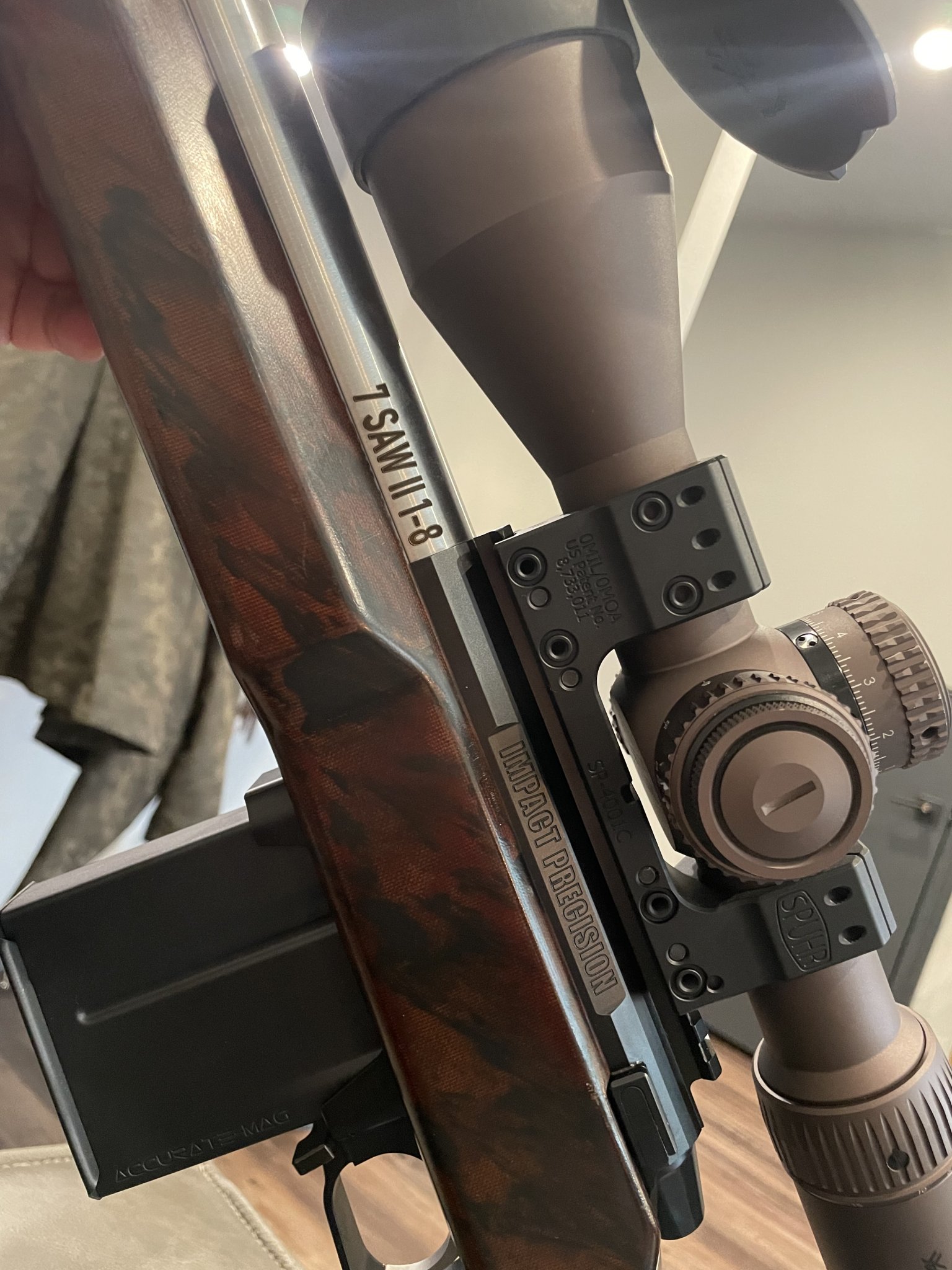

Received my 7saw last week with a 18.5” barrel. Sako 85 receiver, McMillan carbon fiber stock and Preferred Barrel Blanks barrel.
I mostly hunt backcountry & shoot suppressed, so I’m trying to keep everything relatively light and handy. The plan is to have it well suited for taking elk out to 400 yard max range.
I don’t have my rifle yet.
Maybe take measurements before and after sizing of length, length to datum point( headspace), neck diameter, and web diameter. Before you use your die, disassemble and clean with bore solvent and brush .

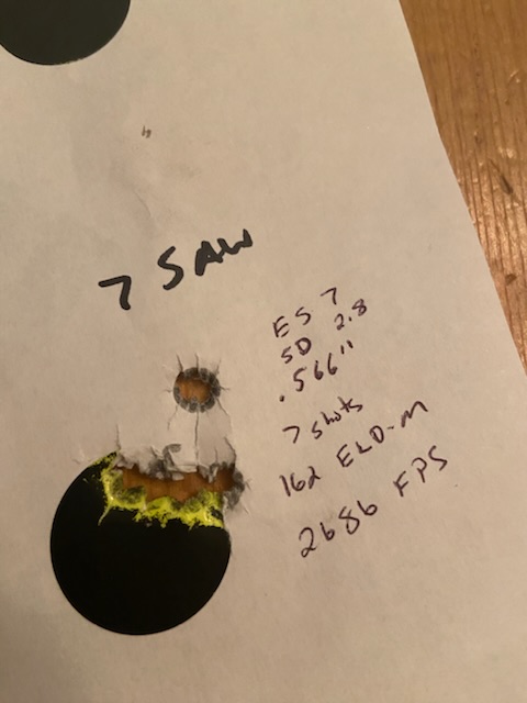

I have a 22” PROOF carbon I’m shooting suppressed. Saw II chamber.

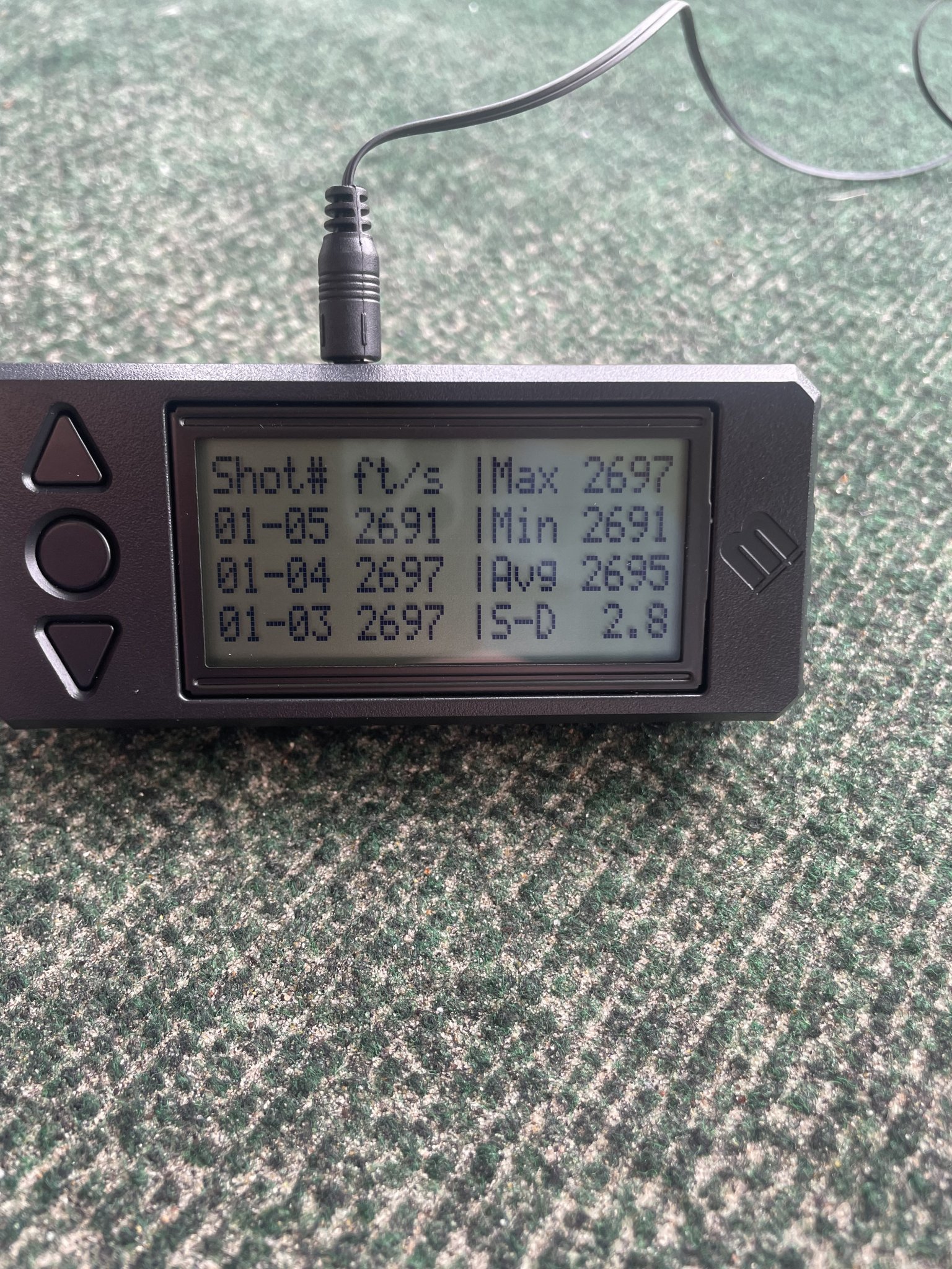

41.2 grs of Varget yielded me:
Avg 2686 FPS ES of 7 , SD of 2.8. (7 shots) with the 162 ELD-M, hope that helps. COAL of 2.899 seemed good, it liked that seating depth.
I was still getting a bit of cratering and slightly heavy bolt lift towards the end of that string. I’ll probably drop to 41.1 grs and call it good. I’m not getting the velocity that Clay has on the WTO website for that barrel length/ load combo without a little pressure. Clay mentioned to me that some PROOF barrels trend a bit slow.
Animals won’t know the difference and it shoots really well in Virgin Alpha brass. I’m hoping pressure will be lower in once fired brass.
As for your cratering, if you’re not getting heavy bolt lift or extractor swipe on case head you’re PROBABLY good. I’m pressure averse though, see it cause problems too often in real conditions.

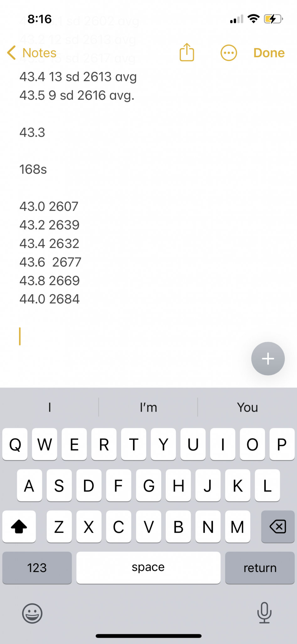

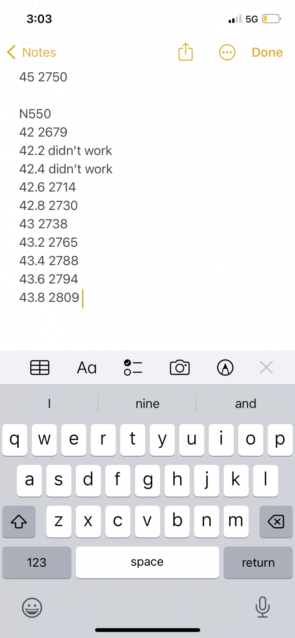

Got out to start shooting the rifle finally today. I have enough IMR 4166 to burn out the barrel, so I'm hoping I can get a good load with it. I started out with finding max load for 4166 paired with BR4, and federal 205M primers.
Working my way up from 39.0 to 44.5 gr in 0.5 gr increments. 44.5 was compressed so that was as far as the case would allow. 168gr berger vld Seated at 2.950 coal.
Max velocity I made it to once I saw slight pressure signs on the case head was 2798 fps with BR4 primers and 2795 fps with the 205M primers, both at 42.0 gr. Max velocity i made it to with worsening, but not extreme, pressure signs was 2952 fps at 44.5 grs. I only went that high with the CCI primers, as speeds were damn near identical between the 2 types of primers. 41.5 gave me 2776 and 2775 for BR4 and 205M primers respectively.
I'm pretty happy with these speeds as I was hoping to use up the 4166 since it's discontinued. I will do the same thing with IMR 4451 as I have 8lbs of that too and would like to find a use for it, and have more brass to get some firings on before I really start playing with the load. On WTO website it states that the avg velocities for 168gr bullets are right where I'm at if I play between 41.5-42.0 grs, so I'm pretty happy so far with the results.
I feel like CCI primers are preferred so far, judging on target. All shots between 39.0 and 42.0 grouped together, the next 3 after found a new POI.
