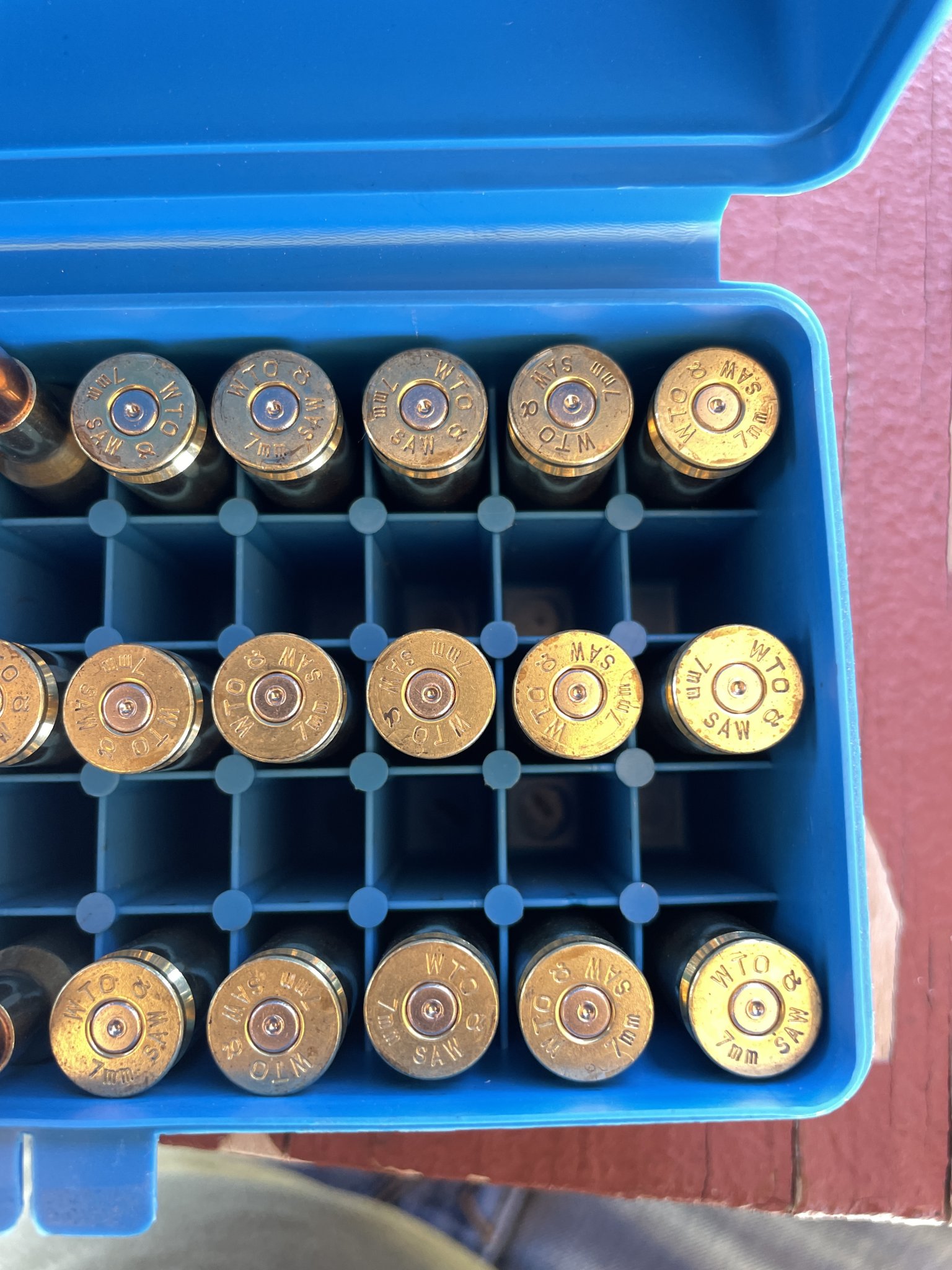

Has anyone used any converted LRP 308 brass and have comparisons to the Alpha SAW brass? I have quite a bit of FC 308 brass but don’t want to waste my time if it’s going to be useless. I know that’s not very good brass anyway. I also considered buying Lapua LRP brass because I’m trying to save my SRPs but don’t want to give up too much performance.
I have the Alpha small primer brass, with a 162gr projectile the accuracy node is in the upper end of acceptable pressure, I reckon if you use LRP brass you will hit pressure issues well before you find decent velocity

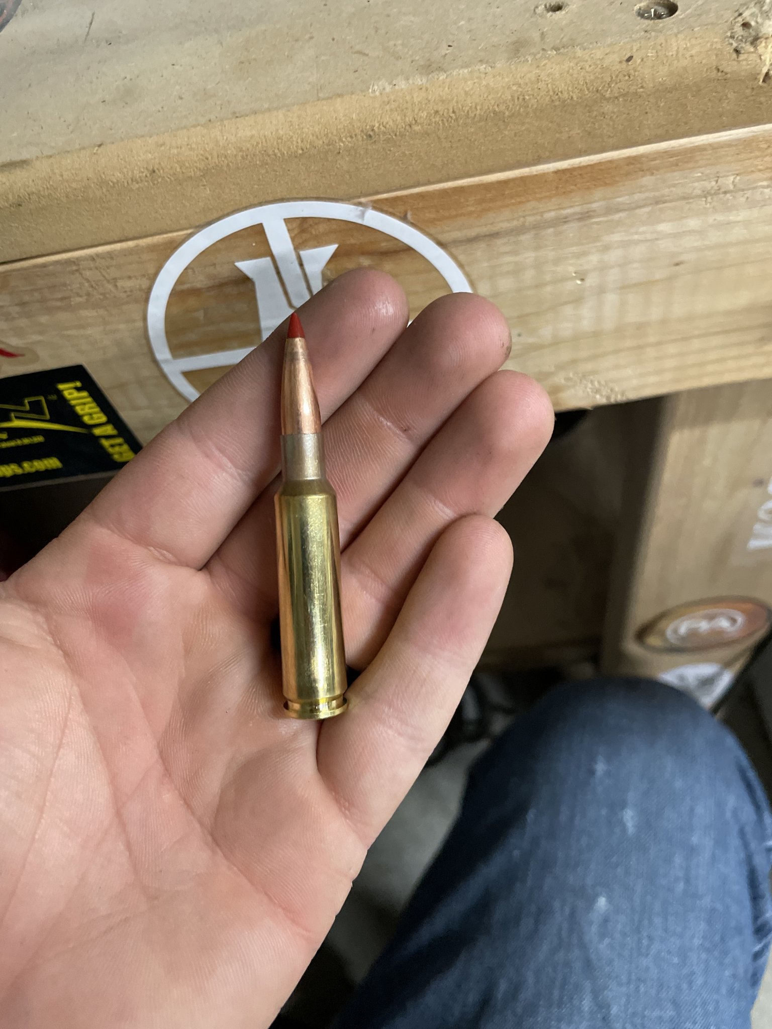

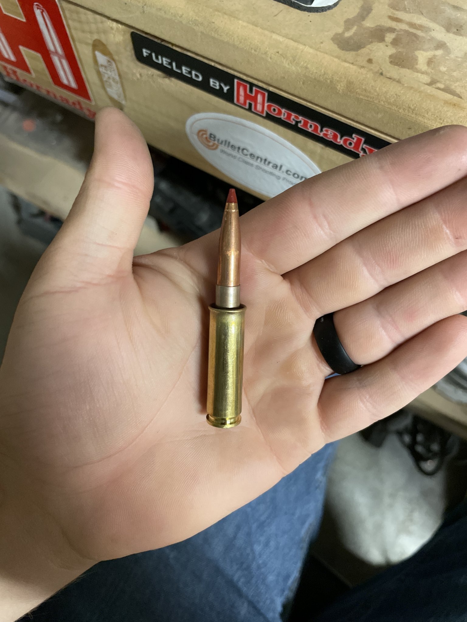

Has anyone had problems with the hornady 7 SAW dies and a forester coax? I seem to be able to seat the bullet just fine on a dummy case (most of the time). The second I put powder in it it crushes the case (only at 40 grains of Varget so it shouldn’t be anything if a crazy compressed load). Set the die up the way I do every time. Factory case, lower the arm, adjust the die until it touches case mouth and back it off one turn. Set micrometer die from there.
I'm curious about the ring near the meplat and the blunted meplat, causes me the question the seating stem. How is the nk tension? I'm using the same seater and haven't had any issues.
Photo of a case with no powder for reference
took it apart last night and the seating Stem has some pretty heavy machining marks on it (I can catch a fingernail on some of them) so I think it was causing it to bind up. That coupled with not enough lube I think. If I work the press slowly down in increments (down up down up) I can seat fine. It only does this on single passes. Going to get a new stem and make sure I lube more. Neck tension doesn’t seem to be the issue as I can seat them if I go slow. Being new alpha brass I honestly just didn’t run it through the sizing die (.311 bushing), but I should have. Next batch I will definitely be doing so.
I use a .308 bushing and then through a 0025” undersize mandrel

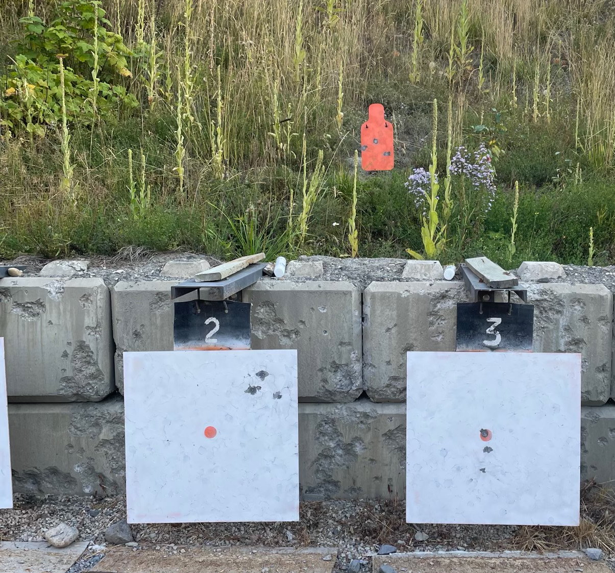

Took my lightweight 7SAW to 1000yards, my buddy on the left was shooting a 7-6.5PRC with 180s. I was shooting my 162 ELD-Ms out of a 22in Bartlein barrel at 2760 fps. Brand new brass, not fireformed yet.
Almost had a sub 0.5 moa group at 1000 yards but I got too excited after the first two and I think I might have screwed the last one ... still a remarkable performance of the little 7SAW out of a 10lbs rifle with a lightweight Manners LRH stock.

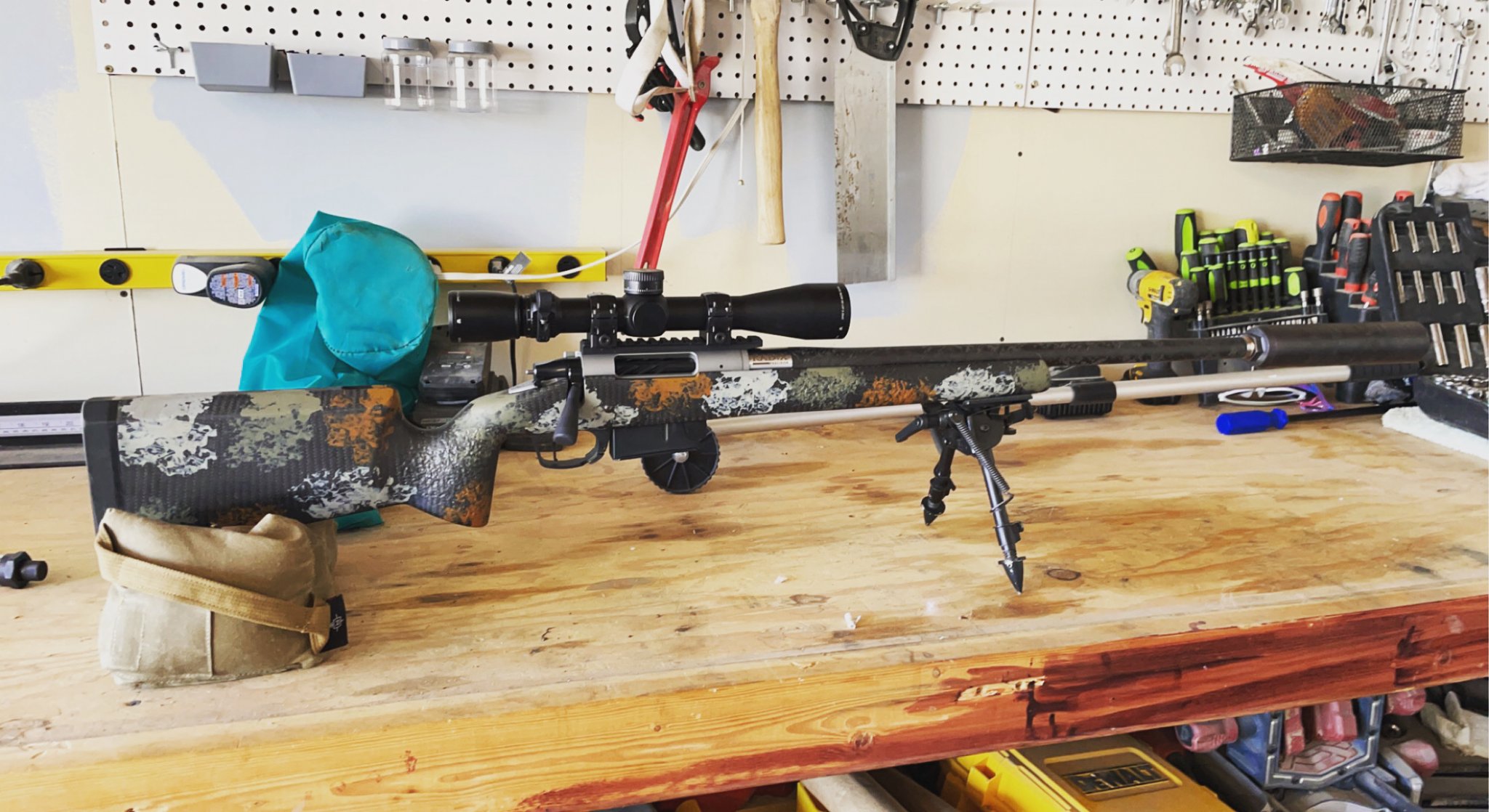

Originally I wanted to do a less than 9lbs build but I just love the Leica PRS 5-30x56 that I decided I’ll leave it on this year since even though it’s a good 37oz, it’s still fairly short and doesn’t affect the balance at all.

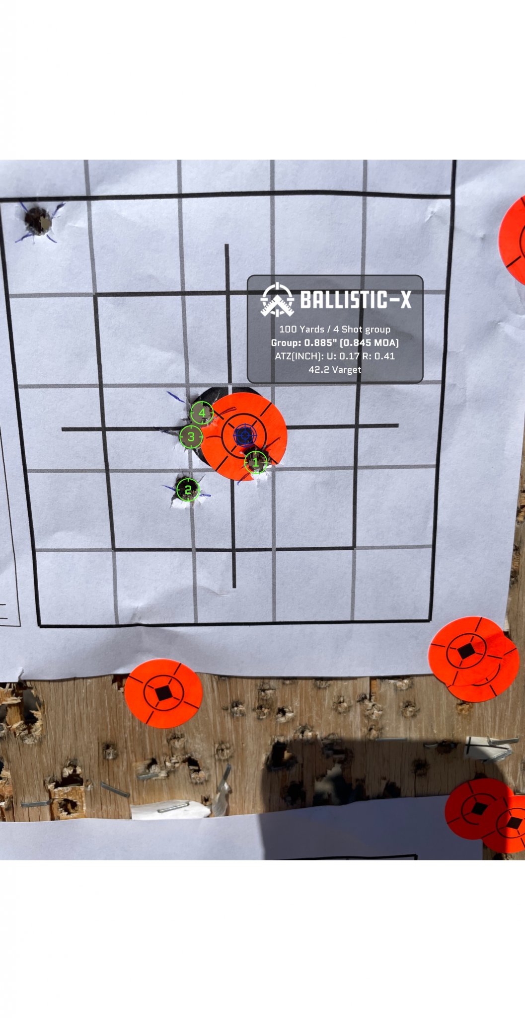

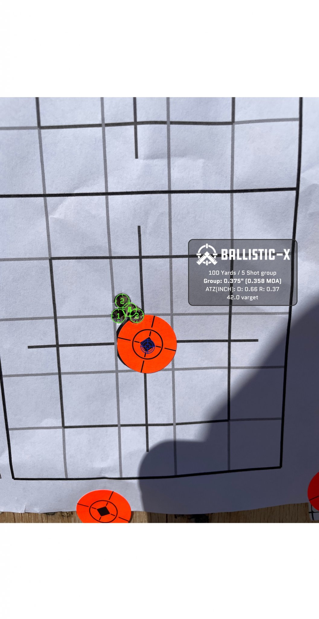

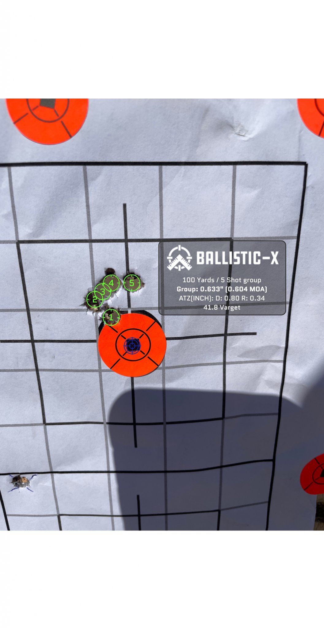

Did a bit more development today now that my barrel has sped up a bit (this 22” proof is one of the faster ones I’ve seen).
Just did 5 shot velocity strings and 5 shot groups (minus the one group with 4, I wasn’t paying attention to where my elevation was dialed on shot 1).
Alpha brass
162 eldx at 2.945
Varget
Cci 450 magnum small rifle primers
41.8
  1. 2802
  2. 2794
  3. 2795
  4. 2805
  5. 2789
  6. SD= 6.4
  7. ES= 16
42.0
  1. 2820
  2. 2806
  3. 2804
  4. 2794
  5. 2812
  6. SD= 9.6
  7. ES= 26
42.2
  1. 2812
  2. 2818
  3. 2809
  4. 2824
  5. 2812
  6. SD 6.0
  7. ES 15
Everything grouped sub .9 inches, however 42 by far produced the best grouping even with the highest SD/ES.
Still not seeing any pressure signs aside from some ejector swipe.
May try to work up a bit higher. 26 ES is a bit higher than I’d like.

I bet you that the first round at 2820 is the one that cause that higher SD/ES and if you were to do more testing , you’d eventually see that it was the right node. I’d definitely stay with the more accurate one at 42.0
I
i am probably going to load some
More of them up at the 42 mark as I tend to agree. Im just using a charge master lite, so my scale isn’t perfect weight wise all the time. Im just happy to break 2800 on a 22” barrel.
Reactions: hseII
