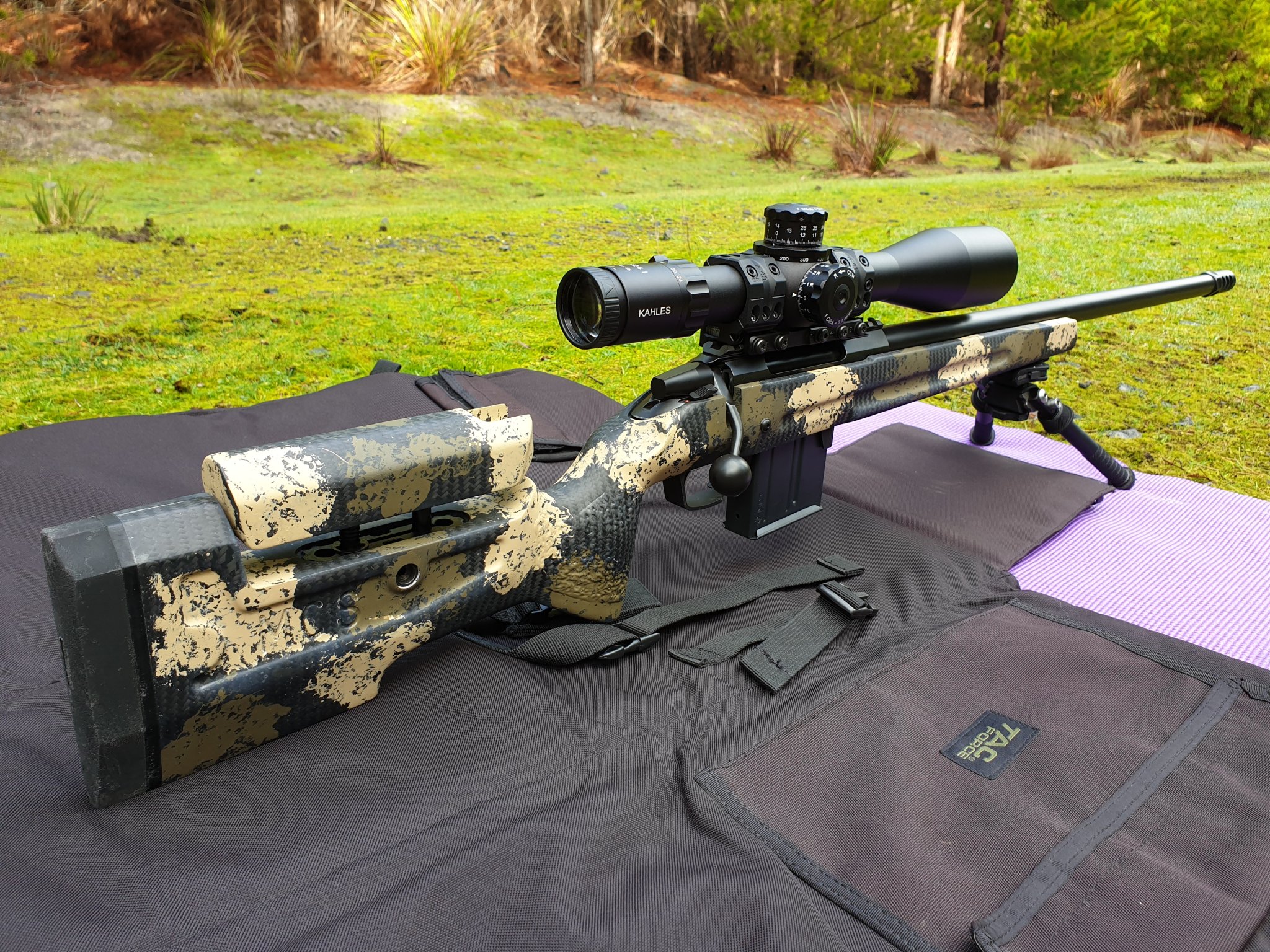

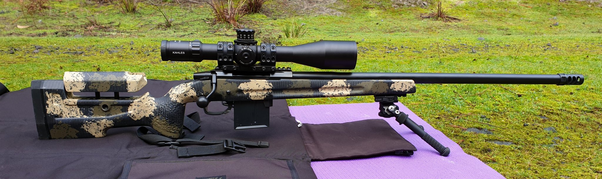

Went out and got some data on the new gun today. Shot the carbon barrel in with 70 rounds at 43.5gr of Reloader 16 with the 162 ELDs. Found a load that shoots sub-half MOA between both rifles as well, so have settled on that as the go to load for now. Both rifles have a node at 45.8gr, with average velocities of 2829fps, and 2857 for the carbon and steel barrels, respectively. There is a node for the carbon barrel at 44.3gr as well. The carbon barrel hasn't sped up much yet though so I'll retest after another 50 rounds or so.
Specifics for the load is as follows:
Brass: Lapua .308 Palma SRP
Projectile: Hornady 162gr ELD-M
Powder: Reloader 16
Charge Weight: 45.8gr
COAL: 2.900"
Barrel Lengths: 26"
Velocity/SD/ES/Barrel: 2857fps SD: 1.2 ES: 3 (Proof Research Medium Palma); 2829fps SD: 4.3 ES: 10 (Proof Research Carbon Sendero)

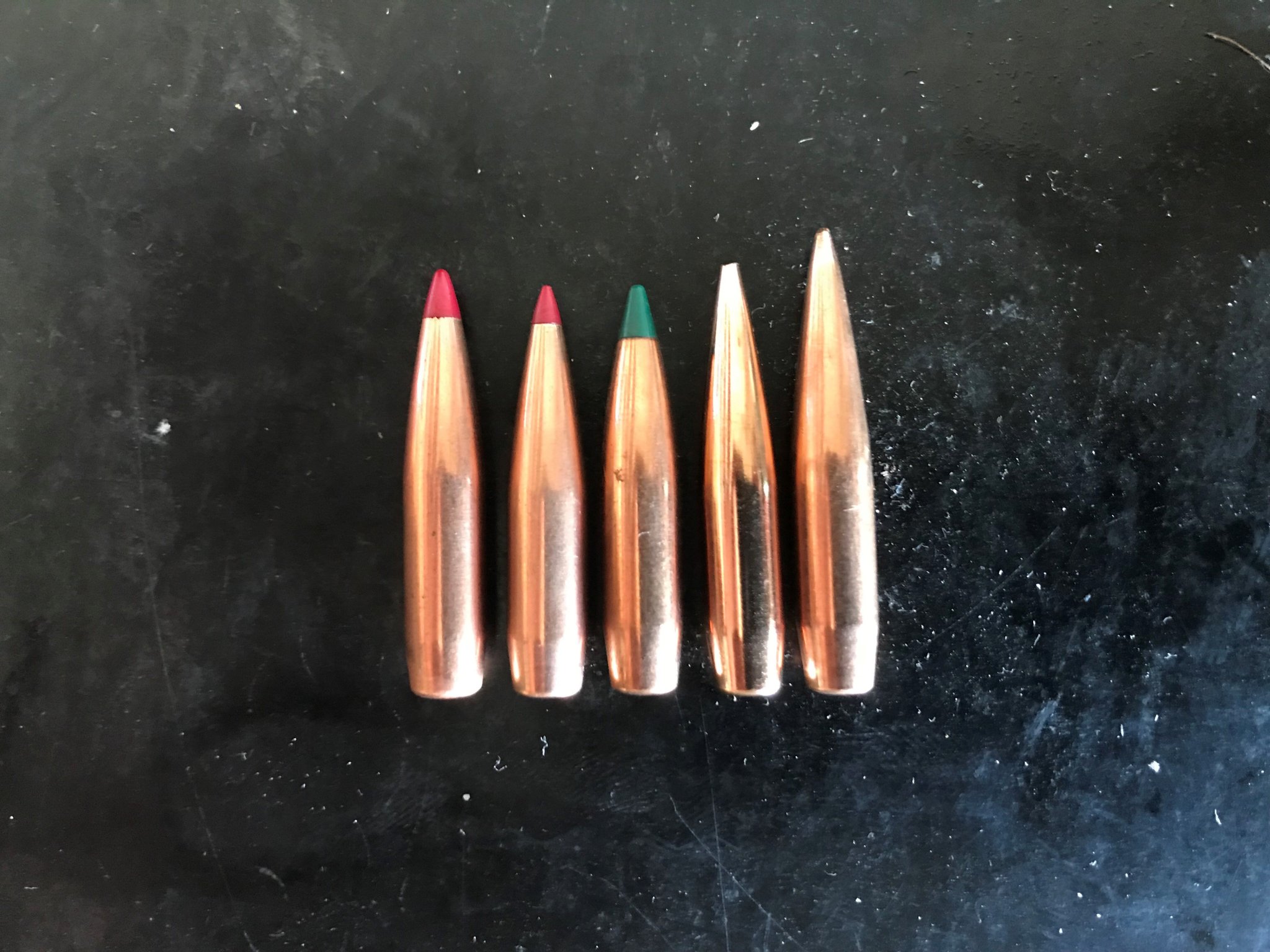

I've had some dramas with the Hornadys so am switching over to the Berger 175 Elite Hunters. If anyone's interested, here's a comparison of 162 ELD-X, 162 ELD-M, 160 TMK, 175 Elite Hunter and 183 SMK. I'll be using either 2000MR or Reloader 16 for the 175s.
7104253

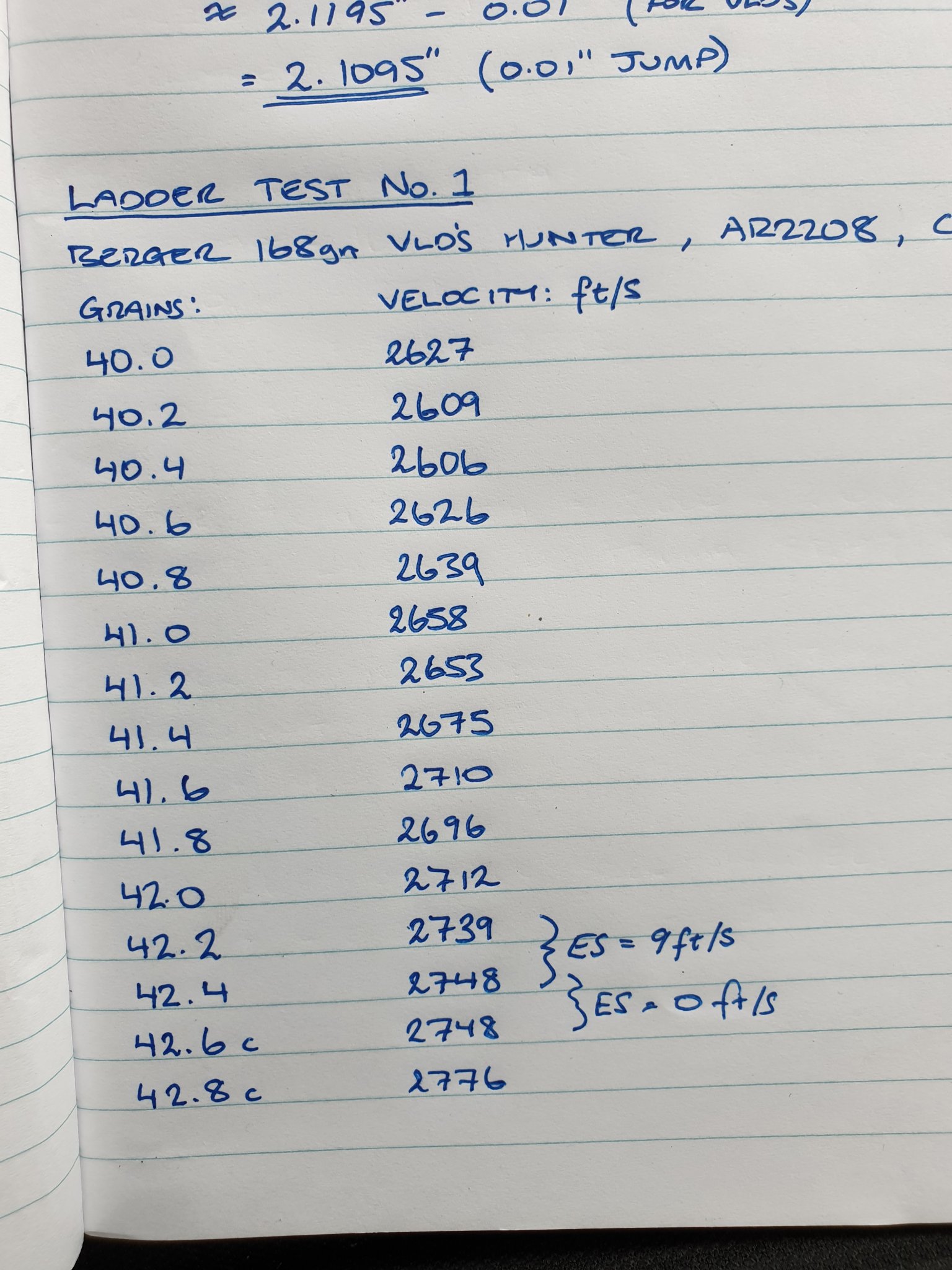

Hey guys.
Only just started playing with my SAW. It has the short throat chamber so I decided to try some Berger VLD 168gn Hunters as they have a short Base to Ogive.
Rifle is a Tikka T3 running a 26" Proof barrel, 8 twist. Manners carbon prs stock with mini chassis.
These results are with only around 50 rounds down the tube and during fire forming Lapua brass. Should hopefully see a jump in velocity once i shoot it more and use the formed cases. Accuracy has already been fantastic.
Powder - Varget/AR2208
Cases - Lapua Palma
Primers - CCI 450
Projectiles - Berger VLD Hunters 168gn
Ladder Test 1 - 0.01" off lands (2.1095" CBTO)
Ladder Mini Test - 0.005" off lands (2.1145" CBTO)
Thanks to Simia Del for your help (plus the barreled action ?)

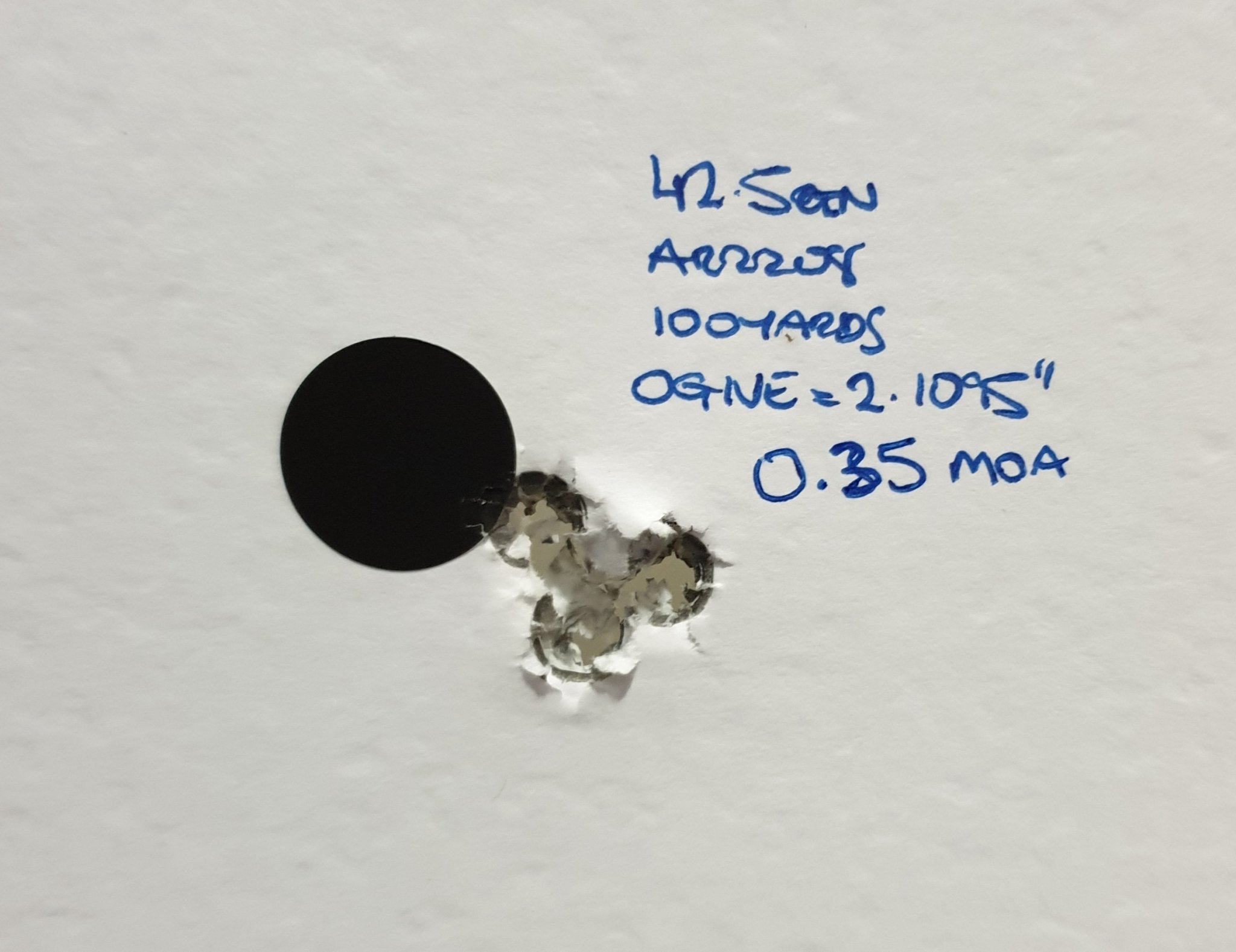

Hey guys.
Cases - Lapua Palma
Primers - CCI 450
View attachment 7134505View attachment 7134506
