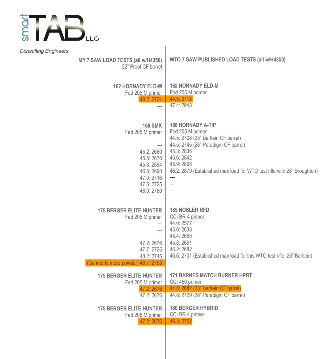

I need someone's wisdom that has some considerable time on their reloading table in the 7 SAW II. I have 350 rounds fired on my 7 SAW II chambered 22" Proof Cartoon barrel and I can't make velocity, OR find pressure (see chart). Whether its a 162gr Amax, or even crunching a 175gr Elite Hunter over 48.7grs of H4350, it won't get it done. No ejector swipes, no sticky bolt, no primer indicators, nothing.
See attached "my load vs. WTOs published loads" comparison. No where close. Im consistantly 180 - 250 fps slower with equivalent charges, or I'm comparable fps with consistently 2grs + over WTOs.
Reactions: winniedonkey
4" of barrel is 100fps and proof barrels are often slow. not surprised
try varget
Great, that explains everything, thanks...except when WTO tested a brand new, 23" Bartlein with 171gr pills , they were able to make the same velocity as me with 175gr pills with 3 gr less of the same powder in a "broke-in" barrel. Barrel length? He's already put that to bed; his tests of the 26" Paradigm CF barrel and the 23" Bartlein CF barrel resulted in a less than 2% velocity differential with the same powder charge with the same 171gr pills.
Anyone else?
Great, that explains everything, thanks...except when Clayton from WTO tested a brand new, 23" Bartlein with 171gr pills was able to make the same velocity as me with 175gr pills with nearly 3 gr less of the same powder in a "broke-in" barrel.
some barrels are fast and some slow. also unless they're exact same bullet speed wont always match with same charges due to shape, bearing length, and just specifics on individual barrels
Probably the difference between your 22" barrel and his 26" barrel. My Proof barrel in 7mm Saw is a tad slow at 24" as well. Might have a slow lot of powder as well.
Alright, thanks.
But my data with the 162gr ELD M has me pushing the same bullet, with the same powder, with the same primer, using the same brass at the same velocity as WTOs load development, but with 3.7 grains more power.
