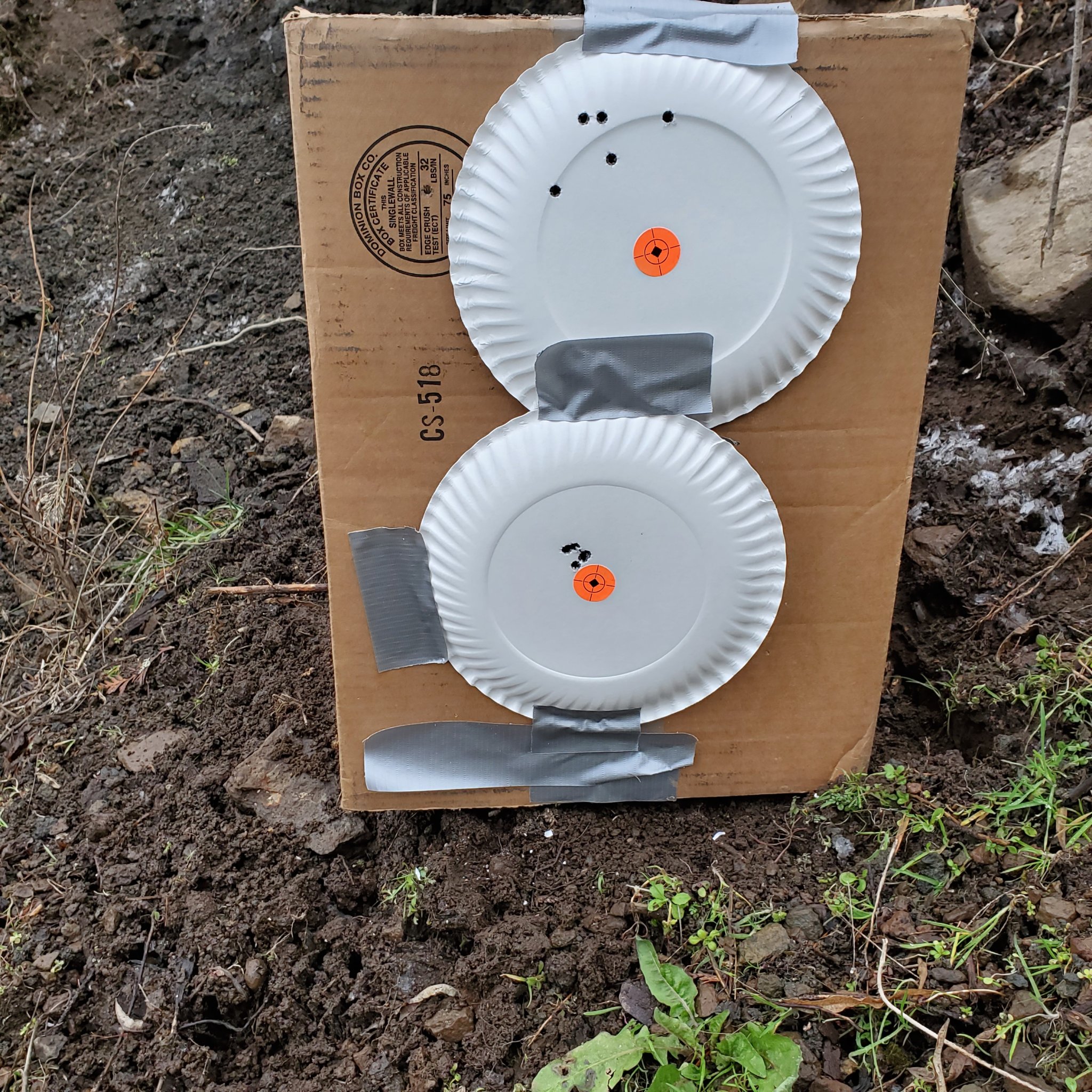

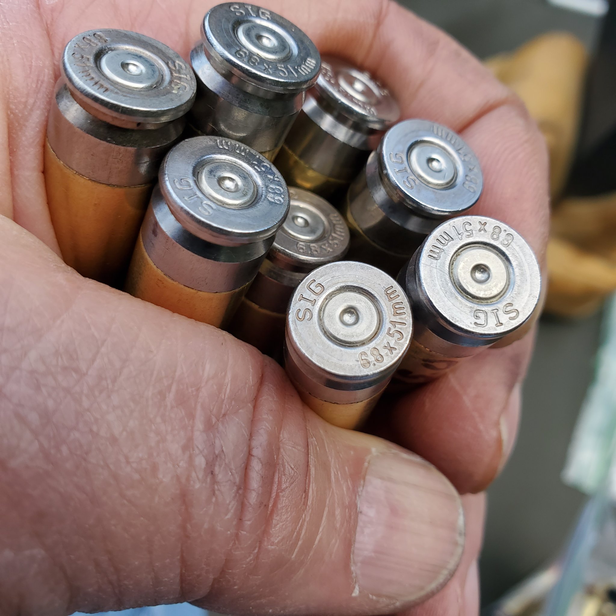

Pic two AR rifles, same caliber, shot on the same day with the same match ammo...one a standard AR barrel guarantees 1"- 3 shot groups...well 3 of the 5 in the 2.5" group are close to 1" ...so it kinda qualifies.
But the lower .5" 5 shot was the first 5 shots out of the new premium barrel, costing more than twice as much.
The next pic are the 80,000 psi hybrid 8.6 cases you have to make to get them but they are available. These are run at 65,000 psi so the data could apply to any 6.5 twist bolt gun in 8.6, if worked up to, or stop when your chamber doesn't handle the pressure in Alpha brass.

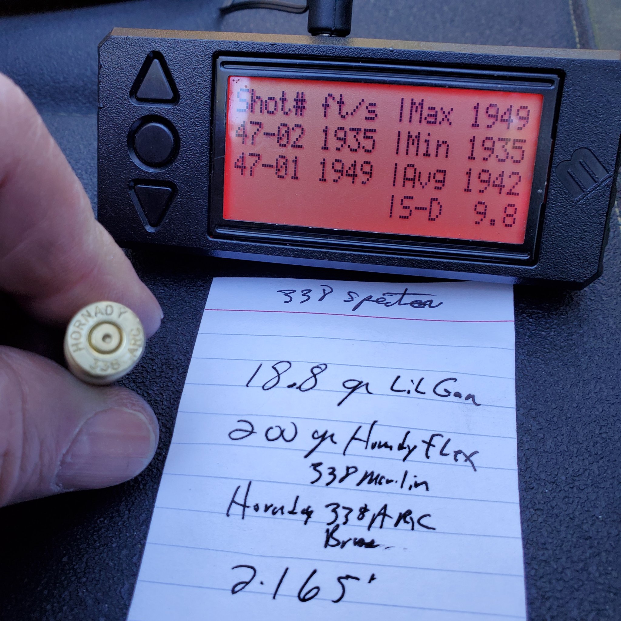

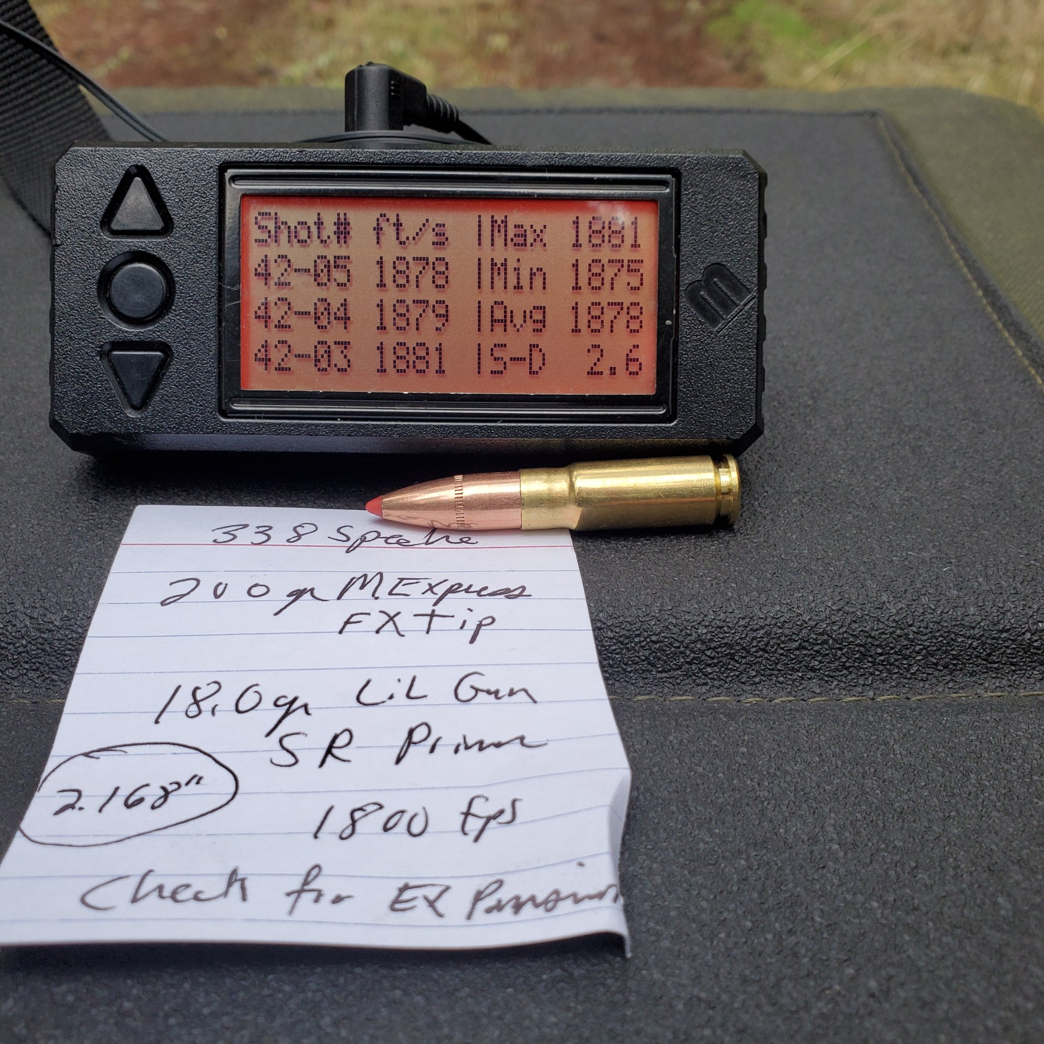

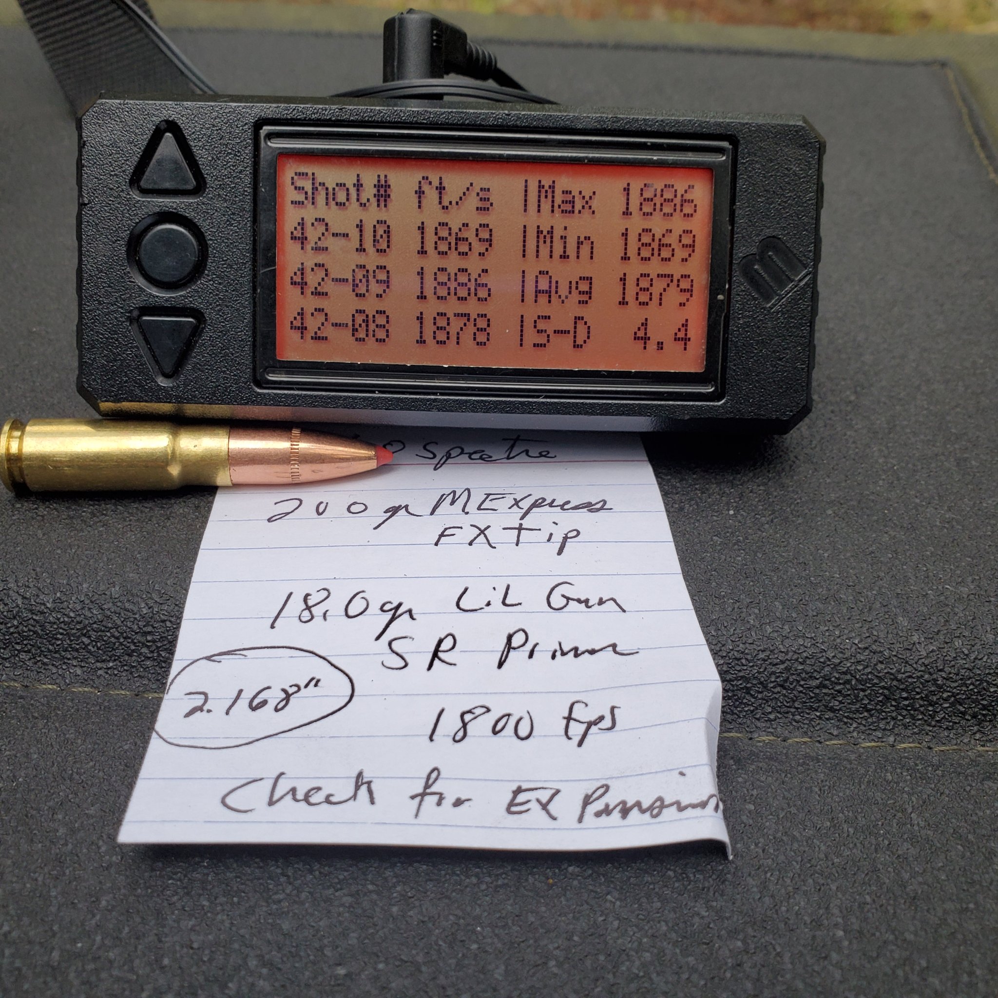

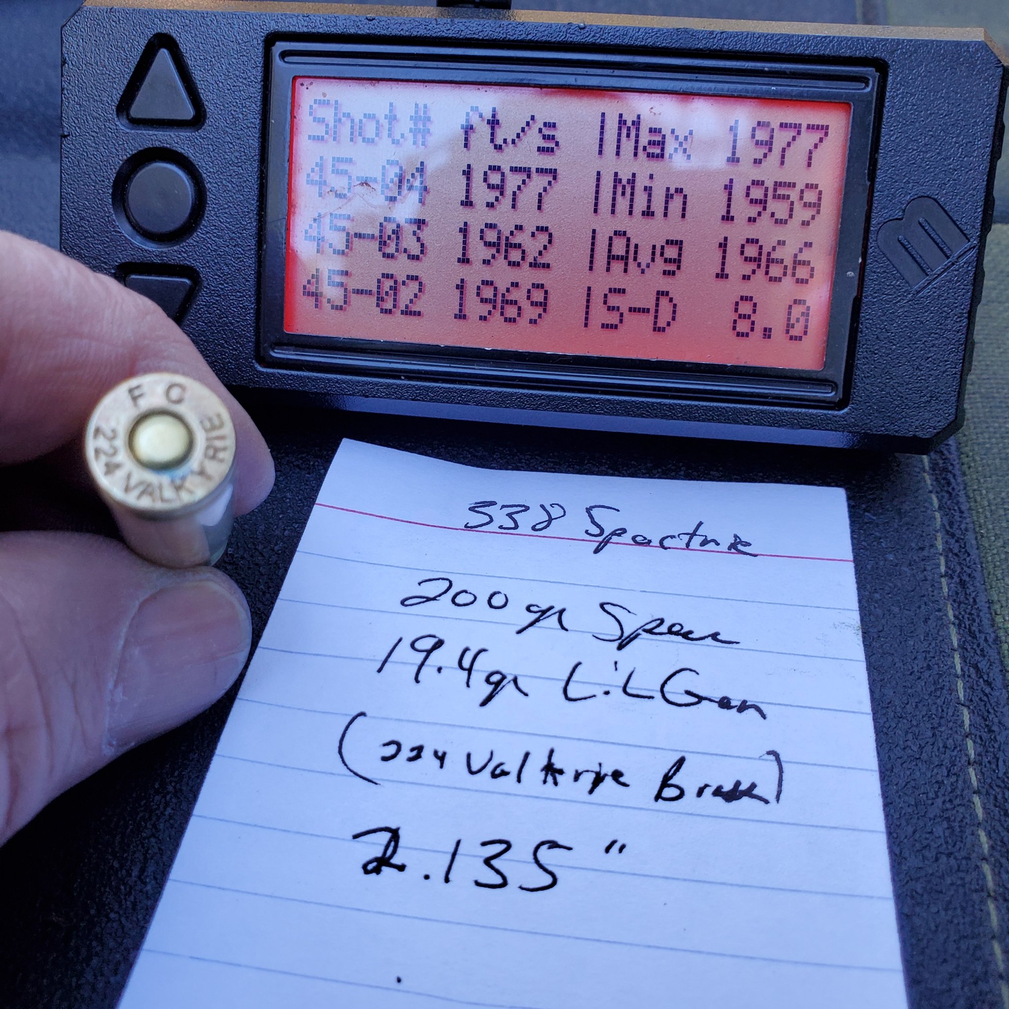

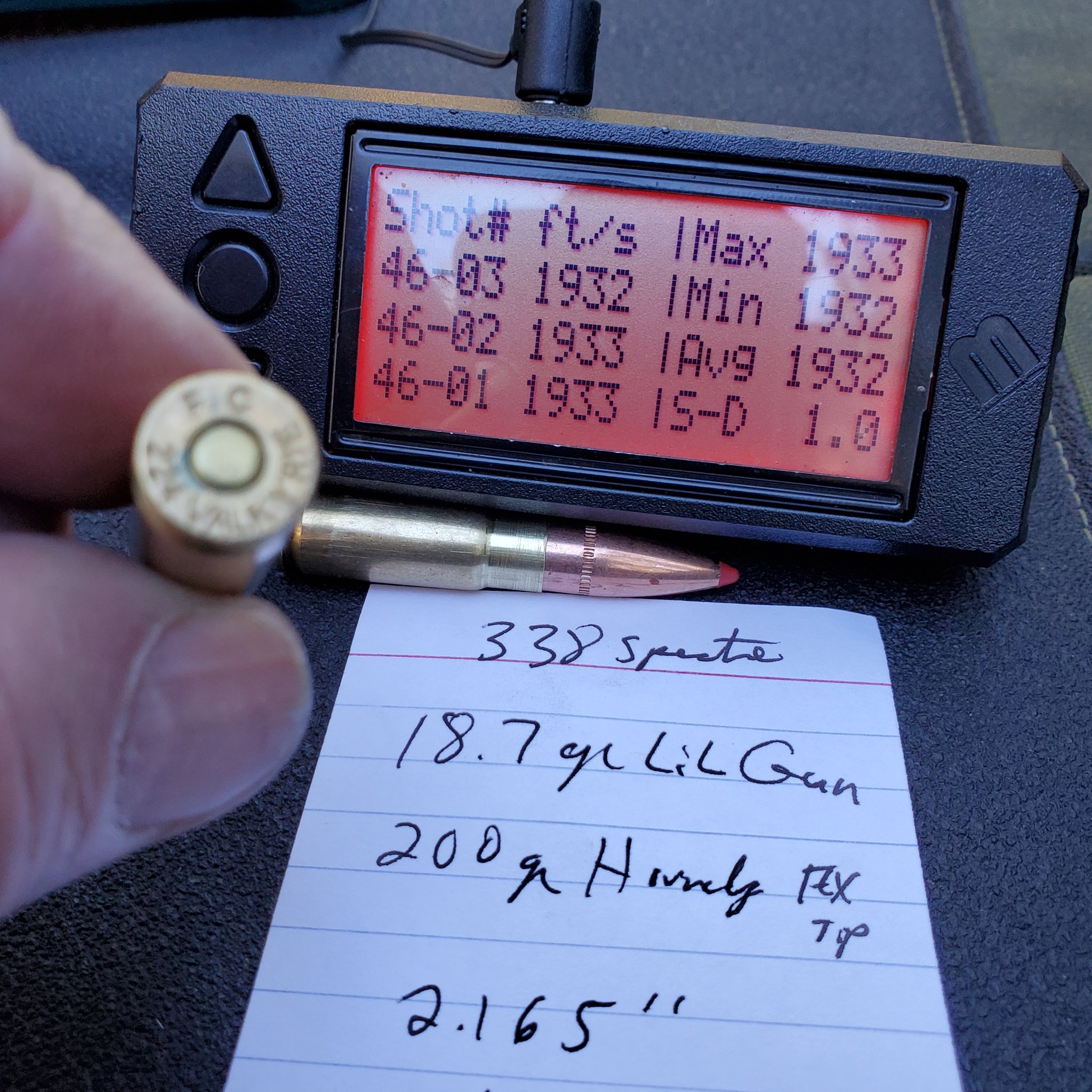

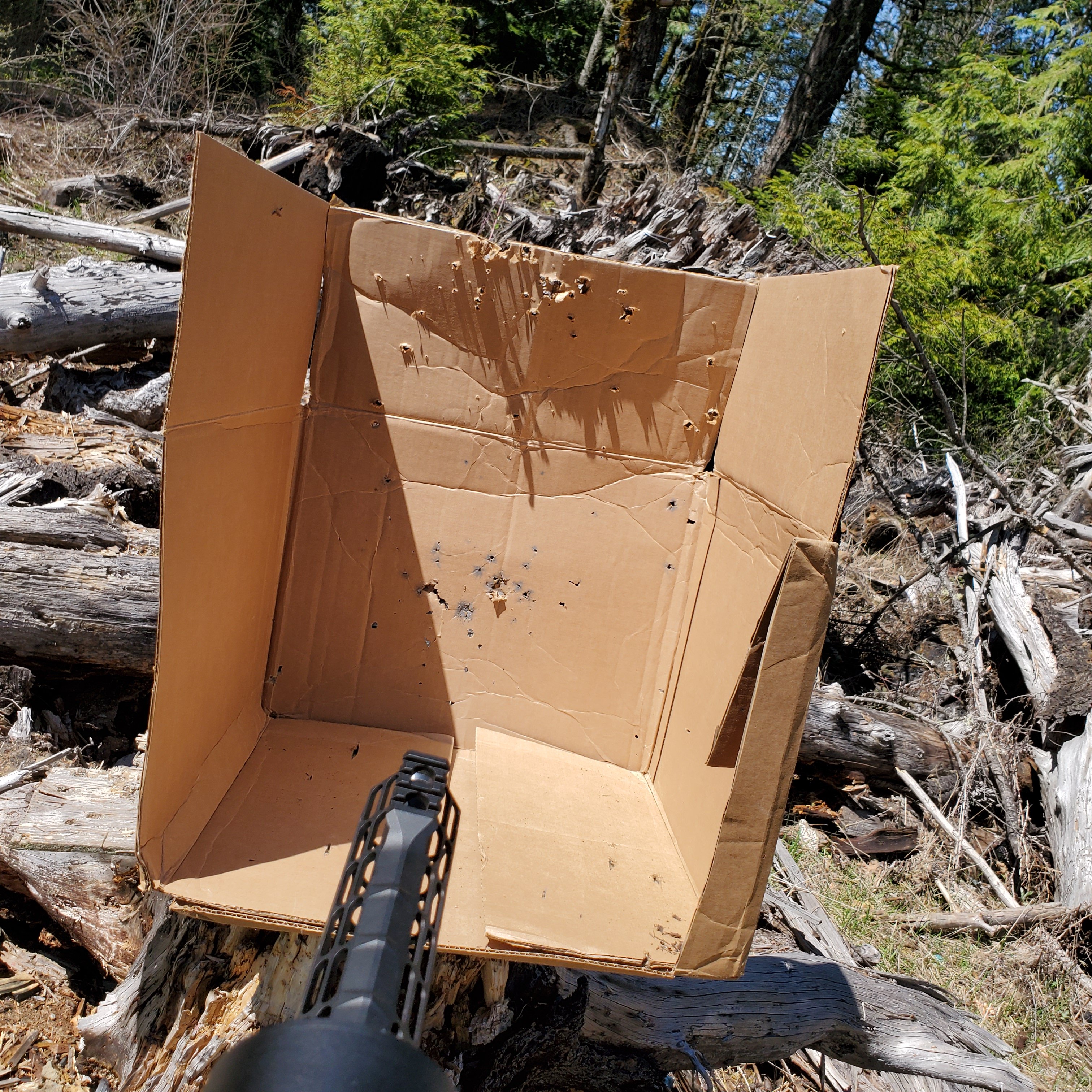

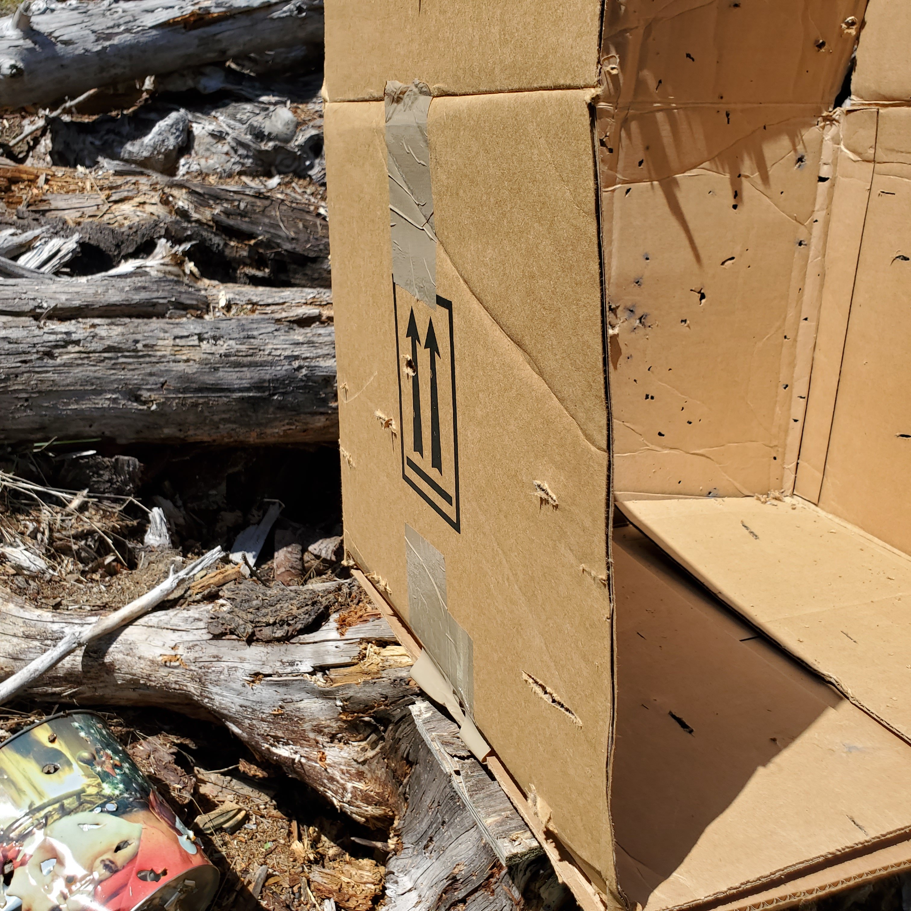

Just got back from shooting today.
Shooting the 338 200 gr Hornaday Flex tip for 338 Marlin.
It seems to be devastating on 2 liters down to at least 1700, but didn't recover any bullet.
Shot from the 338 Spectre 16" barrel AR 15.
The cases are new formed, nothing is weighed...just loaded on a progressive press... check out the low velocity S/D out of an AR 15.
This is mechanics of loading, case capacity is excellent, high fill ratio, powder burned 100% in 16" barrel at higher pressures where it's designed to burn. LilGun is gettin it done here. Plus excellent accuracy.
No messing with components, just load and shoot.
But this 338 Hornady 200 gr flex tip might give supersonic 8.6 blkout with a 6.5 twist a fairly cheap bullet to consider when extending their hunting range.

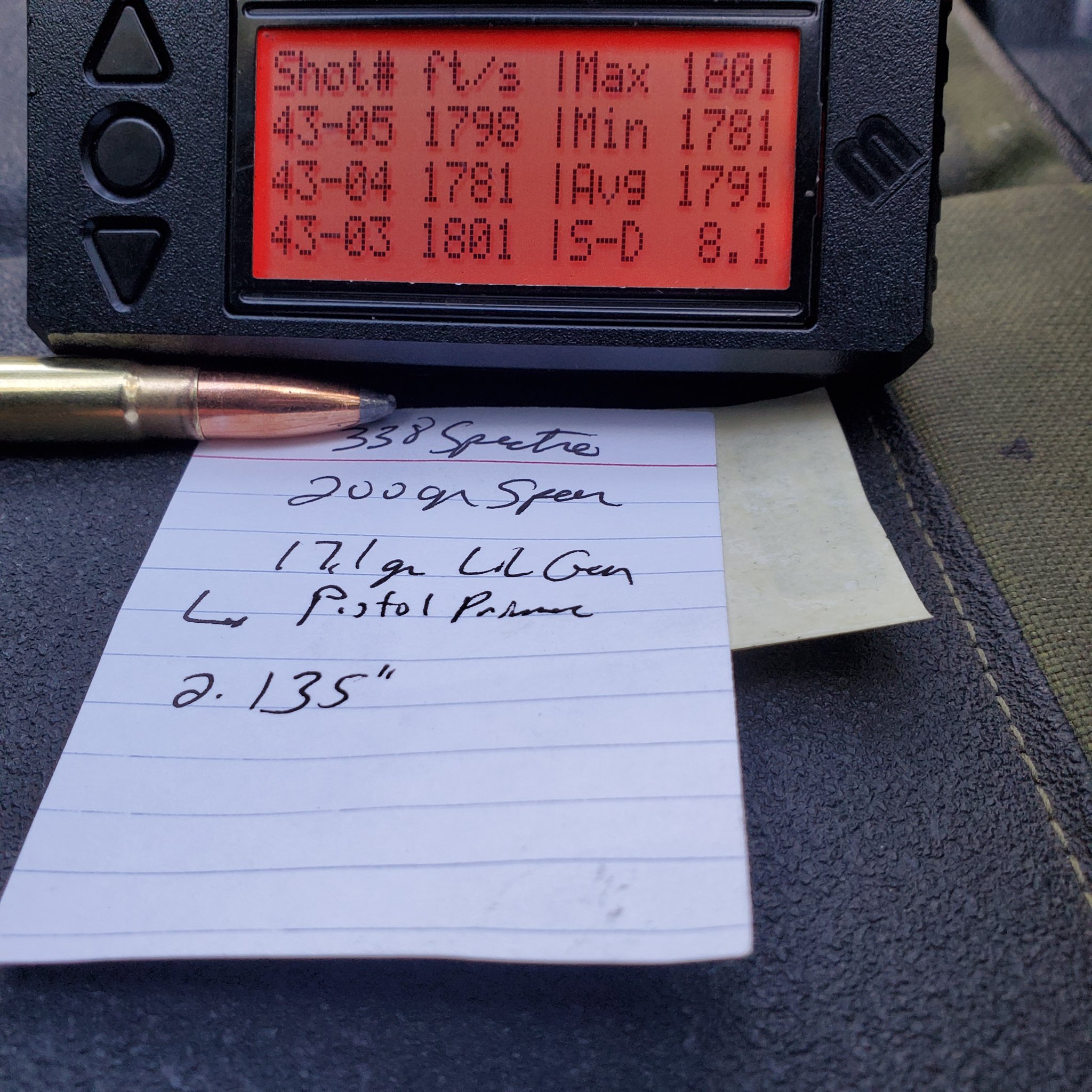

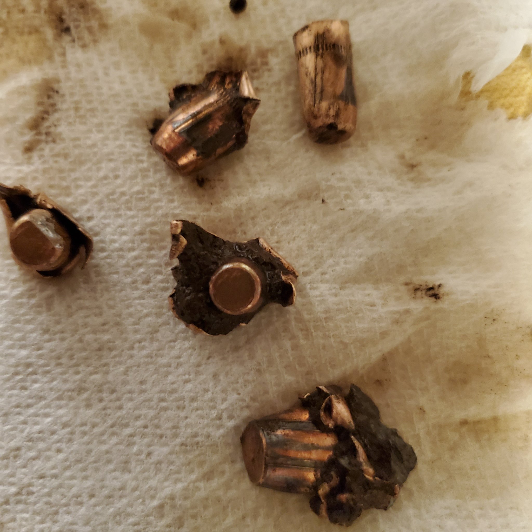

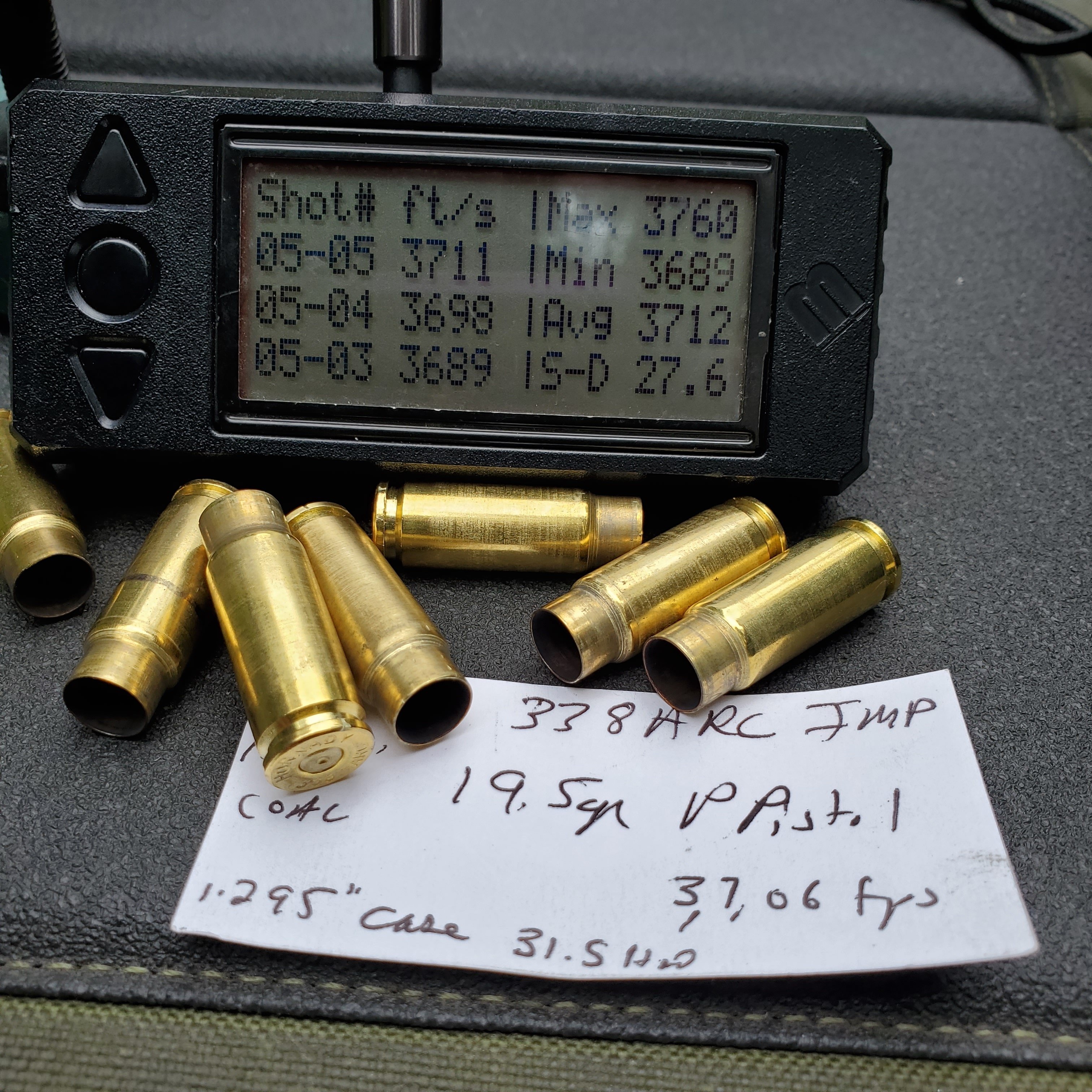

More experimentation with the 338 Spectre today.
Actually cut down some 224 Valkyrie and modified some 338 ARC for tougher brass cases, if possible.
It worked they are able to take higher pressures.
The Hornady 200 gr Marlin 338 flex tip was employed as well as Speer 200 gr hot core bullets.
The 200 gr Marlin lever action bullet at 1930 fps seemed to mushroom up, and break up and work as expected for a soft point, but the Speer at 1966 fps did too.
For 6.5 Twist in 8.6 Blk for those interested in cheap accurate super hunting bullets to try.

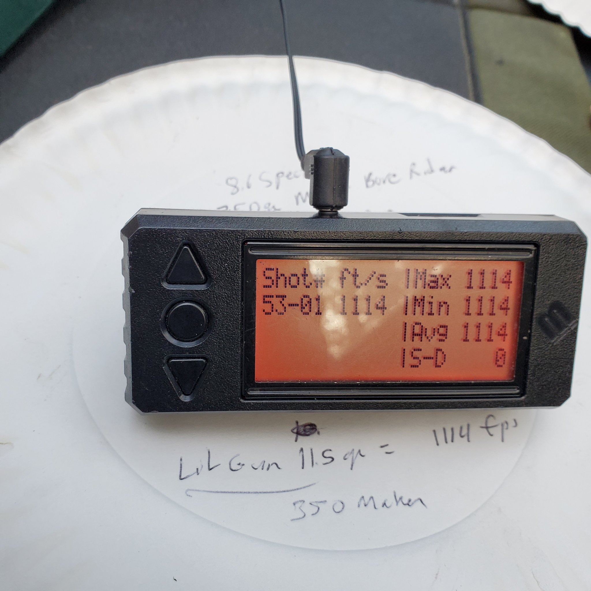

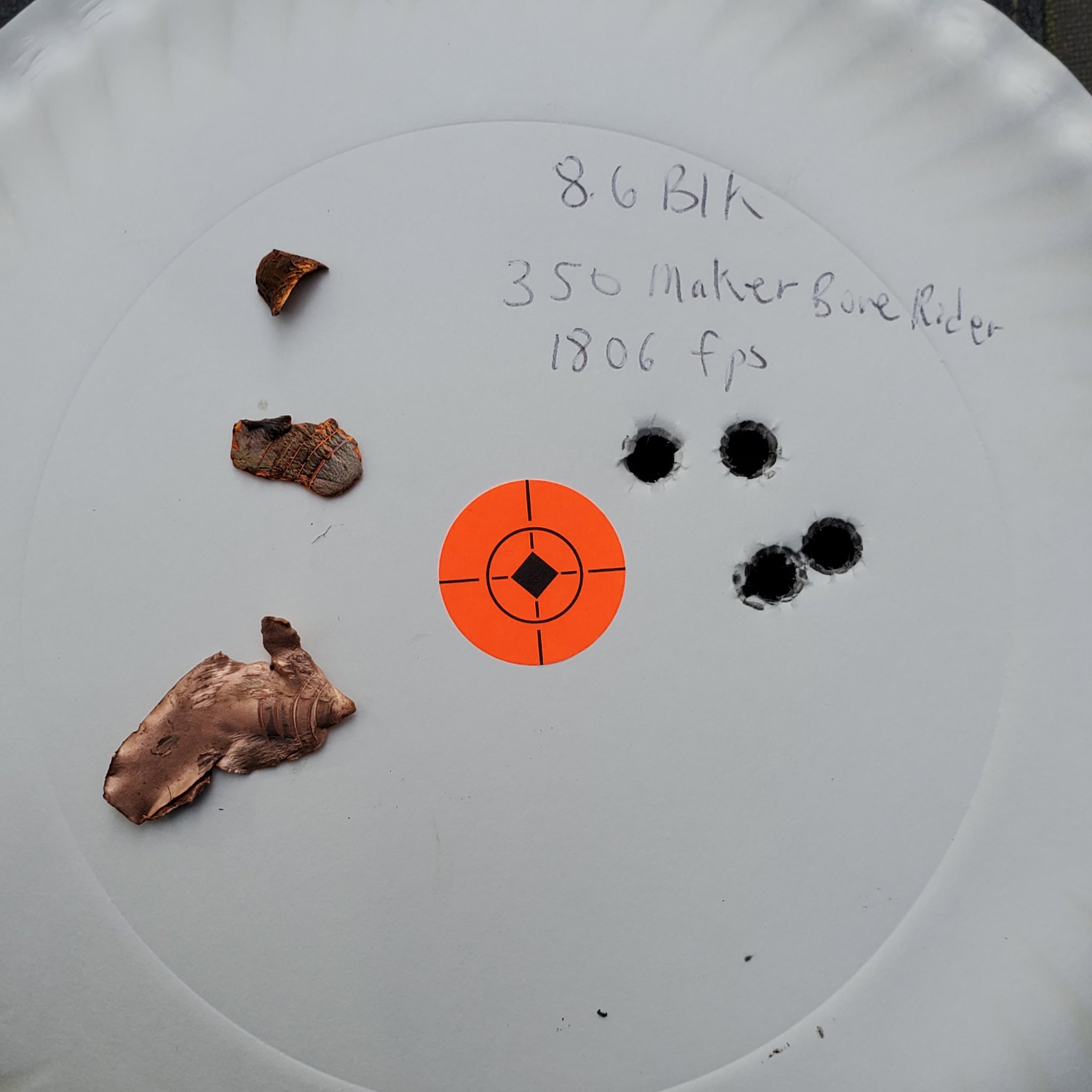

During the 338 Spectre/ 350 / and 375 Spectre /400 gr experiments. I decided that making the .338 350 gr Maker bullets bore riders by turning the bullet down to about .3295" just before the driving band. This would allow the bullet to stick down the bore farther, making more space for powders in the tiny 338 Spectre.
So why not stick the same 350 gr bullet out and load it in the 8.6 blackout, as a high velocity experiment.

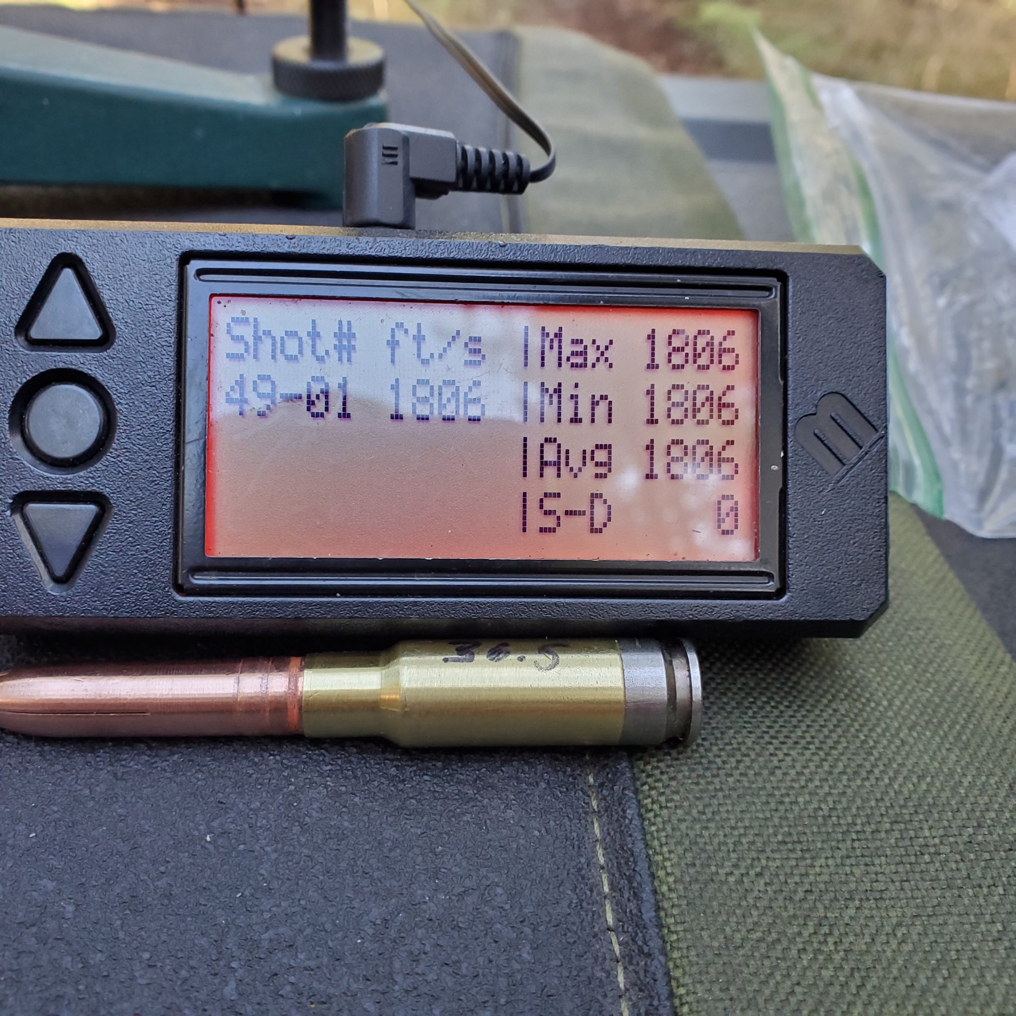

FOR 6.5 TWIST ONLY
3 twist limited to 1050 fps.
So I got 1806 fps with the 350 Maker on the 6.5 twist.
That's aprox 2530 ft/lbs compared to a 3 twist aprox 830 ft/ lbs. Because of its velocity limitations of the 3 twist with these bullets.
Interesting to see what they would do to a hog at 1800 fps...all I found was copper fragments around the target. They would be deadly way out there before hitting 800 fps which is likely the lower end velocity for expansion.
Accuracy was okay, for a cold foggy day, those are some of the bullet fragments found laying around.

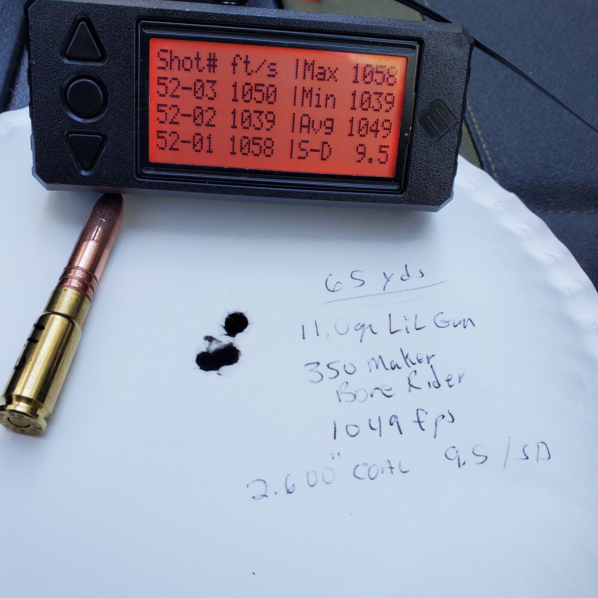

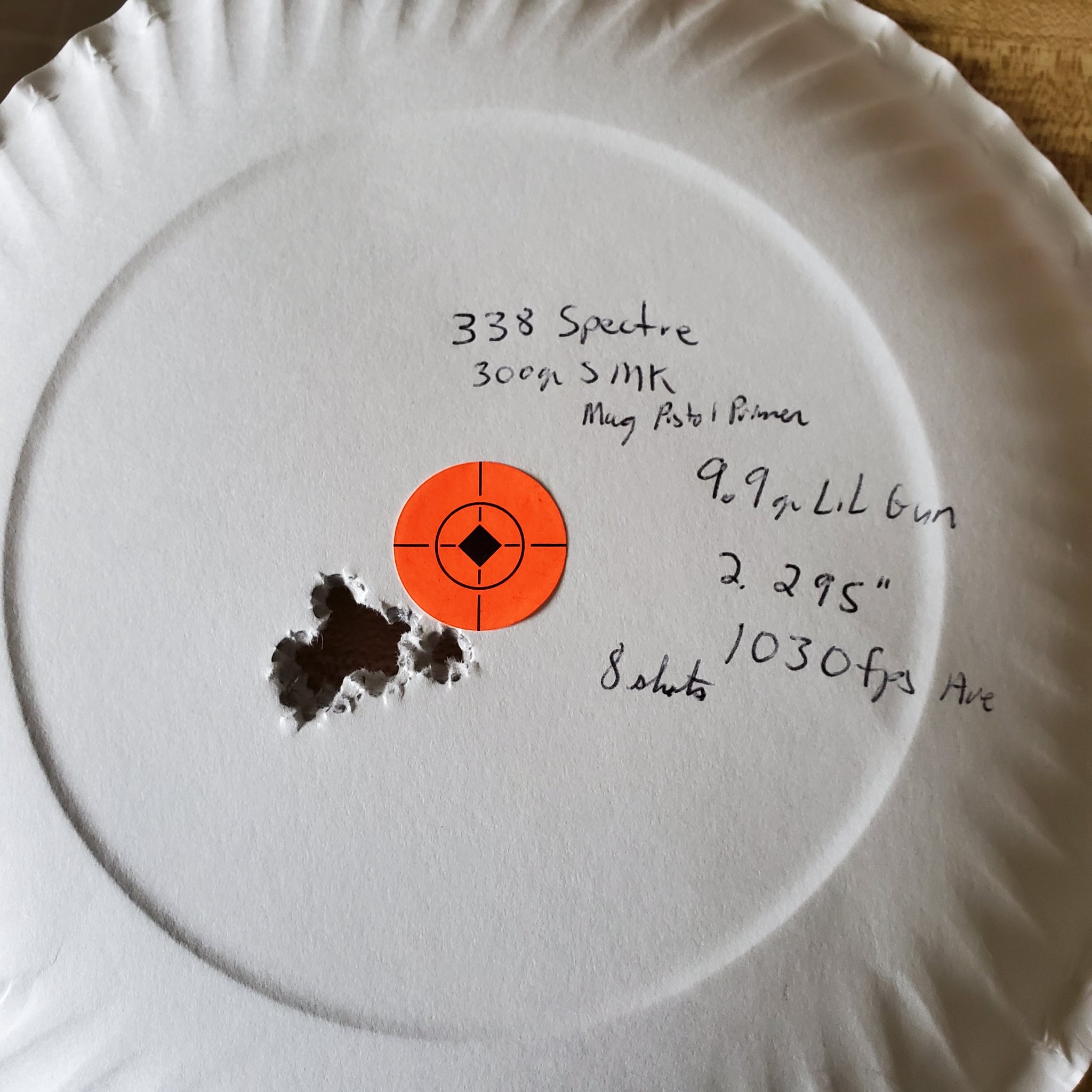

Here is the real reason for the "350 gr Maker bore rider bullet", was to add some caee capacity to the 338 Spectre cartridge,
Because he was shooting a bolt gun and didn't care about AR 15 mag length.
So it only too 3 grains off the bullet but allowed the 350 gr to be seated out to 2.6" adding case capacity to the tiny 338 Spectre.
11.0 grs LilGun was the best at 1049 fps
10.5 grs of LilGun was good S/Ds but wasted too many getting on target, and the resulting 3 shot group was a little larger...
11.5 gr was top velocity load at 1114 fps probably too close to breaking the sound barrier.
This load data could be used in 338 ARC ...If the 8 twist will stablize the long 350 gr bullet, and one can seat it out to 2.600"
With out seating it out the top velocity was 873 with a few loads tried.
Just playing with it not hunting.

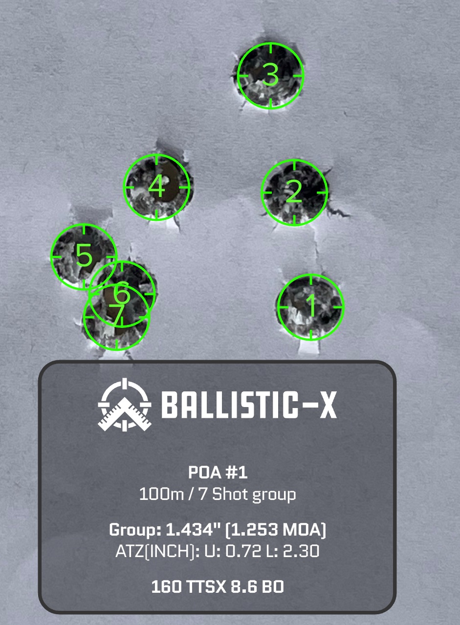

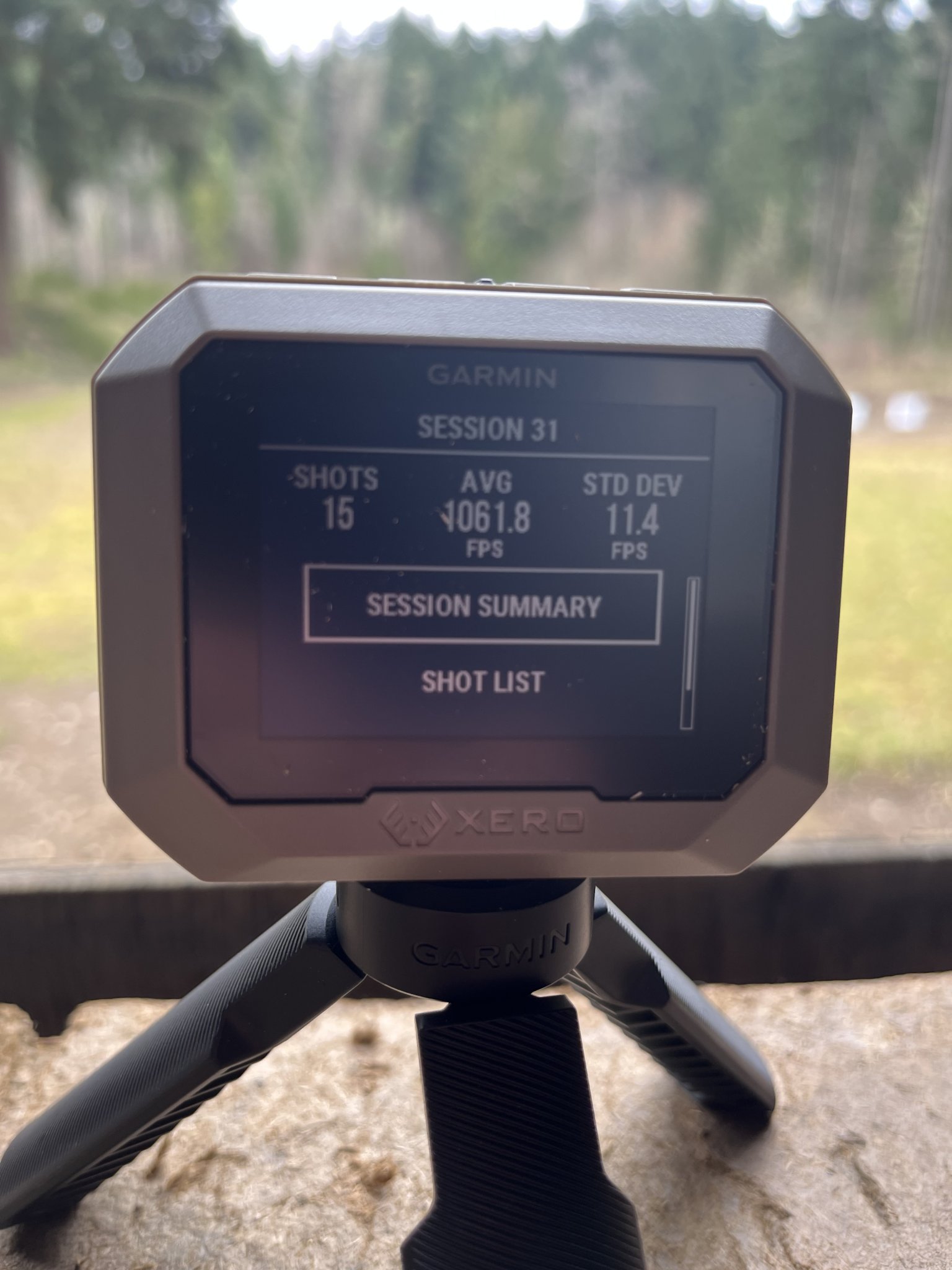

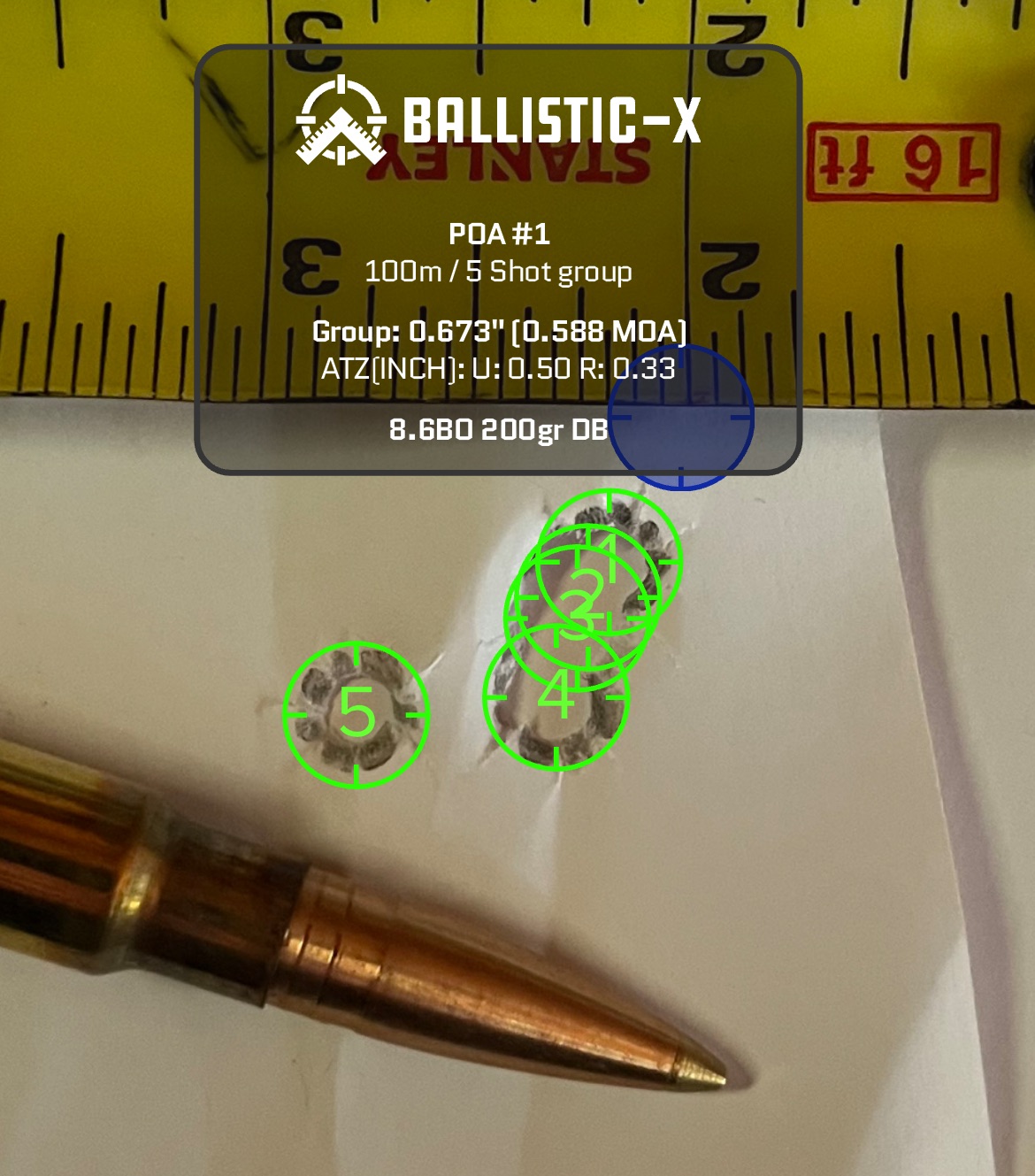

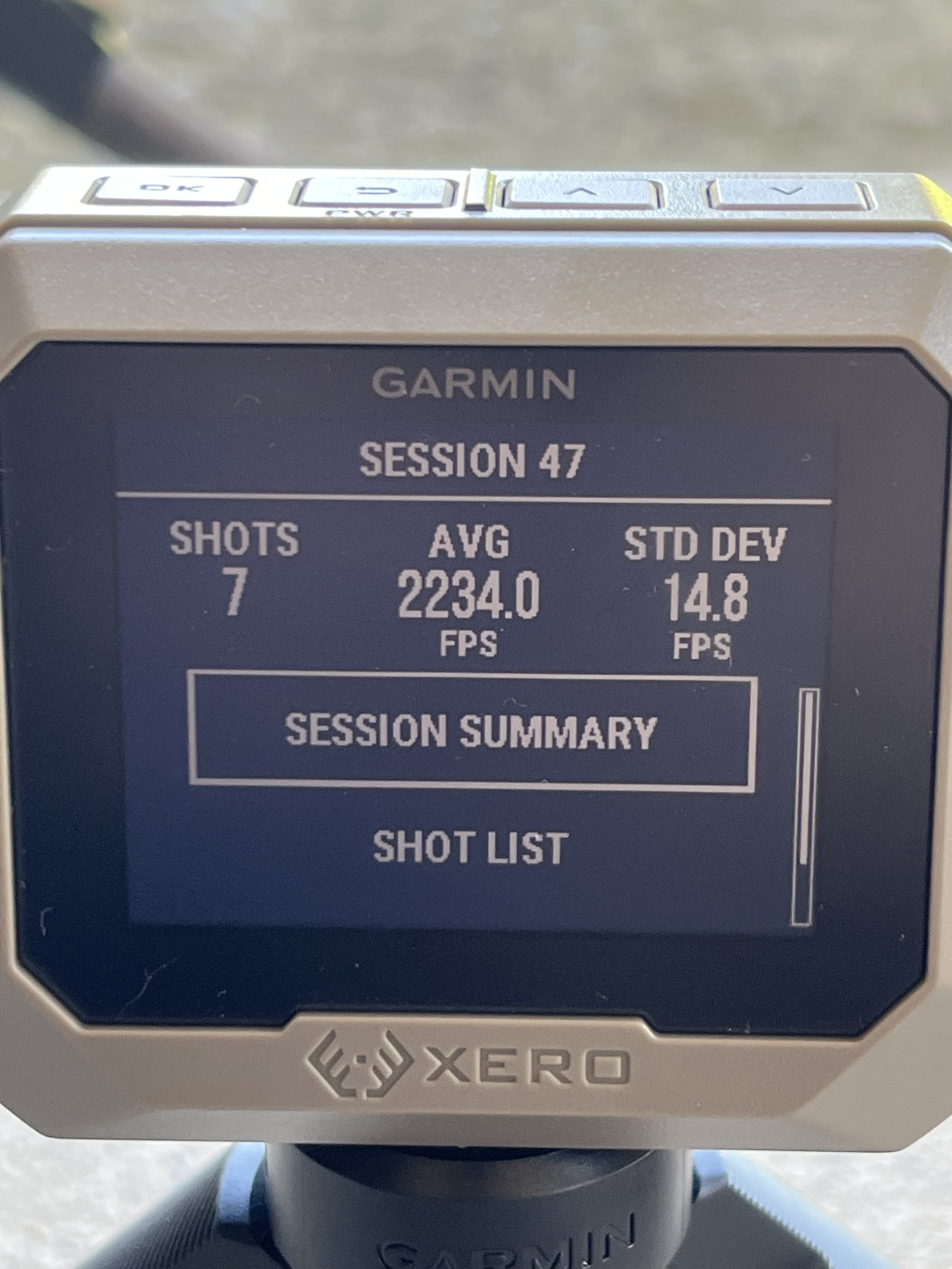

I performed additional load development that for me continues to show the 1:3 twist ain't bad for supers. This will probably end up being my 'do-it all' load for hunting under 300 yards. My preference will be to stay at around 44.0 gr of H335 to avoid temp. sensitivity issues near max load while still putting out a decent velocity from my 16" barrel.
With the high G1 ballistic coefficient, this load at 2450 fps muzzle velocity should be putting out ~1500 ft lbs and ~1900 fps at 300 yards (-18.5" of drop w/ 100 yd zero). It will begin tapering off to 1800 fps (~1300 ft lbs) almost bang on at 350 yards. For the 185 TTSX that means you should be able to achieve the minimum expansion velocity of 1800 fps comfortably with a 16 inch barrel at ranges the cartridge is designed for. Though I will say the drop gets pretty extreme past 300 yards according to the calculators, with -29.5" at 350. Pretty much after 300 yards you're looking at ~5" of drop for every 25 yards. Might as well bust out the compound bow at that point.... (kidding).
I was able to get this load shooting at just over an MOA with no bags, rests, or supports, just the bottom of the stock on the bench. I think in my gun with some more practice (patience) and my bags it could be a 1/2 MOA load.
I want to note as well for the 12" 1:3 twist folks out there that this is probably a great do it all hunting load for those shorter barrels as well. Out of a 12 inch, if you can achieve similar pressures, you could probably get around 2325 to 2350 fps and reach out to 250-300 yards comfortably with enough energy to hunt game.
Notes/Data:
Rifle
: Faxon FX7 Barreled Action 16" 8.6 BLK 1:3 Twist
Suppressor: SilencerCo 46 Hybrid Modular (full length) with .46 end cap
Chronograph: Magnetospeed v3
Powder: Hodgdon H335
Primer: Remington 9 1/2 M Magnum
Projectile: 185 gr. .338 Barnes TTSX (min. expansion vel. 1800 fps per Barnes, 0.432 G1 B.C)
Brass: Starline 8.6 Blackout (Bulk - 100)
Brass (Trim) OAL: 1.68"
COAL: 2.6535"
Case Capacity at COAL: 40.4 gr H2O

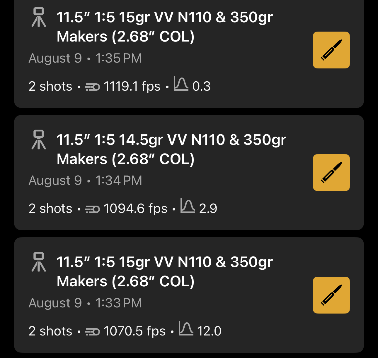

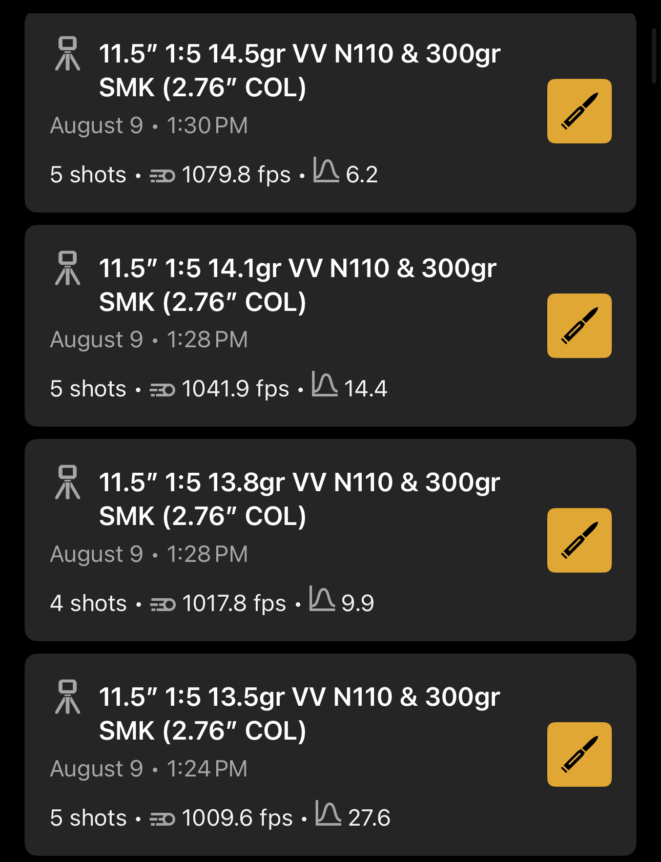

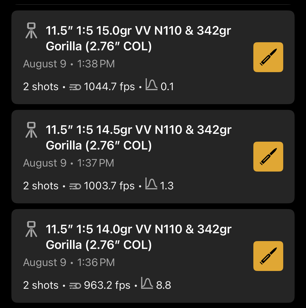

300 grain sub-load category: (12" bolt)
- Have been using Sierra 300 grain: (measured and filtered out 300.0 grain bullets for my testing)
---- Thought I settled on 17.1 grain AA1680; 2.755" COL which gave me about 1068 fps 1.5 MOA
---- Repeating this load opened up to 3 MOA which means I'm still missing something somewhere.. Maybe my impatience of waiting on the barrel to cool more between shots for 10 round re-tries.
- Finally got some new Berger 300 grains in and it's different: (12" bolt)
---- Same exact 17.1 grain AA1680 gets me 1,134 fps average!?? (clear and consistent 66 fps faster than just Sierra bullet)
- The bullets are 300 grain (tight tolerance I must say with longer profile than Sierra)
- BC may be better but does it matter with a bullet leaving the barrel for what the BC is?
- Trying to keep the same seating distance to the barrel lands as the Sierra forces you to seat much farther in if you want to stay within the max overall bullet length for 8.6
- Grouping was a bit more consistent and ok at about 2.5 MOA with this trial first attempt with Berger (all impacted without any 1:3 twist issue)
- Will need to work up a new load just for these Bergers to see how well they can really do. I hope they hold together since I've heard of at least one user that had one of these Bergers shatter and damage their barrel muzzle break (but all held well at faster than I wanted/expected them to go )
AR Test : 16" barrel
- Yea I got a cheaper AR upper for 8.6 that I don't use much since I expected a 12 month tax stamp wait vs it taking only 2 weeks for by Q-fix. Anyway, it beats up the expensive 8.6 brass and gives me about a 3 MOA with my bolt loads so it will stay less used out of the two.
- The clear difference is: sub-loads running about 1068 fps are all 70 fps slower out of the 16" barrel vs 12" (which most may expect)
- And sonics are about 60-70 fps faster in the 16" vs the 12", also as most may expect.

Updated results for 8.6 -- 300 grain Bergers and Barnes 160 Grain
Note: 12" Q-Fix bolt with no can installed for any main load development using Garmin Radar Chronograph..
(I have a shit ton of A1680 and H110 so my efforts kind of don't need to mess other powder types until I use up what I have a bit too much of already)

Old account got locked. There’s a lot of talk about the 1:3 not being accurate. I believe a lot of that has to do with barrel quality, Faxon being the worst based off of my research. The loads shown here are with a 1:3 twist barrel. 1st photo shows a 5 shot group with Discreet Ballistics 200 gr projectiles loaded with H335. The problem I’m running into with H335 is the pressure. I ladder tested up to 39 grains and started getting a sticky bolt at 39. I dropped back to 37.9 and got a sticky bolt every shot. I must’ve made an error in GRT initially because I thought 40gr of H335 was just within 25% of max load. Turns out 34 gr is probably where I need to be for traditional brass, but velocity won’t be at 2000 fps where I want it. Might be good with hybrid brass, I’ll work up and find out. I’m almost out of the 200gr projectiles. 2nd and 3rd photo shows a subsonic load I worked up using Discreet Ballistics 280gr seluous expander. 15 shots with varying seating depths yielded consistent MV using 13.8gr of N110. I most definitely pulled the flyer off to the right. Had it been a clean shot it would’ve landed on top of the group. Need to reshoot it without 400mg+ of caffeine. Looking at other powders, X-Terminator, A2230 and a VV powder seem to be less temperature sensitive based off of what I’ve read. Those powders look like they’d give similar velocities at equal/lower charge weights, just less pressure and sensitivity.
Reactions: wisconsinboy
I am currently loading for an 8" sbr, a 12" ar, and a 12" 700, all with 1/3 twist.
I am running the range of DB 280s, 285 gorilla's, 300 smks, 342 gorilla's, and 350 makers.
My most accurate are the 285s, 300s, and the 342.
I use Lilgun and H110 for my powders loaded to around 980 to 1075 fps depending on bullet.
I have gotten away from "moa accuracy" with these subs as the 8.6blk is not, nor never was designed to be, a "precision" rifle round.
For a solid hunting cartridge it is great.
I am getting accuracies of 1 to 1 1/2 inches at 75 yds from these loads and will eventually limit my choices to 2 sub bullets.
I load the 225gr CX with CFEBLK to 1850fps with sub inch accuracy out of the 12" 700.
I really like this round and if I still lived in Fla, it would most definitely be my hog hunter.
There is quite a bit of talking down about the 8.6 but if you don't push it to be what it was not designed to be, it is a great, accurate, short range, hunting/self defense round.
I truly pity the bad guy who is confronted with an 8.6 8" sbr loaded with 285gr or 342gr Gorilla bullets.
Reactions: Stugots

My point was that it’s capable of being precise with a good barrel and ammunition, if you need it to be. The faster twist barrel is just pickier than the slower twist rates.
Your experience with accuracy has been similar to mine, I have no issue grouping at 1 MOA or under with my 16" FX7.

2300+ fps is doable with a 160 projectile, 12” 6.5 twist barrel. Looks like BR2’s give a bump in velocity over the federal primers. Easy bolt lifts, no cratering or ejector swipes, primer edges appear to still have a round edge and aren’t completely flattened. I’ll post the load once I get it dialed in.
Update on the 160 load, looking for any insights for what I’m seeing. I loaded 3 cases with 4 charges of CFE BLK, BR2 primer, Alpha brass at a COL of 2.6” that looked promising.
Temp: 58 degrees F
35.2 - 2319, 2220, 2188 (big group)
35.5 - 2154, 2137, 2322 (.9 MOA)
36.5 - 2211, 2206, no read on first shot (big group)
36.7 - 2236, 2217, 2207 (.8 MOA)
I loaded 7 cases with 36.5 to see how it would shoot. 1.2 MOA with 14.8 SD. On GRT I changed the charge to 35 grains. The result reflects what I’m seeing with a MV of around 2230 FPS. In order to get closer to the 2400 fps target I’d have to add 1.5 grains which puts the pressure very close to maximum, about 7000 psi off.
Has anyone else had issues with CFE BLK being this erratic?
