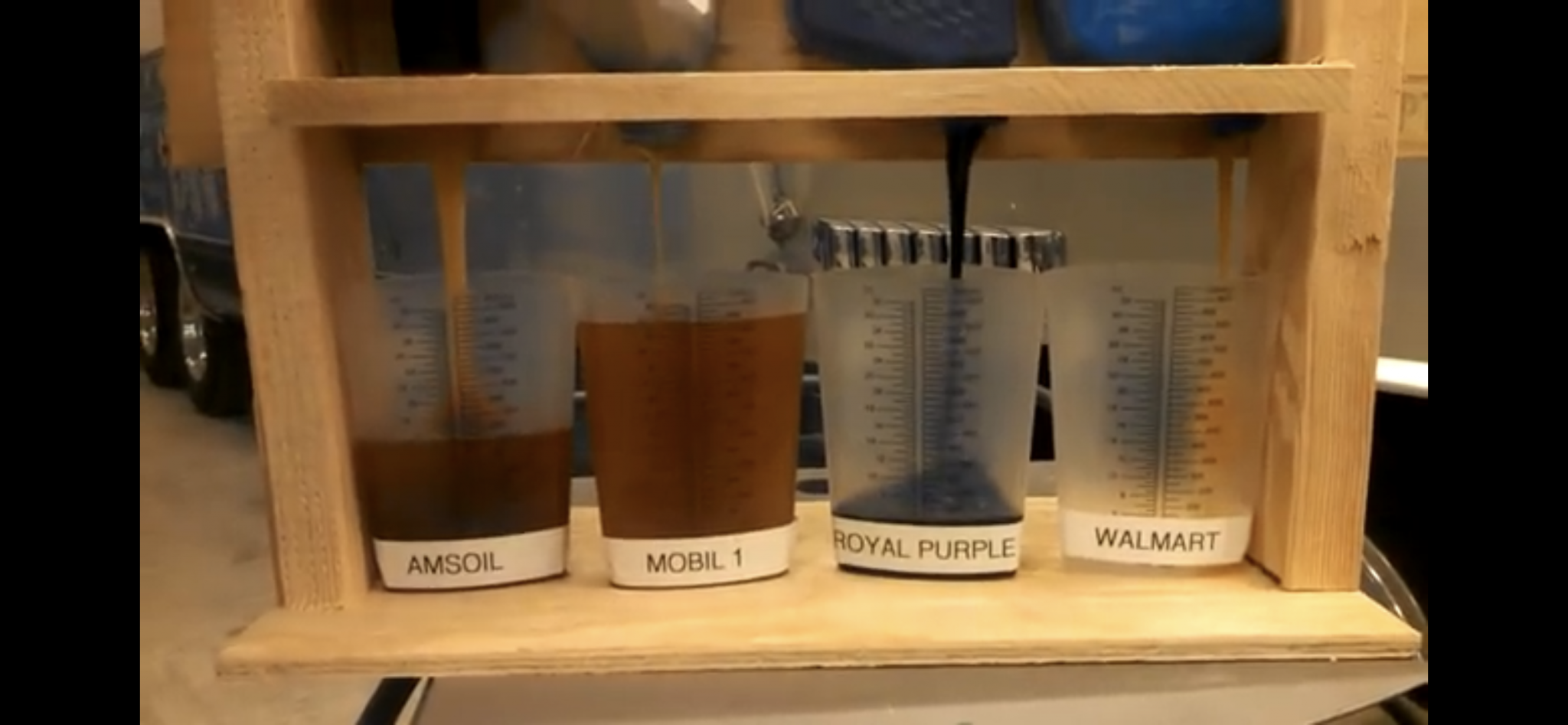

Also @BurtG, don’t trust just the number on the side of the motor oil bottle. I watched a -40°F pour test on a number of motor oils and the cheap Walmart oil was worse than molasses, and even higher end oils were significantly worse than mobile one.
Screenshot below:
