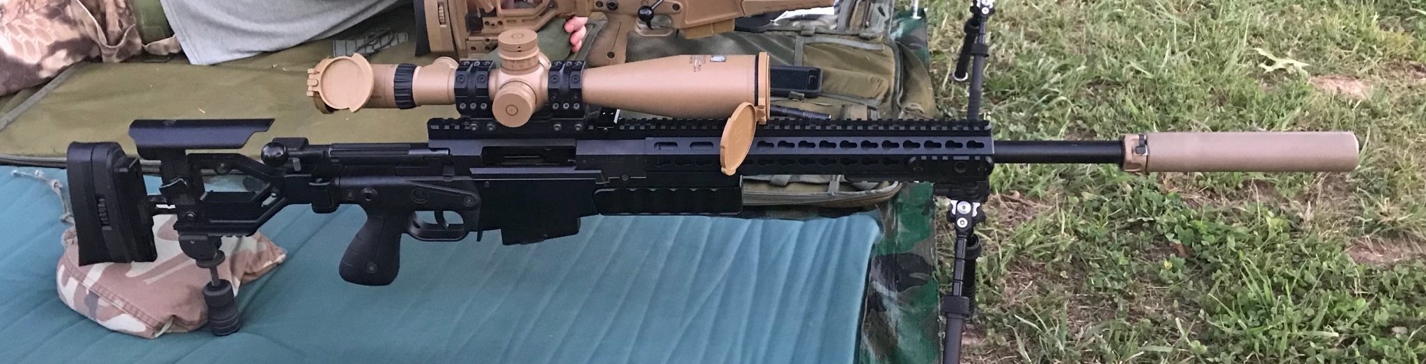

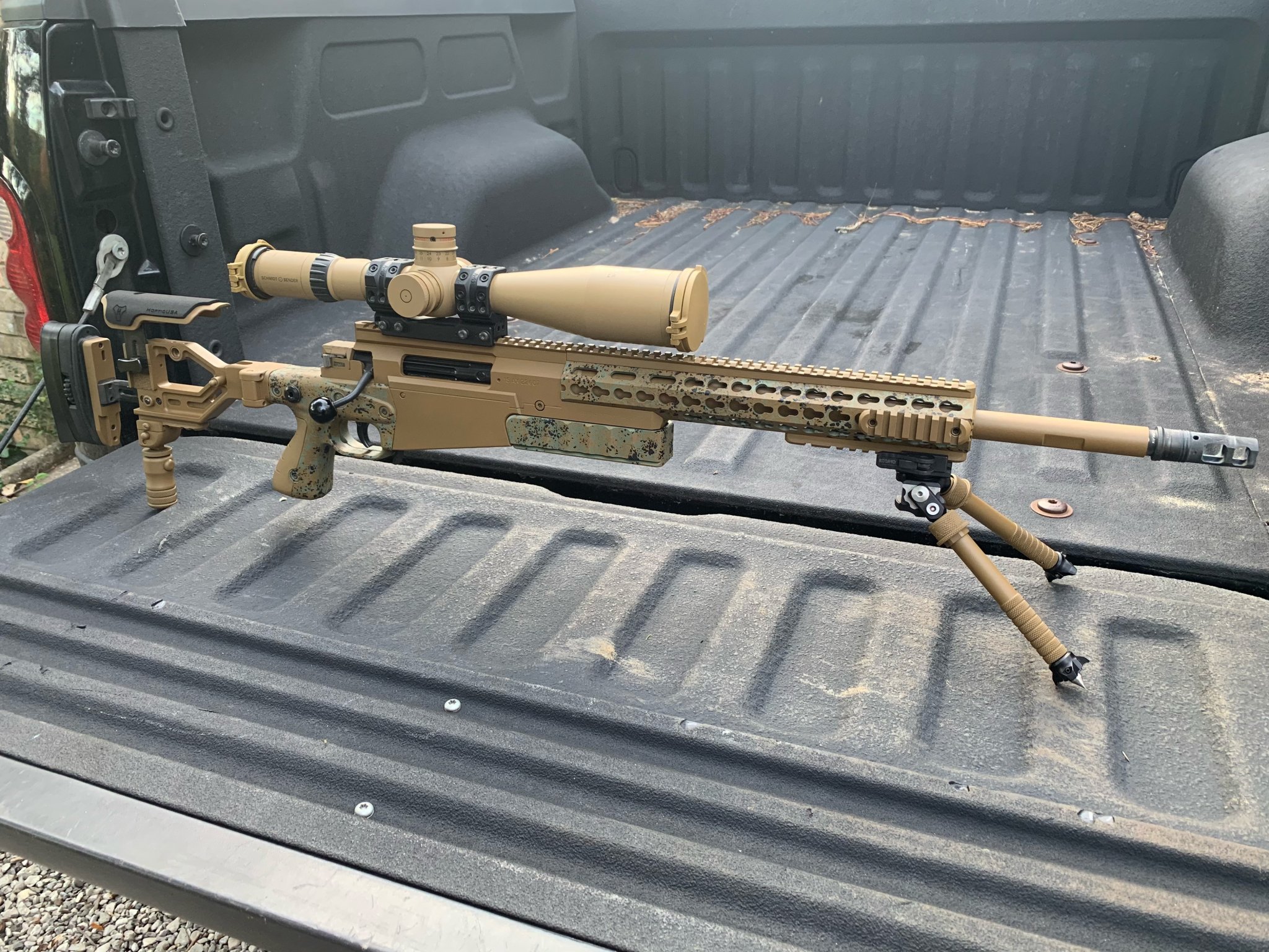

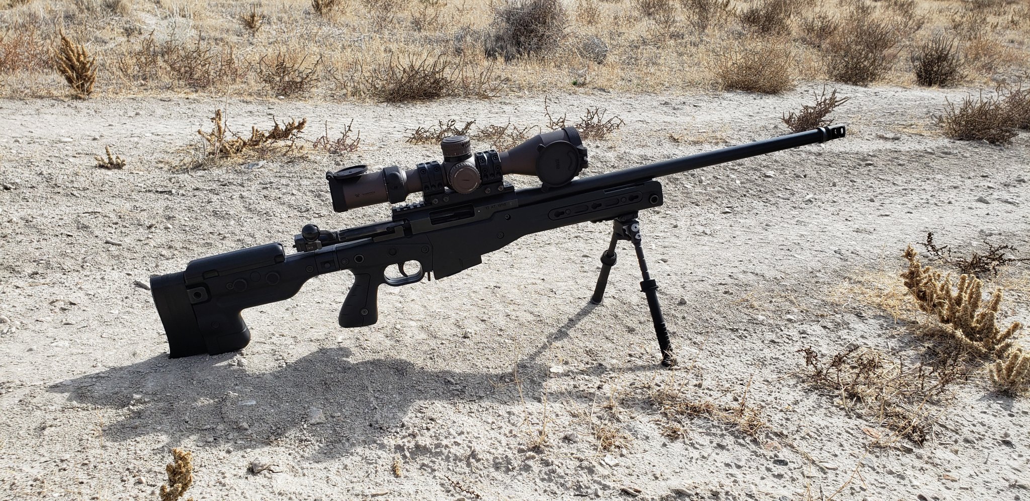

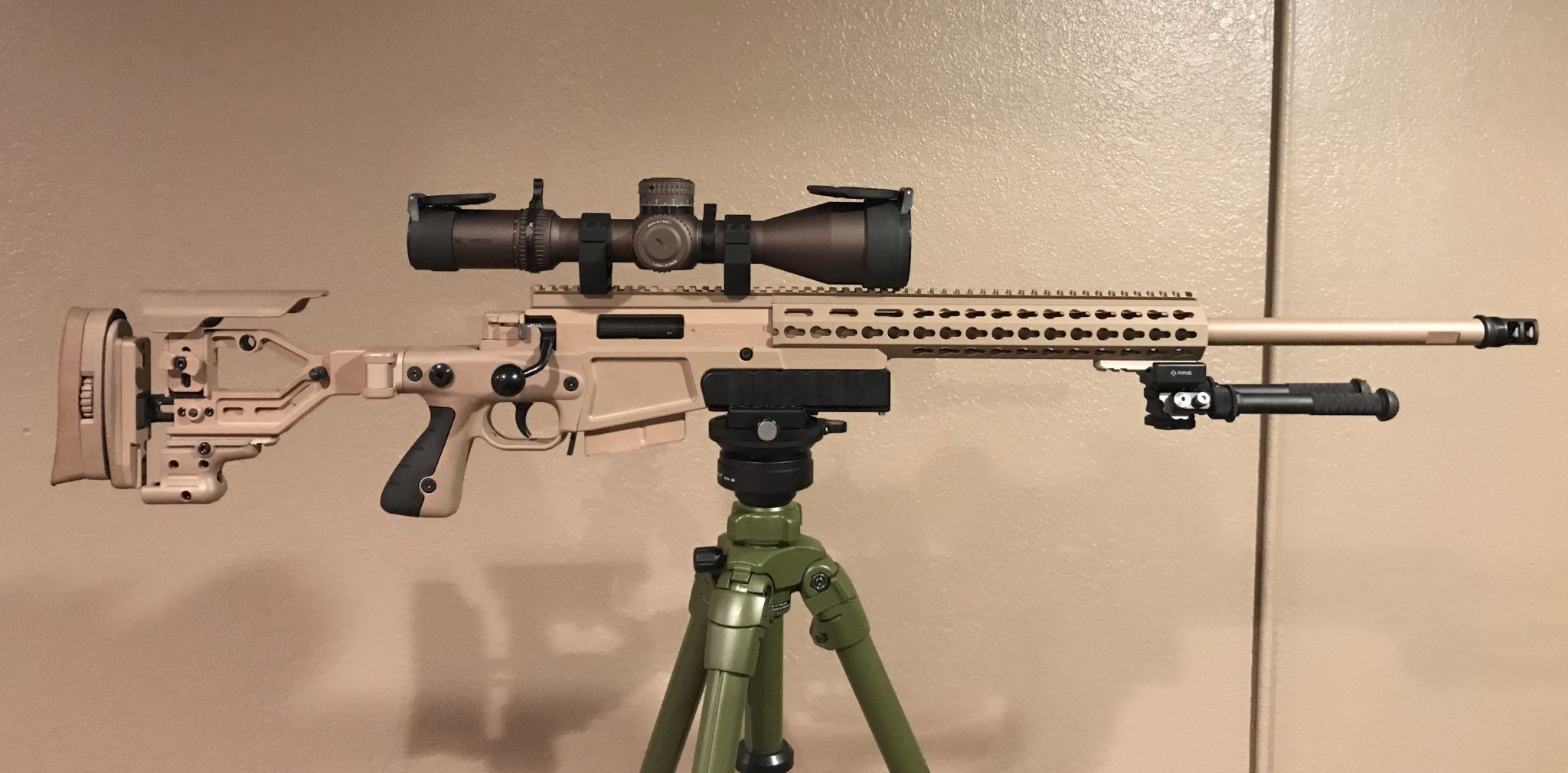

This is the only one I've seen so far and it looks like you will have to raise you scope??
You should be ok with a one piece mount. The nightforce is mounted really low in those rings.
It appears to be one of the original picatinny rails that are the same used on the AX308.

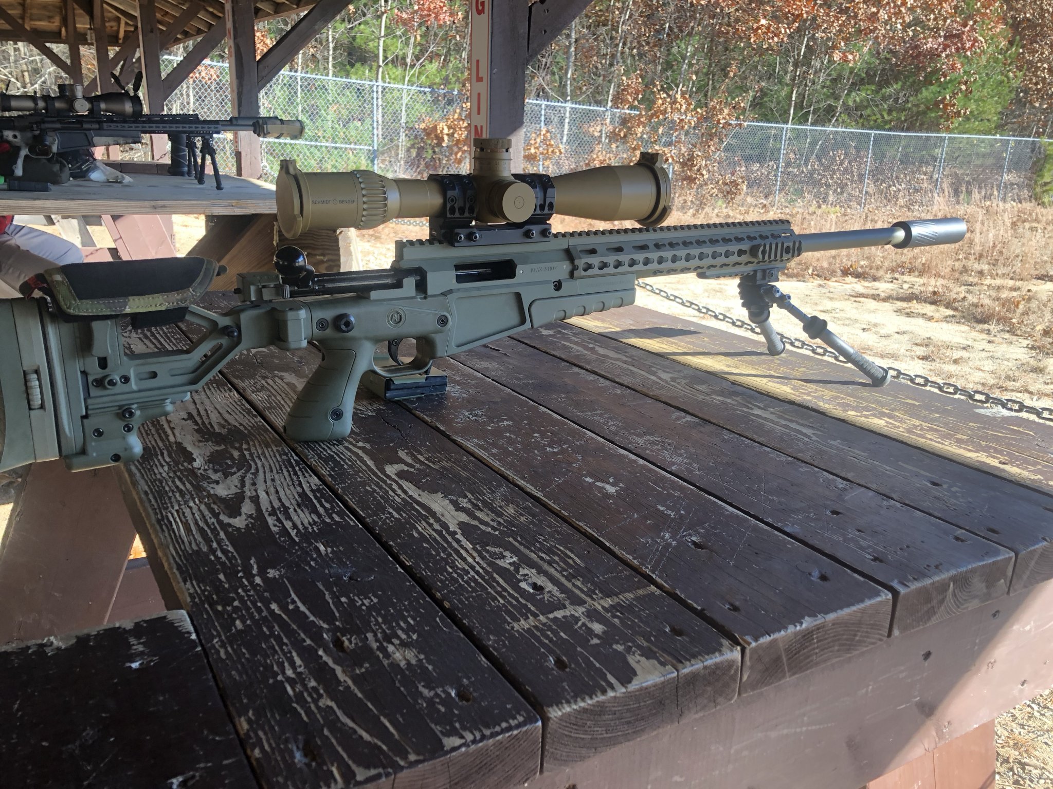

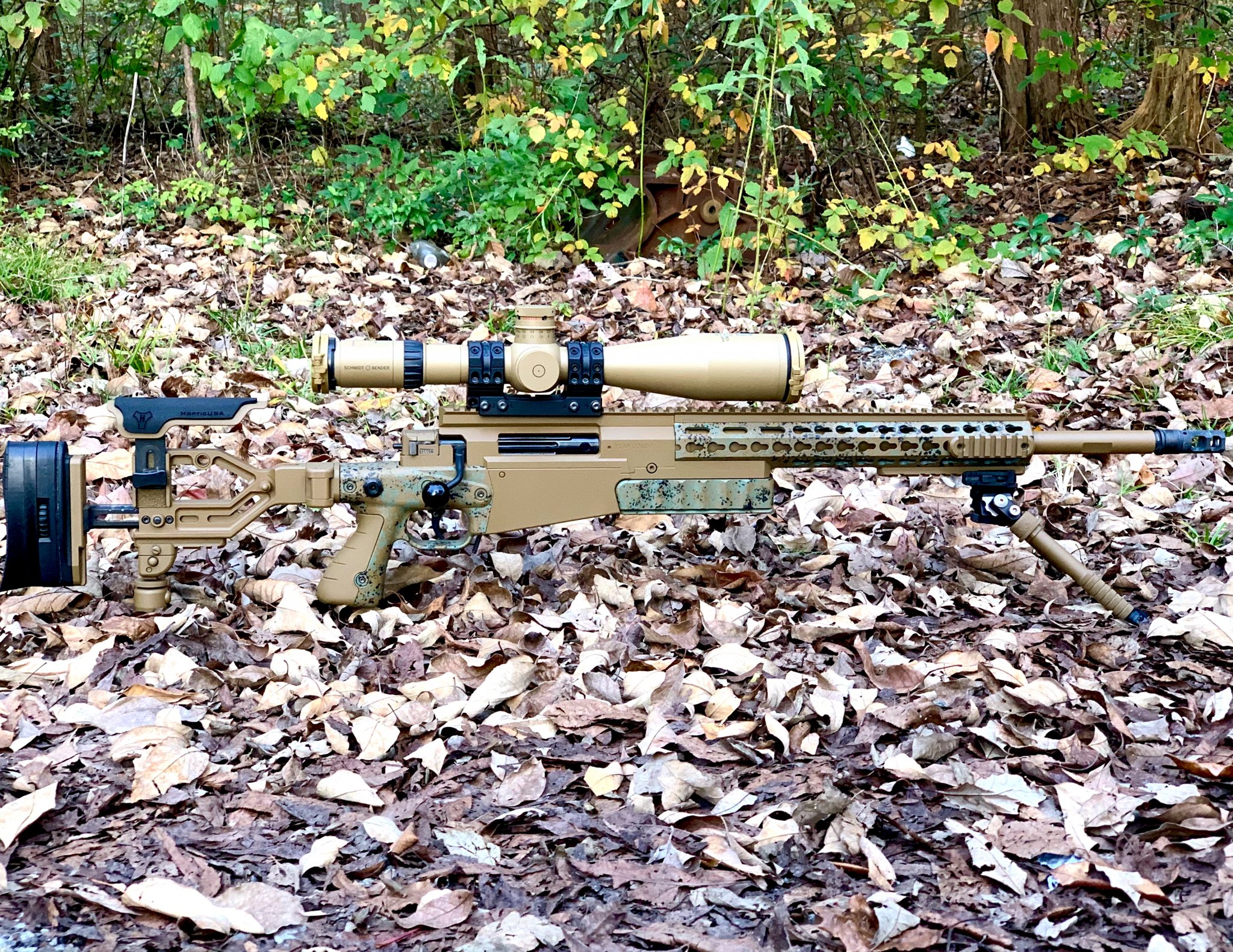

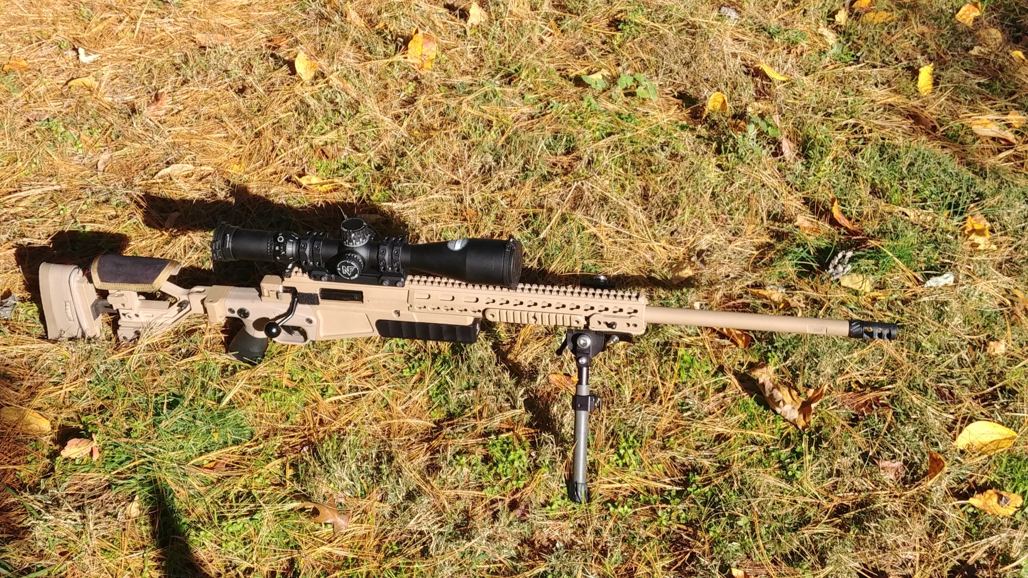

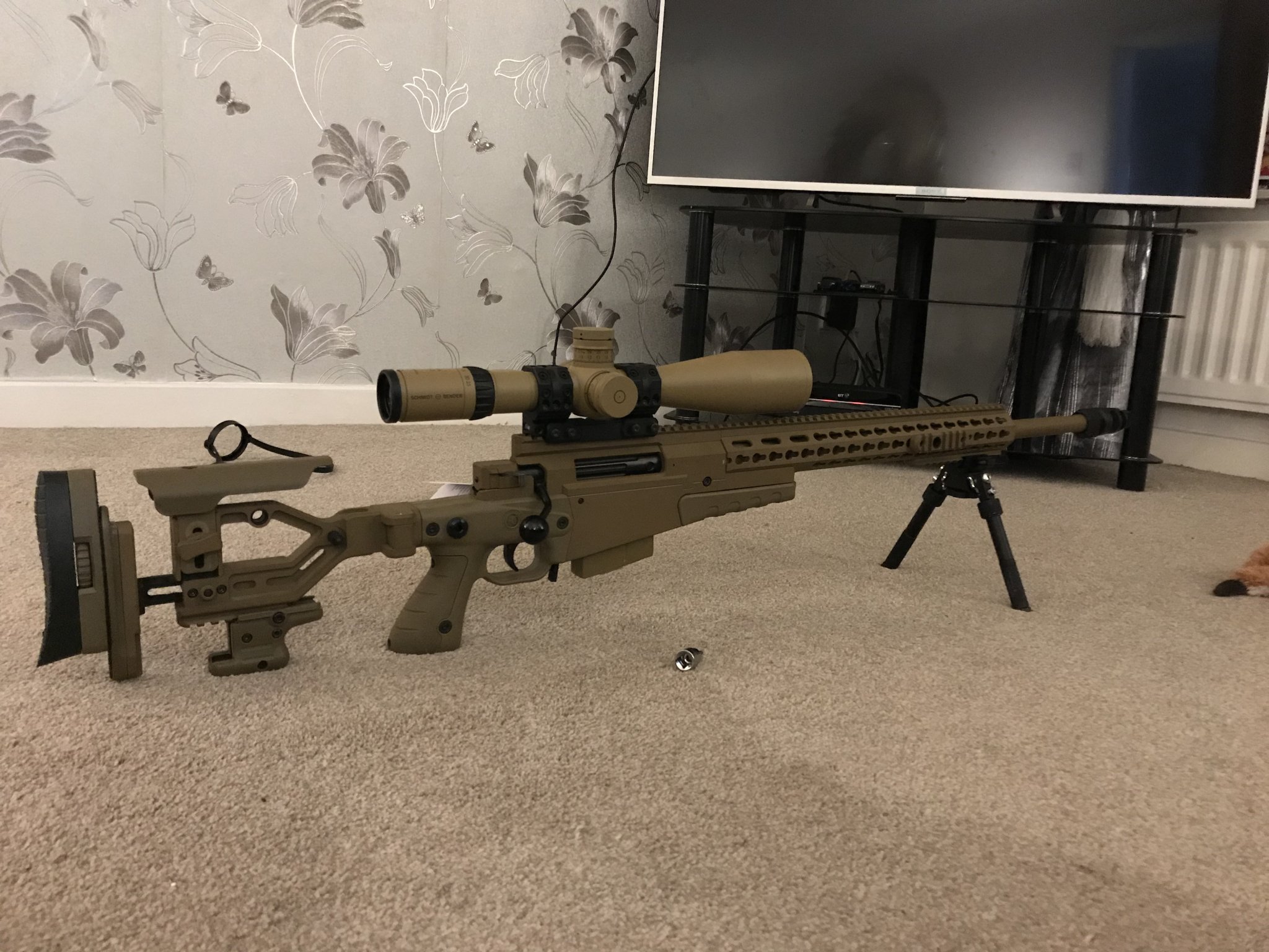

Skrimped and saved my nickels and dimes and just got my shiny new NF 7-35. Had some outside time setting the eye relief and diopter. Rather fickle trying to get a sharp, focused reticle. I'll have to play some more.View attachment 6965597
That's a great looking rig right there.
I had the opposite experience with my NF 7-35. But I suppose everyone's prescription is a little different.
I suspect it has a great deal to do with my astigmatic vision. I actually "see" a slightly thinner vertical stadia line vs. horizontal. It's a function of the imperfect cornea. I have prescription lenses coming this week so I'll spend some time behind the scope.

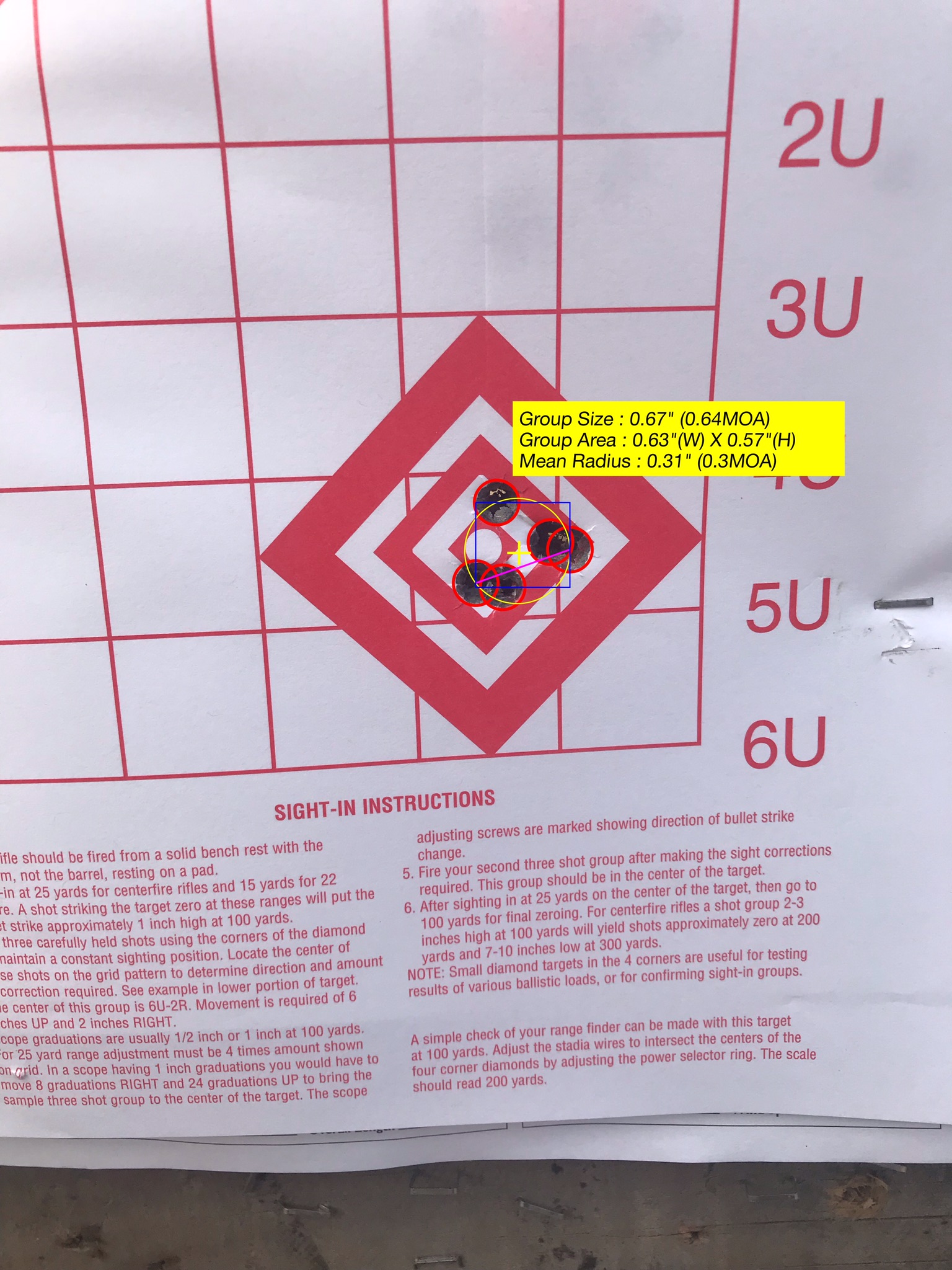

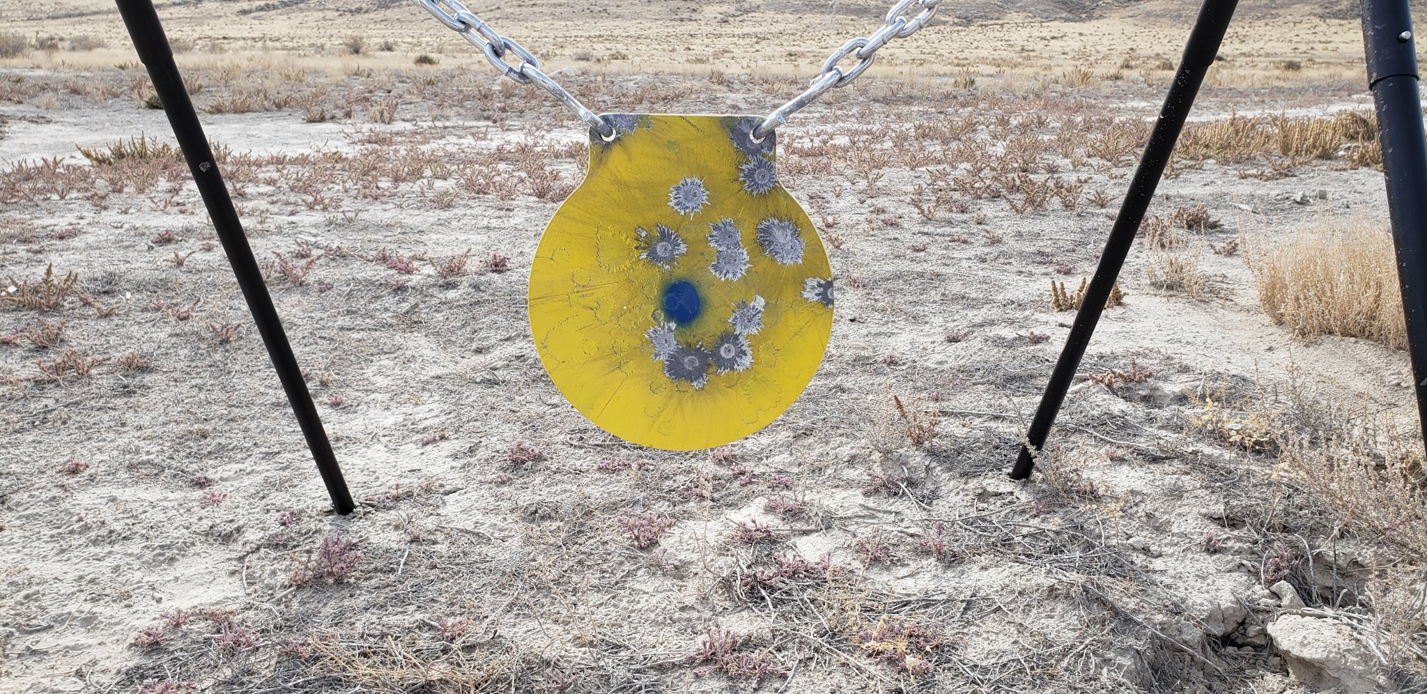

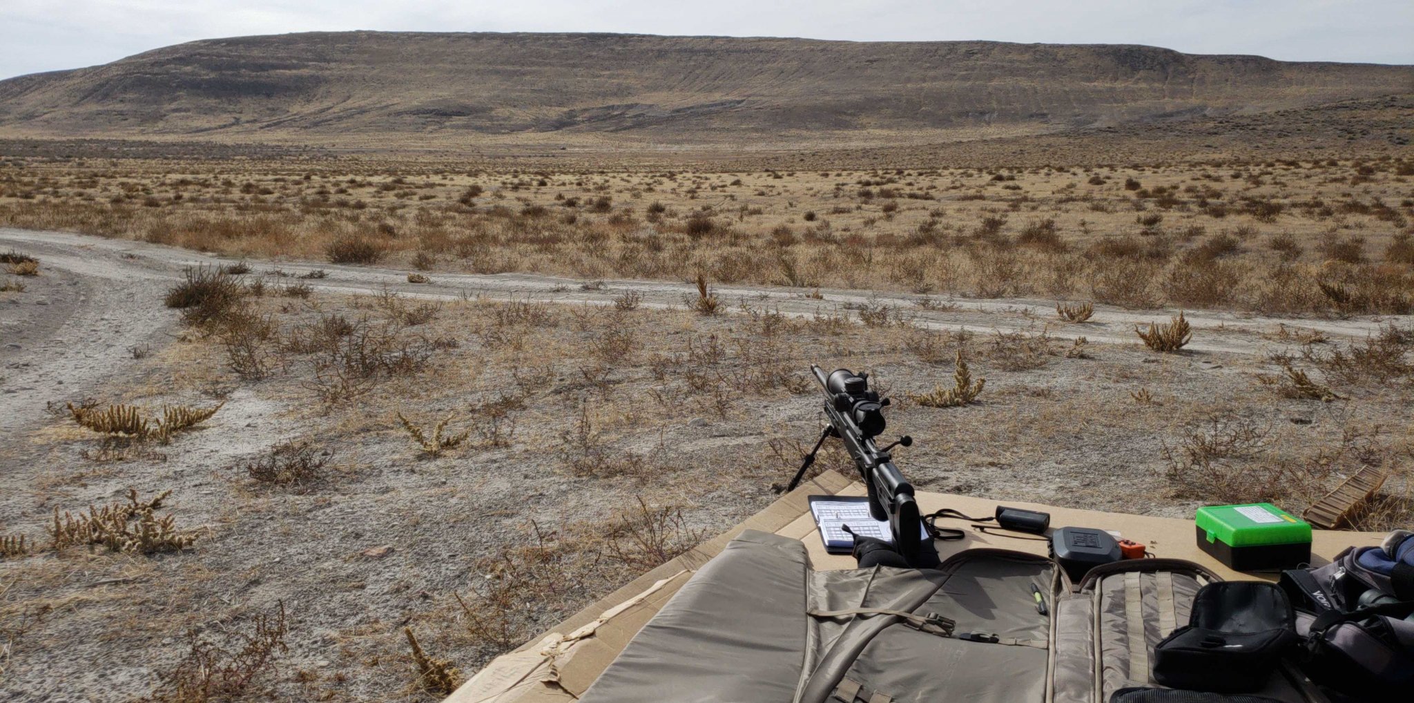

So first 51 shots with my AT today. Had a really good time. Shots below are a few groups on paper. Sighted in with IMI 175 SMK and finished the day with FGMM 175 SMK. After 100 on paper, I moved to 375 yard steel. Using the predicted velocity of 2575 I made a 1.9 mil elevation change and couldn’t miss the targets (full IPSC, 10” circle, ~4-6” flapper target).
Went to go shoot the 600 yard IPSC and couldn’t hit it. The wind picked up and I was lost, and was too lazy to go back down the tower to get my Weatherflow. My primary goal next time is to nail the 600 target as I have never hit anything beyond 375 yards.
Had a great time today. Today reinforced that I NEED to get into a training class in 2019 if finances and time allow! I need someone better than I am telling me how to fix my inconsistencies and critique my fundamentals.
I did notice I had a smoother recoil pulse when I placed my thumb inside of the thumbhole as opposed to using samb300’s thumbrest. For me personally, I felt like I had to grip the rifle harder while using the thumbrest whereas the thumbhole grip seemed more relaxed. However, many more rounds must be fired to obtain any sort of efficiently.

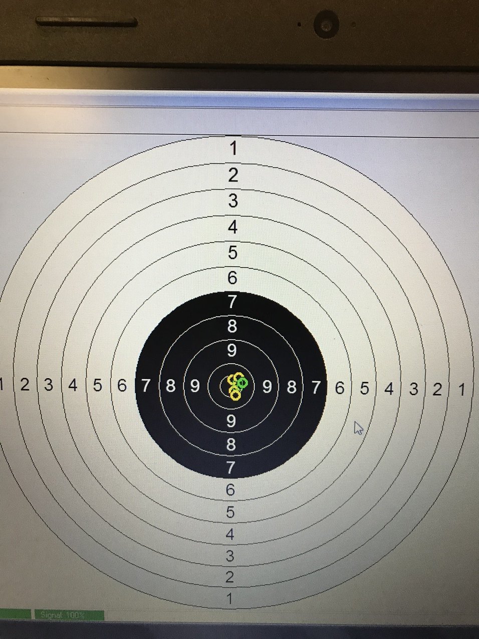

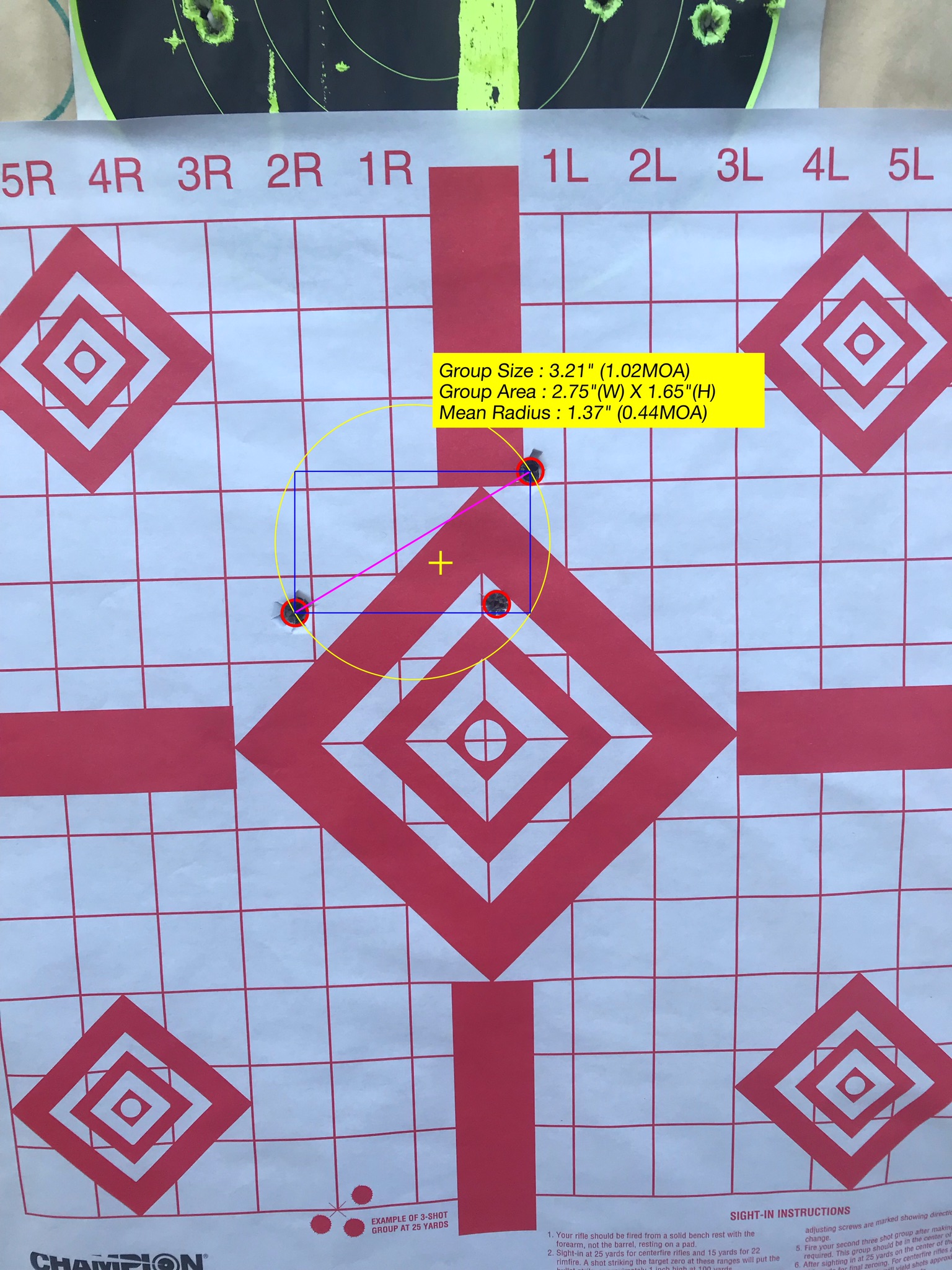

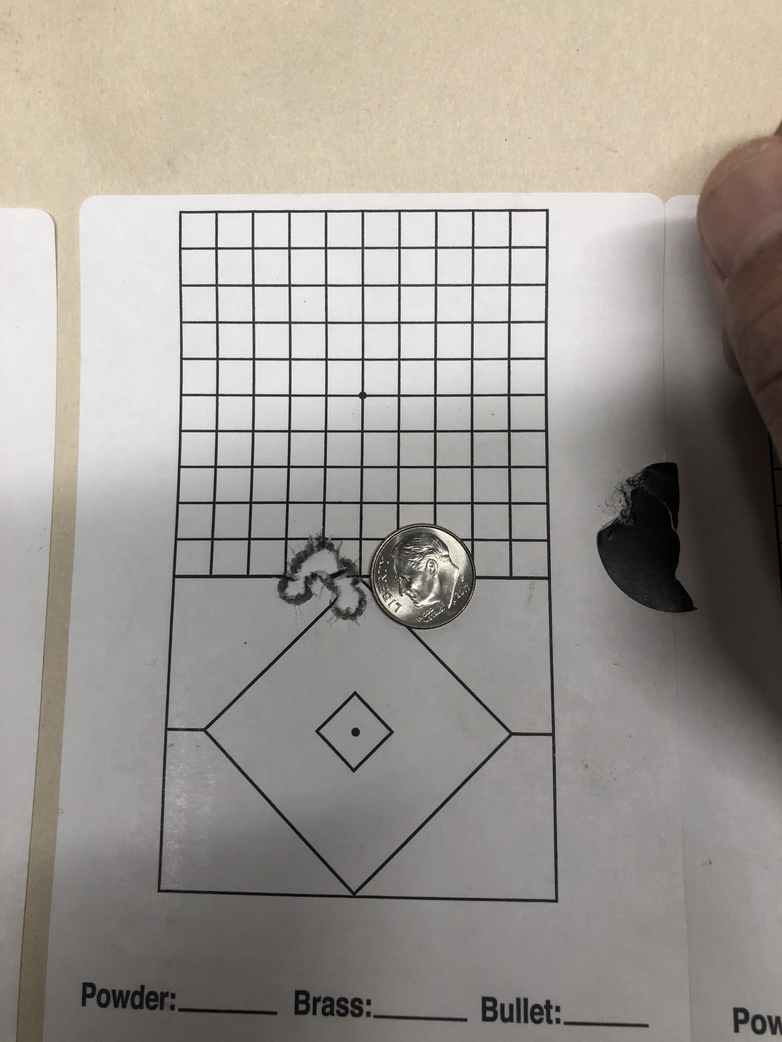

1st five shot group after sighting in (IMI):

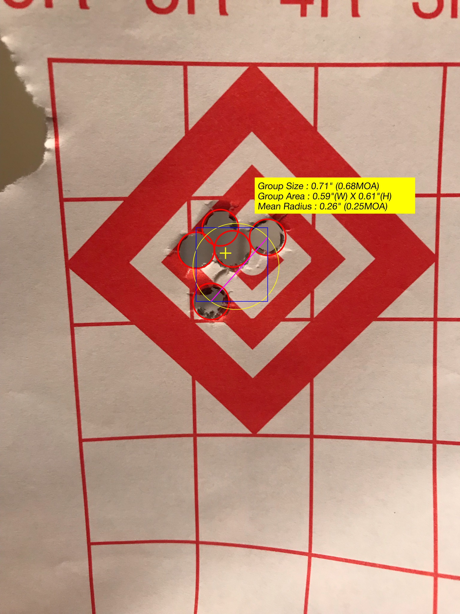

Another 5 from IMI:

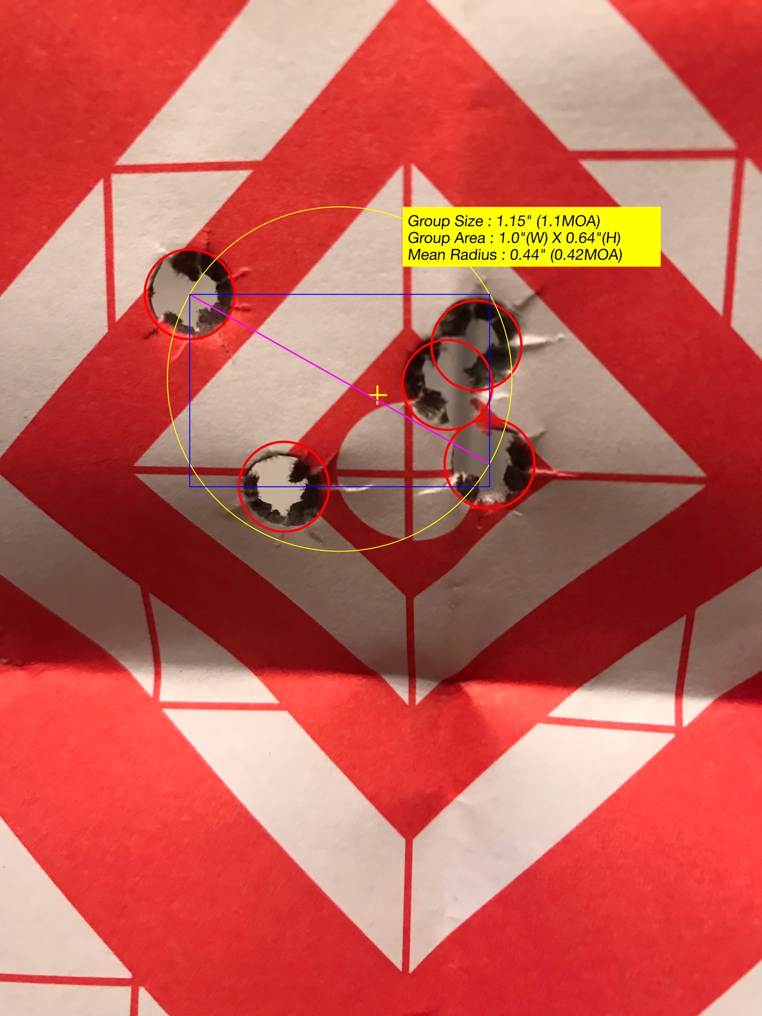

175 FGMM @ 100:
3 from 175 FGMM @ 300:
Obviously I am not up to the standard as many display here (I figure I’m about right at an MOA shooter), but I will enjoy learning and improving with every range session.

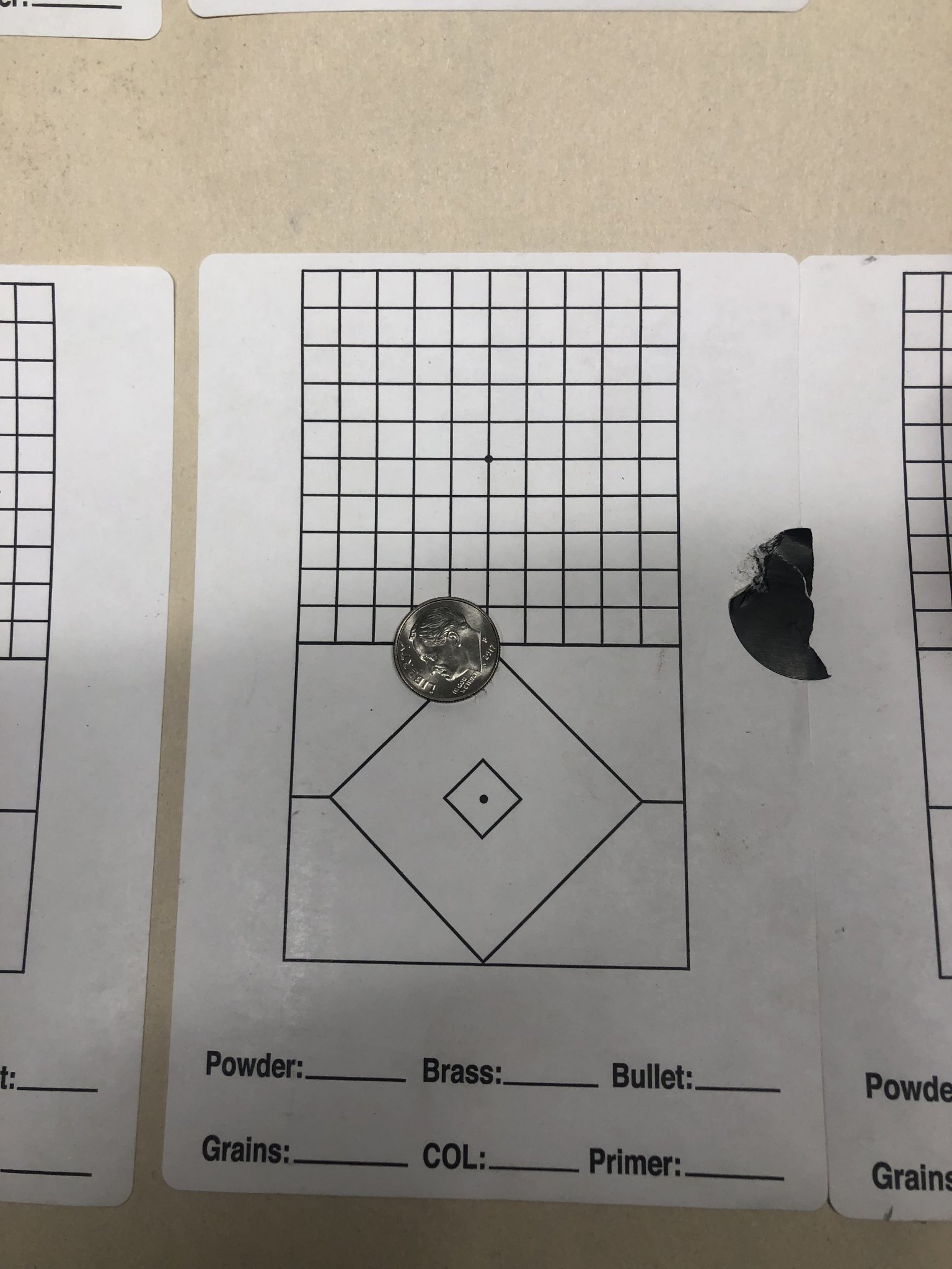

This was from the other day, right after break in, not a bad start.
143ELDx loaded 2.85” oal
42.6 grains of RL-17
Nosler brass
Federal 210m
