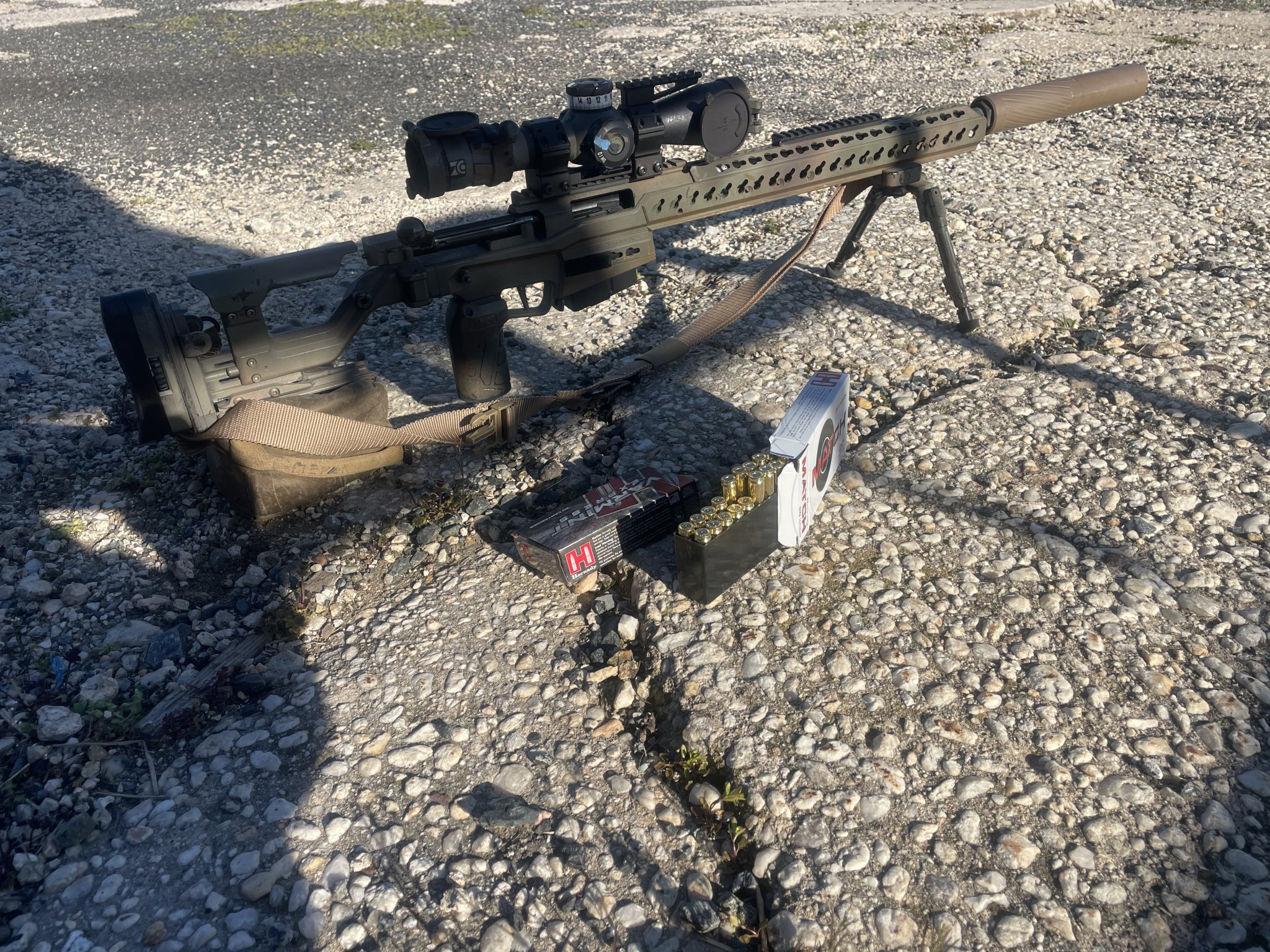

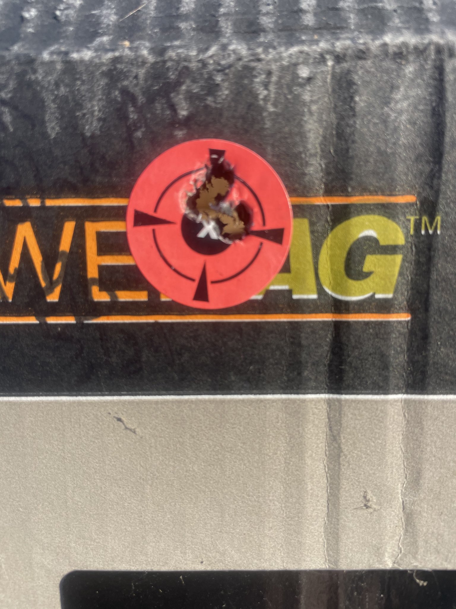

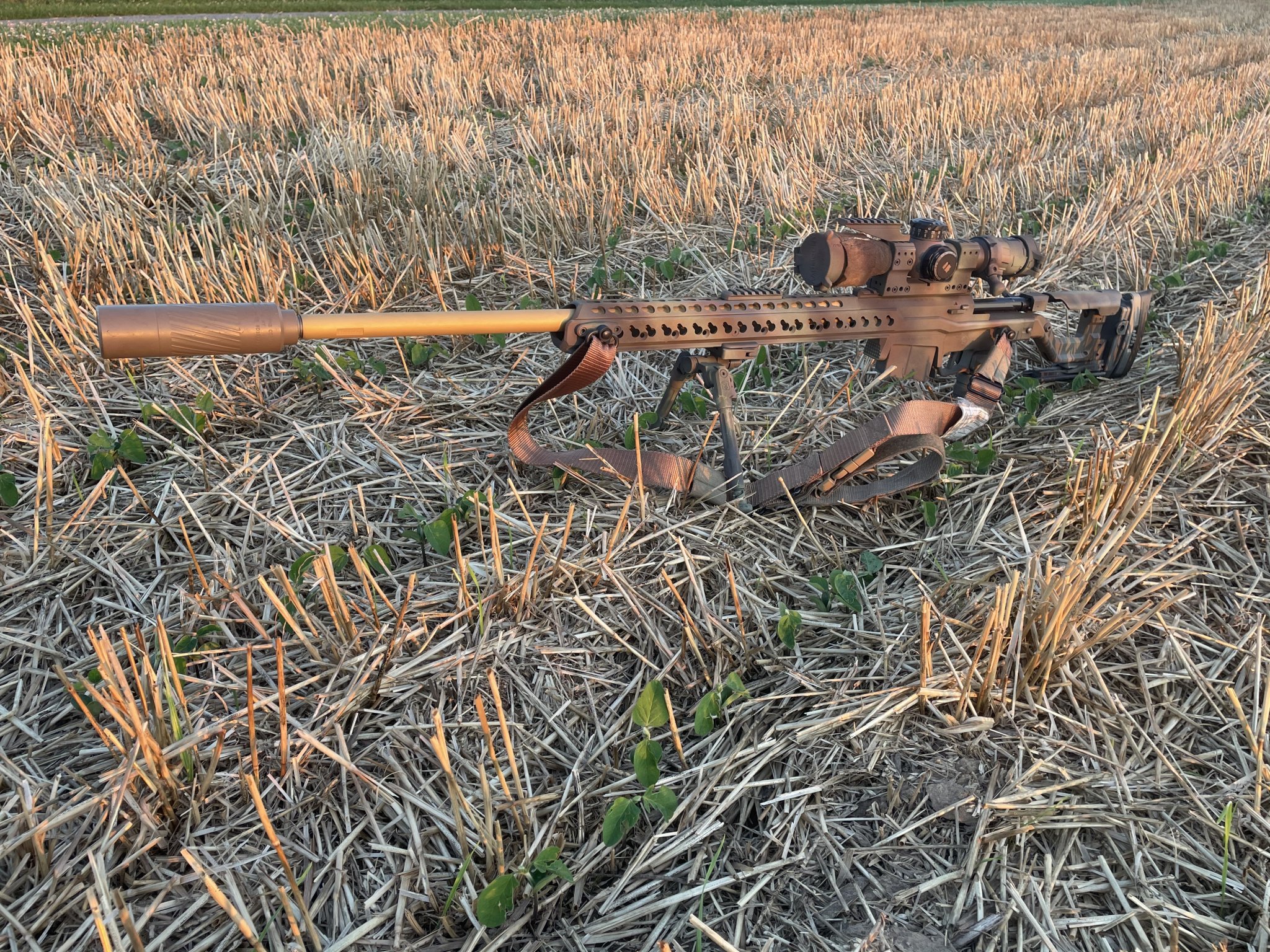

Smoked some pork with the AT this weekend.
168 amax TAP did the trick on two, about where the turkey is in the reticle picture.

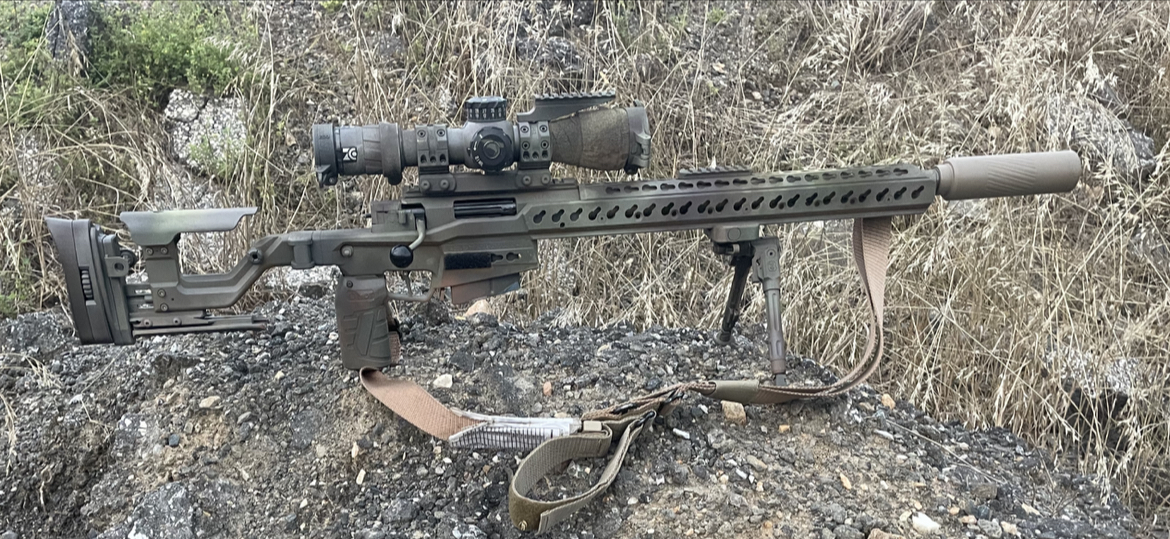

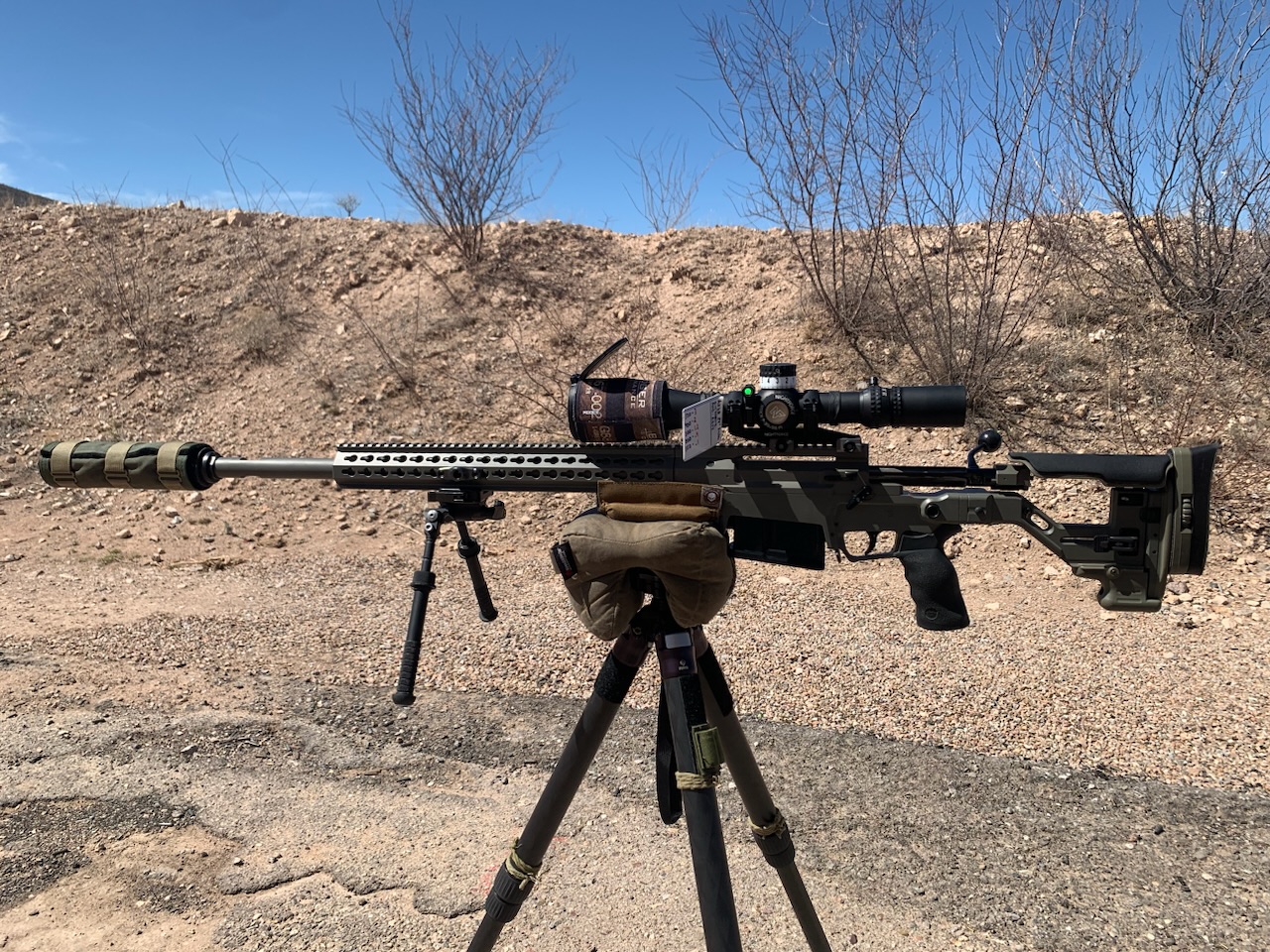

Was running some dry fire dot drills (prone/barricade/tripod) into the backyard this weekend to tweak the fit of the AXSR a bit more from various positions.
Also took it the range today to shake out the forend bolts some more. I only now realized that there's threads in the chassis itself that the forend screws run through that strip any vibratite or loctite before ever getting to the forend threads, so I dropped a drop of blue loctite in the forend threads themselves and torqued them to 55 inch/lbs again ... dumped about a 100 rounds of 308 through it today and re-checked the torque, seems to be holding ok now.
The more I shoot this thing, the more I just want to use it for everything and sell my other precision rifles (except for maybe the 22LR). Initially I was concerned it wouldn't be a good fit for PRS-style shooting due to it being a long action and quite a bit bigger than my usual setup with the Arca "hump" making it top heavy when shooting positions off of bags, but with a Gray Ops plate on the hump it's a great all-round shooter even off of barricades.

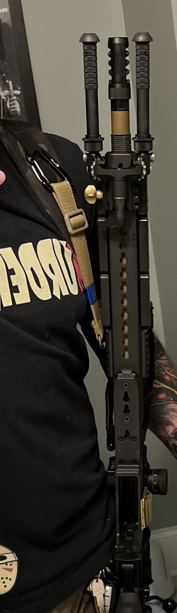

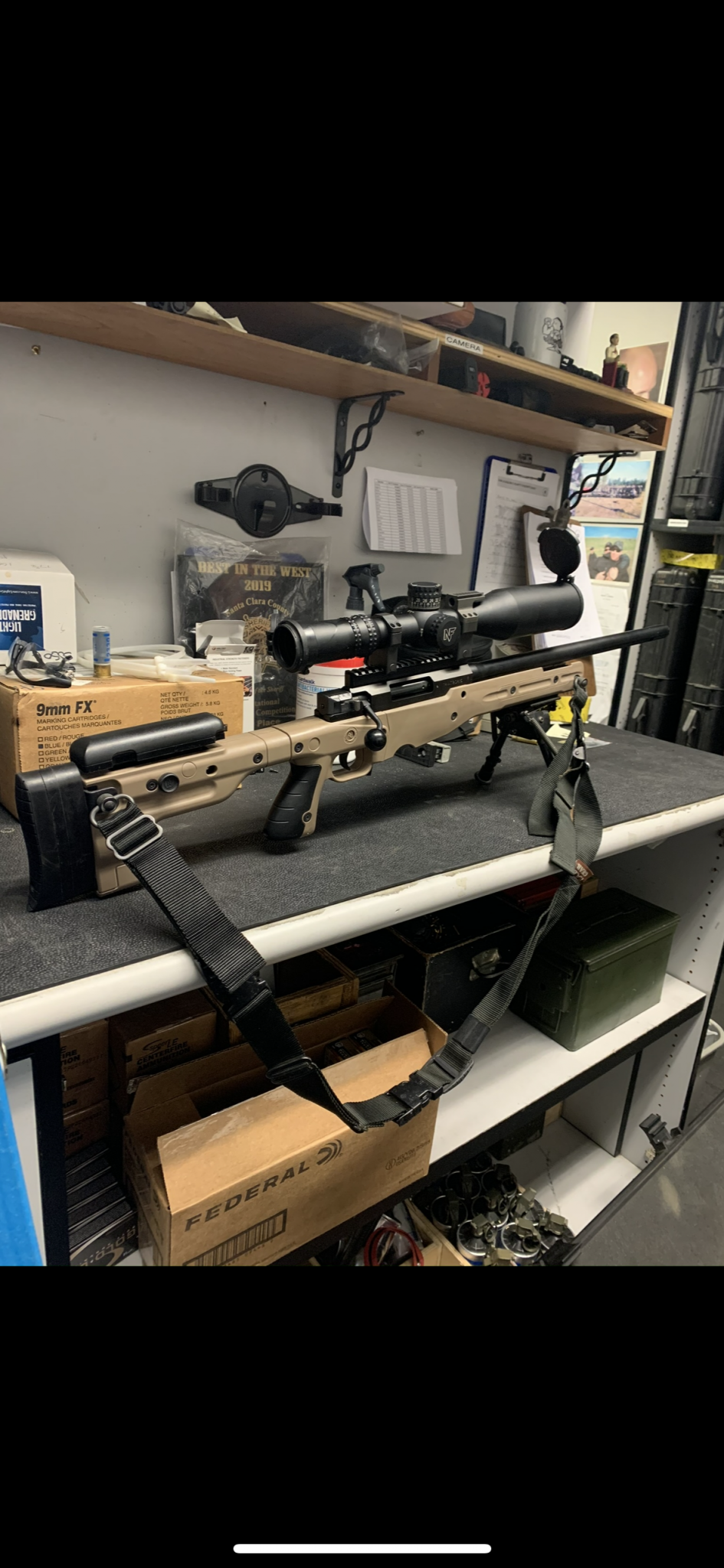

Saw some dude run this QD strap setup for walking around his rifle around stages and figured I'd give it a shot. Hot damn, super comfortable and let's you go hands free without having to set down your rifle, but without the hassle of manipulating a sling over/behind/etc. your pack. I'm probably late for the bus on this one but might be handy for other folks as well.
I run the OBi link system the same way, but that’s way cheaper if you’ve already got a spare qd swivel. I like it.
That looks great. How do you get one?
That OBi system looks fantastic. I'm the king of rummaging through my pile of crap and cobbling together solutions haha ... my bag rider is an old upside down acog mount with a KRG bag rider bolted to it and I run my tripod out of a cheapo molle bottle holder and a strap :ROFLMAO:
