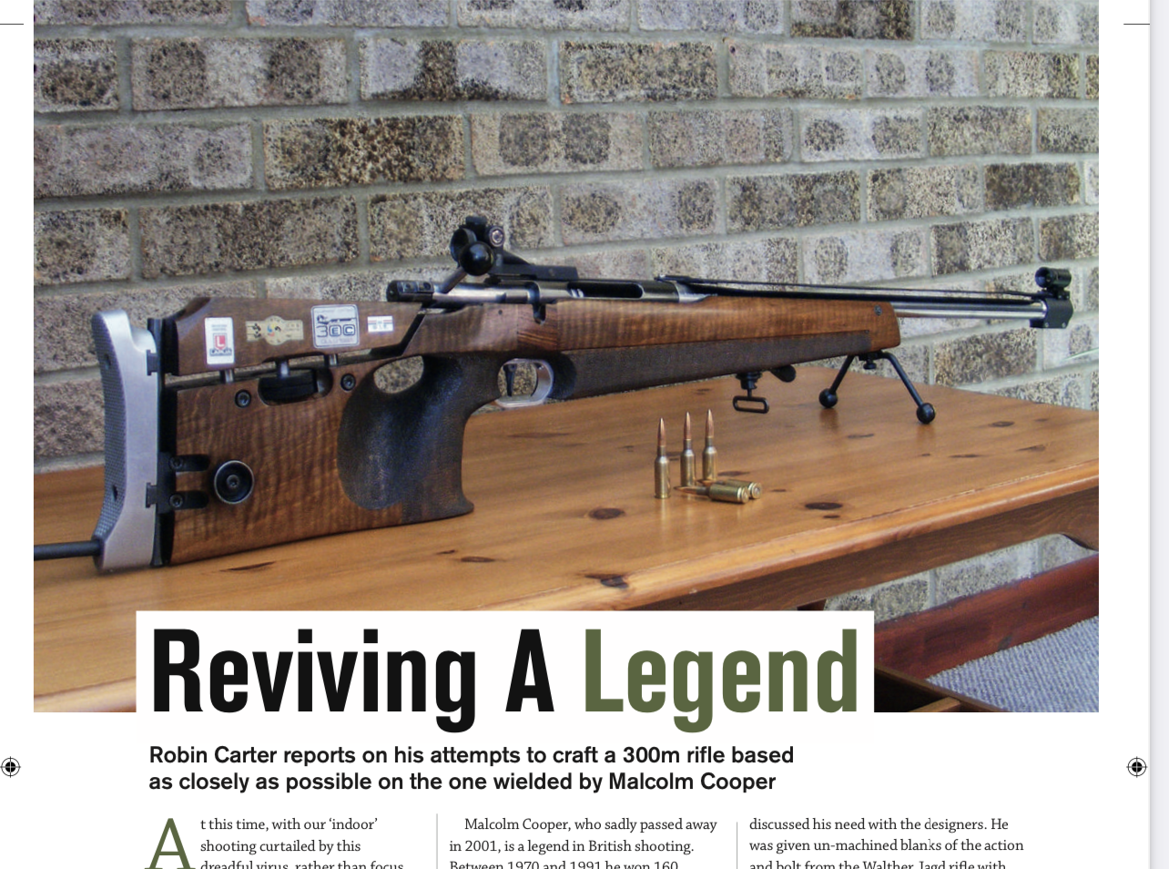

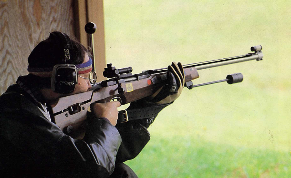

Is there an “Accuracy International Thumbhole Stock Master Race Thread” I’m missing somewhere?
Every AI thread is a thumbhole stock master race thread
However some are still lying to themselves and think they’re happy without one
