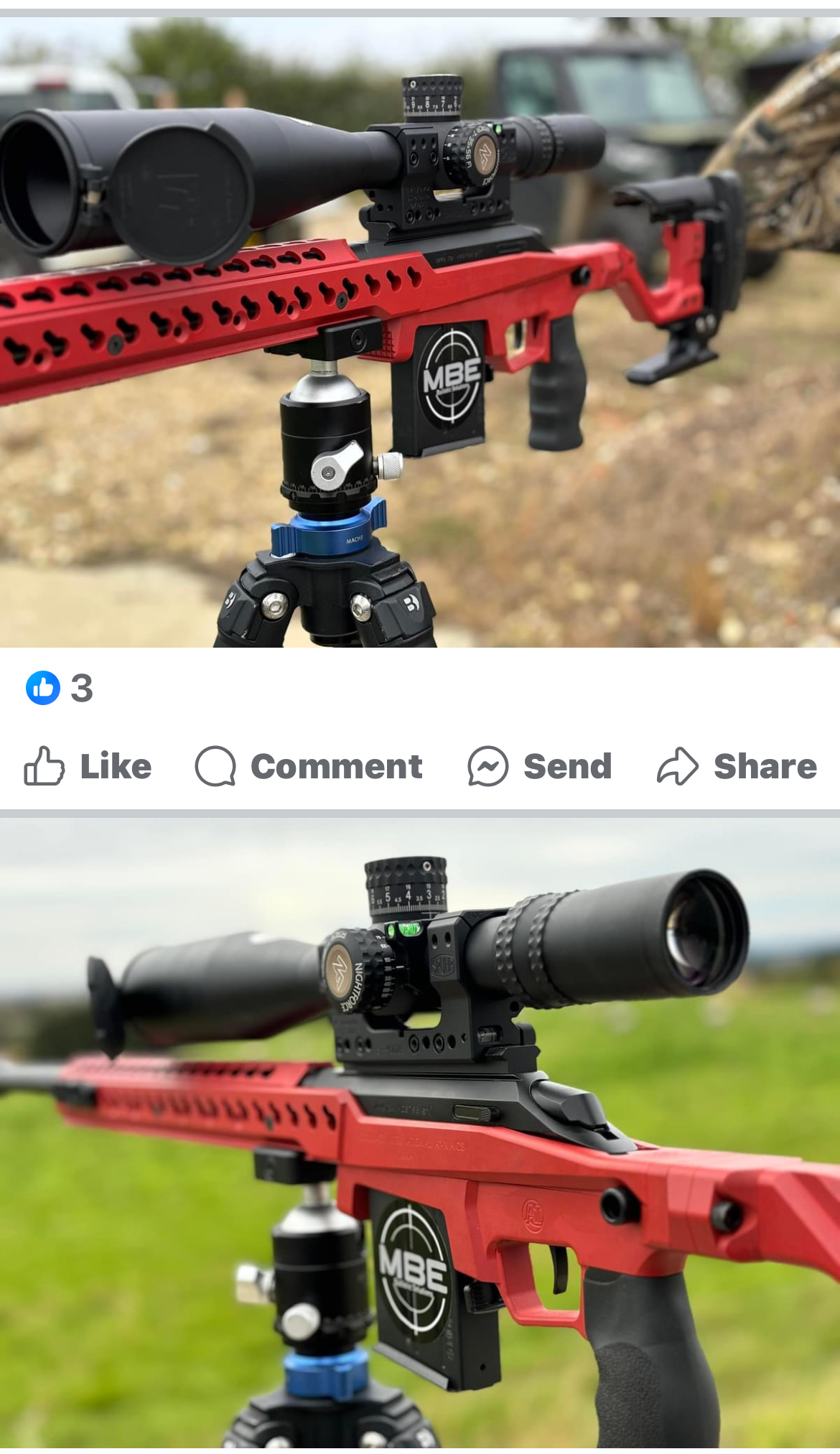

Been trying to find a bag/solution for the axsa hump for a bit here for better stability for prs.
I saw this a while ago from area 419 but they were discontinued and I was never really sold. However someone was selling a used one here so I snagged it just to try. Seems like a solid solution and I get much better contact across the whole rail with a bag.
Only compromise is I can’t slide my bipod have to quick detach and move to rail but I do that a lot less in stages than trying to get stable off bags.
This is also a lot lower profile.

This was my main reason for not liking the AX for positional shooting.

Too close to the butt pad for my liking but it is working for you thats what matters
