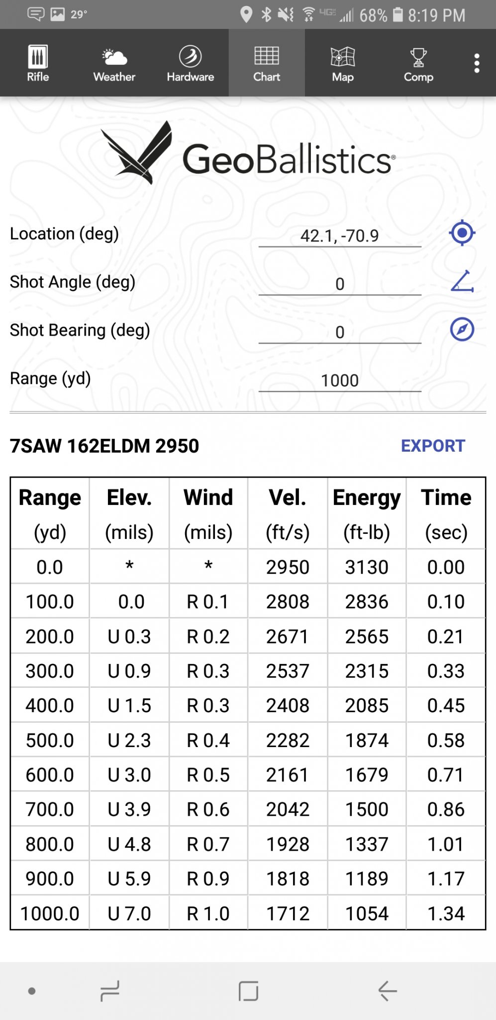

    What finally convinced me to change from MOA to MIL was the quick wind formula you can use with the G1.
    The example I was given originally was that the G1 BC for .308 is .4XX so you use a 4 mph, therefore:
    100 = .1 mil at 4 mph
    200 = .2 mil at 4 mph
    300 = .3 mil at 4 mph
    400 = .4 mil at 4 mph
    500 = .5 mil at 4 mph
    600 = .7 mil due to velocity bleed off and correcting the estimate
    700 = .8 mil
    800 = .9 mil
    900 = 1 mil
    The base 10 was a lot easier for me to quickly find a number to use. I think Frank had a great podcast on this one.
    I don't think that's right but I'm going to have to do an example myself to see if I'm wrong and also learned something new.
    Reactions: Alabusa
    It's a generalization. But there is normally a wind speed that works like this. It may be 4 or it may be 8mph
    There are two different projections. Both at 7mph. 90 degrees to shooter
    "The discussion from accuracy is incorrectly applied to the difference between .36" and .25" which is less than 1/2 a bullet width. However both methods have finer adjustments available "

    b6graham - thanks for the examples. I didn't realize there were cases in which this held true.
    Not just "some" cases. This works for any cartridge within it's supersonic range. There will be a certain wind speed that will give it 0.1mil drift per 100 yards. It works as well for a 69 grain Sierra Matchking at 2800 fps as it does for a 300 grain Berger at 3150 fps
    Skookum is right.
    Note that both my examples are a little fast for what those specific bullets would normally go from a short action non magnum. The velocity plays a big part. So its important to figure it out for your specific load. But it can be very useful for bracketing.
    In the case for these loads. 7mph roughly is the normal jump so a 3-4mph wind will be half that (.1mil at 200, .5 at 1k) and a 12-14 will be closer to .6 at 300y and 1.4 at 700y for example
    Now if only I could get average wind speed from me to target within 1mph every time haha
    I grew up with MOA; it's my native language if you will. I translate to MIL; all my field rifle scopes (sans one mid weight hunter) are MIL. I read the wind in MOA, then translate to MIL. It all goes very quickly, especially when thinking in terms of 3 clicks per MOA. The reason I standardized on MIL was because of its dominance in real world application. MOA is the universal language for flat range civie shooters, MIL for 'real" shooters, as taught in the known government precision programs.
