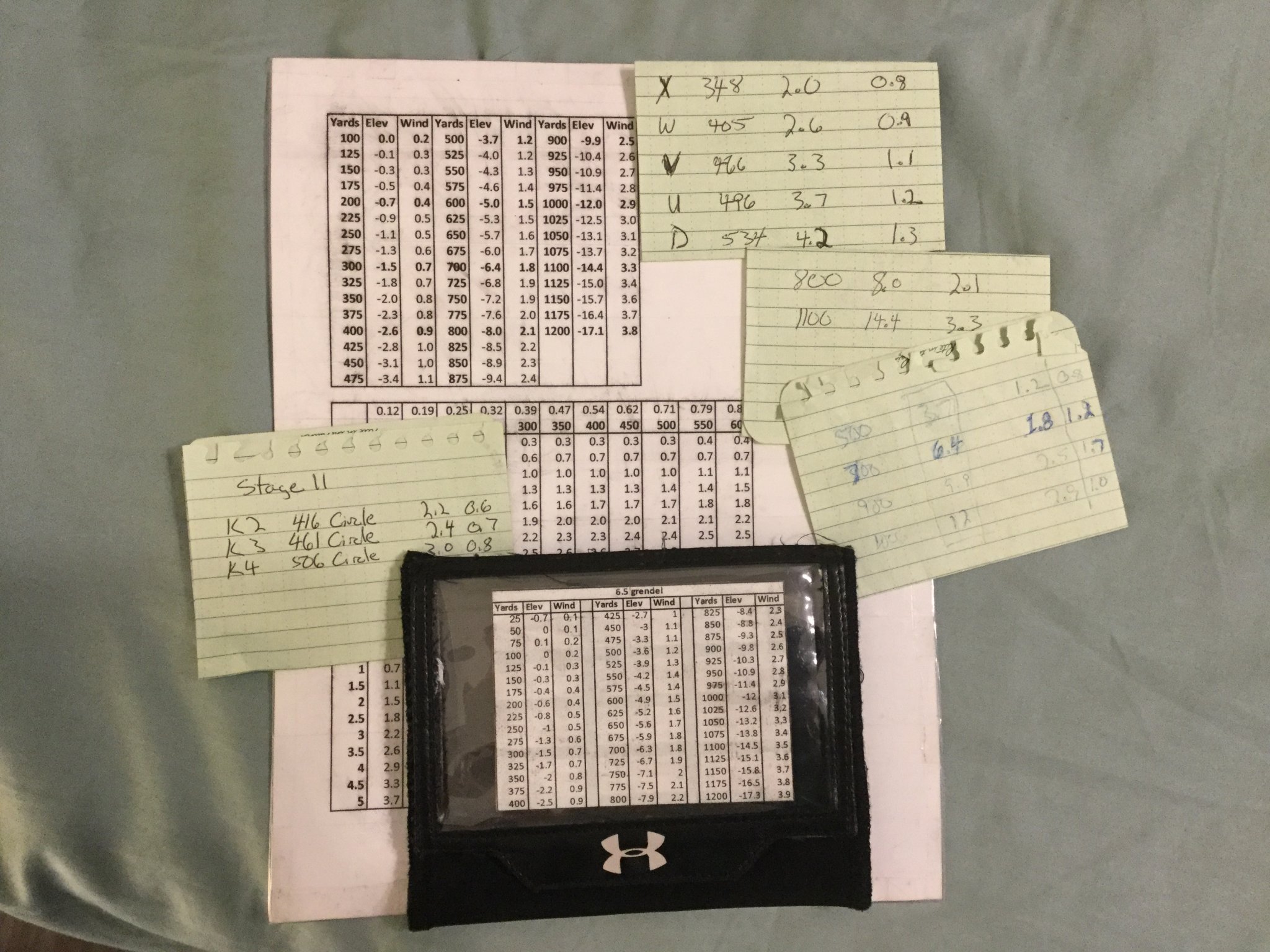

“What’s the wind?
8 mph half value.
Ok, dope chart says 1.8 for 10, full value
Ok, half of that is 0.9, plus half of that is 1.3 (this gives me 75% of my full value 10 mph call), come back 20% (80% of 10 mph) gives 1.1.”
This is 0.082 too much (20% of 1.3 is 0.26), but likely still close enough.
Mrad or moa, doesn’t matter.
But, really, many of those in prs competitions are using a somewhat different approach to doping their first shot...
“Hey, what was your wind call?”
Tenths may be easier to calculate than fractions (in general) because you just move the decimal place, but “half” is easier to visualize. So is half of a half, and half of a half of half, or half + half of a half. Our brain is remarkably good at picking a centerline, that is why “come down half a target” or “come left a one target” is a useful call without angular measurements.
My observation in the local matches I have shot in is that few spotters on the line have reticles. Spotters don’t call angular corrections because they are equipment limited.
Ok, so your method is to figure fractional values from a pre-printed dope chart.
Do you memorize your dope chart?
Would you be able to apply what you know about your dope to call for someone shooting a different caliber?
Yep. Dope the rifle before hand. Every shot fired before the current one is useful info. Write it down and use it.
No, I don’t memorize it. It’s a chart. I have a full 8.5x11 sheet for ease of use, and a miniaturized chart in a wrist coach for quick use. I also carry paper and pen to write down the info I need for the stage to be shot. These notes can be tucked into the wrist coach or affixed to the rifle.
In a hunting scenario, the wrist coach is fine as time on a long range shot is not as critical as it is on a match stage.
I don’t need ballistic data on another caliber to call a correction from a spotter. Every shooter on the line should have good dope for his or her rifle for that first shot, SWAG or not. PPPPPP
I edited my post above with additional info, while @Skookum was typing...
