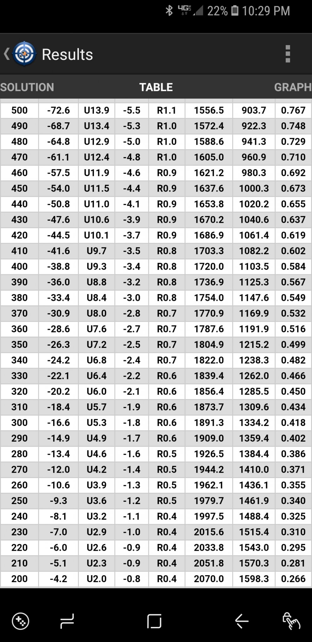

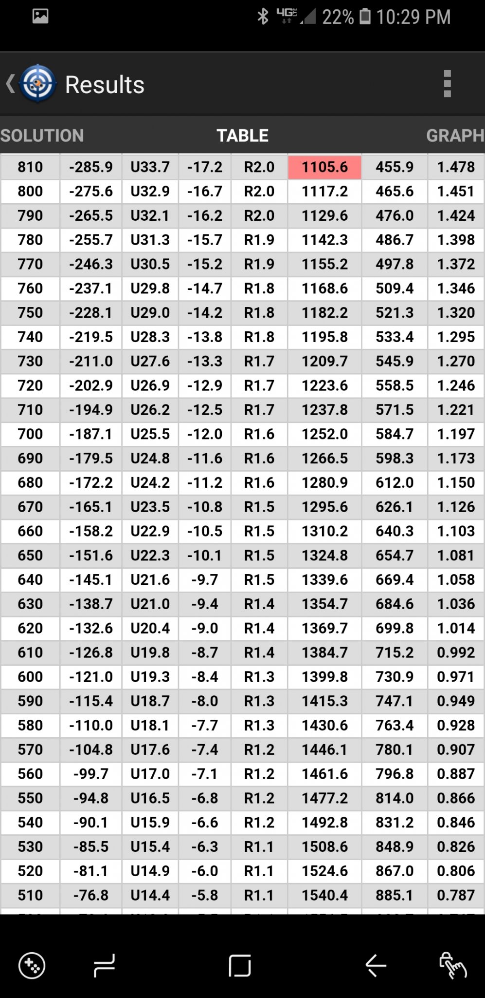

Okay so here is some trial data with the 500 being 1 MOA
it looks like it goes
.2
.4
.6
.8
1.0
then it's really not that hard to go odd numbers after
1.3
1.5
1.75
2.0
2.5
2.75
This is a 6.5 with a 143gr at 2850fps and it's a 3 MPH gun, actually, 3.8 lines it perfect in this case.

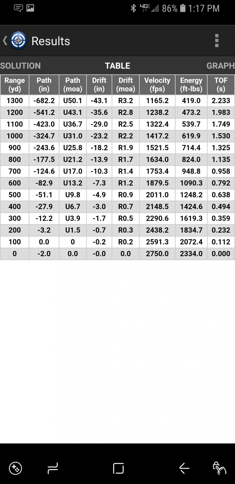

Right, so this what I would do for my 260 in my head: 3 mph = 1 moa at 500. So counting down would be
.75 at 400
.5 at 300
.25 at 200
.25 at 100 (because i know it's not zero)
Counting up from 500
1.25 at 600
1.5 at 700
1.75 at 800
2.0 at 900
2.25 at 1000
2.5 at 1100
2.75 at 1200
3.0 at 1300
I know I'll need more at 1100+ because the bullet is really slowing down at that point. I was just continuing the pattern for the sake of this discussion.
Here is what my calculator says
It actually works out better than i thought to 1300. There is some rounding and whatnot, but it works well.
When i do it, i think in quarters because that's what my scope adjusts in. My calculator spits out tenths even though I'm using moa. I just round to the nearest quarter.
1.2L ah ya, L maybe 3.5x that. I am sorry, I am ok with math. But during the match even though we all tried to help none of use did the conversions to him any justice. We just round the best we could ya, about 3.5-4 MOA? Nobody had the time to run real conversions. Oh ya, 1.2 on my 6mph gun he was running a 5 mph gun (if using mills) so now what?
