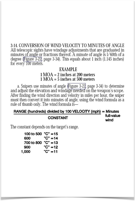

There are of course formulas for MOA also, but the math is just a bit more involved and less handy to do on the fly.
Nope, it's just as easy
For cartridges that fly like a 308: drift in 10 mph FV wind = (distance in yards/100) -1. Takes about a second to do the math in your head. Then you have to scale it for actual wind speed and angle, which you have to do for the mil wind formula as well.
Both methods require a shooter to accurately judge the wind in MPH first though. If you can't do that then none of this matters.
With the MOA formula, actual wind speed comes into it after you get your base drift based on distance alone. But I agree with your basic point: at some point in the process you have to be able to dope the wind speed otherwise you will never get the right answer, mils or MOA.

What hasn't been discussed is what method all you experienced MOA shooters use to figure the first shot. Is it different for a .223, .308, 28 Nosler, 338 Lapua? What's the unified theory of MOA wind doping?
