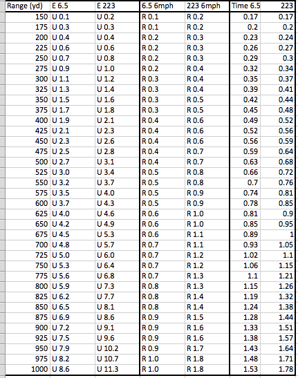

I was just talking to someone shooting Mammoth Soon so because it’s a team thing with two different calibers they have to speak in MPH
If 6.5 Shooter uses 1 Mil on Target X the 223 can’t translate Mils but he can MPH
Everyone kinda shares the first guys at FFP wind speed prediction or has their own in MPH, then translates a hold before the shot.
If both are on mills and the 6.5 guy needed X it fairly easy adjustment from a 6mph gun to a 4mph gun, because they are both using mils.. BTW at your own team match there were some guys with the teammates dope on their own arm board, fairly smart. They were also calling elevations instead of yardage so nobody could use their distance reads..
Now, if the 65 guy was on Mils and the 223 guy on MOA ya, no choice convert it all back to MPH or use a shared arm board..
Because it is a team event they can plan before the event.
Here's what I meant about an arm board for wind with two dissimilar wind values. Here is the 6.5 guys base wind with the same value on the 223 --- the 223 guy might do the same for his base wind of 4 mph and could reverse it with a 4 base effect on the 6.5.
So lets just say the adjusted FV prediction is 9mph at 650 for the 6.5 guy is .9// he only needed .6; Sliding up to .6 on the 6.5 guys wind would be 1 mil for the 223 guy. Same for the actual elevation for distance/gravity drop. This eliminates the need to translate distance or MPH after the initial call and shot.
