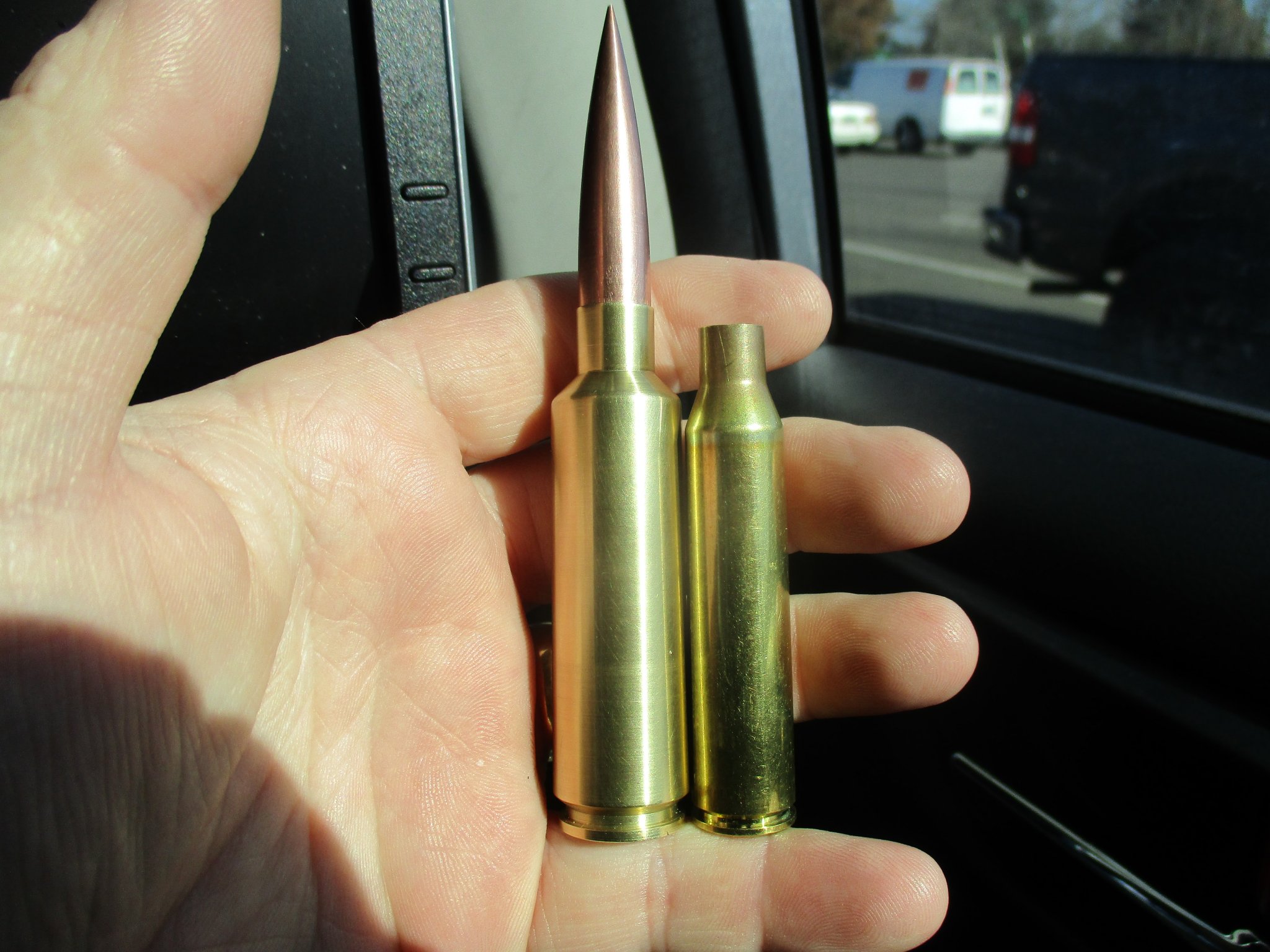

yes another monster in the works . brought to you By none other then BAGW and Sir SWAMPLORD .
It as well is designed to operate in our Blitzkrieg action as a change barrel cartridge .
its called the 408 COLOSSUS . designed to use our newly created 408 bullets from badlands bullets designed by sir Jason .
The cartridge is a little shorter then the 416 barrett and a little less capacity. but just like our 420 Blitzkrieg designed to operate above 80,000 psi running faster powders in the vv570 to the faster end of the bmg burn rates. all designed to solve the problems of extraction bolt thrust and bolt lift. that the bmg parent cases suffer from . while using a standard magnum primer giving a greater pocket life . designed as a repeater . case is only 2.850" long allowing for super long monster b.c 408 bullets and a 416 will follow based off the same case . Here it is next to a 338 lapua

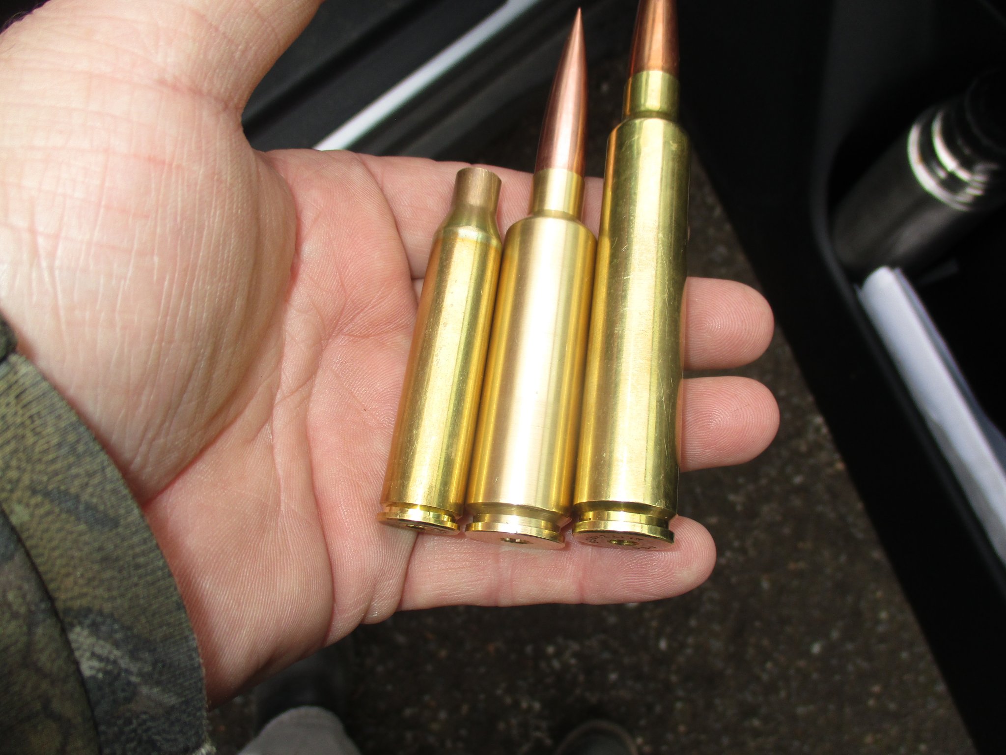

well we try. But we cant make every one happy. Some people love our stuff. while other bitch about barrel life. While others just scratch their head and there ass at the same time we were orig. going to make a 375 , 408 and a 416 off our ex-nihilo parent the blitzkrieg case shortened. but after crunching all the numbers we would not end up with optomized h20 in the length that would be mag friendly so we just designed a new parent cylinder to be shortened. the 375 mars will still be on the ex-exnihilo action and a photo of the blitz next to the colossus next to the lapua case
