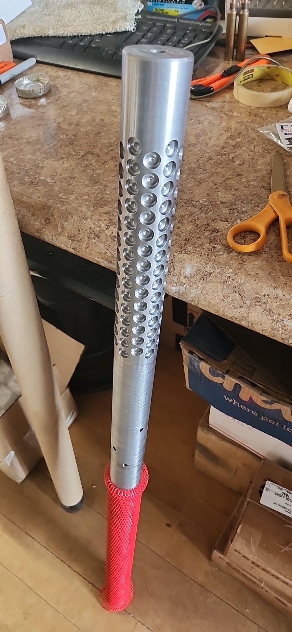

So in the case of drilling the parallel holes in the barrels for vibration purposes no 2 holes are the same at any point, in diameter and not parallel, they are not even round, on the molecular level..so the vibration control can never be repeated exactly the same, from one hole to the next or barrel to barrel... the more you machine the less identical they become...
Magnify what appear as round holes, as I have, they are totally out of round, jagged, and torn, where .0002" looks like a huge gouge. On a molecular level, nothing man made is perfect, and that's where molecular vibration operates.

If I take a mass, create features that limit unwanted directional movement, and guides a wave- back to the tuning fork.
If I take a round rod and drill holes in it each surface section or mass area (depending on how you look at it) is reduced as compared to a solid rod of the same weight. Reducing the ability of vibration to "go somewhere else"/become uncontrollable.
Ultrasonic tooling are not simple solid round tools. They have slots and specific shapes to guide the vibration- while it is not considered data here- specific computer programs are used to help optimize frequency movement.
The shape of our barrel has to- by physics - guide and direct a wave.
If our shape to guide a frequency wave front is "garbage"- back the the first example- just ignite your round. No barrel needed.

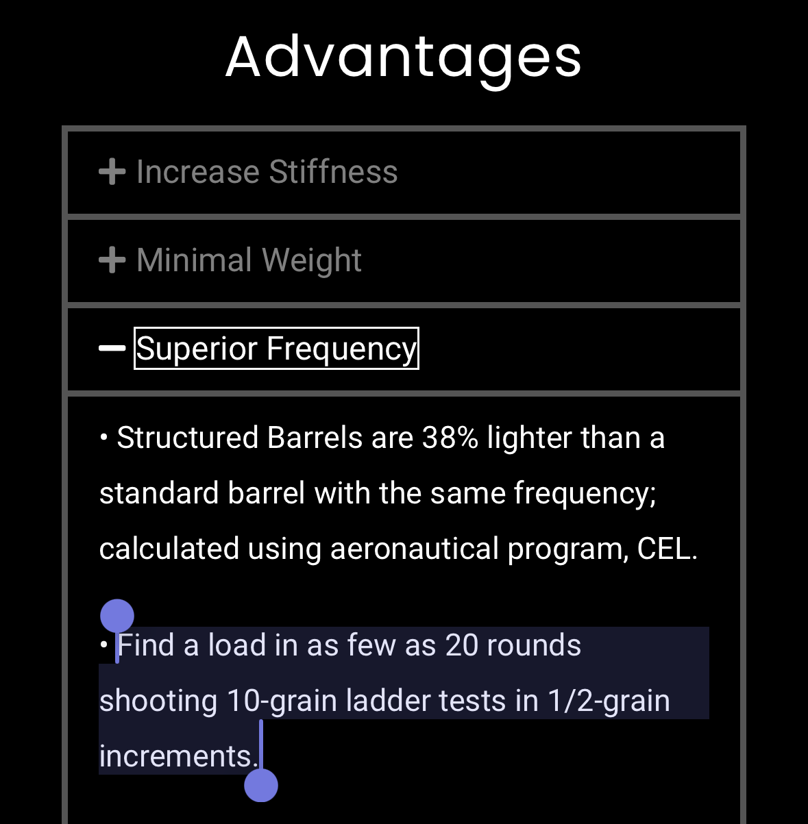

Actually - we have tried to only use data from 3rd party on all of our claims (potential). I recognize the complexity of this subject and the amount of testing that would be required to truly separate our data from others. Bryan actually went back to repeat the test some period later and brought a "better barrel" for comparison.
The test being conducted on the outside are directly related to direct comparisons to other weapons identical (as reasonably manufactured) shot at the same time during field testing. The weapons with our barrels rose (in their minds and data) to a level that noted "let's look into this a bit deeper".
We are not sophisticated enough to do the testing required. Yes- we can pull a trigger on multiple shots- but any data, in which we are the source, would be questioned. 3rd party all the way.

The FEA renderings were not done by us. 3rd party. I would say their software is at least equal to yours.
And bird bone structures are not stronger per weight than mammal bones. Your secret.

imagine believing in velocity nodes or that load development can be done in single round groups
Considering we have ran 20-50rd groups--- what sample size is good?
I have shot 20rd groups with my 300Norma-- what is a good sample size?
What sample size was Coastal Precisions groups?

You’re not going to find a load firing one round per 1/2 gr powder charge. Its just further proof that you guys either don’t know what you’re talking about or are banking on your customer’s ignorance.
I’m betting it’s a big mix of the two

What would a test look like that would satisfy your needs?
Honest question with no ill intent.
This wasn’t directed at you. The annoyance from all the reloaders yelling “statistically significant” when they can’t even define or show what that means while not even knowing that practical significance is more important. We can throw a sample size of 10,000 at a basic t-test and find a statistical significance of say a 3 fps delta. Wth are we going to do with that?
As far as designing an experiment generalizing it to a large population would be the problem. Right, because if you did an experiment with just say Bartlein but didn’t include the other manufacturers, then people would say your experiment wasn’t representative of the population of barrels. This also becomes an issue if you don’t include many different calibers, barrel profiles (unstructured), cartridges, bullets, etc. But most engineering experiments use some sort of factorial design. 2^k being the most popular. For instance, the factors and levels being structured, unstructured, and 6mm and 416cal. The the pain in the ass part is estimating the experimental error because if there are many combinations it will be costly. How many replications would be needed? I have no idea but a pilot study would help.
I think the most complicated issue of the discussion would be testing all of the benefits of the barrels that go beyond precision and MV. At the end of the day, people only really care about if they have a precise rifle and they have the MV they want. The barrel life increase is also something but that can be easily tested with a life cycle test of a few paired matched barrels of one being structured and the other being unstructured.
I get the sense you’re more interested in the causality. I’m good with statistics. I’m not good with material science.

Your response is exactly why we placed barrels into a variety of hands (beyond just standard buyers) running the gambit of .22 to 50cal.
Even my simple mind understands this is really complex from the number of input variables.
Overall my assumption is people who buy our barrels are not Walmart buyers. They most likely have skill set and at least learned something from a lot of experience. Something they can compare to.
I am looking for essentially non-standard variables in their performance.
While a few of the shooters have nearly plotted every round they have fired, look for season long aggregates, others are looking at items outside of strictly POI.
If I look at the fact that 2 of the last 4 Cold Bore challenges are held by our barrels (with only a couple barrels in comps), achieves a group putting them on a 15 shooter set that achieved a specific sub group size in comp (with gun that is 4lbs under weight), "shoots like heave barrel would", "only barrel to stabilize this round", "favorite gun to shoot", "obtained a velocity 150fps faster" -I consider those as non-standard variables. As more are achieved and repeated the non- standard moves toward standard. Instead of being on the edge of the bell curve- we start centering on our own new bell curve within the standard.
Don't shoot me (pun intended) if I misused terms here.
However-- a test. Test over time - varying group/shots taken per event- how many groups to show some sort of viability.
Yes- two barrels- One standard one Structured
I will reach out for your input.
