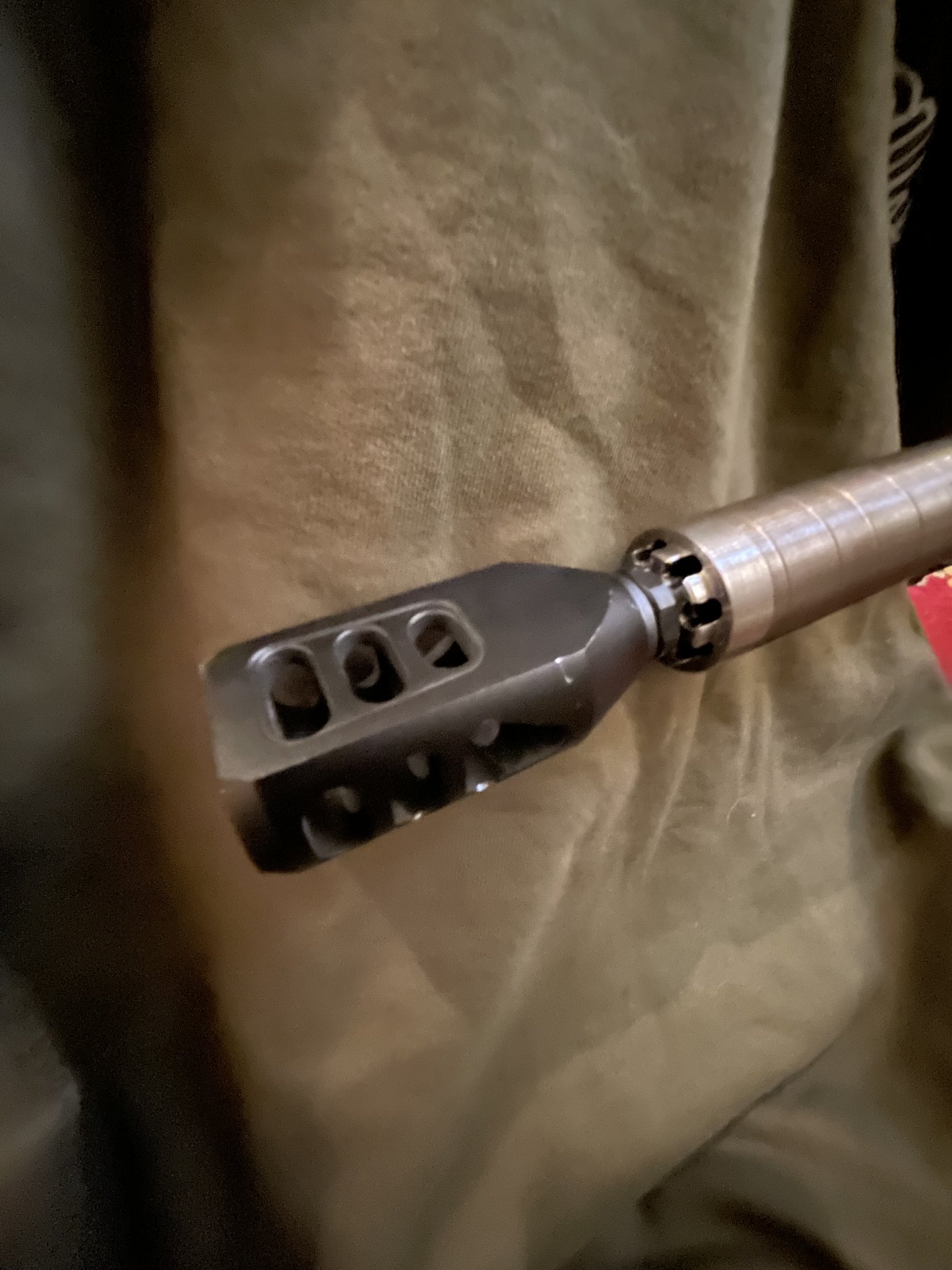

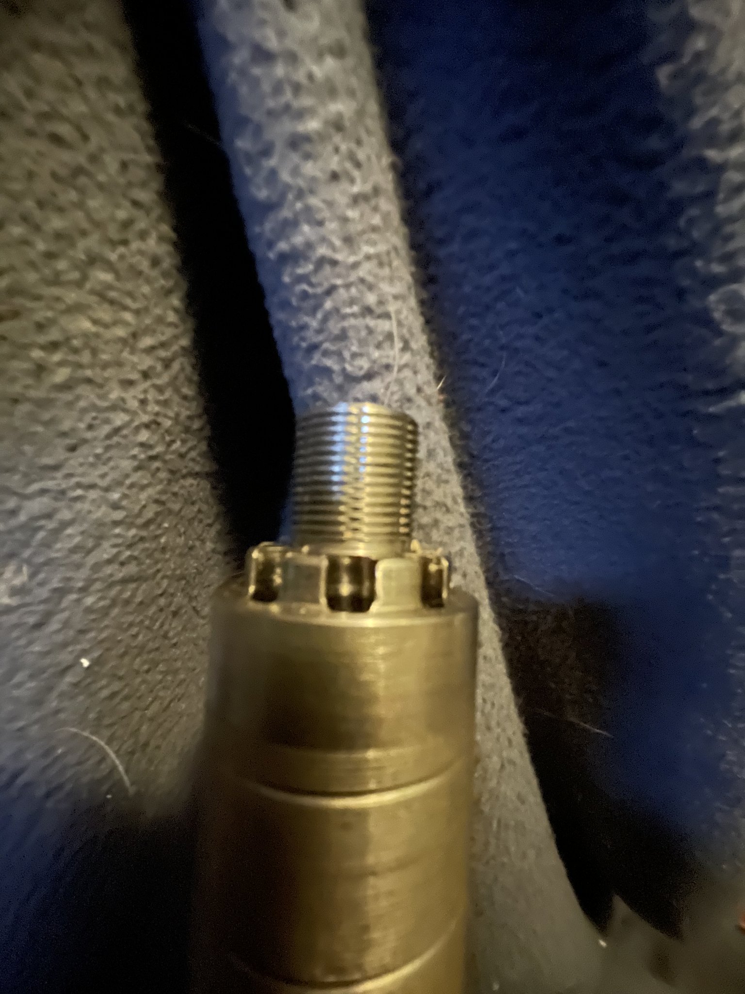

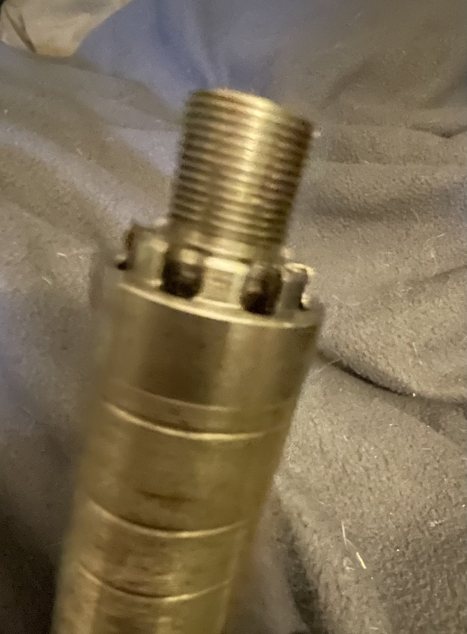

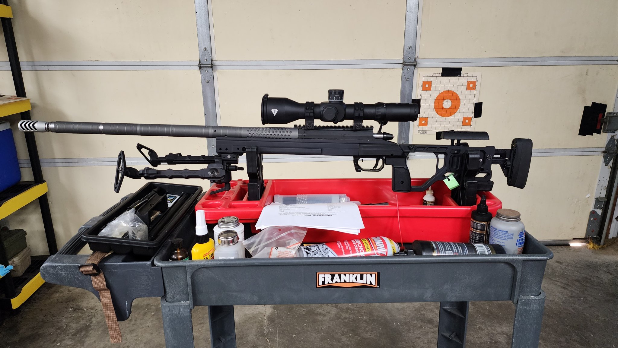

Yeah I don’t know the muzzle threads so have 8 slight depressions and the brake I have threaded right in and on and work fine
Maybe it is does something? Bad or good? But man! The rifle shoots really well so I don’t care
The intent of the grooves is to use the lower pressure at the muzzle to draw air through the holes in the barrel that are around the bore (Venturi effect), supposed to help in cooling. This would obviously be negated with the use of some muzzle devices, like suppressors.

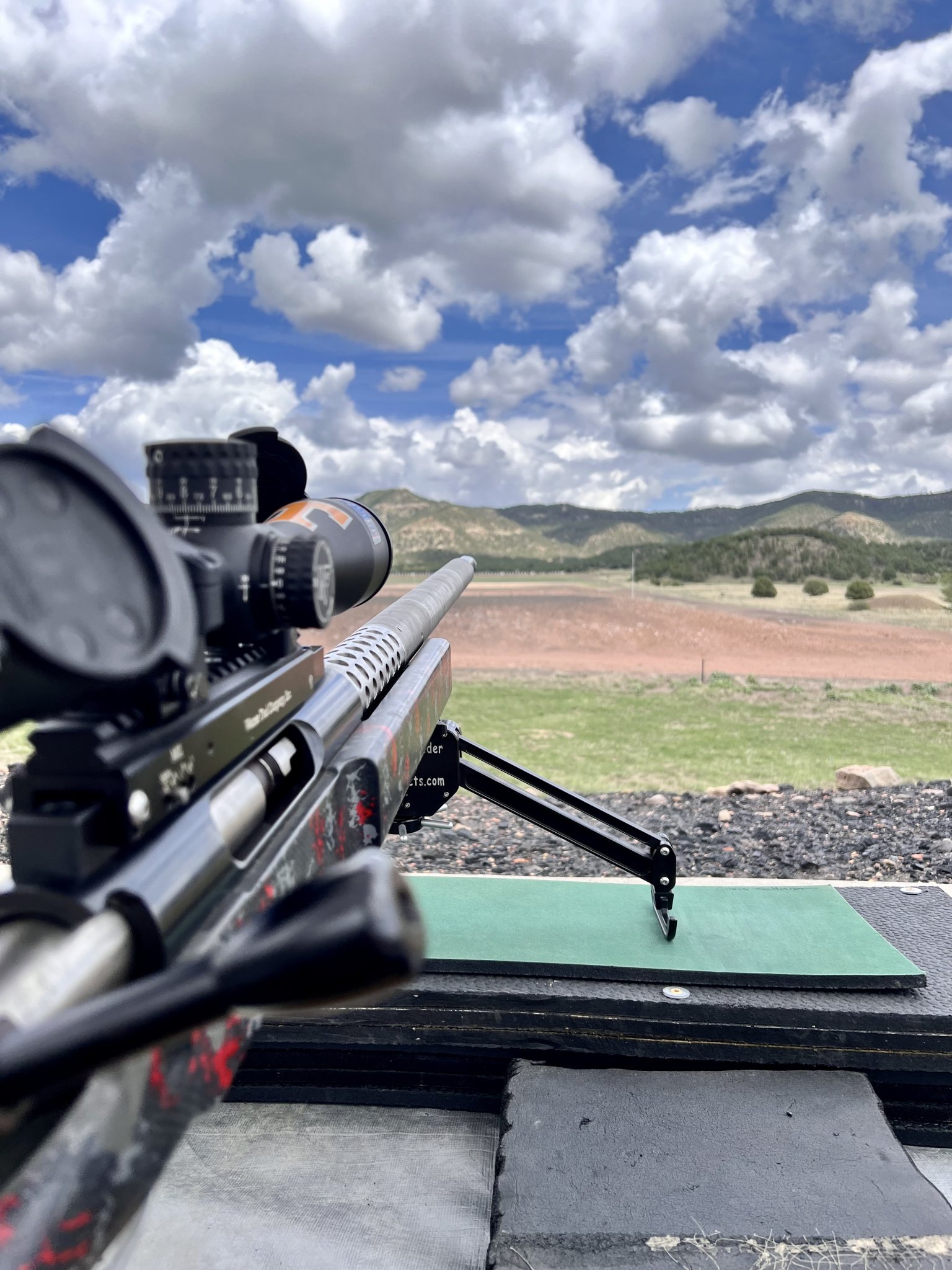

A recently testimonial- Military- ranked PRS shooter-
Hahaha. This will be two messages long bc of IG. Stand by:

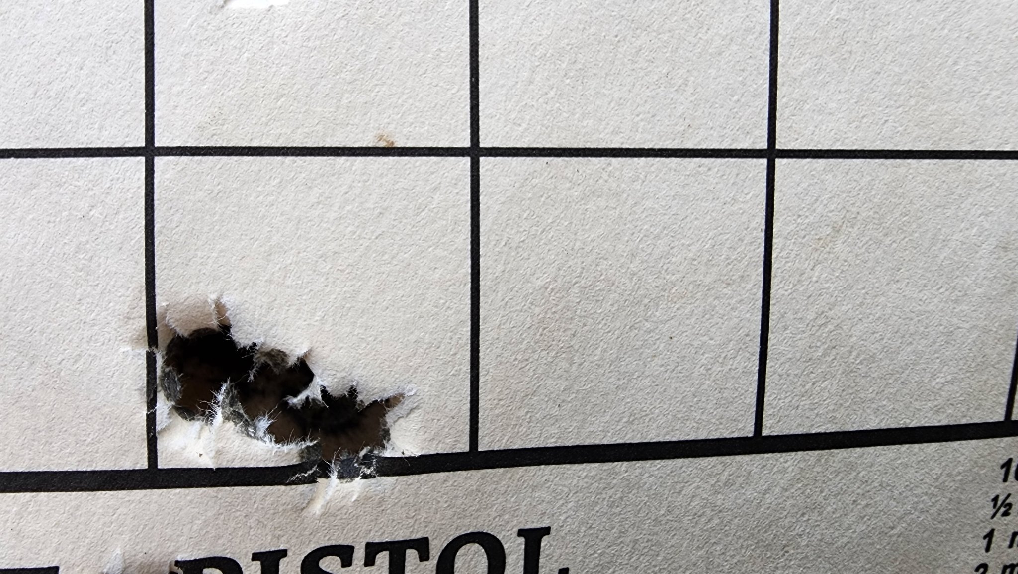

The idea of a hot-rod .223 came from my attendance at caliber restricted matches. I had to use a true .223 Remington, not an Ackley Improved or anything. I wanted to use 90 gr A-tips from Hornady to give me a competitive edge. Having tried the 90’s in other barrels several times with no success; I remembered the structured barrels from TACOMHQ and the claims they made about harmonic/node insensitivity.
I was easily able to find several nodes that would stabilize the heavy 90 gr bullet, including one node at 2800 fps with no pressure signs (only a 24” barrel).

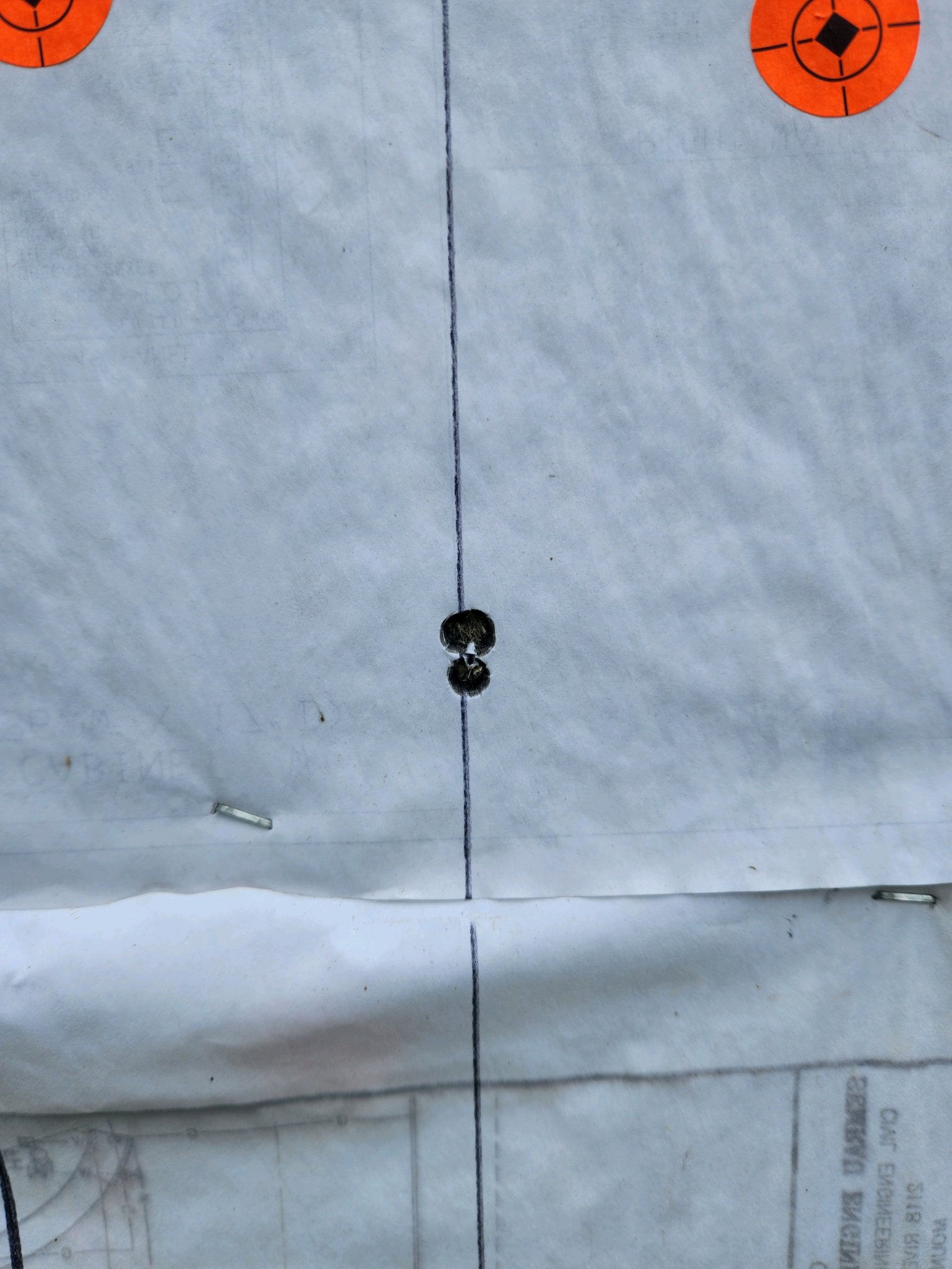

I’m pleased the 90’s worked out, but the thing that was the most impressive to me was what I found during the break-in process. I have several different types of .223 ammo from cheap bulk to match grade.
I fired all of it. It all shot well. Some obviously better than others, but the worst group was just under a minute of angle. Several match grade groups under 3/8ths MOA. The best group(s) being under 1/4 MOA with hand loads. Even more impressive than that was that it shot every type of bullet in the same point of impact. I’ve only ever had to zero my scope one time. I can swap ammunition, and simply change kestrel profiles and it’s a totally different gun, hassle free.
I often make the joke that I have the most accurate .223 in North America. I don’t know if that’s true, but I would confidently put it up against any challengers. I’m looking forward to trying more barrels in other calibers to see if it the magic holds up!

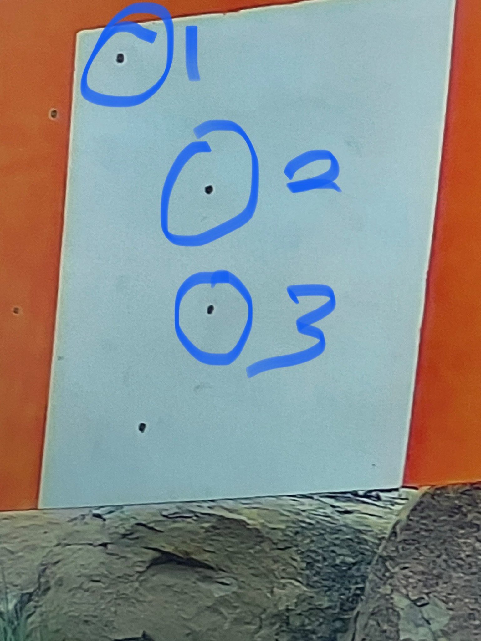

The same noted gun at 1000yds.

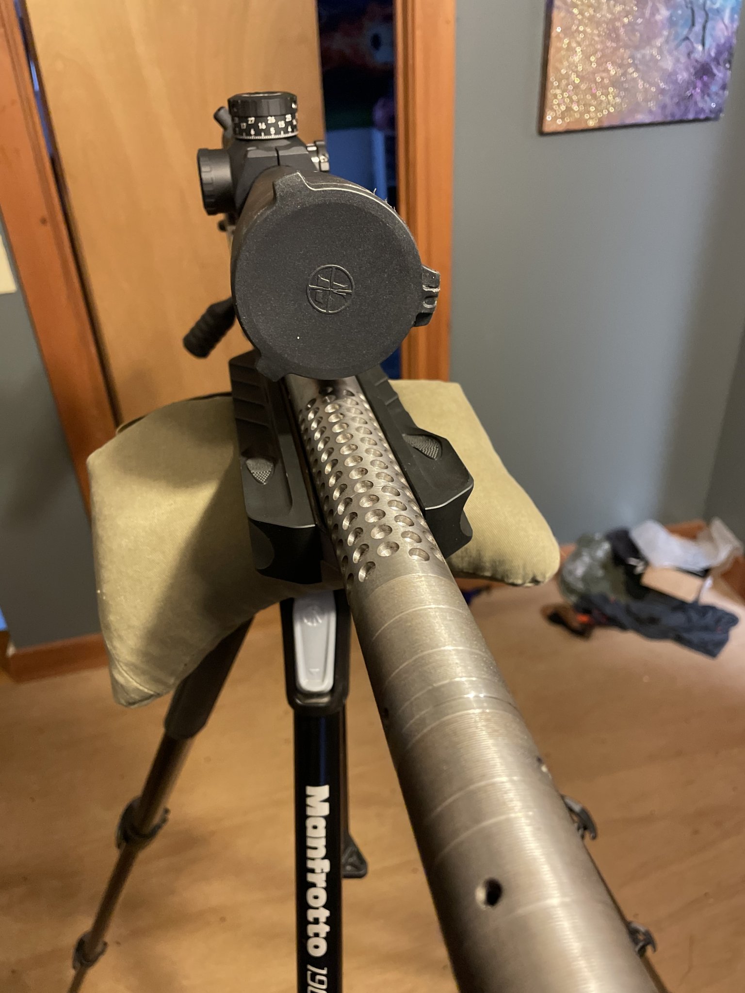

In many cases the muzzle thread will be interrupted due to the deep hole drilling event. We do recommend "plugging" them. Not due to strength concerns but to stop any gasses from traveling back up the barrel- and they do. We either fill with a JB Weld 24hr epoxy (using release agents and at least two applications) or we cut for a spiral lock ring and silicone o-ring sealing the brake onto itself.
Reactions: Crabnebula
Yes- the intent is to move air through the barrel. We have been working with third party (Helber in South Africa) on computer simulations and real life concerning brakes- we are moving air at up to 80fps through the barrel.
Yeah, that’s an easy enough thing to do. Although in the meantime, I have a muzzle brake with a crush washer, and it’s not showing any signs of gas running through the little indents on the threads for the muzzle brake. This is by far the most accurate rifle I have ever shot and I’ve been able to shoot a whole lot of very very expensive F class rifles, as well as military long-range rifles so I must say again Mr. John Baker awesome job. I am very happy with the outcome of my structured barrel.

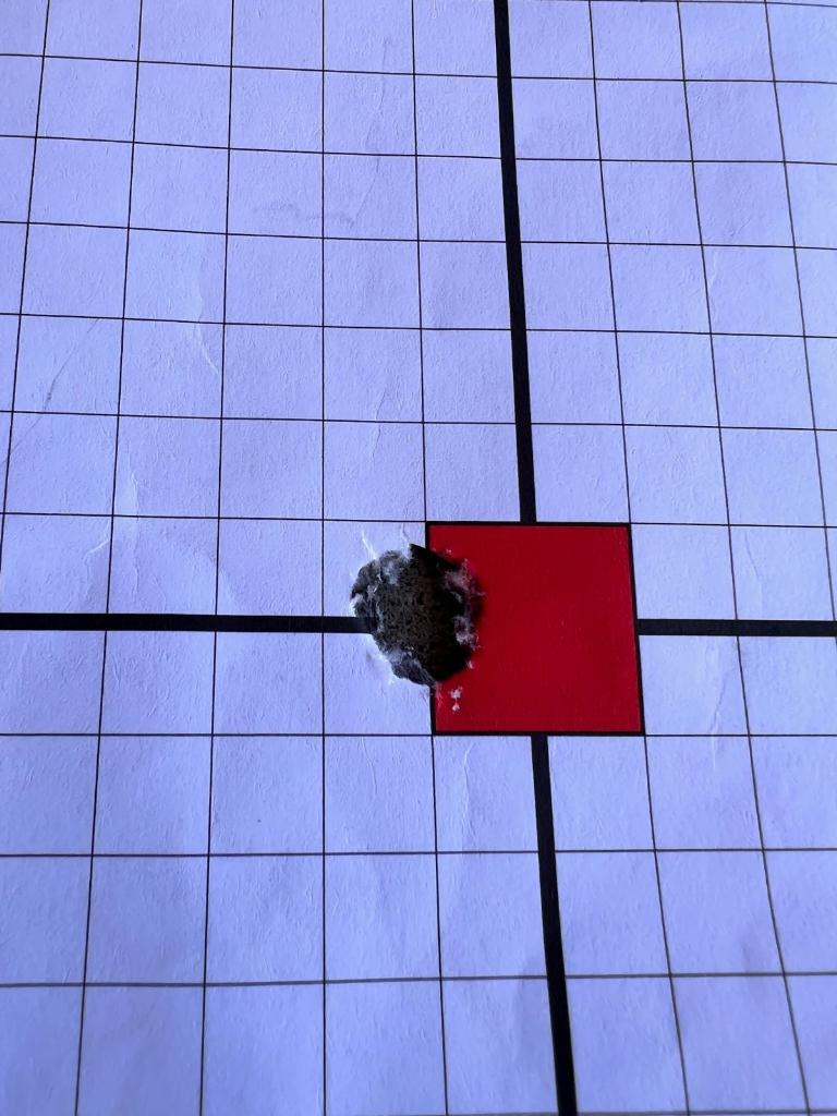

So been a while since I dropped by this thread. I didn't get as much shooting with the Structured Barrel this summer as I wanted. Just endless outdoor work at the farm. But I did blast off enough ammo to now have about 100 total rounds made up to test down in Oklahoma next month when I go down on a Hog Hunt. The ranch has a 1000 yard range and I'm bringing a lot of .300. Some for fireforming. Some that I just loaded up that is neck turned, etc.
What I can say is that the rifle so far is shooting better with 'junk' fireforming ammo that some of my rifles shoot with carefully-prepped match rounds. The recoil impulse for a .300 WM is... minimal. The repeatability is fantastic.
As for doing a 41XC on a structured barrel... Do it!!! Worth the wait. And it's definitely a whole new world has opened up with this technology being scaled into small arms.

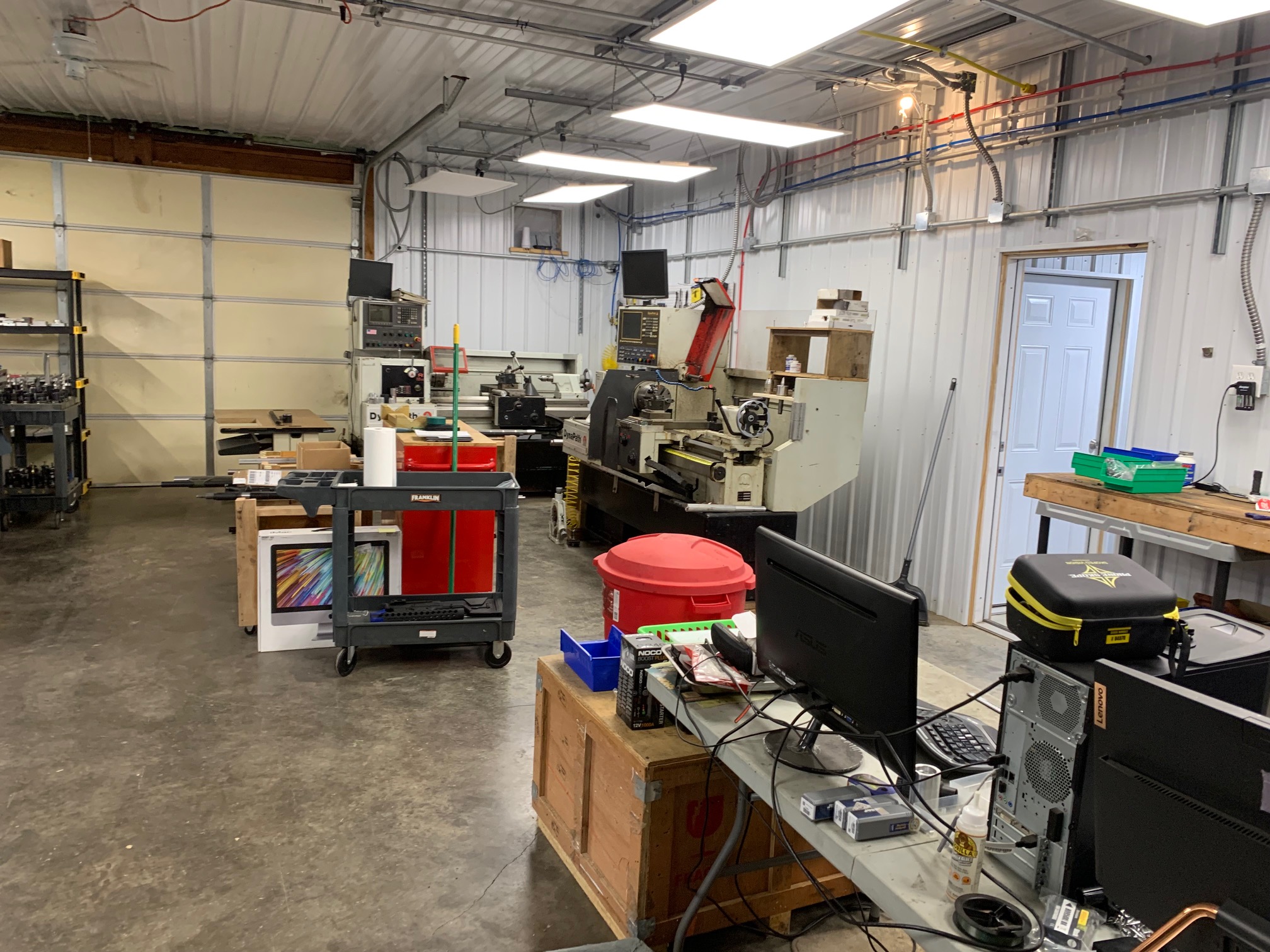

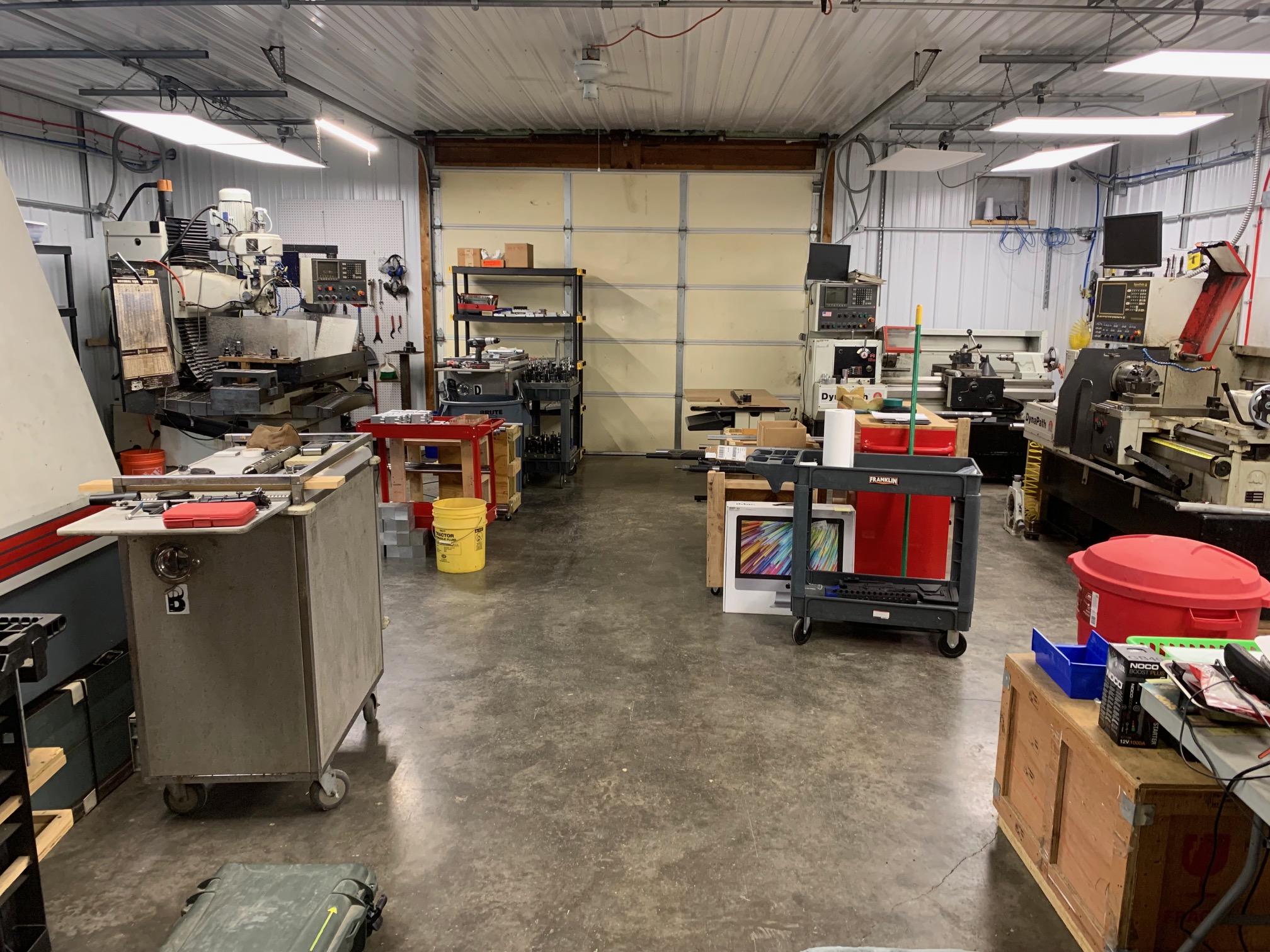

First, I came expecting a big 10 or 15 person operation. It's actually just John and his son in about a 6000 square foot shop near his home outside Fort Smith. That they are achieving the throughput that they are speaks to their work ethic! Because they are also making prisms for ELR hunting, scope protectors and working on some other proprietary stuff. The shop is neat as a pin. Everything is well-organized with barrels and names and customers all well-labeled and carefully stored. There is an on-site reloading area. And a number of projects in process. Also some of John's testbed rifles, which I'll tall about later.
A couple of CNC machining centers, lathes and some older manual stuff..

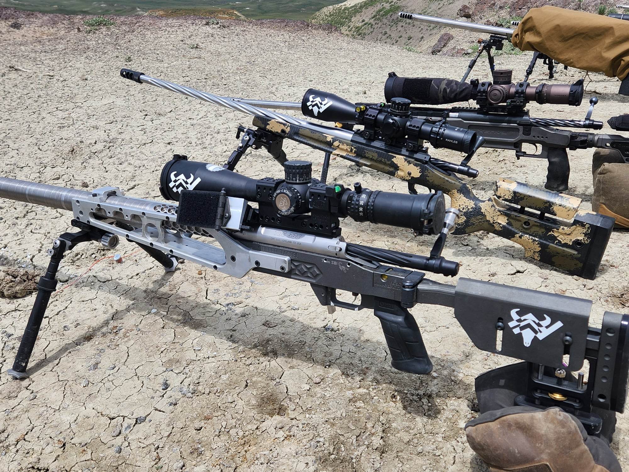

So the visit started with a quick shop tour and a look at several of John's personal guns. I won't go into details of some of the modifications, but from a technology perspective, he is treating the whole platform as a system with the barrel being one element. The things I saw on the R&D side are not only impressive, they are bleeding edge.
Conversation, while it was raining cats and dogs, went for about three hours and we discussed the gamut of things from vibration/harmonic mitigation to cooling to metallurgy to chassis design and I came away not only thinking that the structured barrel stuff is, as I have thought all along, a winning technology for ELR competition and the .mil world... but that we have not seen anything from TACOM yet. Also handled the prism's for the first time and they are really cool pieces of equipment. Does everyone need one? No. Do I need one. Not really. If you are starting to think about cold bore hits at 2+ miles or .mil applications... yes. You should be looking at this.
It's not for deer hunters... or 300 yard shooters. But that's not who the stuff is being made for. This is the absolute oleading edge of internal ballistics and will have ramifications for external ballistics for years to come.

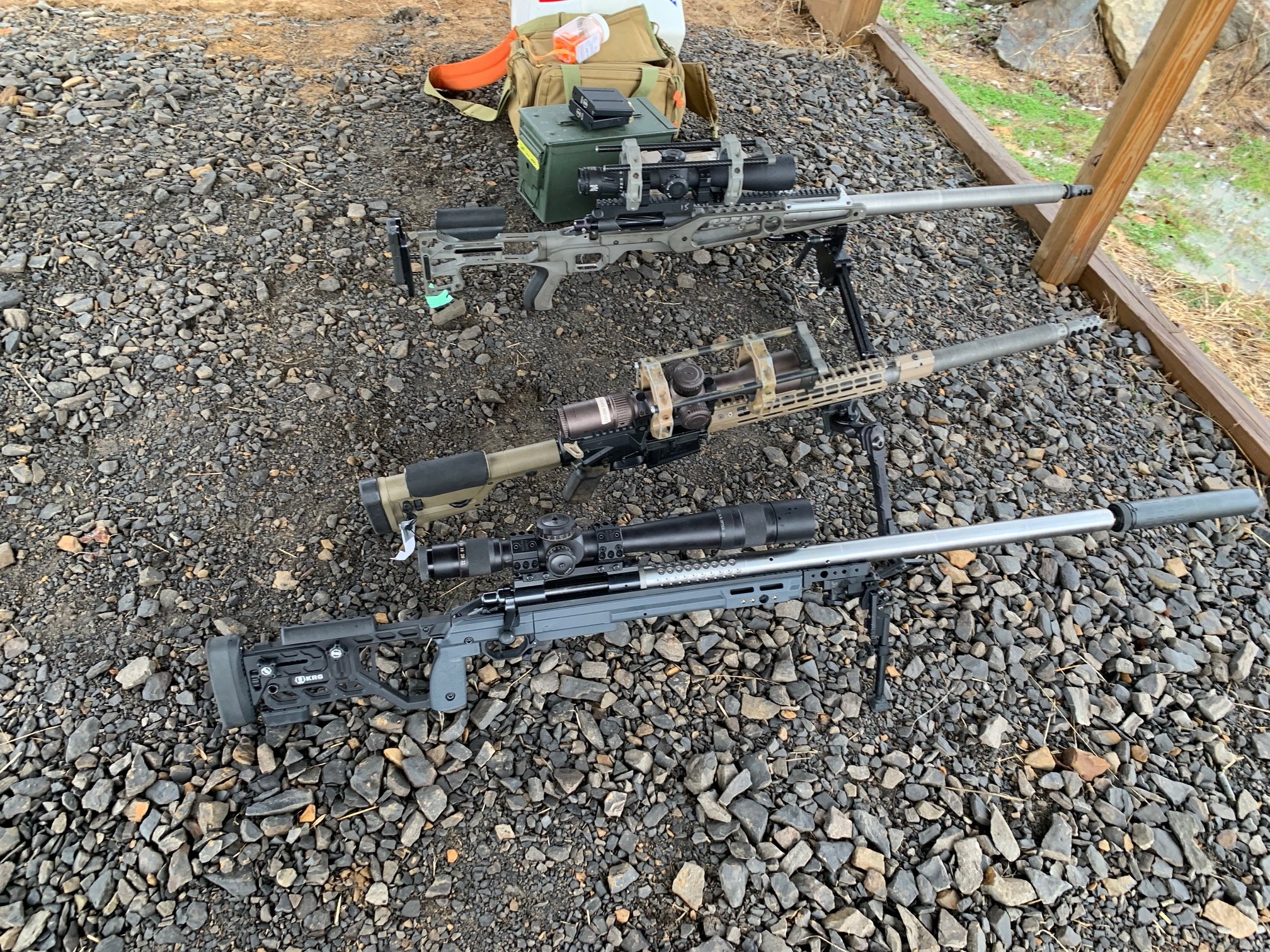

So once the rain slowed down, we got out three rifles. One was my Structured Barrel .300 Win Mag which I've now put about 100 rounds through. @pmclaine I think is the only other person here who has fired it. My ammo at this point is still 'fireform' ammo. But I am gradually building up enough fire formed .300 to do a batch of really tier-one ammo for it. John also broke out his .300 Norma Mag. (A caliber I lust after). And a .260 Gas Gun. First time I have shot a .260 in, I think about 8 years. Great cartridge that was going to be the next big thing then the 6.5 Creedmore came along and everyone jumped ship.
Front to back, My .300 Win mag. John's .300 Norma. And his .260 gas gun.

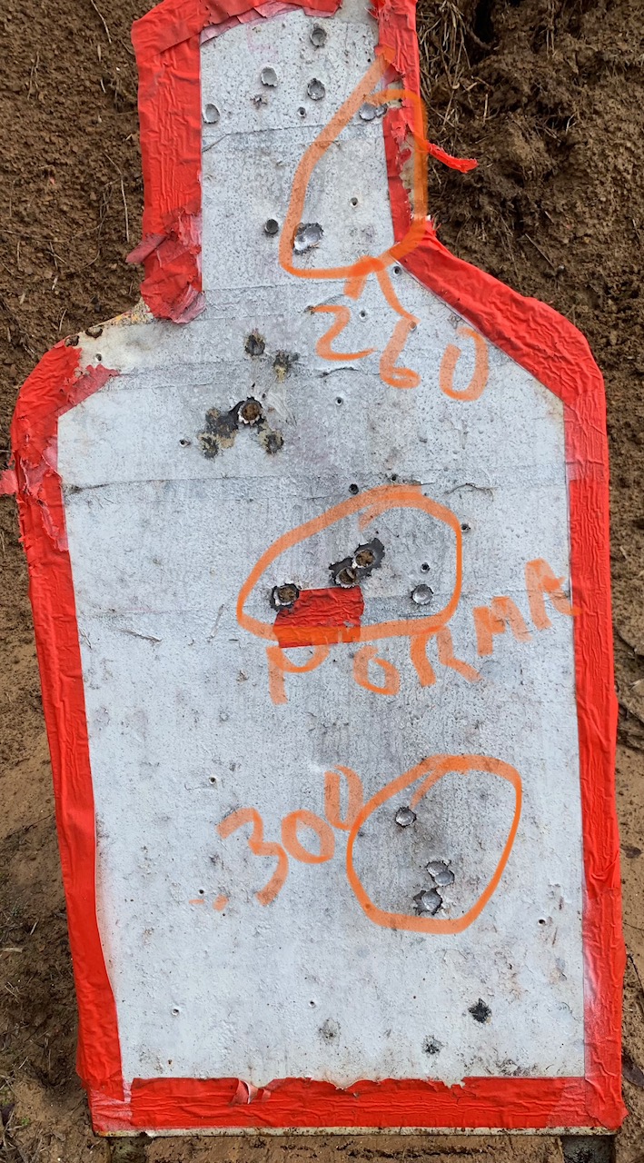

The rain had not totally let up when we started shooting and he had a con call and I had to get on the road to OK, so shooting was limited. First, I shot his .300 Norma. We had poor visibility out at the 400 berm (the longest at his home range.) And 15 - 20 gusting full value crosswinds from the right. (The house next door to him, BTW, was destroyed by a tornado three months ago.... his house is untouched. Reminded me that wind down here is serious...) The Norma didn't fit me great and I didn't want to mess with the stock, but got parallax adjusted, good magnification (wicked nice ZCO on that gun, BTW). I got four shots off. First was sort of a sighter. The next three gave a nice group. I have no doubt that if I fitted it up better and fired more rounds, I'd have really dialed it in.
As with my rifle, the recoil impulse is like shooting a .308. In other words, almost none. I watched the bullets splash on the targets. I could adjust my own holds. I was back on target well enough to see (not shoot) but see... before the bullet had hit at 400... Which is pretty impressive! Here is the target, BTW. I mixed up my aim points so we didn't have to drive out too many times in the mud (see yesterday's post). BTW, the Norma 'sighter' is not circled. It's high center mass a bit to the left... the only other hole we put in his steel (Sorry John!) The next three shots are near the rectangle. My wind calls account for the spread, methinks.
Next tried the gas gun. Again, unfamiliar, but at least I shoot AR-10 platforms enough that it was pretty easy to tuck into. Forgot what optic it has. But, again, got my parallax set and figured I'd go for the head. First shot just clipped the 'neck.' Second I got it centered up better and then 3 and 4 were using a bit of 'Kentucky' Windage and were touching. If I had not run out shells in the magazine, I don't think I'd have had a problem keeping them right in that spot. Again, the structured barrel with the gas gun was interesting. Very dead... little or no recoil. Very apparent that the last round had fired because the bolt impulse was 'more apparent' than it is usually. You could feel the difference easily. Not that sort of 'subtle' I'm Empty feel. I'd actually have liked to fire this one for several magazines, but time was running out. Even though the rain was stopping, the wind picked up even more. BTW, I think 2 is to the left of the number... and partly off the picture. The one to the right of the 2 is an old strike. John Baker may have a better picture.
Last, I shot my own gun. The .300 Win Mag. with Structured Barrel. As I mentioned, I only have about 100 rounds through this and am still fireforming. The experience remains the same. Almost no felt recoil. I had a suppressor on this and that made an interesting 'feel' to shooting it, because I didn't hear the shot or really 'feel' the shot, but heard the crack of the bullet bouncing off a stone wall to my left much louder than the shot. And then the whack of bullet on steel. Again, everything the structured barrel is purported to do and has been described from the earliest pages... yup, it's doing that. I fired two sighters (actually my first round hit the ground... my turret had gotten twisted probably when I was showing the rifle to someone last summer...). But brought back to zero and put round one about where I wanted it. Then settled in and fired off four more kind of quick shots before John suggested we drive out and look at some groups. He was spotting and my last four shots he kept saying "I think you keyholed your last shot.) 4 of 5 went into about 1.5 inches at 400 and, again, I was back on target fast enough to watch the splashes. Recoil, compared to my Mk 13, was almost nil. Like shooting my very heavy TRG-22 with match .308. My only surprise with this string was that it is one of the longer distances I've shot this and how easy it was to just shoot fast and know the round was going where it was supposed to. No need even for a spotter. I saw them hit.
So a handful of rounds in the rain doesn't make or break a technology... But shooting two other (albiet unfamiliar) rifles and getting the same results certainly speaks for my rifle not being a fluke. THe more important part of the day was the conversations with John and his ability to digest and respond to some of my more probing questions and observations. There was also no hesitation to explain or expand on a question. No humming and hawing. No snakeoil sales... this is a guy who gets the technology and can talk to a molecular level... a math level... a materials science level... he knows all the barrel makers and their in's and out's and how to maximize the structuring process on each. He gets machining, again at a microfinishing level that is required to understand how this stuff performs. And he has a passion for it.
A couple of CNC machining centers, lathes and some older manual stuff.. View attachment 8076160

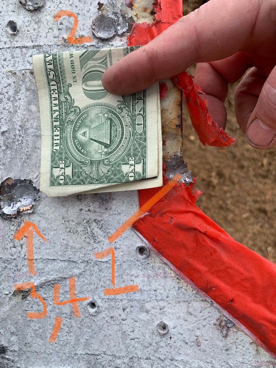

A couple of pictures: our 300WM with a Bartlein barrel in a 12-8 twist and its 200yd group during sight in (rds 4,5,6). Front bipod and rear squeeze bag. The brass is once fired brass from another gun. 190Sierras MK.
The itty bitty clean punched holes are from a 7mmSBI shooting a 190Atips at 3036- during load work up- 4rd groups. Gunsmith John Mills. IMG_20230612_123513.jpg7mm target.jpg300WM target.jpg300WM TRG.jpg2878yds.jpg
Another shooter at the NF match shot a sub 2" group at 1005 and did exceptionally well on the second day (more later) 338 EnABLER shooting a 275gr Badlands Bulldozer at 3230. The barrel had 650rds on it before the match and shot the sub 2" group at 800rds.
More later on a 1000yd bencher later- light class (4lbs under) "shoots like my heavy barrel". "Can you add weight?"

Reach out to me [email protected]Image.jpeg A recent 4rd grp at 100yds (at Raton NM) . .416 Barrett the barrel has 850+ rds on it. Same gun that was used for the cold bore record. This is a few levels up of shooter capability.
We are always open to constructive visits. A bit of shooting too. What are you thinking about for a barrel?
Reach out to me [email protected]View attachment 8171743 A recent 4rd grp at 100yds (at Raton NM) . .416 Barrett the barrel has 850+ rds on it. Same gun that was used for the cold bore record. This is a few levels up of shooter capability.
John Baker is a highly intelligent man …. Way further up the chain than I. The structured barrel that I have has really been special, and we are in the process of getting additional barrels ready for the next couple years of ELR.
The three biggest differences that I have seen compared to my other traditional barrels has been 1)forgiveness 2)lack of verticals at distance, and 3) the cooling benefit(s). Also, I have a clearer site picture because of the machine pattern cut in the barrel: the machine work breaks up the barrel mirage.
Sending 13 (416 rounds) down the tube in less than 6 minutes really puts John’s machining technologies to the test …. Consistency at great distance requires or demands that any vertical dispersion be limited; very limited. To demonstrate or acknowledge the benefit … after the three record rounds/impacts at 2,874 yds; we had to transition to two additional targets while being on the clock. 2650 yards and a return back to 2874…. The barrel performed again at 2874 yds with three more impacts (1,2 and 3rd round). A structured barrel does perform, and perform well deep in strings of Fire (550 grain bullet/middle 180 grains of powder)
