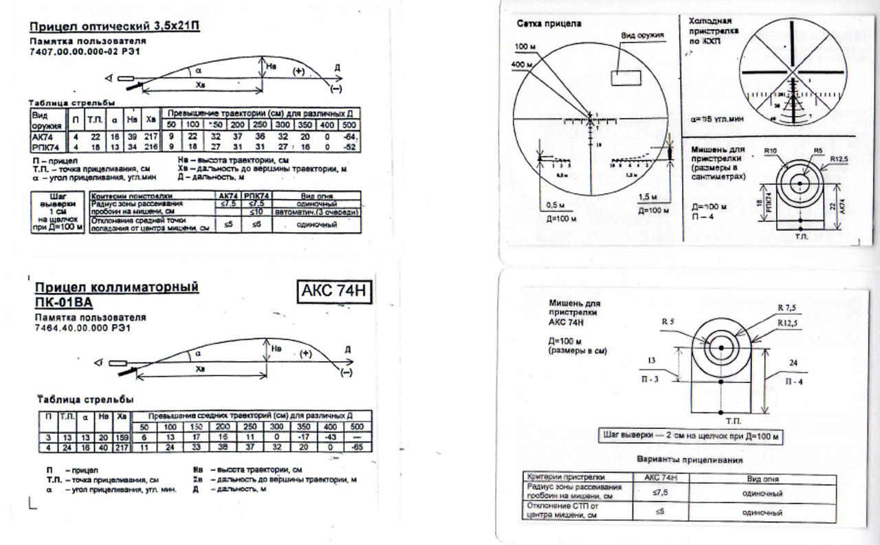

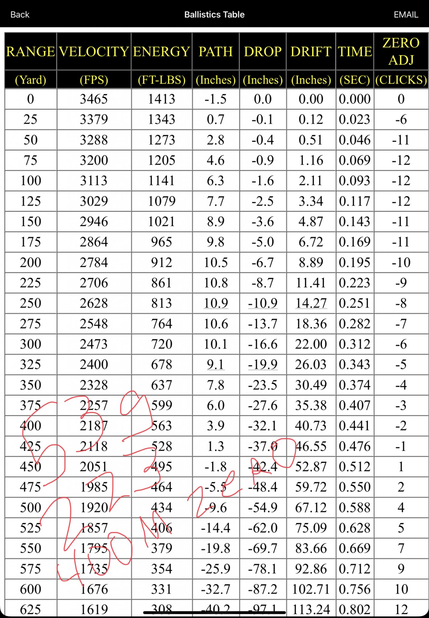

Watched a recent 9 hole review on the ak74 on YouTube. They explained how the Soviets used a 400 meter zero to great effectiveness.
Has p anybody tried something similar?. I put the numbers in my ballistic calculator and I was impressed with the numbers it put out for a 223.

How about some details? What's the max ordinate and at what distance does it occur?

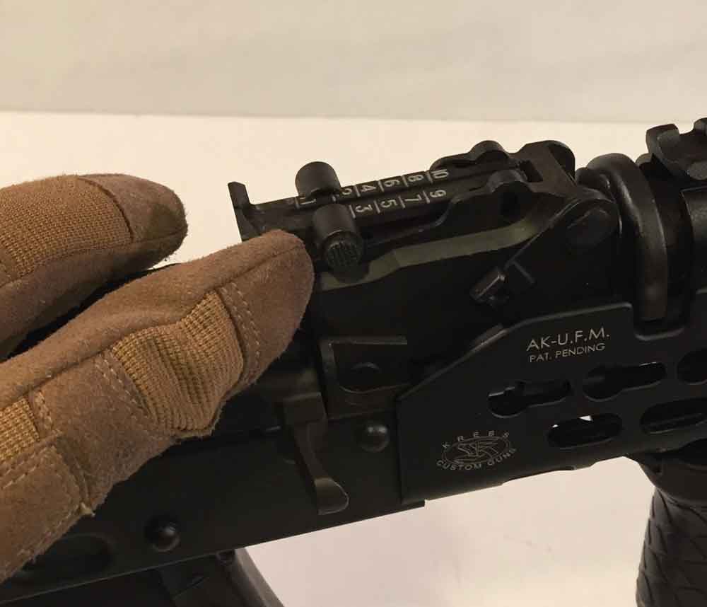

If a Soviet soldier needs more precision from his AK at closer range. He simply slides the rear sight from 400 to 100
