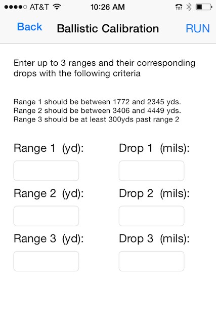

I am having some issues with the app.
1. Are the profiles editable? I hate to have to make a redundant profile to change MV.
2. AB shows my come up at 1000 yards with my .308 155 scenar MV of 2867 to be 6.2 mils..... I wish
3.I looked at the validation screen and it is asking me to shoot 3000+ yards!
What am I missing?
What am I missing?

Best news: I now have an almost perfect fit between my observed data from last day on a long range covering 9 different distances out to 1025 yards with SMK 175's on both G1 and G7. Outstanding.
New bug? While my scope is available, entered, set to 1/10th mil clicks I get the following:
1) HUD readings are in tenths of Mils with the correct click counts;
2) Reticle view is in MOA with the zero adjustment in Mils.
3) table view is in MOA.
4) Graph shows the left X axis in inches.
For now I'm happy with the HUD view but something is obviously set wrong. My scope that I selected is the Vortex Viper PST FFP mil mil with an EBR. Every time I go back to the edit rifle and check the scope selection it seems to default to Mildot
Hope this helps.

Hey guys - just noticed an update has uploaded.
Hope this helps.
Thanks - we'll take a look at this and try to replicate it.
