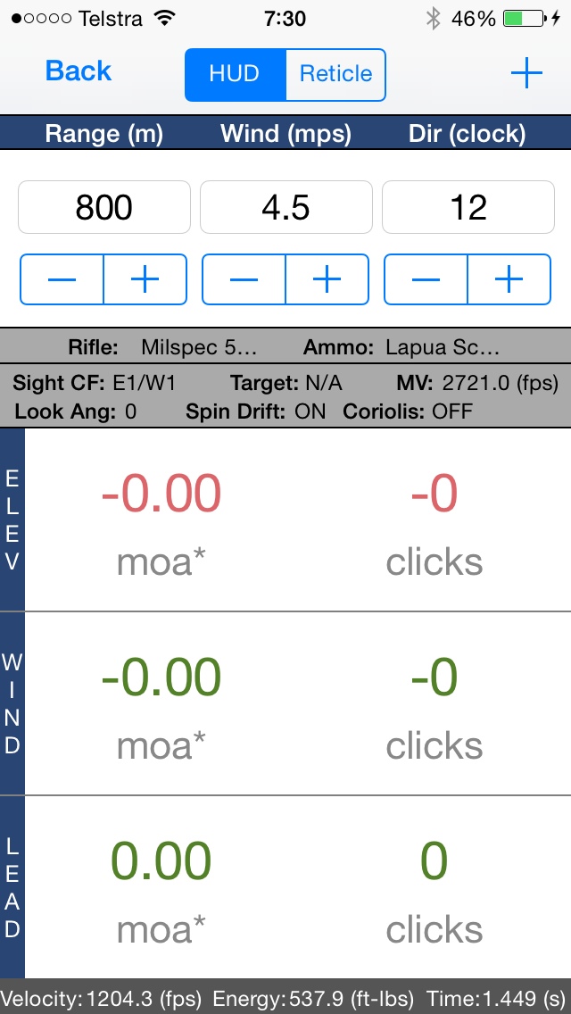

After the I installed the update I no longer get a solution after I put in all my info. It goes to the solution screen and displays zeros in all the boxes. I've reset my phone 3 times and the problem remains .
My tables still aren't right either. Wrote in here a couple weeks back on 7/27. My HUD readings work perfectly but the tables and reticle views are both still hosed up.
I've found I can get by with the HUD and my environment reads in to that perfectly which does not seem to be the case for others on this string.
Just guessing here. Under your rifle settings you wouldn't happen to have your elevation and wind correction factors set to zero or something different than "1" would you?
The other thing that goofed me up at first was I somehow had "Disable Calibration" checked and since it's below the screen edge where you enter your observed shot data nothing would change. So if that was checked before you ever entered any data I could see getting zero in all the HUD fields like you showed above.
Thanks for the advice CH Luke , I checked & my correction factor is set to zero . I have checked & rechecked everything about 20 times and still cannot get it to work . I've got coldbore on pda but I'm a bit disappointed I payed $30 for an app I can't use. Thanks again for your help mate .
