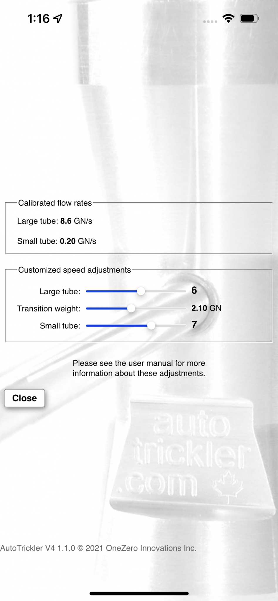

I've attached my settings. The 'twice calibrated setting' picture is what the app defaulted to. This setting would result in overthrows 75% of the time and has had the same result over 3 separate reloading sessions across a months' time. I've had to tune the large tube setting down to 1 which is shown in the "Modified Setting" picture, which only overthrows 1 of 10 times approximately.
The V4 ran great to begin with, I don't know what changed this. I'll have to double check to make sure my scale settings didn't magically change.
I only see this screen under “settings”.
How do I see the screens you show?
I’m using the app on a new iPhone fyi.

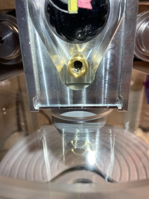

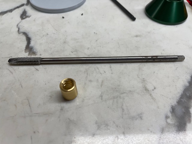

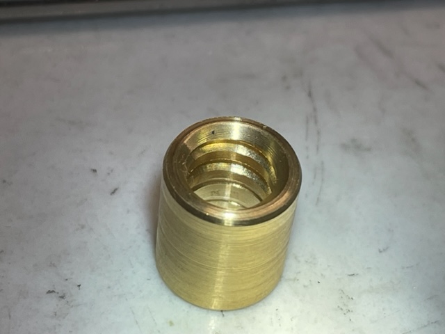

First off I want to publicly thank Adam for his outstanding customer service. I had a small issue related to tolerances, I notified Adam and he sent me a replacement part out immediately, thank you Adam, fixed the issue.
Now I just wanted to give a heads up to you guys out there that may want to try this out, it fixed my issue of having to adjust tilt by using shims on any of my powders( N570,RL33,H1000, Retumbo, Varget, 4831sc, N555).
What I did was use a extended 1/4-20 tap and tapped the full length of the small tube, now it acts like an auger the entire distance, keeps the tube full all the way to the end. Bought the tap at MSC.
I also made a tip using a .075 wide full radius ID grooving tool on the ID, set at a 8 pitch thread setting. That 8 pitch groove feeds individual kernels really well.

View attachment 7878372View attachment 7878373View attachment 7878374
I had the same idea but was much to big of a pussy to try and remove the small tube and tap it. How hard/easy is it to remove the small tube?
Minimal amount of foul language needed. lol Just loosen both motors, pull the large tube to gain access to the small tube drive gear. Loosen 2 set screws on the drive gear hub then slide the tube out the back. The hard part is re inserting the small tube through the drive gear along with the 2 nylon washers( one on each side of the drive gear). Then re tension the belt, repeat with the large tube.
