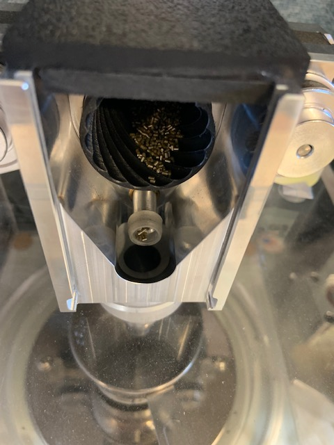

The damn threads in that small tube make it stall for what seems like forever on logs of RL33. I wonder what reversing the threads or making them coarser would do. It is capable of throwing 100 grains of RL33 in like 12 sec but it takes it 30 seconds if it’s waiting for that last kernel or two to make it down the small tube
Reactions: BCX
It’s honestly bad enough on RL33 that I’m going to hand trickle the big stuff till there’s an improvement. A uniflow set to 99.7 grains and I’ll trickle the last .3 and beat the V4 every single effen time
tap the tube through with a 1/4-20, works like a charm, almost too well.
I saw your post on that. Are there any downsides? Has Adam commented on why he chose the threads he did in the tube? I don't want to "fix" it for large bore stuff and then later realize I broke it for another powder...

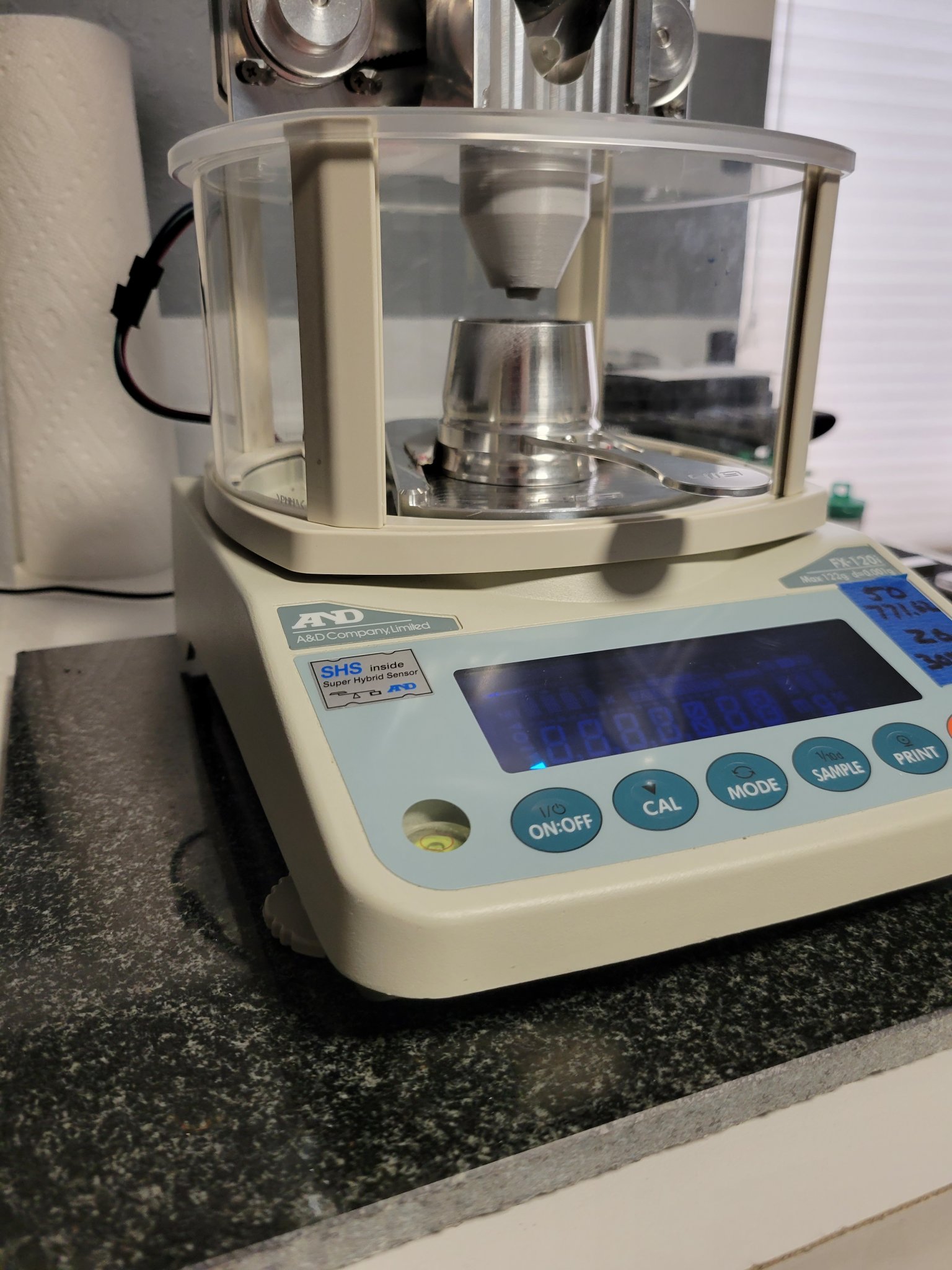

My V3 used to have drifting issues. I've done the following to stop it.
1. Use a granite block base with anti vibration feet.
2. Power conditioner.
3. Side plexiglass panels to block drafts.

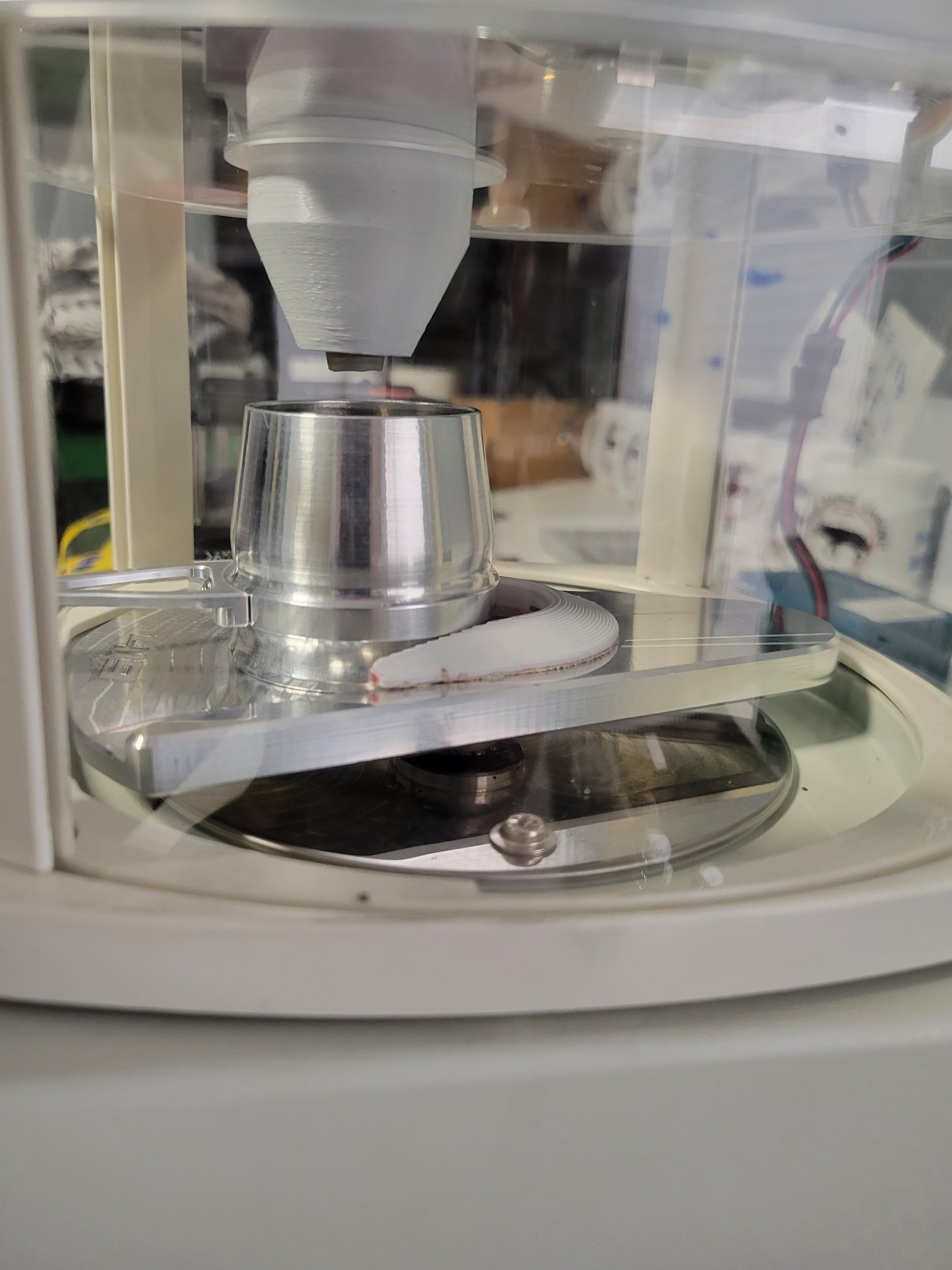

4. Started using an aluminum powder cup instead of the supplied glass cup. This seemed to make the most difference and I'm guessing it was due to static build up.
5. Use a calibrated weight to check calibration before and after letting the scale warm up for 30 minutes. Sometimes there is a difference after 30 minutes - if there is I power off the scale and then power it back on and recheck calibration.
6. I have nothing on the scale when I power it on. I used to power the scale on with the powder cup on it so it would zero with the weight of the cup on it. Now I place the powder cup on the scale after it has warmed up and then hit the zero button to get it zeroed with the powder cup on the scale. Using this method when I remove the cup it will register a negative value. I note this value and if the scale drifts that value will change so I know. Usually if it does change it means I have a kernel or two that popped out of the cup onto the scale.

Granite blocks with feet and aluminum cup - forgot to mention those, good points and I do that too. Also not storing cup on scale and letting it warm up with nothing on it, I think those things make a difference too.
You are correct, I mostly use RL33 and N570, so making the mod for smaller kernals may not be benificial.
Sounds like a tube with inserts for different powders would be the ideal way to do it

Which aluminum cup? I have read about issues with the shorter aluminum cups.

Most of us use the 419 cup. You should read through my "static is driving me crazy" thread. Lots of legit info in it for set up

Area 419. I also drilled V4 funnel and inserted a tube tip that is cut down a little to ensure it does not clog. I have no splashing issues.

It's a glass cup, but has a plastic handle. I wouldn't have thought it would be an issue either, but tested using both cups and the glass cup would drift and the a419 aluminum cup didn't. I had to swap back and forth multiple times to verify the issue because I didn't believe it at first either.
That phenomenon been documented by many. The aluminum cup is the way to go.
