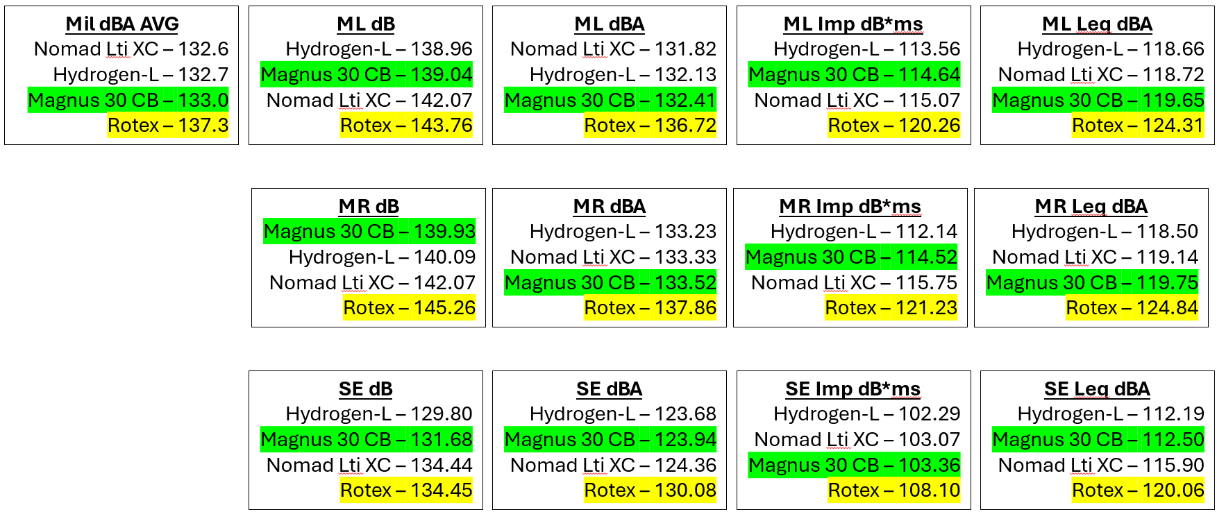

If maximum suppression is your goal (which makes sense on a bolt gun), then check out these Silencer Summit Results.
Thank you.
Which measurement is more important to be comparing?
It seems that the B&T SD762-Rotex (which, when I search comes up with links to the Print-X Rotex 762 full size I referenced in the title) is comparable in most measurements to the Magnus and the Nomad LTi XC.
I think I was mistaken in my earlier assessment of the B&T SD762-Rotex being comparable.
If a 3dB change in measurement is doubling the noise level, and a 6dB change quadrupling the noise level, it seems the B&T is substantially louder than the Magnus.
The B&T is louder than the Magnus 30CB, Hydrogen-L and Nomad LTi XC.
Math makes my head hurt. If I'm misunderstanding the numbers - please let me know.
As a shooter, am I correct is assuming I am more interested in the shooter's ear (SE) sound level in this comparison?
Yes, shooters ear is a good measurement, more useful on gas guns than bolt guns. All else being equal, the more volume, the quieter the can.
