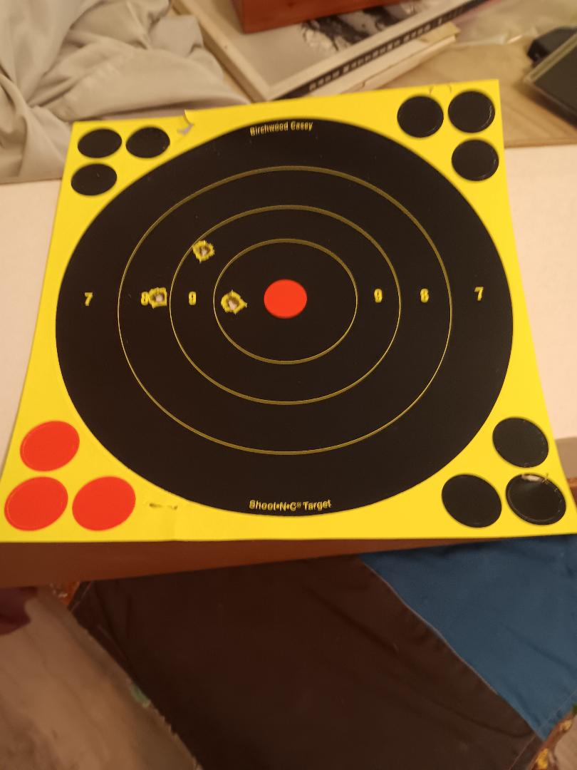

Not all Bergara's are Bergarbage. Just shot this at 200 yds a couple hours ago, same Bergara HMR in 7mm PRC. Ran out of ammo so its only 3 rather than 5.
Measures 1.25 center to center, so thats just above .5 MOA. The wind was whipping pretty well or I think I could have tightened it up a bit. It's also hit just outside 1 MOA at a mile.
