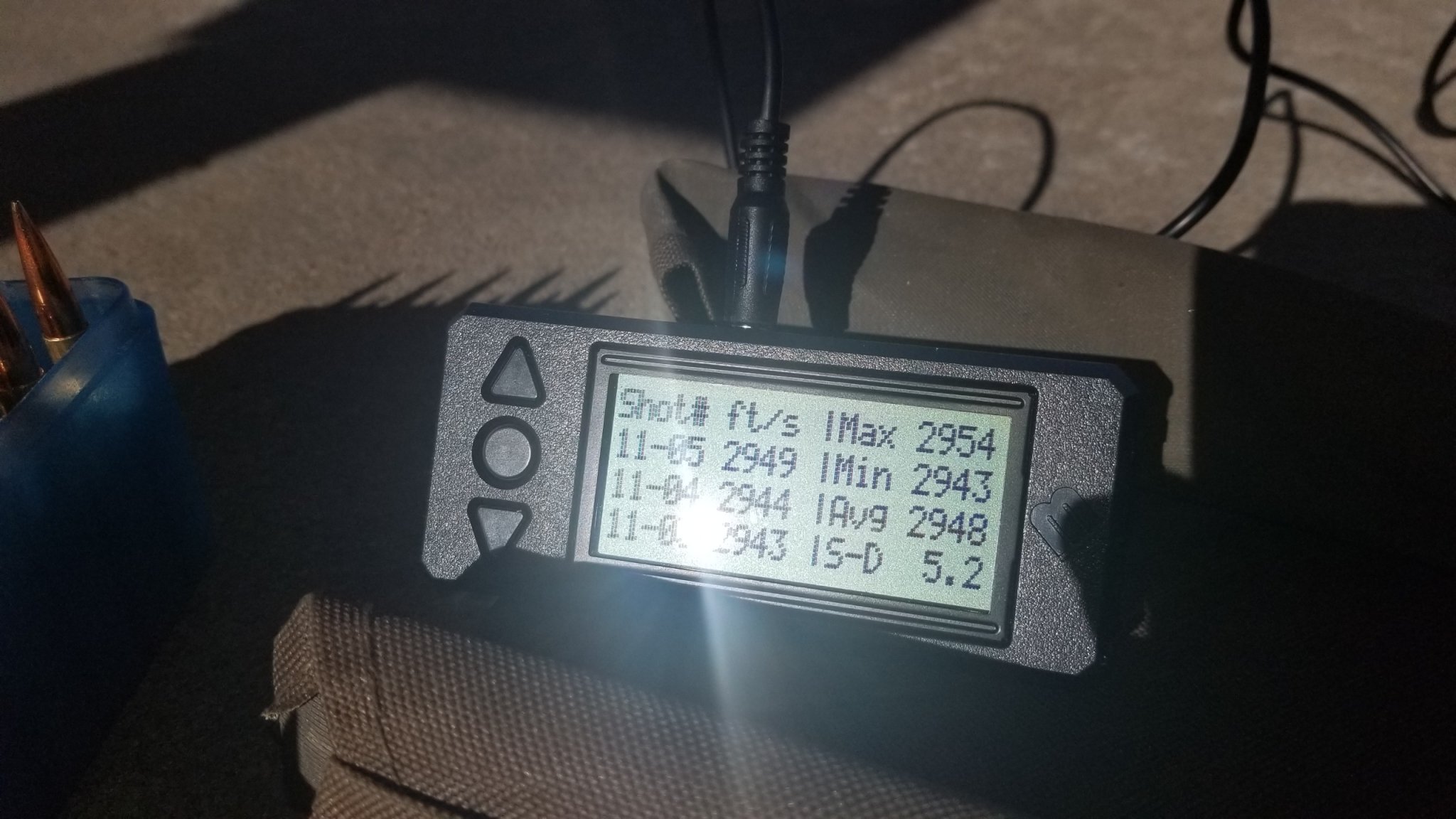

Cases are plenty full when running the bullets at those speeds in the .243 or 6 Creed. Numbers are good too. Lots of assumptions n your part.
Stand with my sword? LOL Now that's funny. I have only been shooting the Creed for a couple years. I still run a .243 too. I am not holding a sword for anything but I know what works for me and saying that. Got a lot telling me it doesn't which makes me laugh. Shoot your stubby cartridge and have fun.
Oh and where did I say it's the best? Please show me.
That can not be a 6 Creed or .243 because everyone knows they can;t run that speed and have good numbers. You must be a liar! LOL

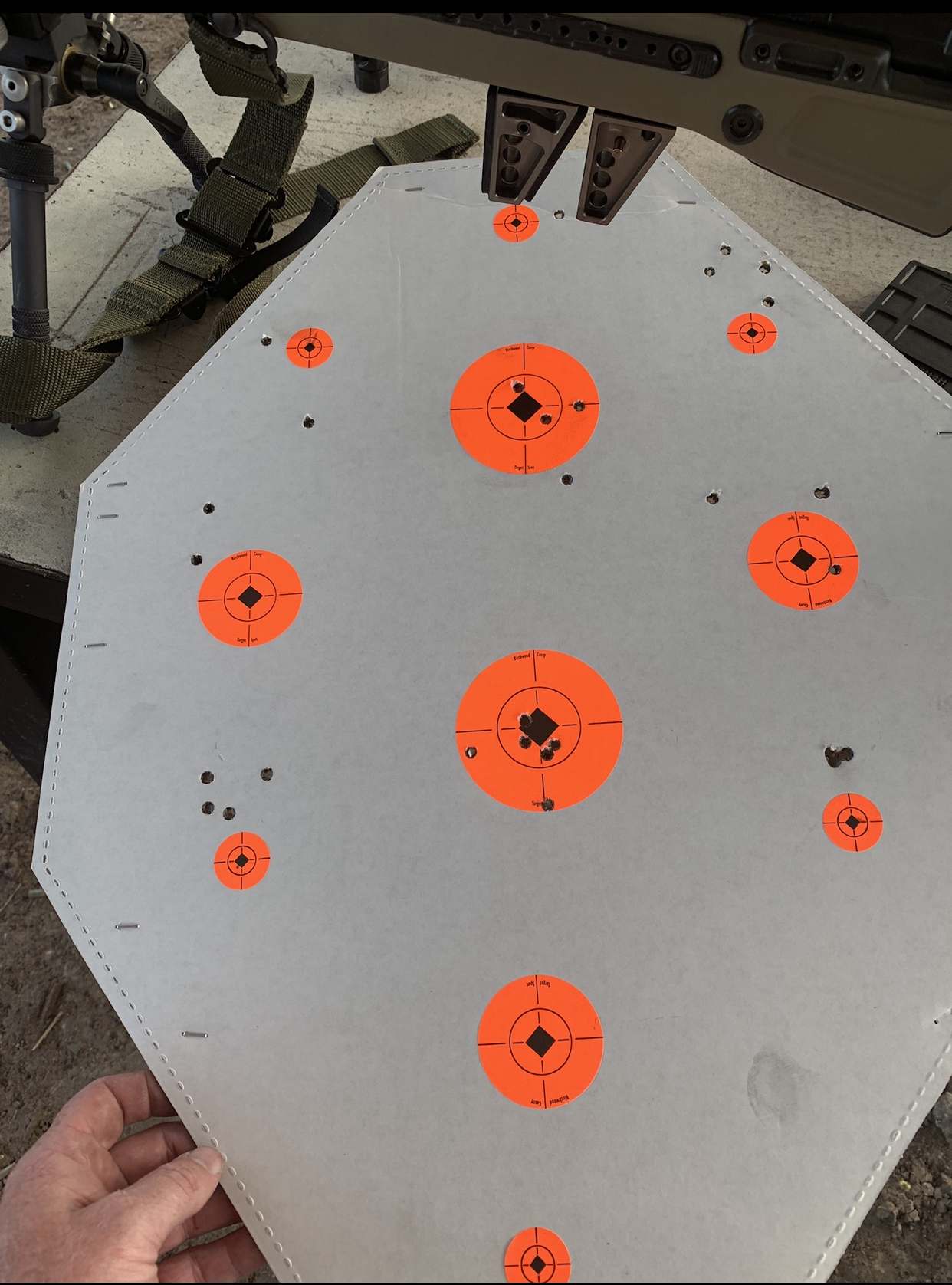

I’ve had some make it to 13-1500 and others go at 900 rnds.
I like 6cm a lot, but it’s a crapshoot on barrel life.
Here’s how one shot after 900 rnds. Firecracking over halfway up the barrel or more. Only factory hornady 108 through the barrel.
This is at 100yds.
