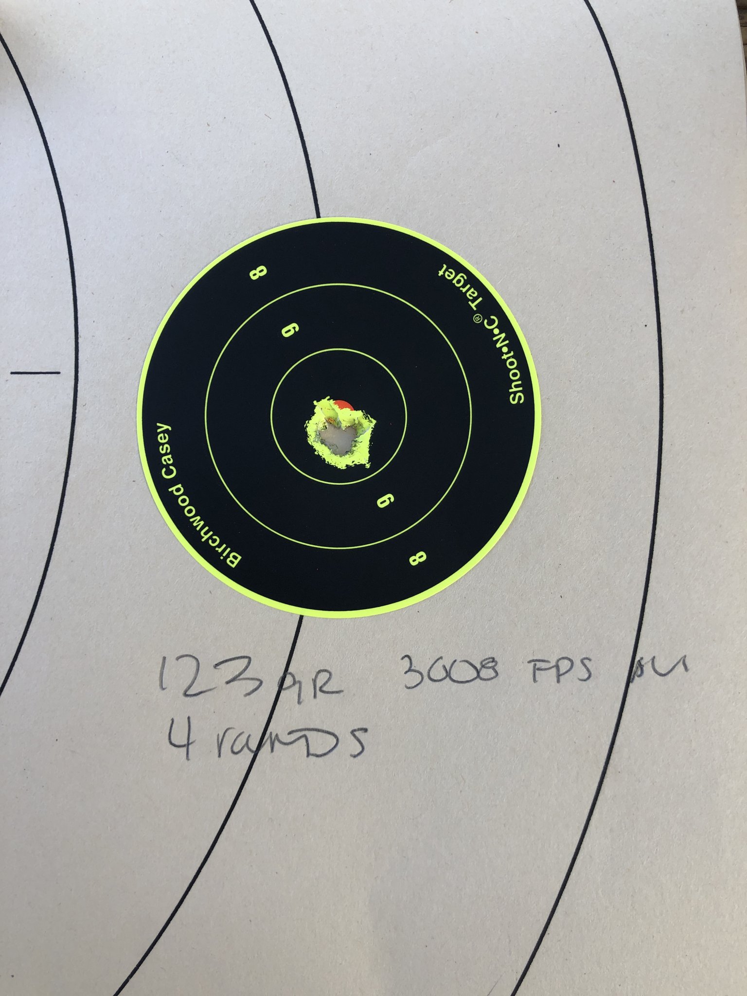

Yes I have seen people shoot 1500 rounds, but also 800 like me and 900 ish in another barrel. Knowing that at both ends of a barrels life the first speed up the last slows down there is less meat than their should be. One season I ran a 6.5 4000 rounds just to see if I could get there. It seemed to have several phases of degradation and in the end was shooting far worse than most people would ever accept. If I got up and said 6.5 last 4000 rounds I’d be misleading people. I am not getting up and bashing the 6CM or the only guy who I see at matches who has lost 6CM barrels sub 1000 rounds. Yes, some people are getting 1200-1500, but not every barrel is working out like that.
Oh and that 6.5 barrel that had the gross number of rounds? @MarcS from Spartan Riles cut 4” off and I spun it on a Neighboor’s action. I shot 2 shots to get a zero.. the next 4 as a group.
Marc laughed when he saw the group but said don’t expect the barrel to last much longer. FWIW the gun has not been shot sense and sitting for two years in my neighbors safe. I have no idea if this barrel will last.
I still have another new 6CM barrel to burn through and about 2000 rounds. So I am still shooting the 6CM - trying to be as non-bias as possible, providing honest information as has both of the Dave’s (one from Texas and one from Nevada).
