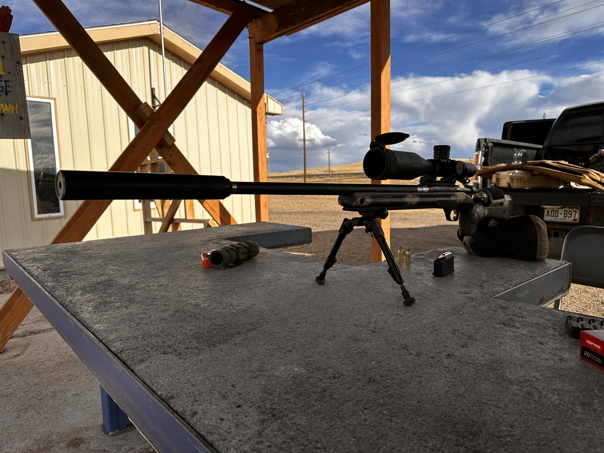

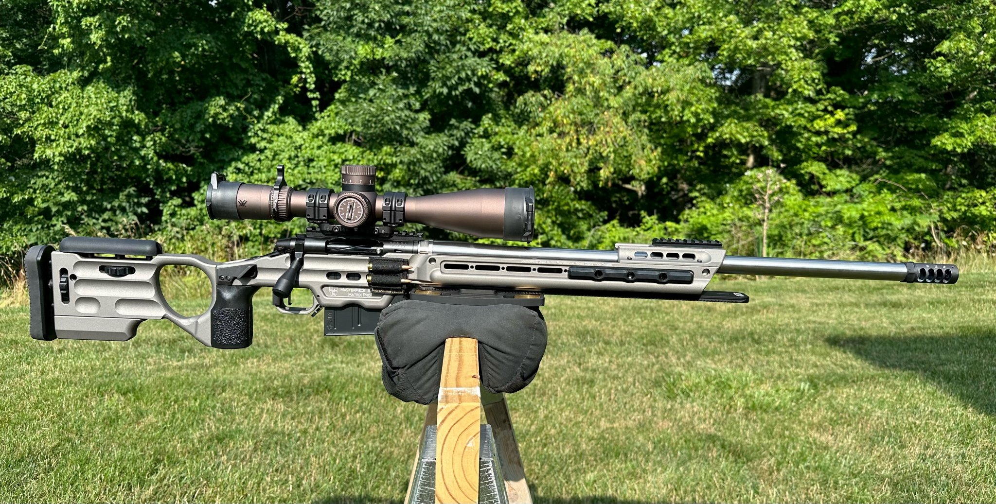

My modest origin build:
Manners LRH in GAP camo w/ full length Manners ARCA rail
Hawkins Hunter DBM with SA mag flush mag
Gold TriggerTech 2 stage
24” Carbon 6 barrel chambered in 6.5prc
TBAC Ultra 9 pictured, got my Magnus out of jail earlier this week so it will be sporting that from now on.
TBAC bipod
Junk ass Arken EP5

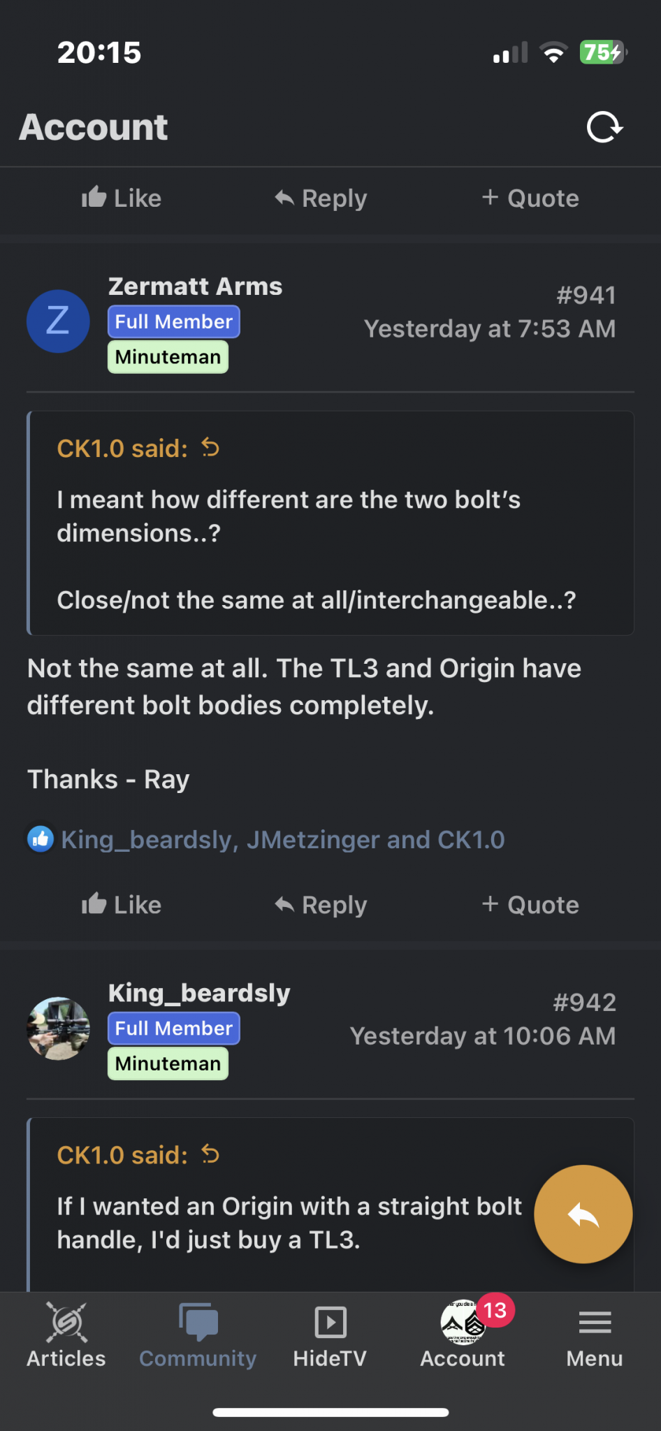

As ray stated they are completely different, I own both and thought it would be cool if the bolts bodies were interchangeable. I think I tried to swap the bodies and it’s was an instant nope that’s not going to work.
I looked at that as well, no go. I have a couple Origins and a TL3 that I love and use. Seems like I have more stocks that accept straight bolt handles than stocks for swept ones. Was just wondering if swept handle could be converted so I could swaps stocks out easier for diff rifle uses (thermal yotes/long range match/etc.).
I'm sure a competent gunsmith/machinist could, either by milling off the swept part of the handle and TIG welding a new piece on straight, then contouring, polishing and refinishing or by cutting it off, retapping and inserting a 5/8-24 thread stud to reattach a bolt handle. It might be difficult to match the finish on the rest of the receiver is the only issue I can think of.
Try reading.
Ray’s post is 941.
Your’s is 944.
Not the same at all. The TL3 and Origin have different bolt bodies completely.

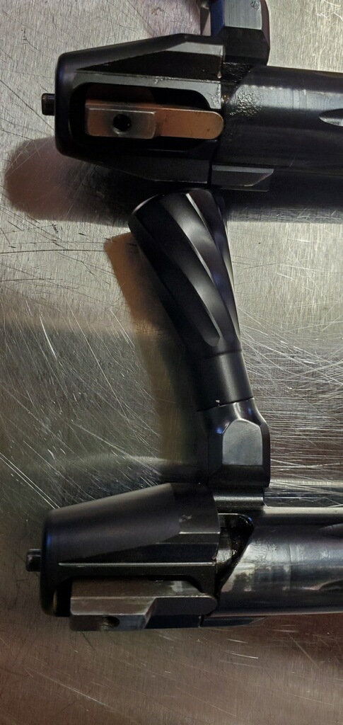

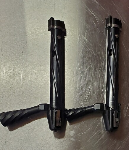

I personally think the newer origins feel a lil better than the old ones. My first was purchased in 2018, and got another last year. The newer one feels a bit smoother out the box than my old one that has had near 5k rounds through it.
Stainless vs. 4140 receiver maybe?
Perhaps. I know the first few years were 4140 with dlc bolt and nitride body(could be reversed, but I know dis-similar coatings) and the stainless may now have a different coating system. But I personally feel the new one runs a lil smoother than my old one. Both great actions along with my tl3.
I know my second one in 2021 had a slightly different firing pin sear that reduced cock on close compared to my first from not that log after introduction. I emailed customer support asking about it and they sent me the new version baronet assembly to swap out for my first. Now both are silky smooth (though I didnt mind a bit of positive cocking).
New on the left, old on the right
My first origin had the original cocking piece, and with a TT diamond it felt bad compared to a properly timed action. Ray hooked me up with a new assembly that had 15-20k cut from cocking piece and that helped tremendously! The new one with a TT special installed feels very good as well. A BixnAndy will still give a lil cock on close, but it's very minimal.
Reactions: spife7980
Well damn, guess thats not the difference in feel you noticed then. Must be the different metals and treatment thereof.
Reactions: 4O6shootist
It's when cycling the bolt. Its odd the new one actually feels slightly more rough(wrong word, but like you feel what would be like a texture almost) when running the bolt, but it has less tendency try and bind up, you can side load and it just glides through, the older one, if you're running bolt perfect with zero bind, feels like glass, but if you're running fast and hard and not perfect manipulation, it sometimes exhibits sticky/bind feeling. Lesson here: don't run bolt like a retard and all is good. I'm still very happy with both of them, just an observation running them both side by side along with my tl3.
My first origin was serial #6, I sold it a few years ago. I bought another origin a year ago and thought it had a different feel to it then my original one. Glad you confirmed my suspicions.

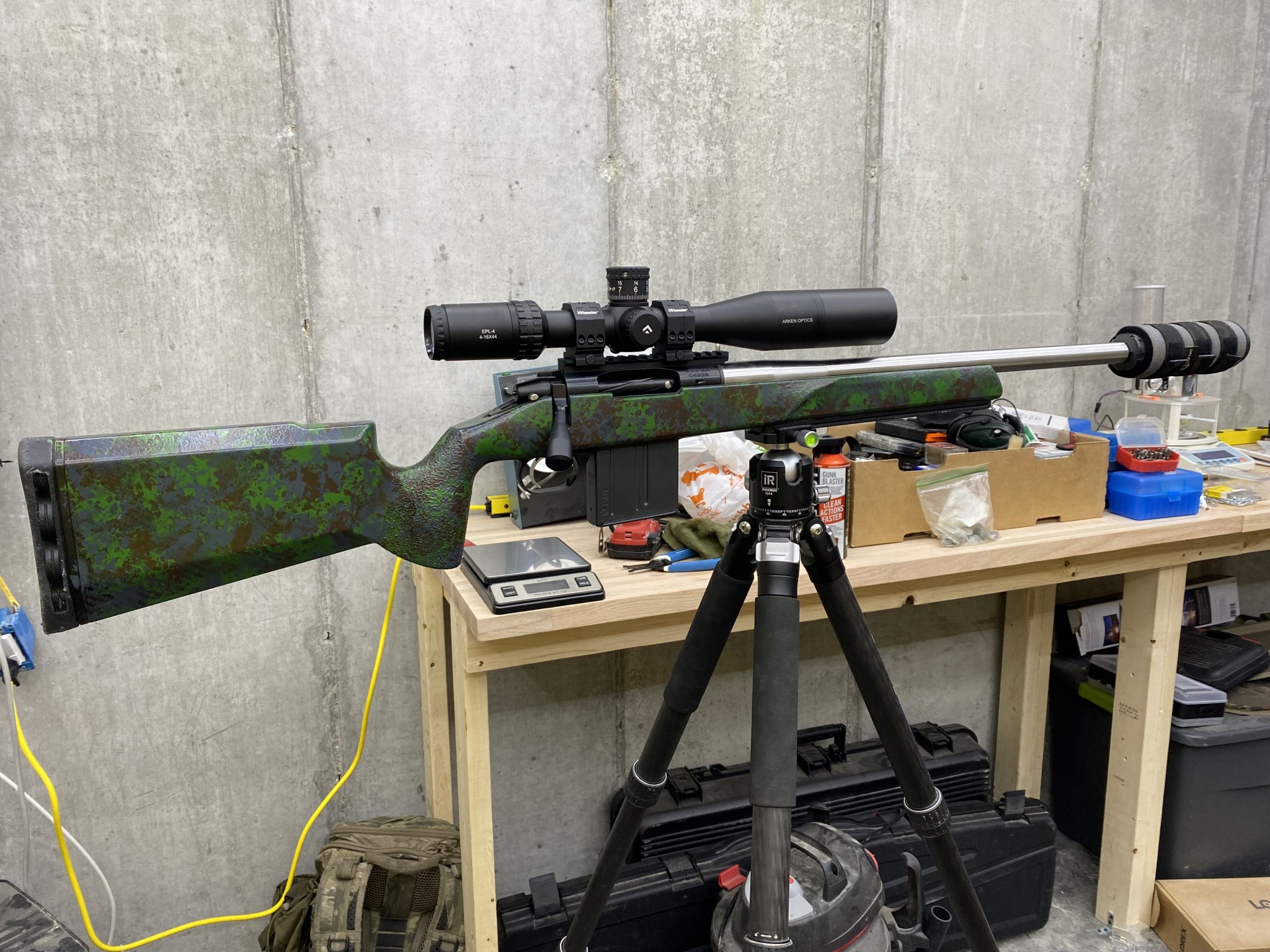

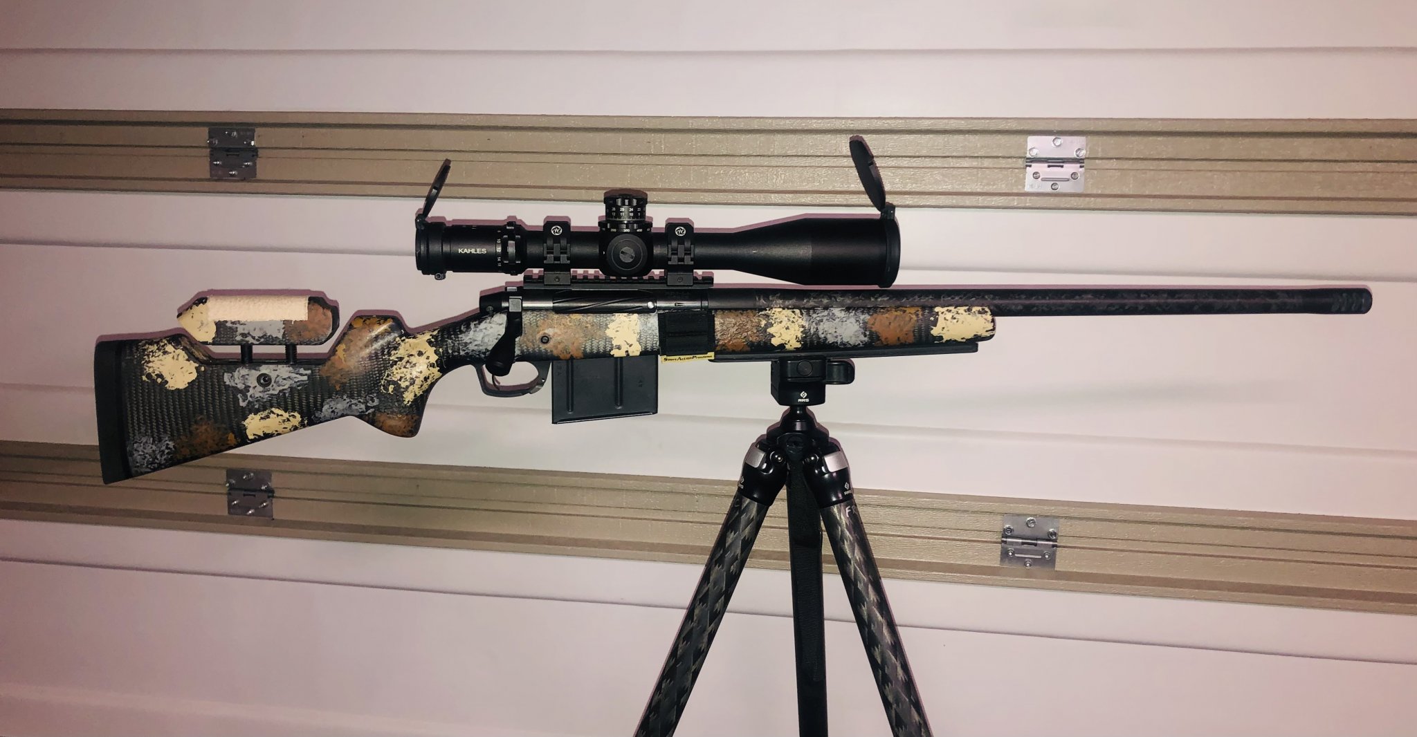

Origin short action
Pva heavy Palma in .223 cerakoted od green
McMillan a3-5 in Forest camo
Tt diamond 2 stage
Altus cal bipod
Kmw gen2 bottom metal
Leupold mark 5 pr2 mil
Arc m brace rings
Pva jet last not pictured
Tbac ultra 7 in jail

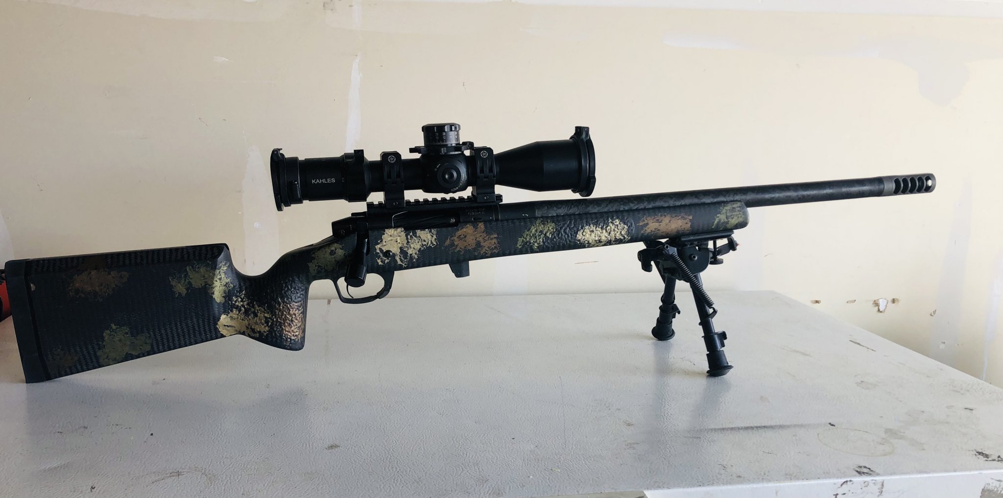

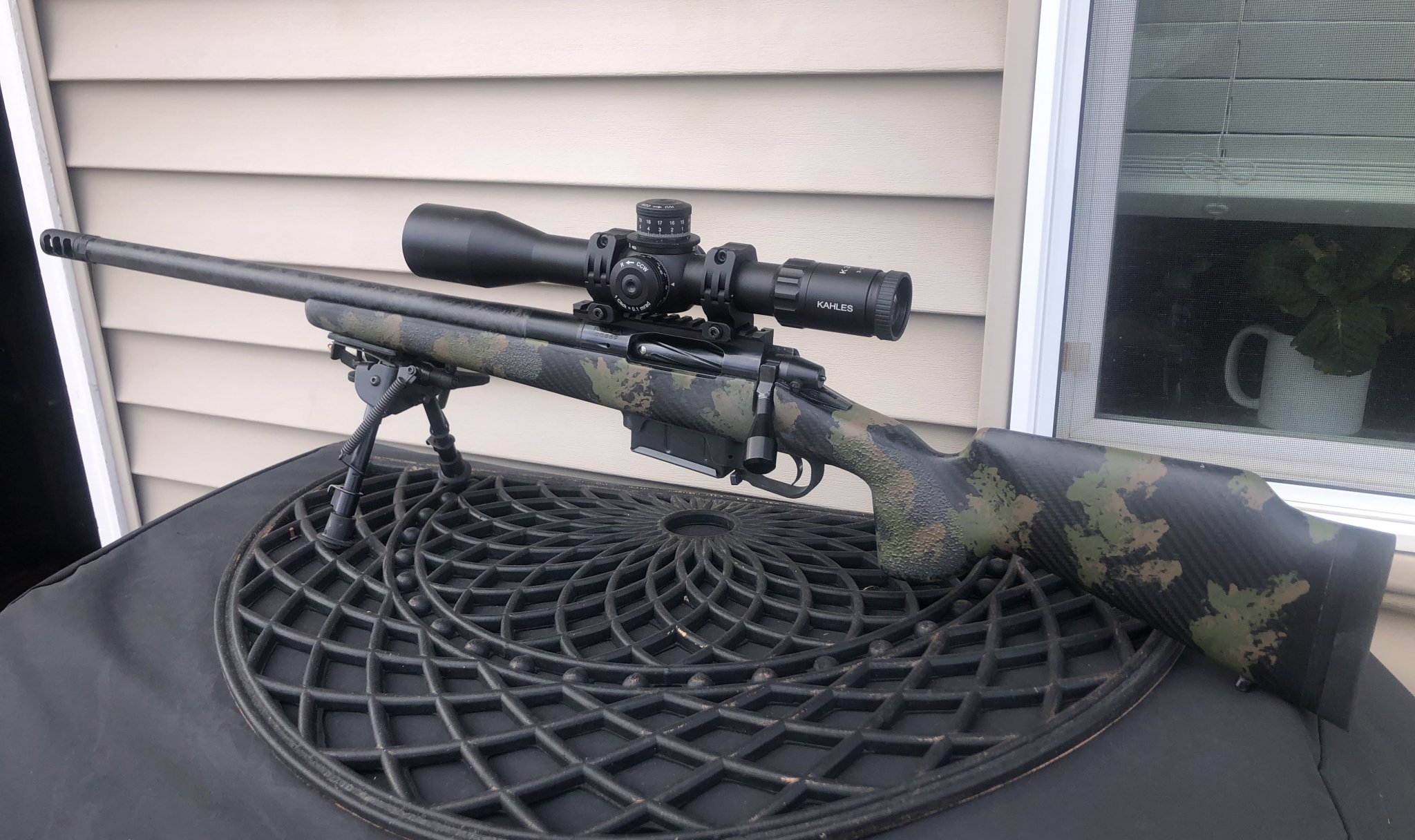

Worked up an accurate load with varget but it’s a little slow, going to grab some other powders and fool around to try to find an accurate fast load, and try varget in the faster velocities again as I have floated the barrel and bolt handle more and bedded the action since I did the original load development.
6.5 PRC
Bighorn Origin SA LH
22” Proof 1:8
TT Diamond
Mesa Altitude Stock
ARC M Brace Rings
Kahles 3-12x50
308 Win
Bighorn Origin SA RH
20” Proof 1:10 w TiPro3 Brake
TT Special
Manners EH1 w/ Mini Chasis
ARC M Brace Rings
Kahles 3.6-18x50
7mm Rem Mag w/ +P Chamber
Bighorn Origin LA RH
24” Proof 1:8.4 w DE Mini Slab Brake
TT Special
Manners TA w/ Mini Chasis
ARC M Brace Rings
Kahles 6-24x56

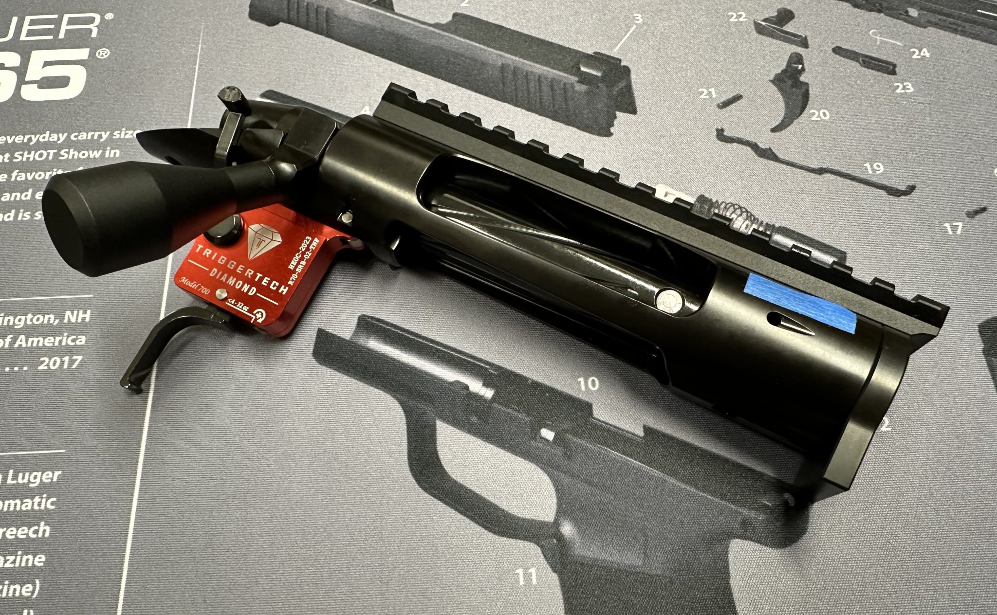

My second Origin build. It will be used for centerfire training PRS and occasional TAC division matches. Save barrel life on my 6mm creedmoor setup almost identically.
Zermatt Origin SA .223 boltface
MPA Matrix Pro in gunmetal cerakote
Bartlein 26 inch heavy palma chambered in .223 Rem by Southern Precision rifles for Bug Nut
APA Little Bastard muzzle brake
Triggertech Diamond single stage flat
MPA BA Scope mount 0moa 1.125
Vortex Razor Gen III 6-36x56 mrad
Area 419 17 inch universal Arcalock rail
Gray Ops CNC internal (5) and 2 external steel weights

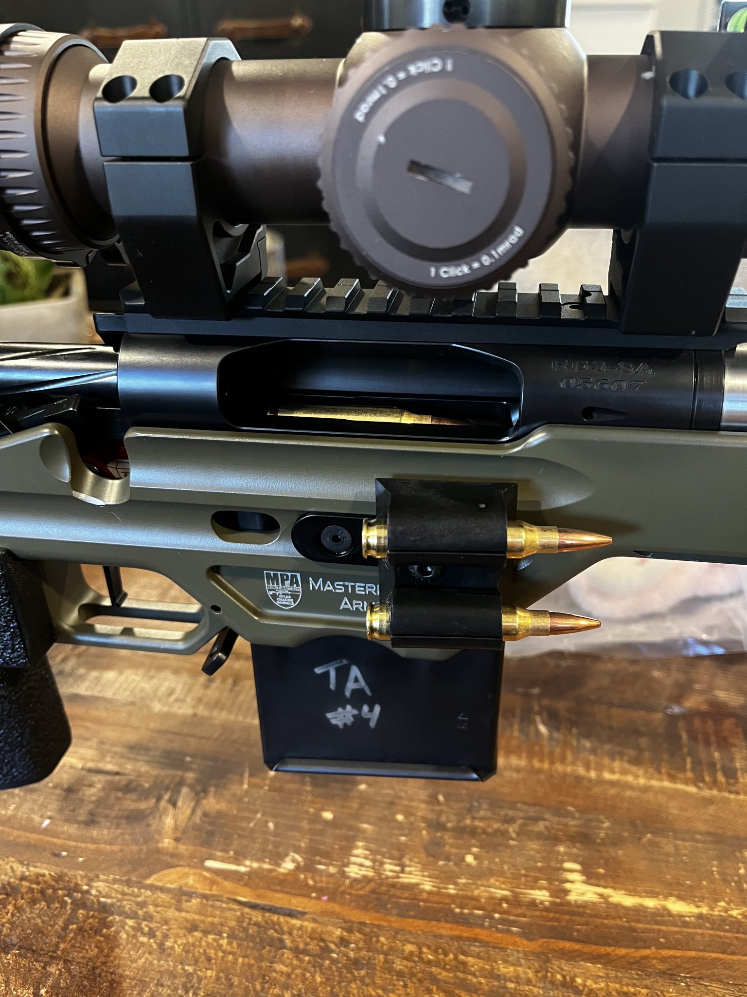

How does that 223 feed? I have a origin SA in 223, and it feeds reliably if I run the bolt fast, but if I run the bolt slow, the bolt face face won’t grab the round and it pops out and jams.
My set up is a little bit different from the poster above. It's has a .223 proof barrel and is in an XRS chassis but it runs fine with plastic MDT mags.
I haven't had the opportunity to try it yet. I'm planning to shoot it over the weekend and I'll find out. I've got MDT steel and poly mags to test.
Have you tried the MDT steel mags?
I’m currently running accurate mags (metal) with a SA origin in 223 in a mpa comp.
The plastic mdt mags didn’t feed great. The accurate feed reliably provided I run the bolt FAST. If I pissy the foot and run it slow, the bolt face just pops the round out and it jams up.
I have the mag catch all the way up so that the bolt is nearly kissing the feed lips. Can’t seem to figure out the slow feeding .
