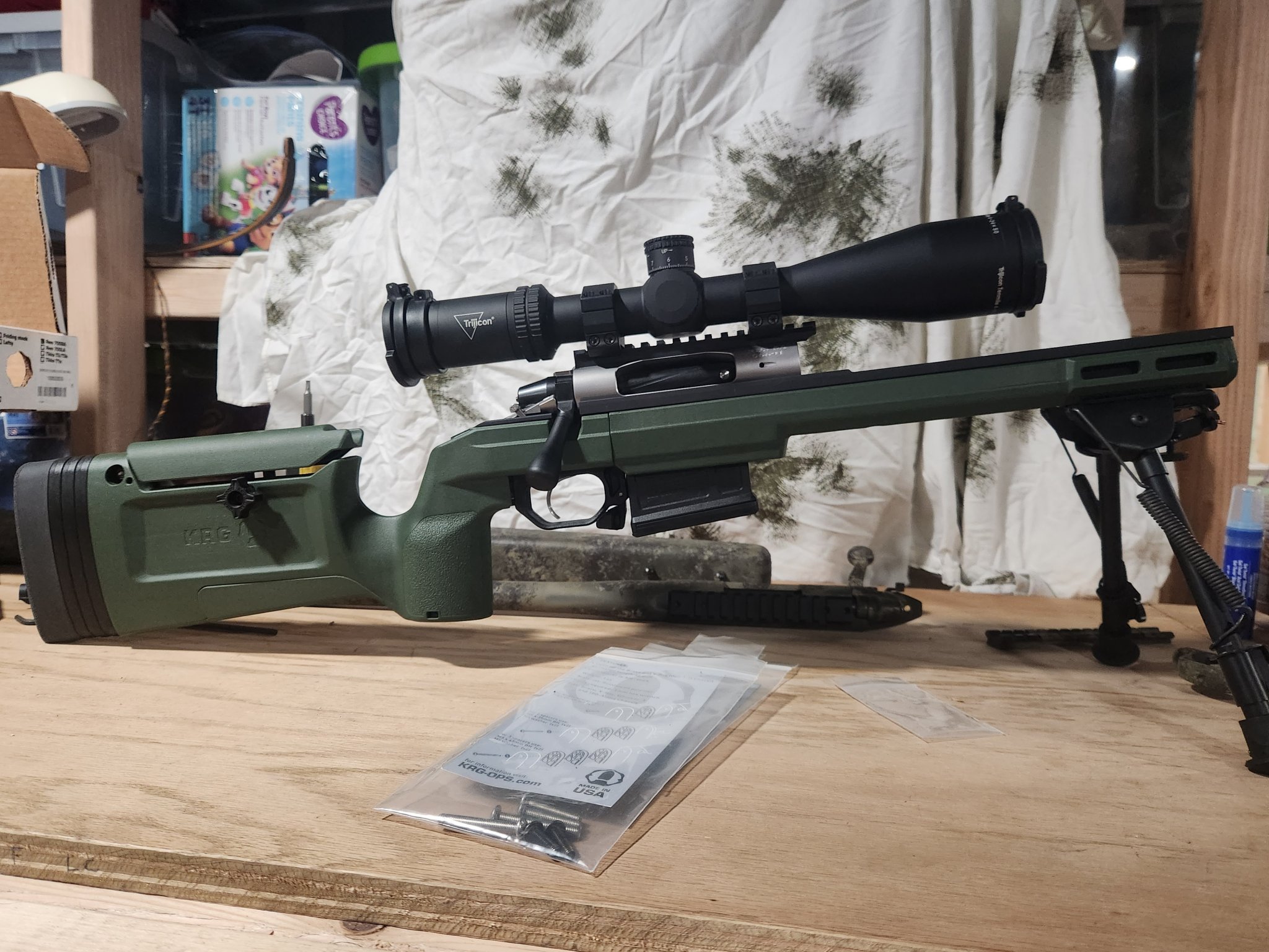

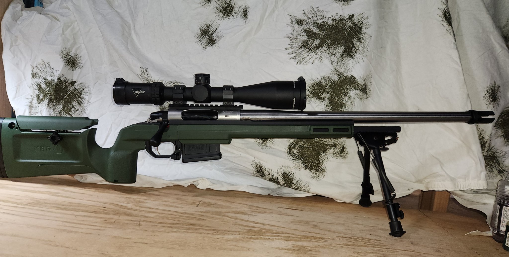

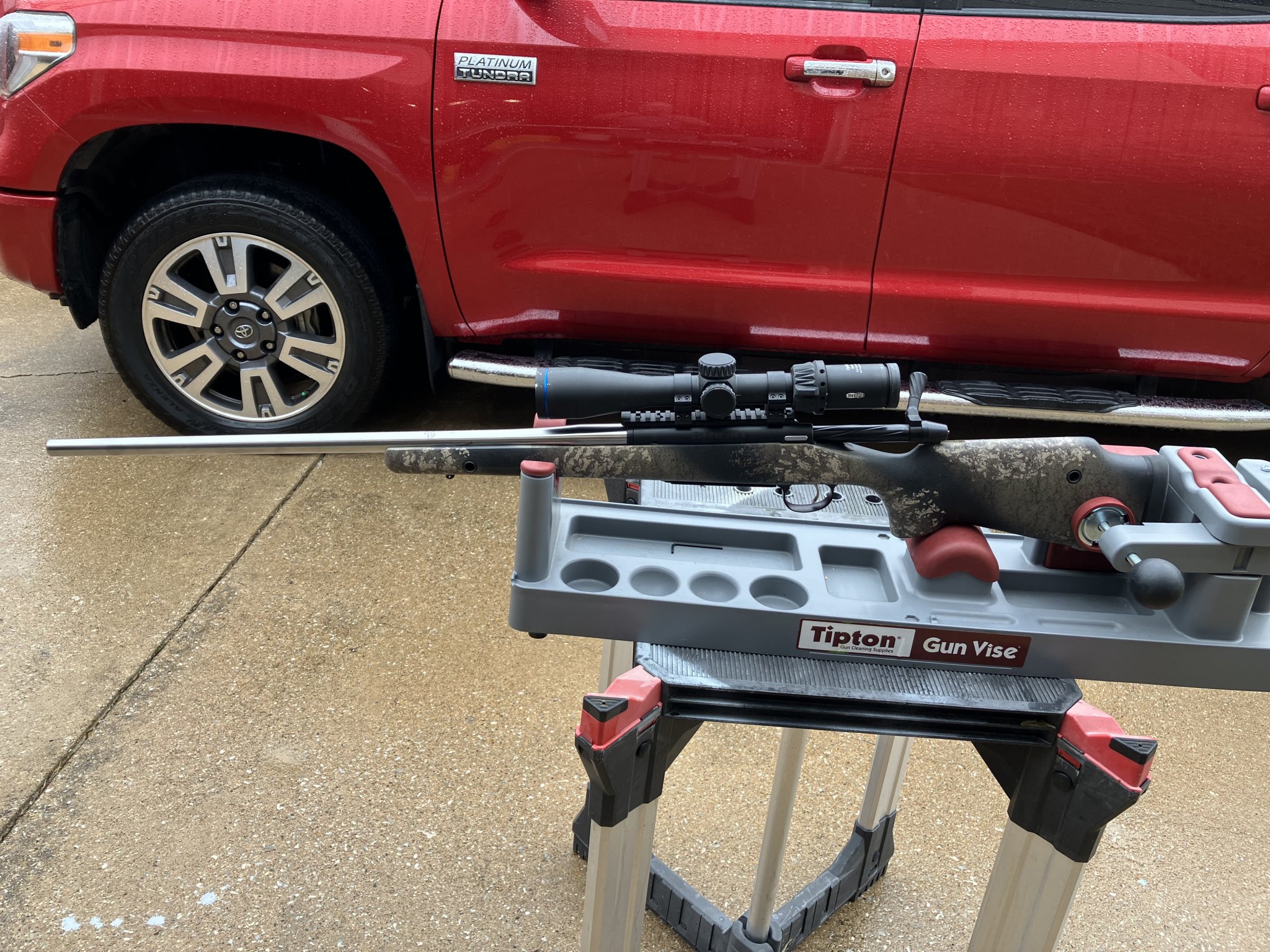

S.o.B! I finally got my action in. Installed the trigger and prefit barrel. Why am I pissed. The front action screw is buggered and won't screw in the action. Thus, I have a barreled action, but no stock.
Action: Zermatt Origin LA
Trigger: TriggerTech Primary
Stock: Greyboe Terrain
Bottom Metal: A mix of RedHawk & Remington BDL parts with a Wyatt box
Barrel: Preferred Barrel Blanks 24" 280AI - shouldered
Future Barrel: Criterion 19" 270 Win, threaded, fluted, cerakoted black, barrel nut to save weight. Should arrive in a few months.
Suppressor: Harvester Evo (in ATF jail)
Scope: Meopta Optika6 2.5-15x44 BDC 30mm SFP
Front Action Screw: Bubba'd
Weight Unloaded with Scope: 10.2lbs.
RedHawk Comment: I shot them a note last night after 10pm that the threads on my Front Action Screw were a mess. By 7am Central, they responded that they would send me a replacement.
Obviously, this rig is not svelte set up this way. This is my I don't have to walk far setup. I will probably have the 280 AI barrel cut back to 21" and threaded at some point.
- When the 270 barrel is on the action, it will get a lighter scope and end up in the low 8lb range.

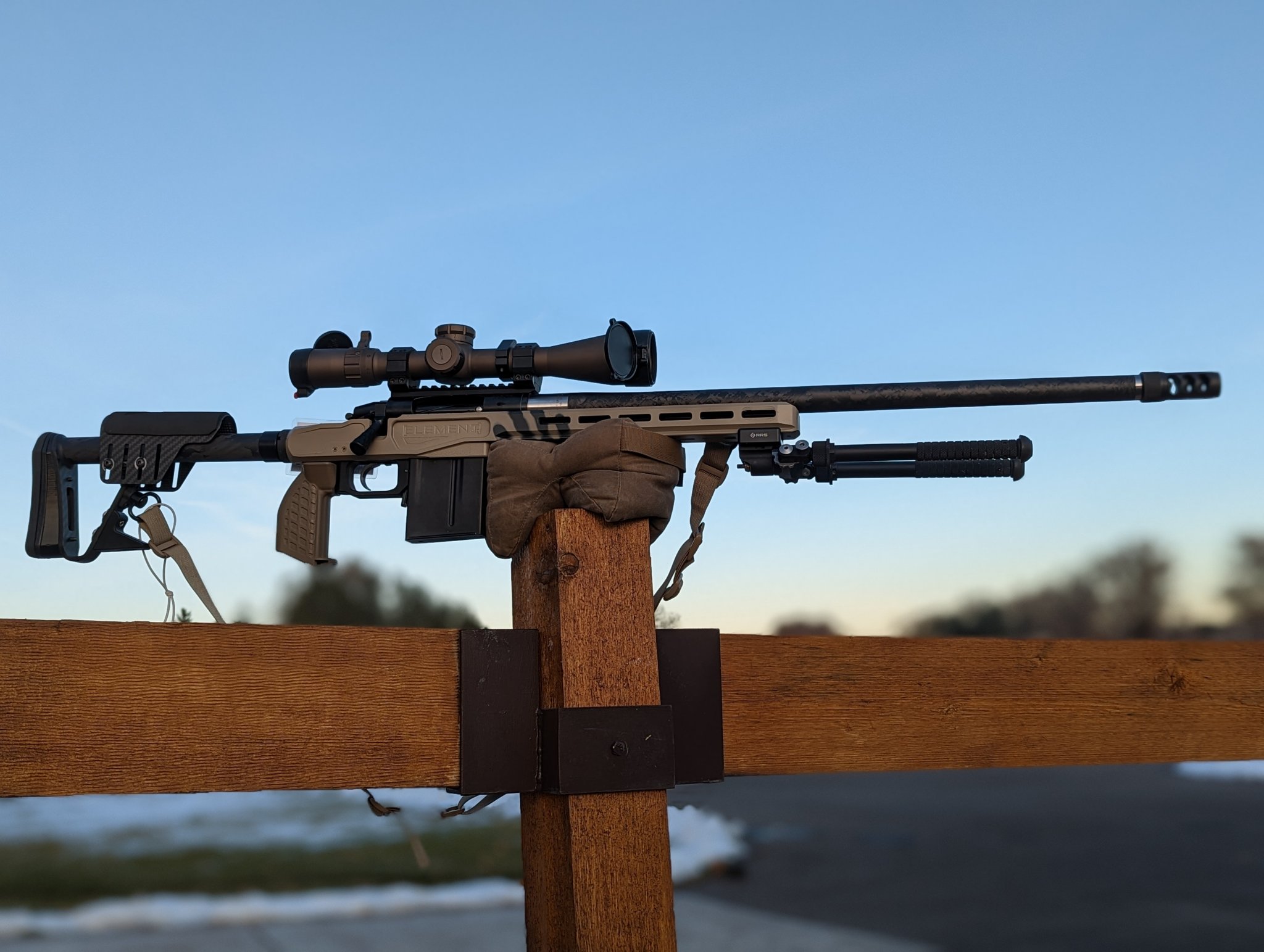

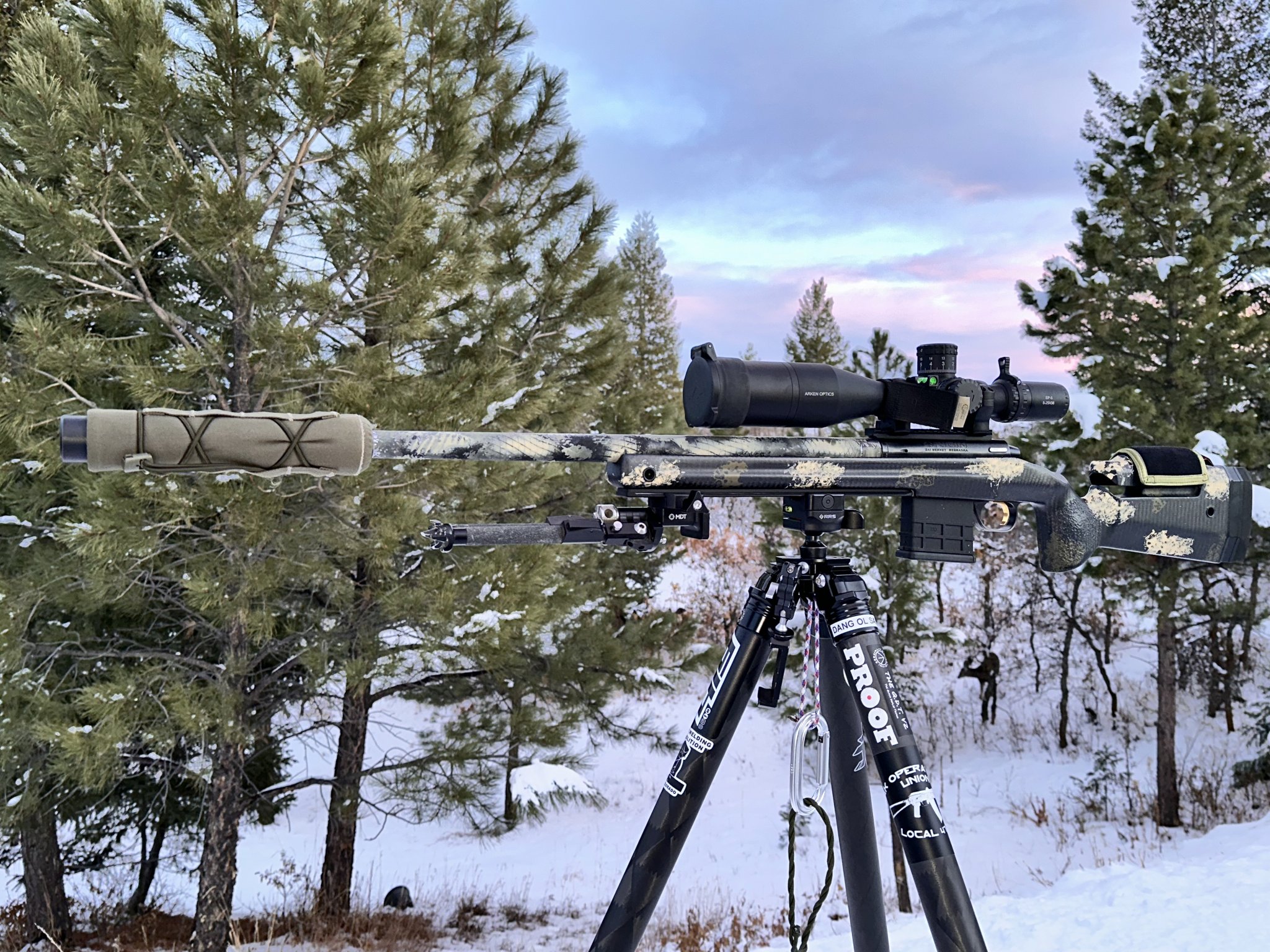

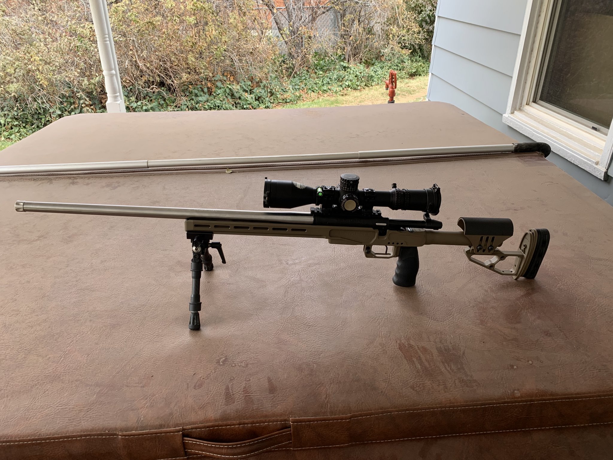

Origin SA, 24” #4 bartlein LH gaint twist 7.25 to 6.75 22 dasher, timney hit trigger, XLR envy 4.0 magnesium chassis, spurh hunter mount, NF ATACR. good multi purpose rifle.

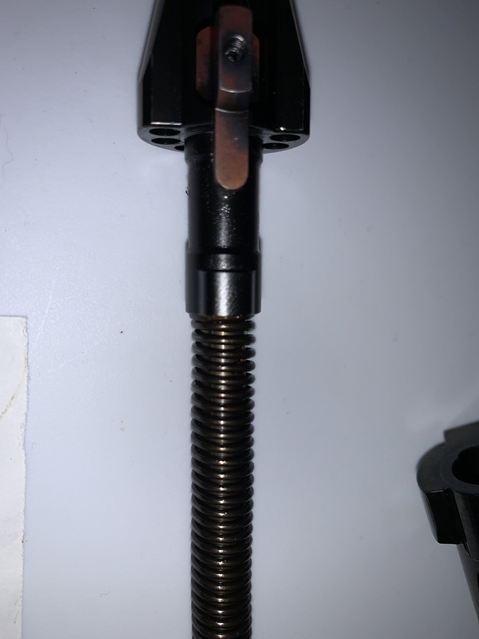

It is very hard to find a good video on how to reassemble the bolt assembly and put it back into the action. I tried all kinds of search terms and could not find a detailed video on bolt disassembly. Most of the videos showed how easy it was to take it apart and said just do it in the reverse.
I have been told you can reinstall the bolt in the field without tools, but getting my bolt assembly back on the action was very difficult. I did it, but I couldn't do it in the field.
Reactions: nrspence
It's literally the same steps but backwards. And yes it's just at easy.
I'll try to make a video today.

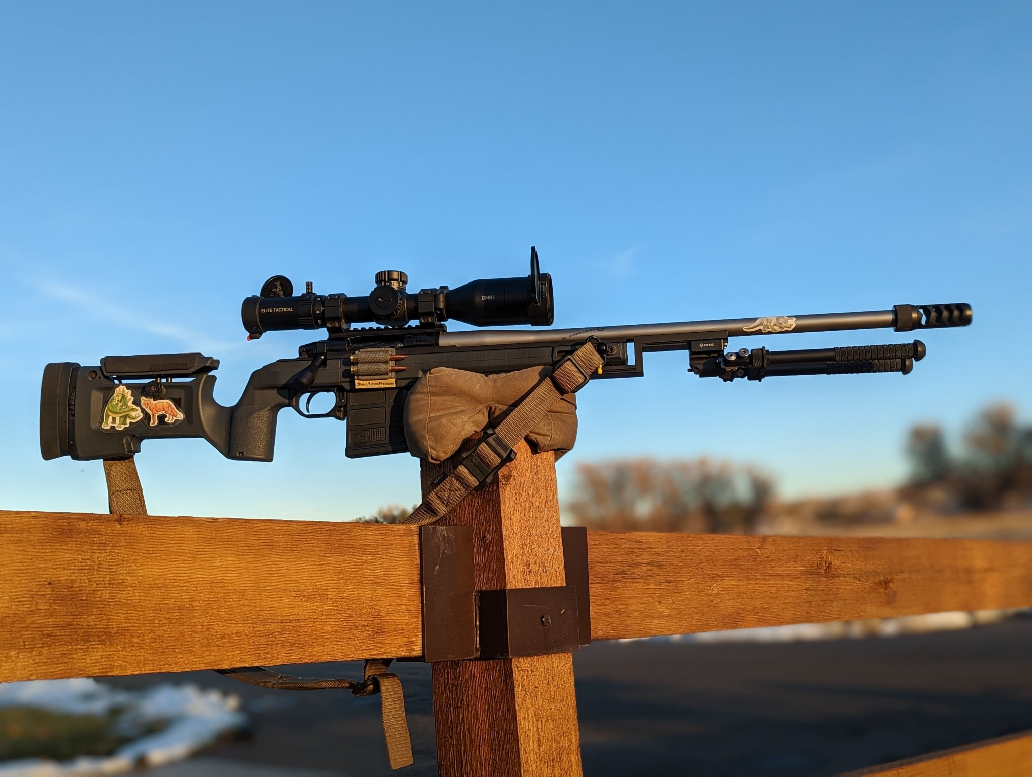

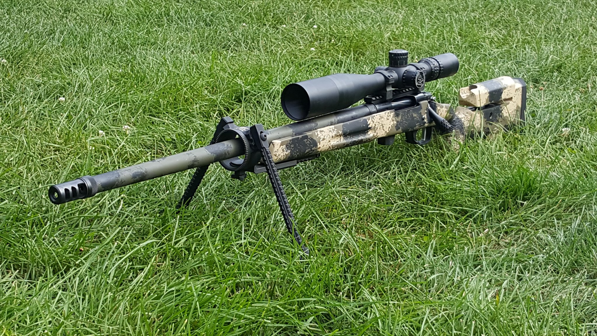

Can anyone measure the height of the top 20moa rail on an origin short action for me? I'm trying to find a means to raise my optic height while keeping my current scope mount. Curios if the Murphy precision rail will net me anything. Thanks!

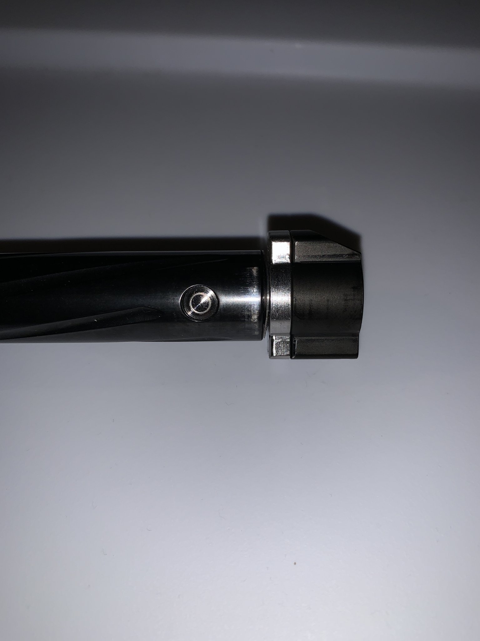

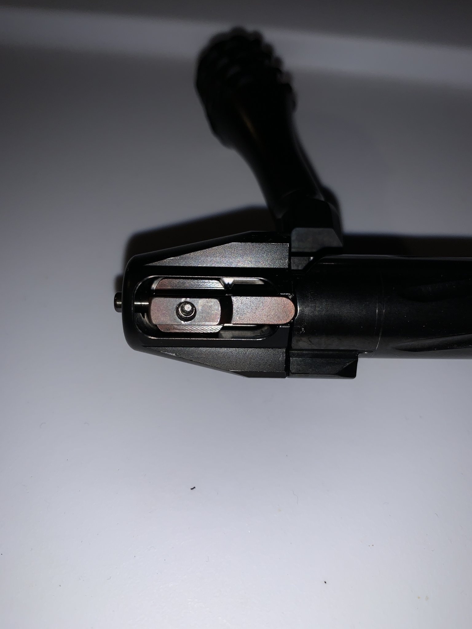

Origin with push feed bolt head
26" 1-8 CBI 223 Ackley
PVA barrel nut
TT Primary
CAL 2
Bravo
EBR-7C Viper

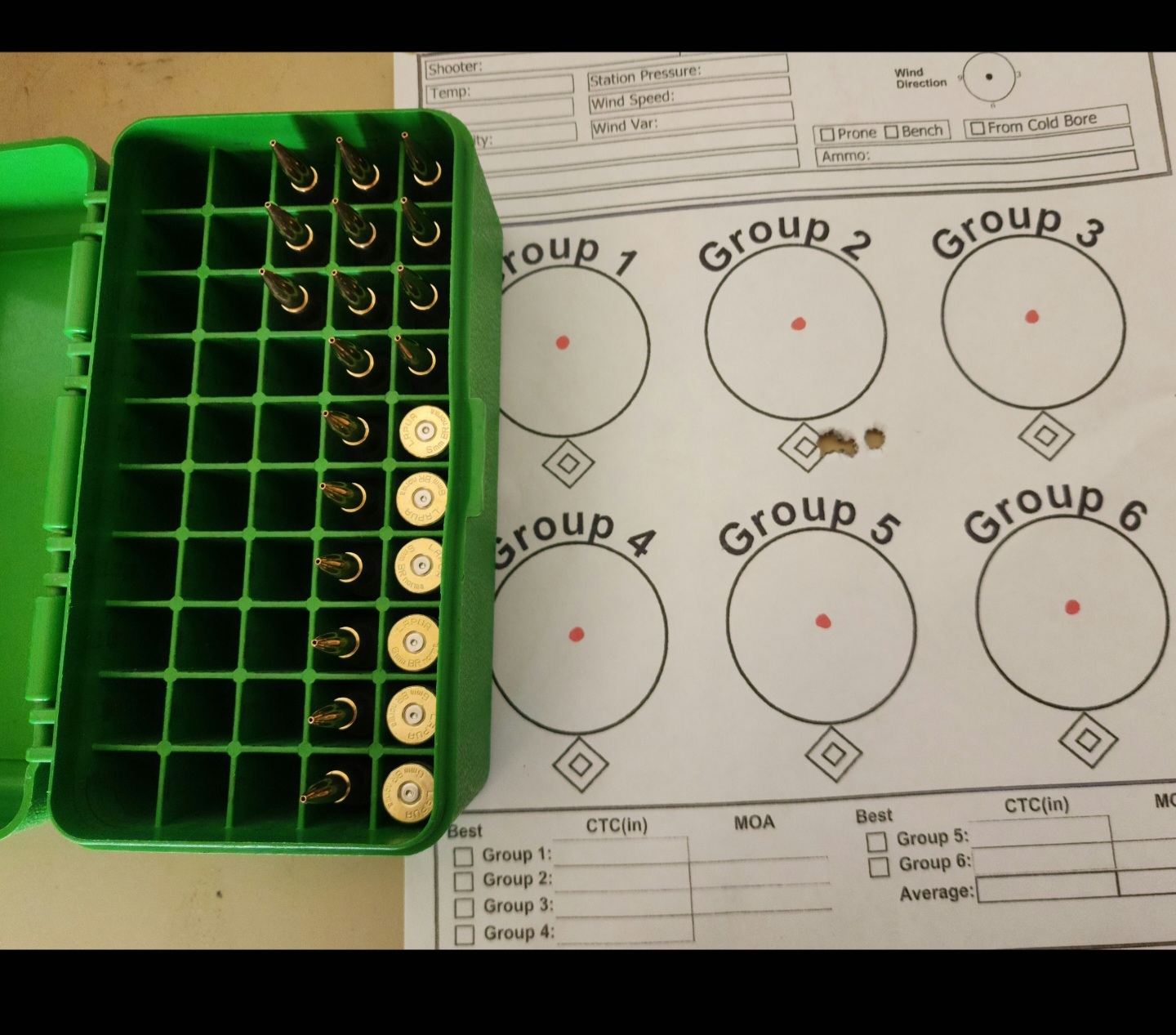

Went out to try out the new barrel and start fireforming brass. Wasn't dissapointed with 1/2" groups using cheap 50 gr Dogtown bullets I had sitting around just to get the barrel broke in and make some brass. After 75 quick rds through it and a deep clean I'm excited to see what it can do. Really liking the Origin and a big thanks to Ray for taking care of me.
Push feed bolt head? You’ve got my interest peaked, tell me more.
Like most know, Origins come standard with control round feed. However, I read online where 223AI has some minor feeding problems with a standard CRF head, so ran it by Ray who told me the same. Zermatt makes special push feed heads that they will swap out for you if requested. As far as I've read, only 223 AI really has this problems although I'm sure there are obscure chamberings that might benefit from it as well. I had 0 cycling problems yesterday no matter how fast or slow I ran the bolt.
I'm going to try the CRF bolt with my 223 Ackley pre-fit when it comes.

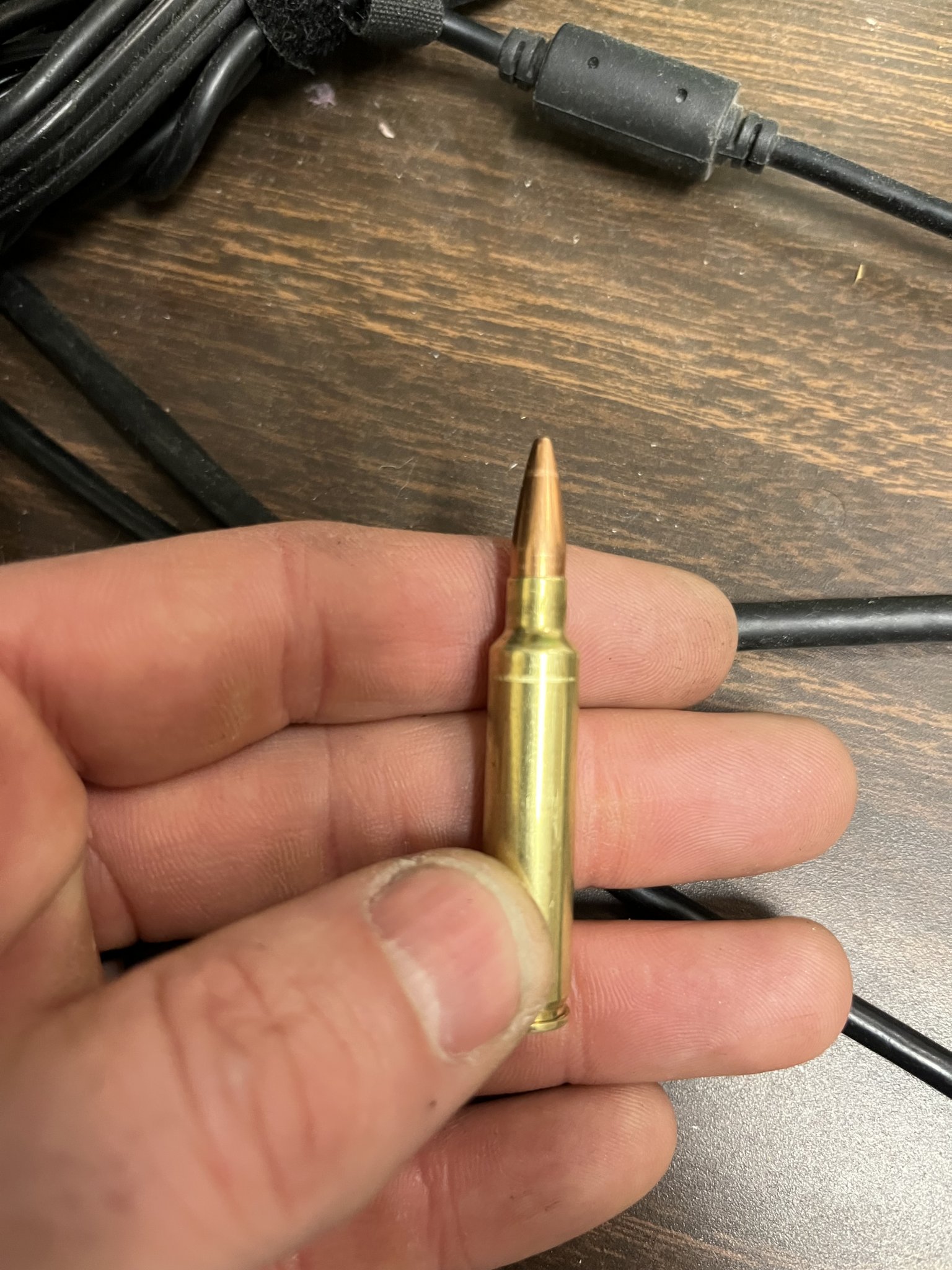

I’m having trouble with a 223ai build. It Will not feed AI cases reliably. Fire forming is no problem and is very accurate. .3-.4s consistently. I have tried aics mags, mdt mags, multiple bullets at multiple oal. Had Smith chamfer chamber mouth and polish. Still no dice. Rounds bind in the chamber and leave a ring on case body. Must be manually removed. This happens 60% of the time.
It Runs smooth as silk from any magazine with vanilla 223. I assume I have a CRF Bolt head as I bought the barreled action used here.
Is the push feed bulkhead the answer? I have reached out to Zermatt asking the same question. Any help or suggestions would be great.
Thanks

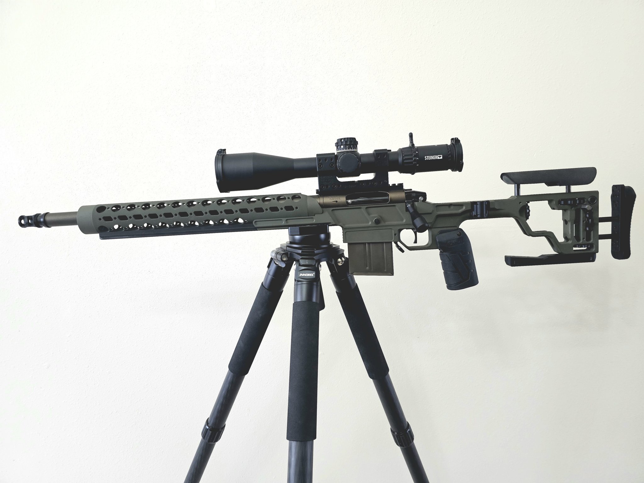

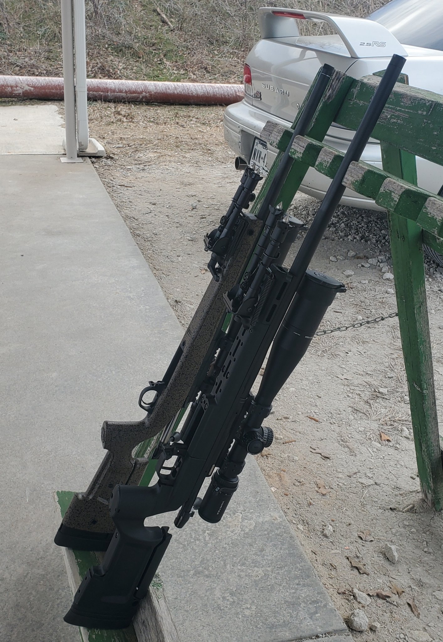

Match rifle:
Origin SA
Preferred Barrel Blanks 23" Medium Palma - 6.5CM
KRG Bravo
Seekins Rings
Bushnell DMR3 3.5-21x50
Timney HIT Trigger
Area419 Sidewinder
Atlas CAL bipod
Hunting Rifle:
Origin SA
Proof Carbon 24" Sendero - 300 WSM
XLR Element 4.0 (aluminum)
Seekins Rings
Bushnell LRTS 4.5-18x44
Timney Trigger
Area419 Hellfire
Atlas CAL bipod
Weight: 11 lbs 6 oz field ready (including mag (3 round), ammo, sling, Atlas bipod, scope caps, etc.)

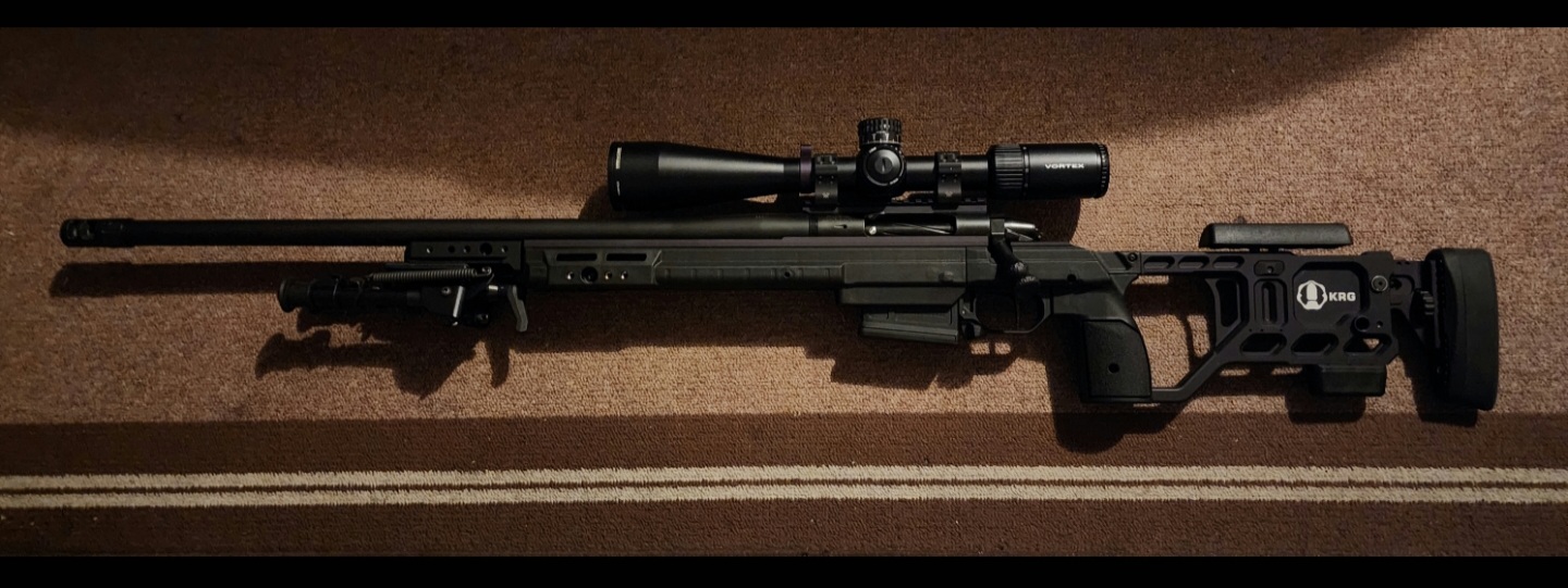

I've had this setup for a few years now, 2018 (or early 2019) was when I received my Origin.
24 inch .223 PVA 1:7 twist (I know it's kind of stupid long). It was actually a blem, so I got it on a good discount.
KRG Bravo Chassis
Harris BRM-S bipod
Triggertech Flat trigger
Nighforce 20 MOA rail
Vortex Viper PST Gen II 5-25
Vortex rings (medium height?)
I use the Accurate Mag 10 round 223 AICS mags
Love this gun, thinking about building a 300 Blk SBR with an Origin and KRG Bravo for hogs here in Texas. Too many dumb ideas and not enough money.

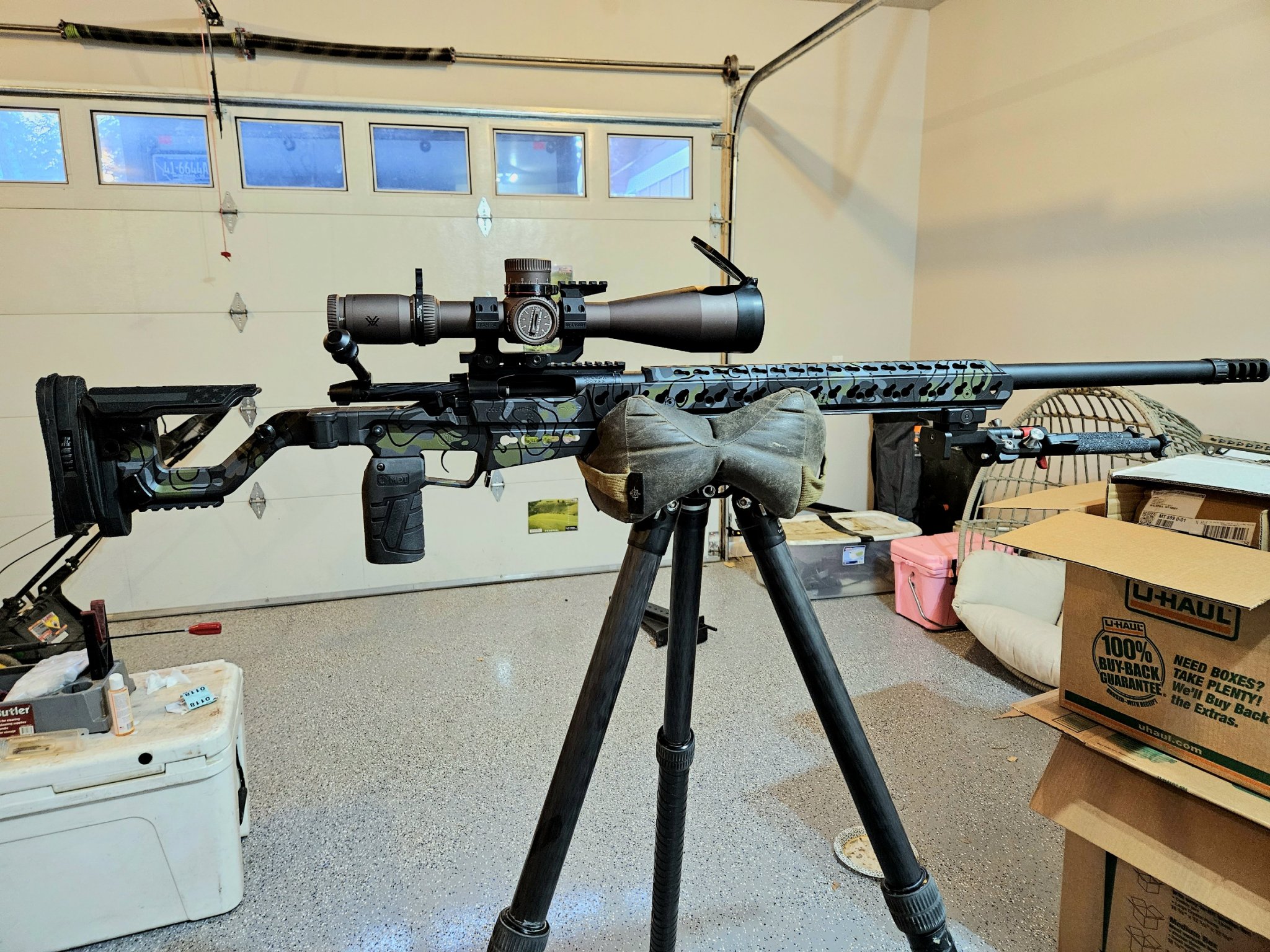

Fresh lefty build.
22br
24" Brux
Krg w-3
TT Diamond
75gr berger vld @100
1 Sighter + 5 shot group = happy in pants.
Feeds like a champ. I see myself shooting this rifle alot this year...not sure how my other bolt guns will feel about that..🤣🤣
I fricking love this setup and definitely see another Origin build for me this year.

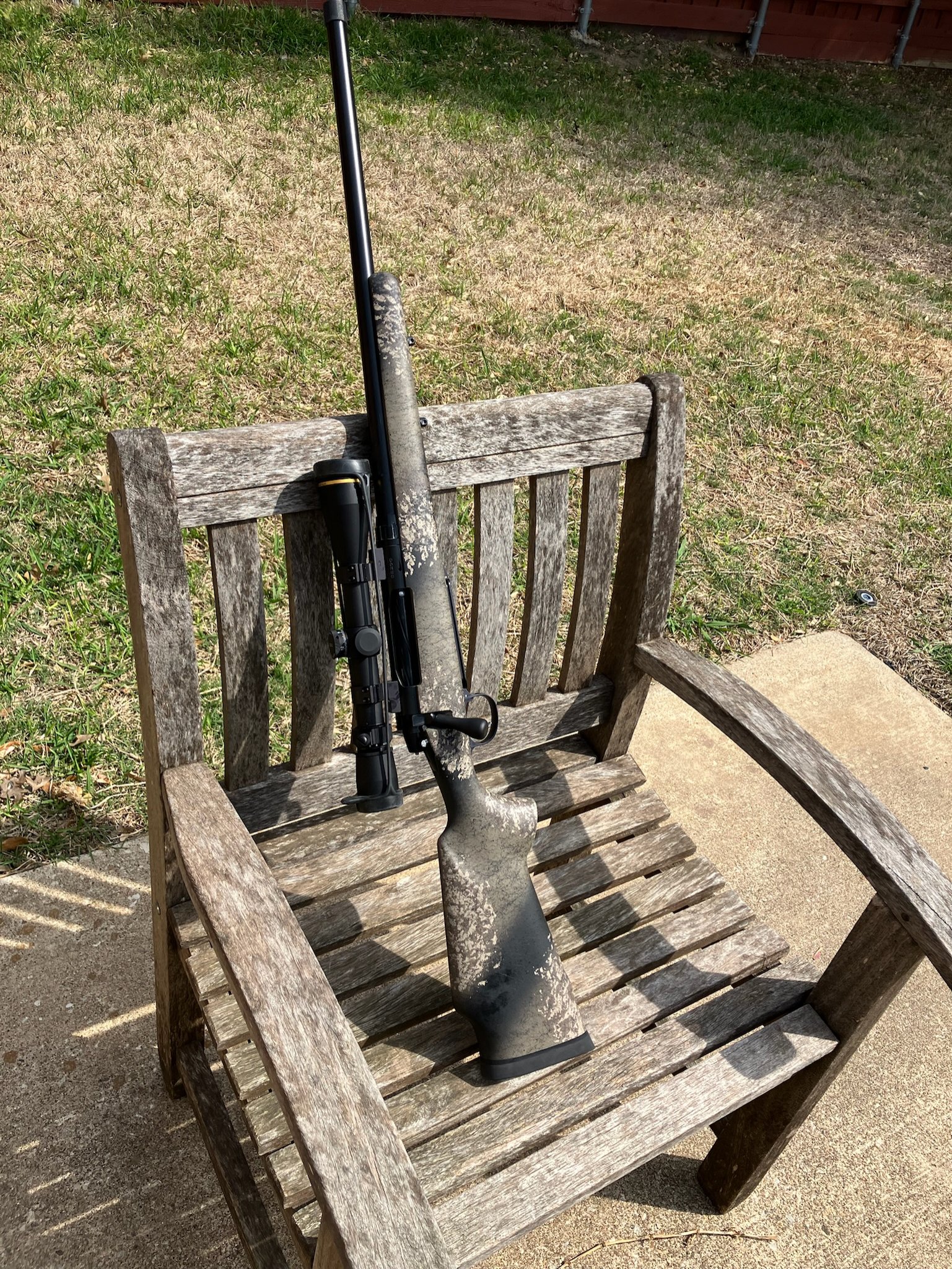

I decided to lighten up my original build (24" 280AI and heavy Meopta scope). Barrel nut Criterion barrel with lighter Leupold scope. I am also converting to a DBM H&S Prevision bottom metal. 9lbs as pictured.
I like how the Greyboe stock blends into the old teak wood.
