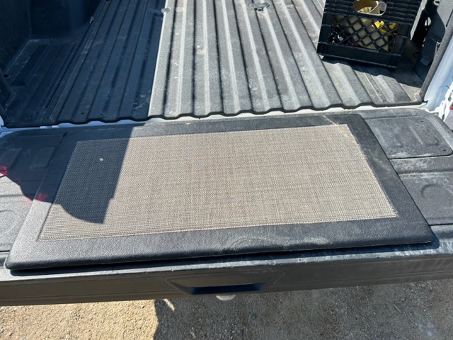

I bought all the materials to build what I wanted in a mat
I had gone away from the wood idea, realized it needs to be able to contour to uneven ground.
This mat caught my eye at Home Depot and it's working perfectly with the Ski Feet from Accutac.
I haven't gotten to take it out to distance yet but putting down some really nice groups at 100.
Its a pretty heavy rubber/ foam and the center is like a woven synthetic material that allows the feet to slide freely.
I will also say the ski feet completely change how the rifle handles it's gonna take some getting used to, I'm so accustomed to shouldering into the bipod
https://www.homedepot.ca/product/ho...-39-inch-ergo-comfort-mat-in-black/1000842866
