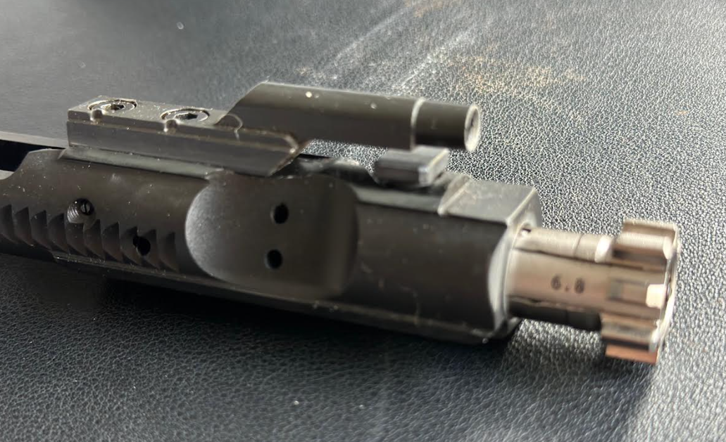

Not sure where you're getting that the small frame JP carrier & bolt are double the price of the Geiselle, but JP's website lists is as #375 vs Geiselle at $325.I have not seen too many talk about Geissele's "nano coating" yet, but the entire carrier has it, as opposed to the DLC offered only on the bolt for JP.
The machine work is definitely nicer on the JP FMOS, but its also double the price.

You missed a pretty critical detail in both my post and the photos.Not sure where you're getting that the small frame JP carrier & bolt are double the price of the Geiselle, but JP's website lists is as #375 vs Geiselle at $325.

Yes, I misunderstood that you were only referring to the carriers..........but the JP is not quite double the cost for the Geiselle, but close enough.You missed a pretty critical detail in both my post and the photos.
I was comparing the cost of bolt carriers, not the entire complete BCG with bolt.
A JP Full Mass bolt carrier is in fact double the price of the Geissele Enhanced bolt carrier.
Also, multiple others in this thread have pointed out that JP’s actual carrier is NOT dlc, so that would be a moot point.
I cannot complain about it, for the price. With the brownells discount, it was $100+tax&shipping.Yes, I misunderstood that you were only referring to the carriers..........but the JP is not quite double the cost for the Geiselle, but close enough.
And yes, I know full well that none of the carriers from JP are DLC. Nonetheless, they are still, very, very slick.
For a carrier of the Geiselle's quality, & PVD coated, the price is not bad & the difference between a PVD & a DLC carrier matters less that it does on the bolt where DLC's toughness is still an edge over CrN via PVD.
And a lot still depends on the quality of the sources doing the coatings. But I have no doubt that Geiselle is using a high quality source.

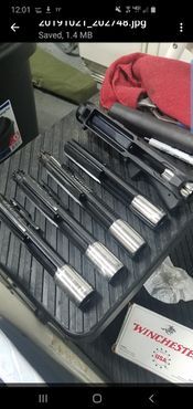

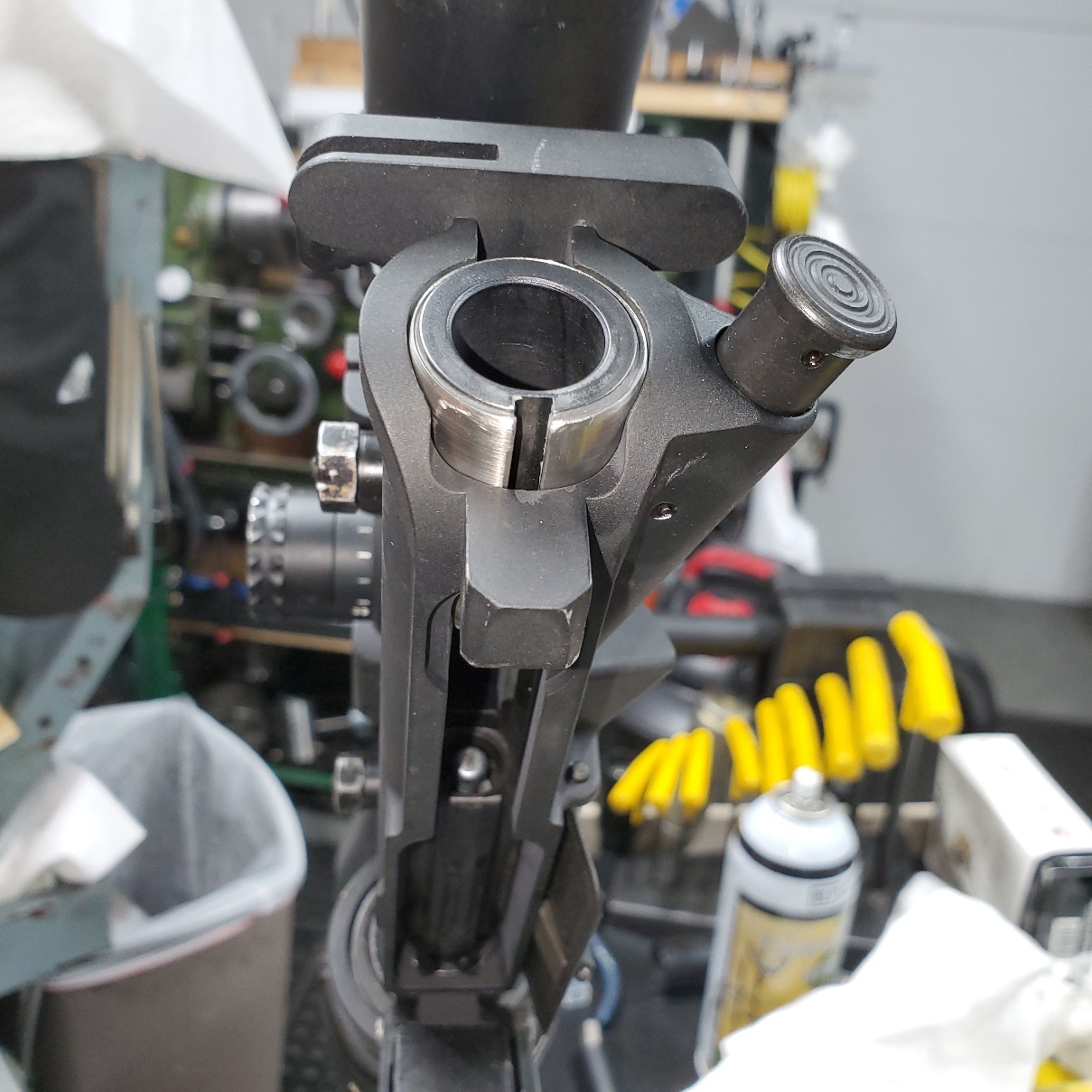

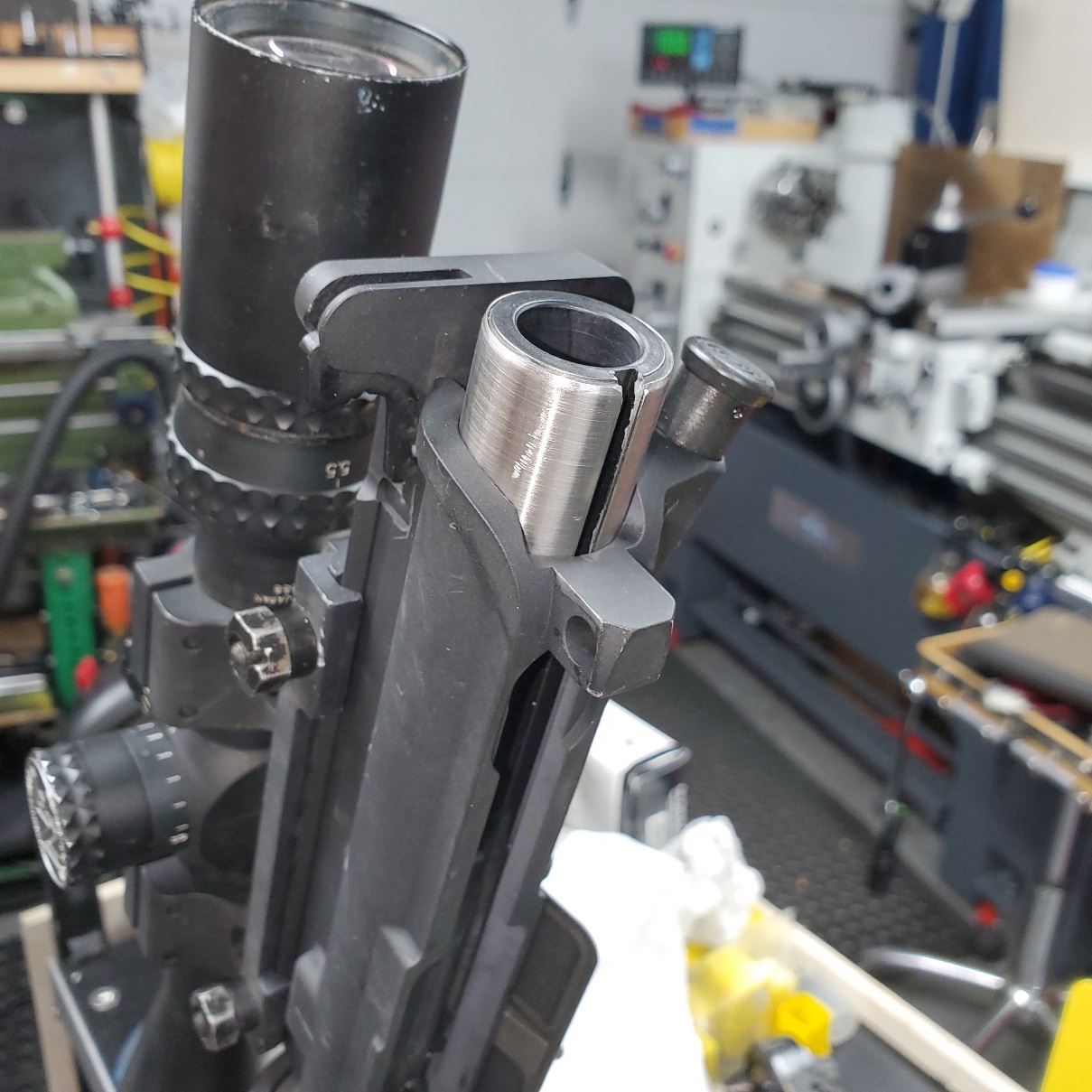

I take it you had to machine the sleeves?I have been using my own enhanced BCG for years. Fitted sleeve, JB Welded, then slot cut. Due to oversized tail, the buffer tubes are bored and polished. The old brake cylinder hone in the tailstock does a good in polishing the bored out tube.
The one with pressed in brass plug is the same on all my service rifles. I've done a few for friends, all were happy with them. No functionality issues.
It must have been close to 10 years ago when I did the first one. It was on a new service rifle upper build, so I did not have A-B comparison. At 200 yards, if I remember, I shot five, 5 shot groups at 200 at different days, none went over 0.8 inch.
Fast forward to before the plandemic, I loaned my rifle to a friend along with my ammo to shoot on a 2-day mid range at Bayou Rifles in Houston area. With 4.5x power scope, 20 inch service rifle, prone, sling, he posted 1189-62X, launching 80 VLDs. The bolt gun with optics sling shooter who won the sling category, I believe was using a 6mm cartridge, shot 1191-59X, maybe 1192. Shooters are both HM.
One data point, but it illustrates the fully captured BCG did not hurt precision, maybe it helped. The shooter to his credit, shot the system very accurately.

Yes. Start with with 1 inch SS tube 1/8 or 1/16 wall. Turn down OD to fit, bore ID to accommodate however thick JB you wish to employ.I take it you had to machine the sleeves?

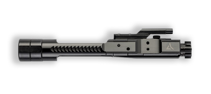

On page one of this discussion I posted a list of quite a few of the similar ones most popularly offered:Any chance we could get a list of oversized bolt carriers to prevent carrier tilt? Young National Match seems to be old news since they sold to a different holding company. I had been thinking of buying a JP - are they considered oversized?
What's the final OD? I need to remeasure the Azimuth ones, but I think there like 0.040" lager than standard.
