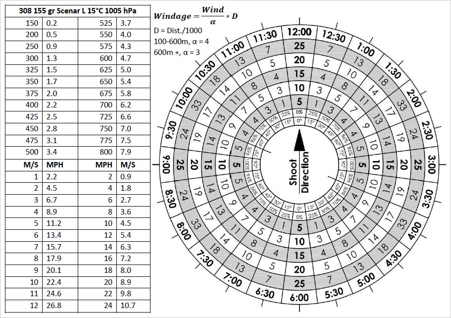

Just got into the whole mph gun thing, but as I live in Denmark and normally do my wind calls in meters per second, my plan was to convert it into a m/s gun number.
However as 1 m/s = 2,25 mph, it didn’t really work out very well, as I would have to deal with too many decimals when crunching the numbers on the fly, due to the lower resolution in m/s.
So despite my complete disbelief in the imperial system, I have now converted all my wind calls to mph! :LOL:
I’m shooting a .308 155 gr. Scenar L at 2830 fps, and it worked out to be 4 mph out to 600 m and 3 mph from 600 to 800 m which is max at my range.
I stole Jack Master’s brilliant wind rose from the wind angle topic, and made myself a little range card with dope, m/s to mph conversions and a little reminder on the calculation.
Have tested it a few times against Applied Ballistics, and it’s surprisingly fast and accurate.
Moved on to make a similar card for my .22 trainer, worked it out to be 8’ish mph, but at closer ranges.
With 8 mph I get below table.
50 m = .5 MIL
60 m = .6 MIL
70 m = .7 MIL
80 m = .8 MIL
90 m = .9 MIL
100 m = 1 MIL
It’s not as pefect as the .308 wind calls, but accurate enough for the shorter distances.
50 m = .5 MIL
60 m = .6 MIL
70 m = .7 MIL
80 m = .8 MIL
90 m = .9 MIL
100 m = 1 MIL

You still have to do the math regardless of what units the wind is measured in.
1,6 is a unwieldy number to crunch without a calculator, whereas 4 mph is easy to work with. You just take your wind call, divide it twice and multiply by the distance.
6 kmph would be usable, but as it's unusual to measure wind in kmph (I don't own a Kestrel, cannot get direct data in kmph from any reliable source and guys with Kestrels at my range measure m/s), it would have to be converted from m/s to kmph anyway. And as 1 m/s is 3.6 kmph, there is no direct link anyway. Heck I would say it's easier to convert m/s to mph and get a usable number, if done without a calculator, you can roughly just double the value.
Applied Ballistics also don't work with kmph, so in order to streamline all data, it was easier for me to move to mph.
I might change my mind later on, but for now the system seems pretty solid, even for a die hard metric guy.

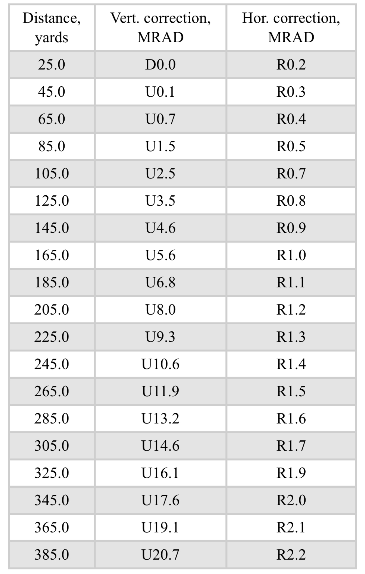

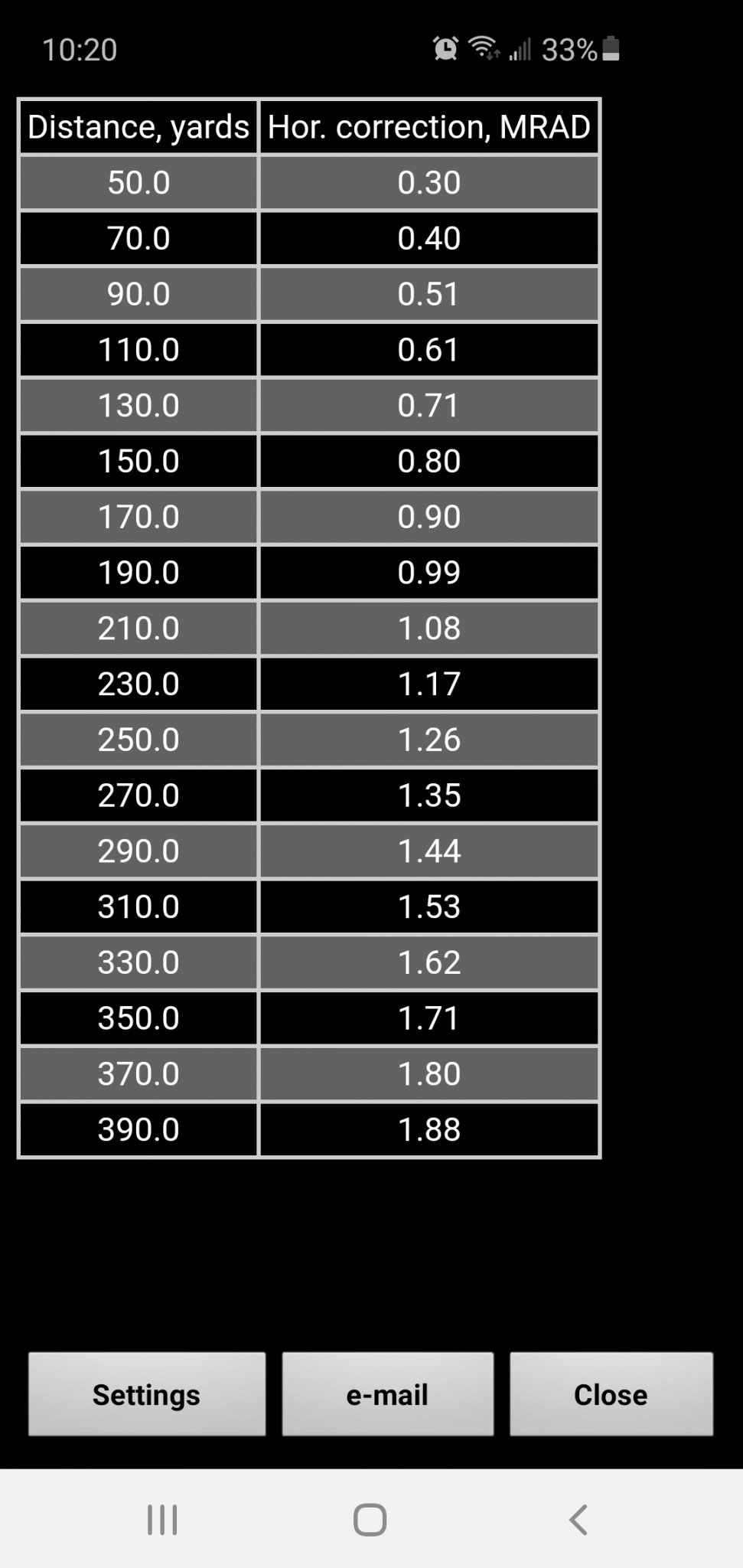

Could someone explain to me how to make this work with 22lr. I really like this mph gun method but am unsure how to do it with my 22. I have made impacts at 400 yards with my 22 and my goal for the summer is to hit 500 consistently. This will really help me achieve that. Thanks for your help and if you dont want to post here feel free to pm me and explain it there. Cheers
Use your ballistic calculator and experiment with 10, 15, 20, and 25yd increments and with 3, 4, 5, 6mph winds.
One of them will line up.
Start with your zero range. As that theoretically should have “zero” wind.
Thanks man, I really appreciate the help. So my rifle is zeroed at 50 yards, I want to play with the wind speed until 50 is .1 and so on correct. Its been quite the learning curve since I started shooting orps and crps(canadas version of nrl22 and nrl22x). I think getting this figured out will help me greatly.
Read post #62 above. He does it for a 22 there.

Ok guys I think I got it. So i used 400 yards and to get 4 mil correction I was at 10.5mph
I used 400 because I shoot out past 300 as much as I can, I really want to hit 500 or better this summer with my 22. Now my wind was coming from 3 o'clock. How will I adjust for quartering to and away winds? When I first ran the numbers I did it at 100 and came up with a 9 mph value. Am I better to use the 100 yard or 400 yard info? Thanks for taking the time to help me get this all figured out.
You’re definitely getting it a bit mixed up.
You want to find that wind that repeatedly increases .1 per a fixed interval.
You adjust non 90deg wind the same way you would anything else. Via direction/percents of full value.
For example here is a 6mph wind with 20yd increments. Notice how it is almost 100% a .1 increment?
That’s with the equivalent of a 6mph full value. So if you have a 12mph wind from a direction that is 50% value.....you use the 6mph.
Ok i get what you are saying. Thanks i was for sure getting it wrong.

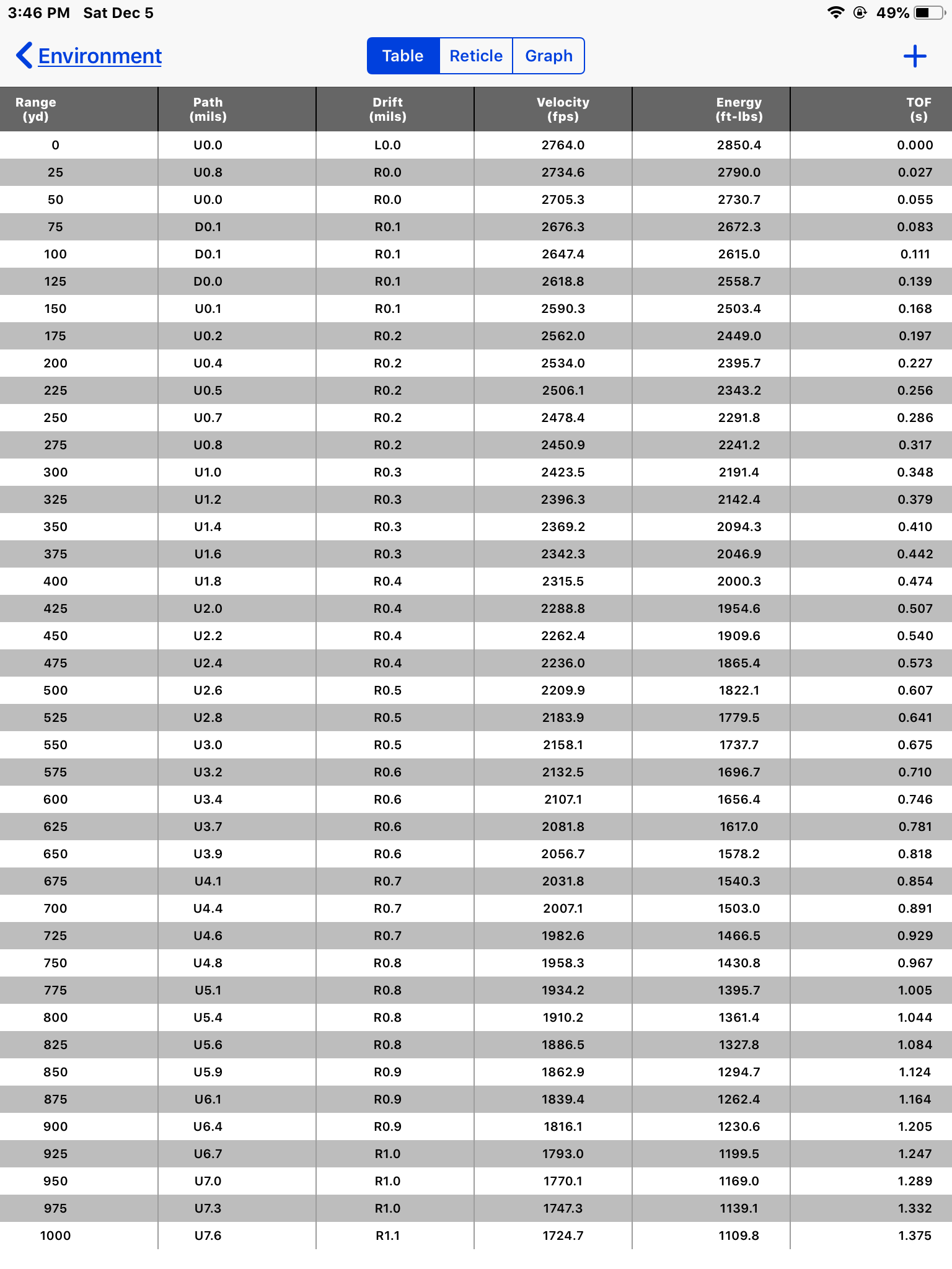

400 is the farthest I have shot so far. I want to try for 500 by end of summer. I was shooting at 330 today with surprising consistency. The wind wasnt terrible, i was kind of bracketing from .2-.4 across the centre of the plate ad was 14.9 mil elevation. I.could see the mirage really well so when the wind changed it was an easy call. Last weekend at 385 I was struggling with a 10"×10" plate but the wind was my main issue. The mirage was pretty much laying flat and I had low, like 30% hit rate.
I don't shoot a lot of 22lr. But quickly played with my 22lr data to see what worked. I set my distance to 300yds and looked for a wind speed to get 3 mil hold. It was 8 mph. This made 200 to be 2 mils and 100 to be 1 mil. Scaling this wind system from being .1 per 100yds to 1 mil at each 100 yards worked really well. I have a 50yd zero in the program.
8mph wind.
50 yd =0.5 (zero distance)
100yd = 1.0
200yd = 2.0
300yd = 3.0.
400yd = 3.9. (Would round to 4.0.)
500yd = 4.9. ( Would round to 5.0)
600yd = 6.0
700 it started to grow. (7.15)
This is the system I would use. It lets you slide the decimal from the yardage to be the wind hold.
Example.
240 yard target is a 2.4 mil hold at 8mph wind.
Maybe this only worked for this one rifle I am shooting. Can anyone check thier data and see if it works for them?

This usually only works until about 200yds.
Then it’s typically not linear.

Regardless you need to convert to a full value wind, once you have your full value wind then you use your MPH of your gun to figure your hold.
Ok so I understand the MPH of my 308 is a 4mph gun and basically (to a point) each yardage is that many .mils at a 4mph cross wind. (@90 or 270 degrees). My question is using this method how do you determine the correct wind hold with a quartering wind. I’ve used the British wind method in the past and wanting to give this method a shot
Read here.
The modern wind rose
Reactions: seansmd
That is a method we talk about a lot
Go into the Everyday Sniper Podcast Section it's there a bunch
Basically you determine your 600 yard wind so it lines up to .6 Mils at 600
That is your MPH Gun, so you have
100 = .1
200 = .2
300 = .3
400 = .4
500 = .5
600 = .6
From there you only use multiples of that MPH
