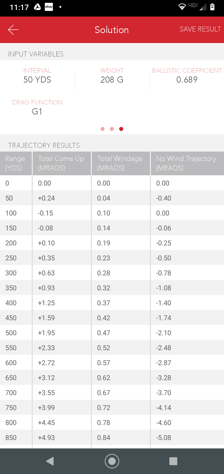

Ok I am late to the party and I have skimmed through the highlights here. I am interested in simple wind calls for hunting. These seems like an awesome method if I can get my head around it.....
Below is my 20” 280AI set at an 7.5 mph crosswind. So am I right that I have an 7.5 mph gun/load? Or am I way off base?
Thanks!
Yep. Gou are spot on. I would use 7mph for that rifle just to keep it simple.

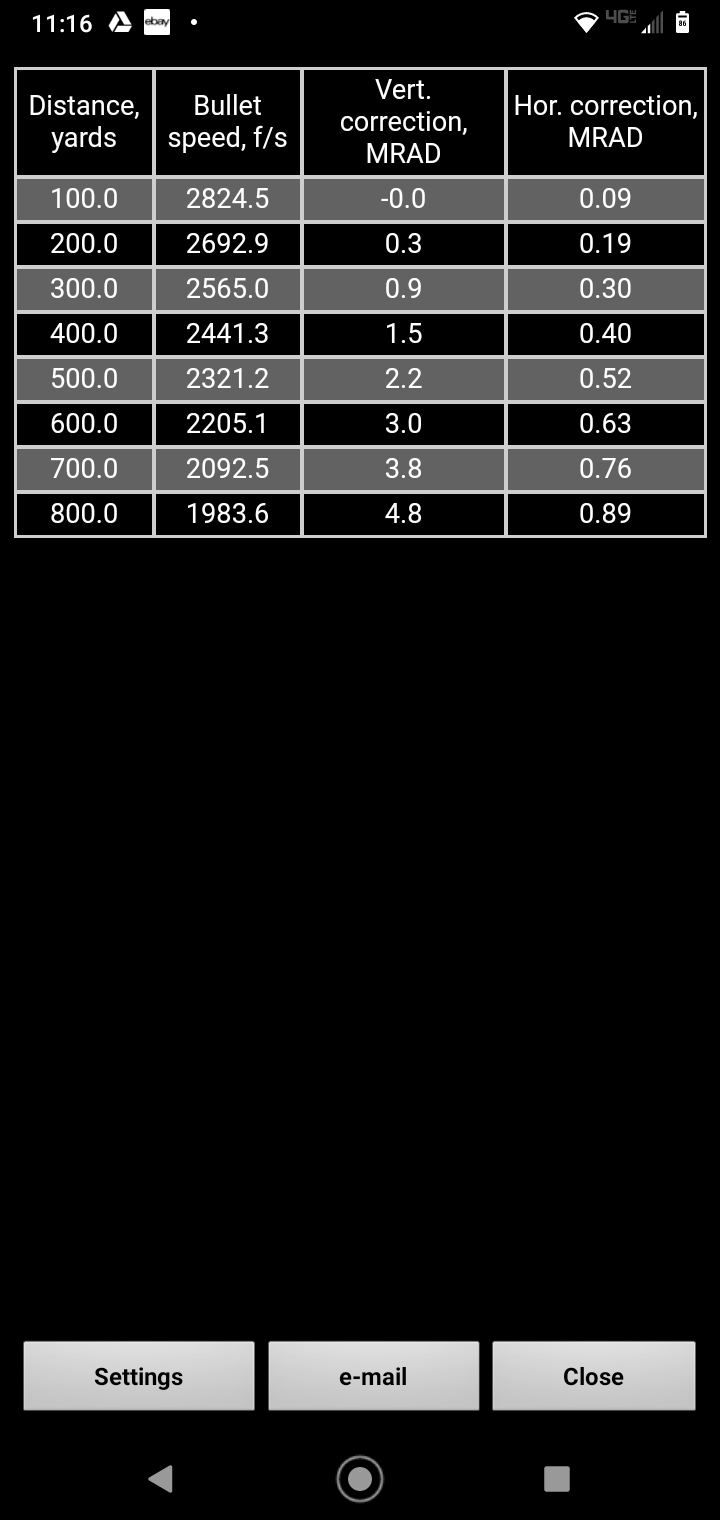

Okay so Ive gone through all the instruction frank has given about finding the mph value of my rifle and wanted to run it past you guys. Im shooting a 208gr berger with a g1 of .689 at 2960fps. I shoot at 4200ft above sea level and according to that math my rifle is a 8mph rifle. Does that sound accurate to you guys? Im still trying to figure this whole mph method out
Running through Strelok, yes. Hornady 4DOF close.

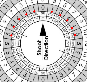

Is there a trick to the trigonometry or wind rose without the wind rose? Is it just straight memorization? How do you learn the corrected wind for the direction it's blowing at every wind speed without the wind rose in the field?

If you do not have a wind rose you can memorize these couple numbers and do the math in the field
12:20 = 25%
1:00 = 50%
1:30 = 70% (some would use 75%)
2:00 = 86% (some would use 90%)
2:30 and 3 = 100%
Example
10mph wind at 1:30 is 7mph cross wind (10mph x 70% = 7mph)

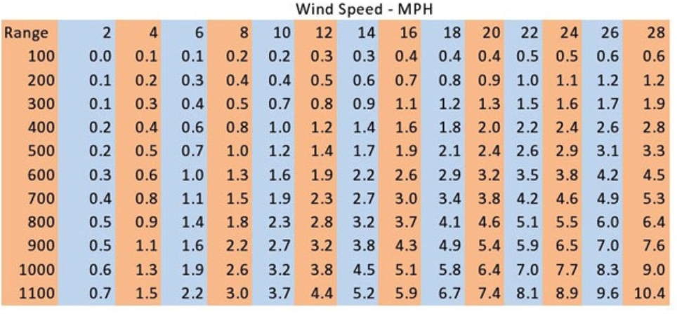

@Lowlight - Frank (or anybody else), you know I rode the short bus to school so....what is this chart for. What MPH gun. I see that under 6 mph wind at 100 its a .1 hold. Makes sense for a 6 mph gun but it doesn't hold as we go thru the chart.
i.e. if a 6 mph gun, then at 100 yds wouldn't the 12 mph wind hold be .2, but it shows .3? And if we go down the column under 6 mph wind, then shouldn't the hold values just march up at .2, .3, .4, etc as the range increases.
Yes, I admit in advance I'm an idiot. LOL
The chart is old, 15 years old, you don’t understand it please don’t use it
None of the other numbers will work for you it’s not a MPH gun chart it just shows you can see it based on the bullet.
The chart is an old 175gr chart only for my gun, we don’t use these like this anymore
Stop over complicating things we have gun number charts on here that look nothing like this right ? You saw the PowerPoint 3x now, the gun number chart looks different
Only the 4 MPH column works because it’s a 4 mph bullet nothing else will work for you
But its my super power! LOL
Well, only twice....this Sep will be 3 times! haha
I got it...I have the proper gun MPH charts and understand them. This one we are talking about just sort of threw me for a loop.
Thanks Frank and travel safe. I look forward to seeing you and Marc in Sep. 👍
