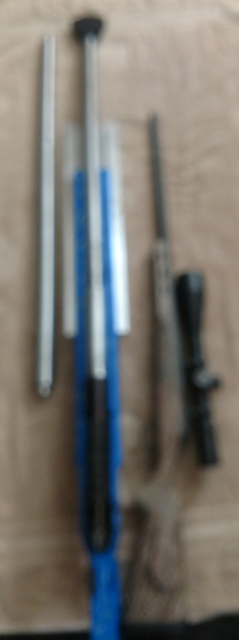

The gun in the picture is my 375/50BMG and the barrel is expected to last 400 rounds. Barrel cost $700 and the installation with the muzzlebrake is another $650 or $1350 for 400 rounds. Bullets run $3 each and I use 208 grains of VV20N29 powder at $268 plus Hazmat. RWS Primers are 50 cents each and brass is $5 a case for RWS or Lapua.
On a situation like mine you do the quickest work up you can which is around 40 rounds or 10% of your barrels accuracy life.
When you order your barrel you get enough shank length so it can be setback and also recrowned. The first barrel gets used for practice and fireforming and the second barrel is used for matches that count.

The picture shows a Remington 700 next to the 375/50 BMG and the larger second barrel for matches. Sorry about the picture quality I fell on my phone.
