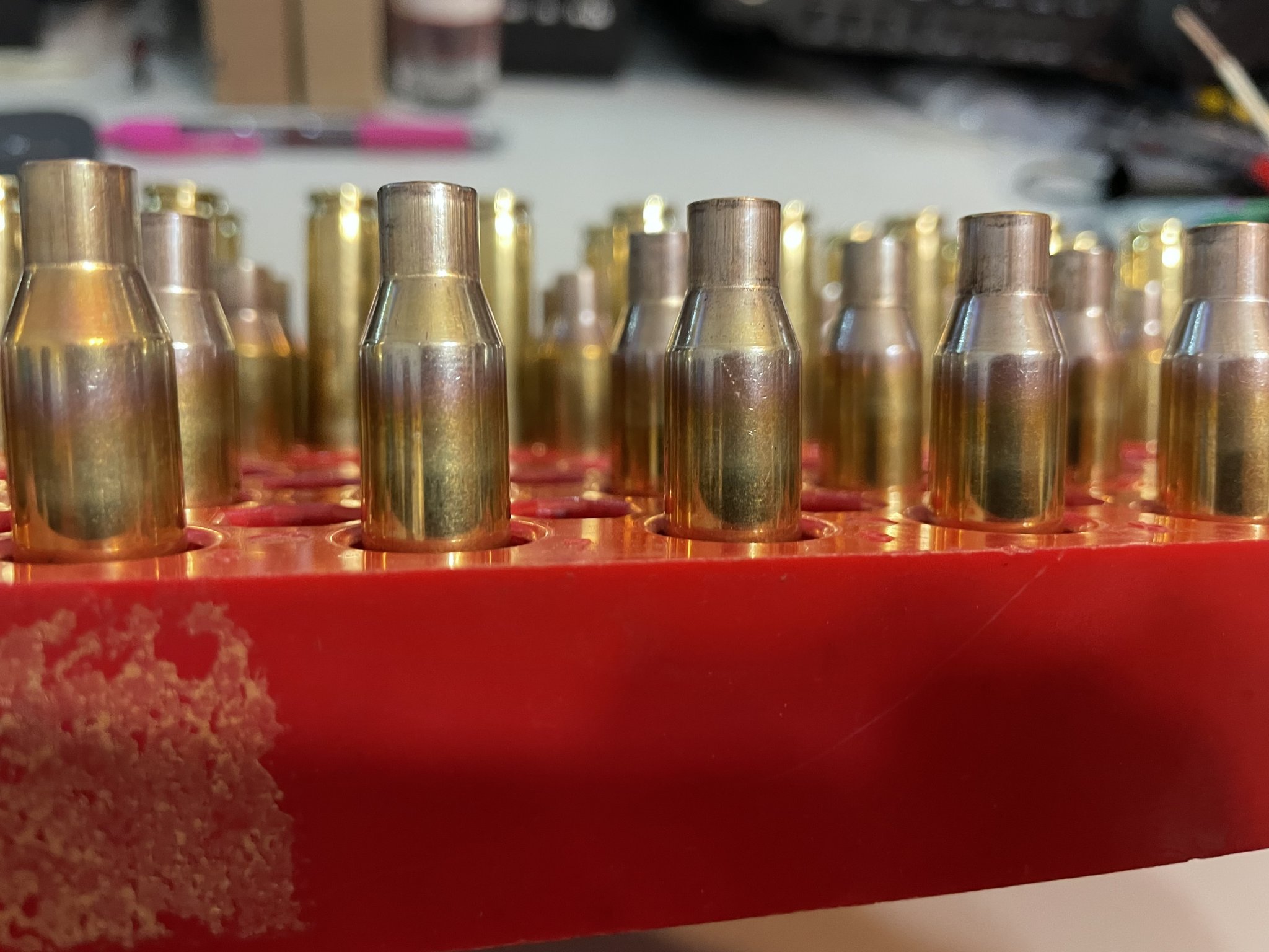

Solary Magnetic Induction Heater... Amazon product ASIN B0851C6Q22
Did 100 pieces of brass in 20 minutes! To heck with $1500 commercial inductive annealing machine. Bend the correct size element to where they are 90° instead of straight, Turn your lights down low where you can see the brass just start to turn orange and go to the next one. Takes about 4-5 seconds depending on brass thickness and length. DONT USE A CHEAP PLASTIC TRAY like in pic 😂
