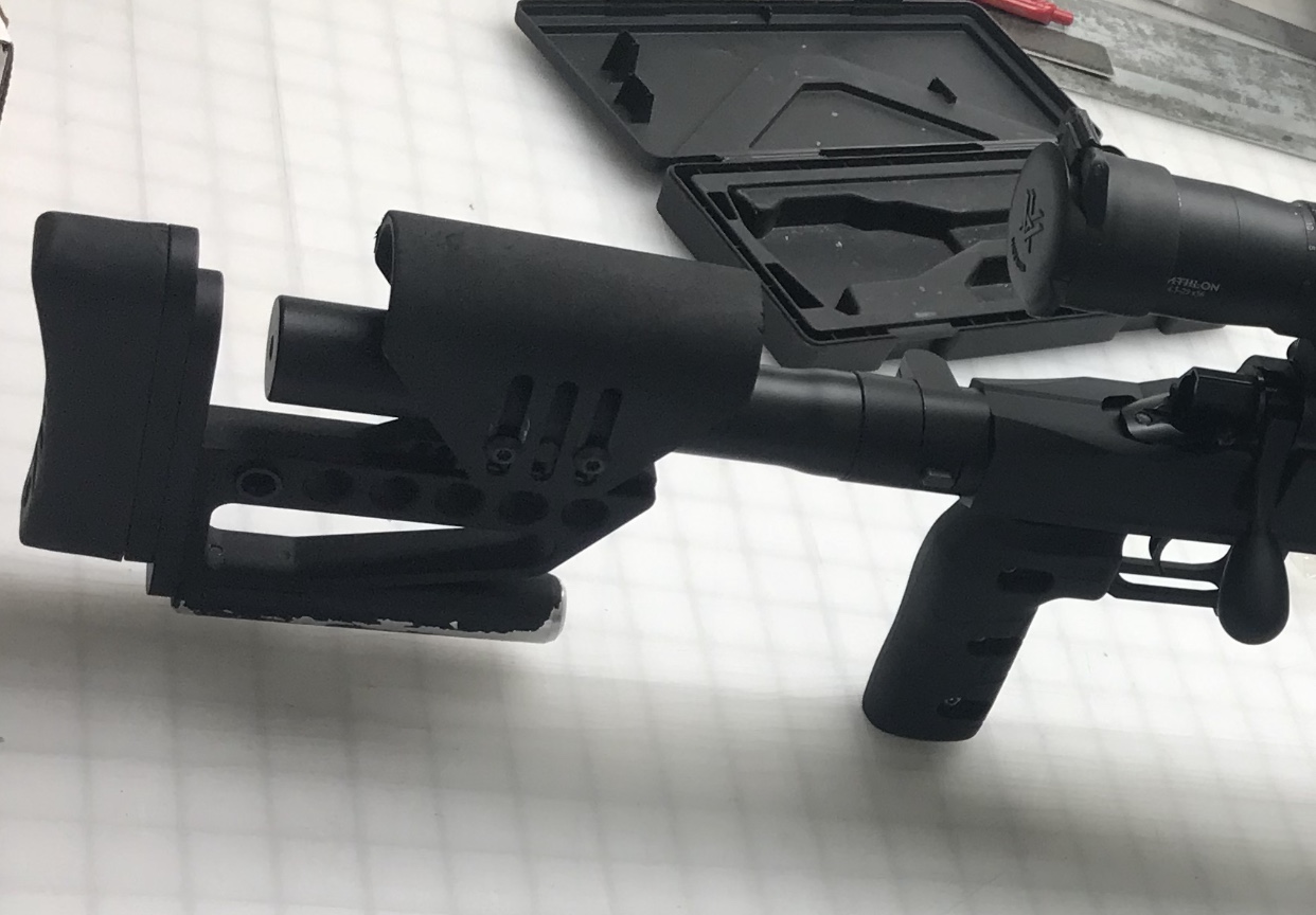

For me it’s something like this.
7091548
