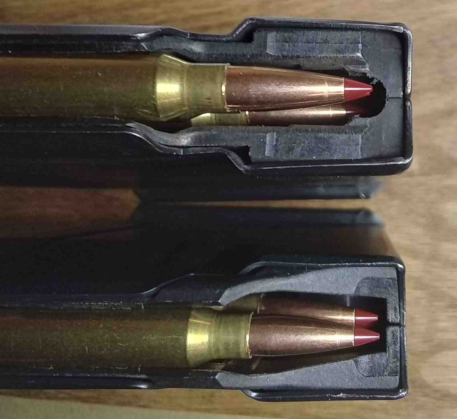

Question for other folks running .223 in their CDG. How much tuning do you have to do for the average magazine? I know there were a few posts in this thread about mag nodding.
Any recommendations for good DSSF .223 mags? I got one from MDT to try before I buy more, but it has had trouble feeding the last few rounds. (Bolt slides over the round as it slides forward I. The feed lips).

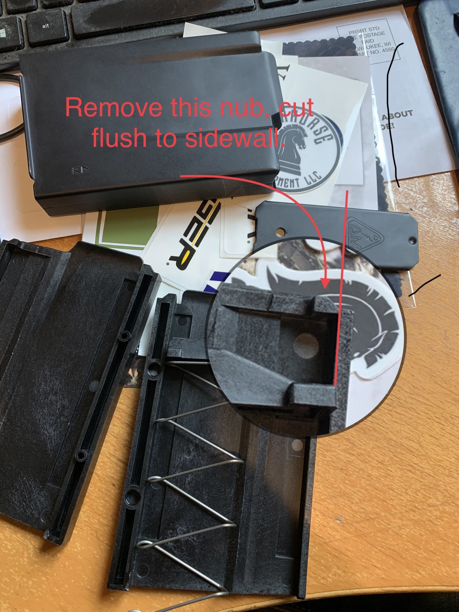

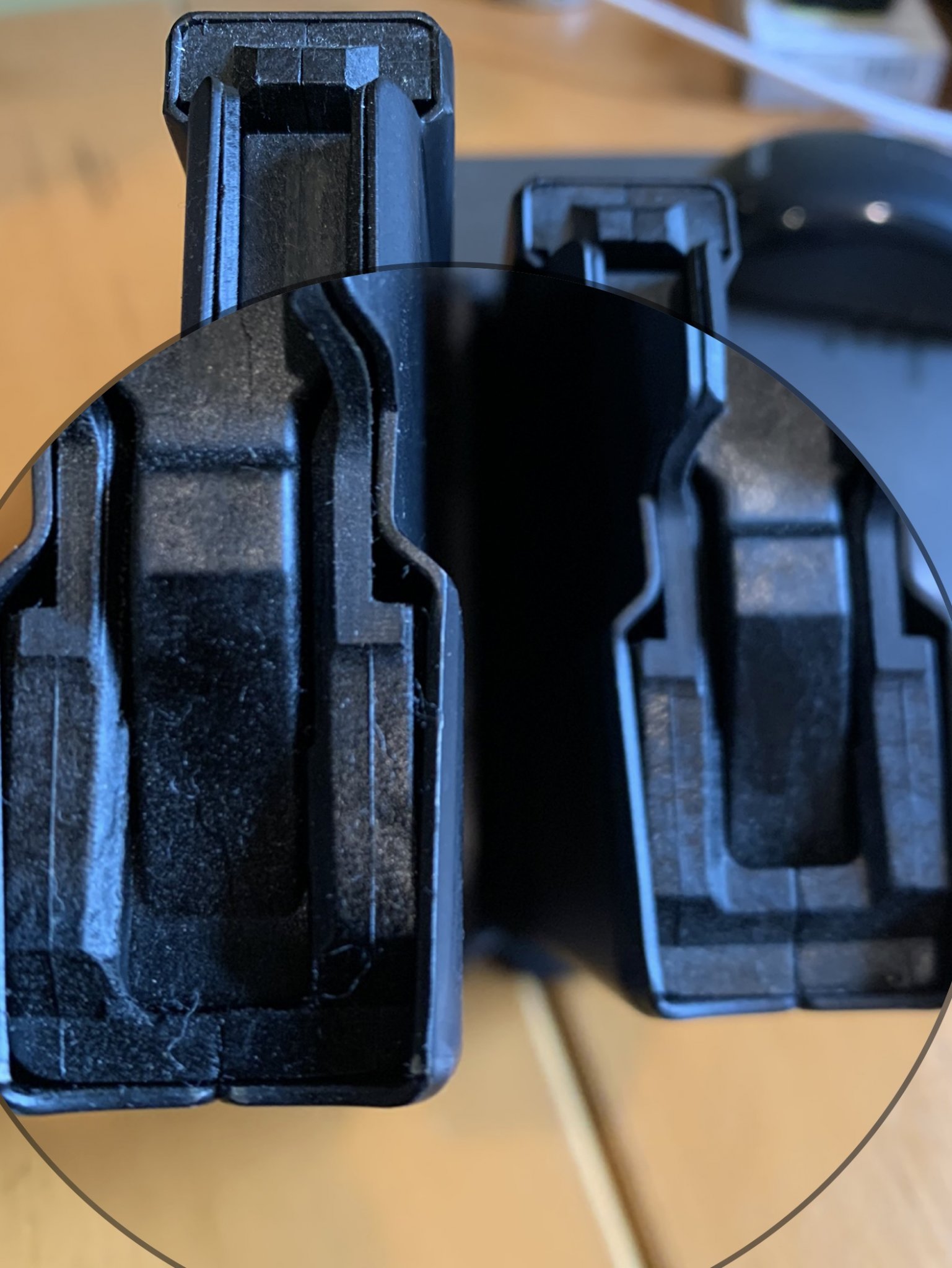

I was able to fix it by carefully observing the feeding issue (slow motion video) and sanding down some bowing in the polymer walled feed lips to flatten things out, but I hesitate to buy more until I ask around and see what other folks experience has been . These seemed particularly finicky.
What AICS mags do you prefer for .223? How reliably do they feed In the CDG? I know chassis has a part to play here as well. My magwell is tuned very tight
The recommended mag from ARC is Accurate Mag. Either a 5 of 10 round mag. I have a 223 CDG and all i had to do is use an adjustable mag latch to set the correct height so it does not drag on the bolt. There is a spacer that comes with the action in the bottom of the box for AICS mags. If you put upward pressure on the mag it will jam into the bolt. Possible that you have to modify the chassis to get the space to fit.
Reactions: lash and Ichi
I'm using the 223 AICS Accurate Mag with no issues.

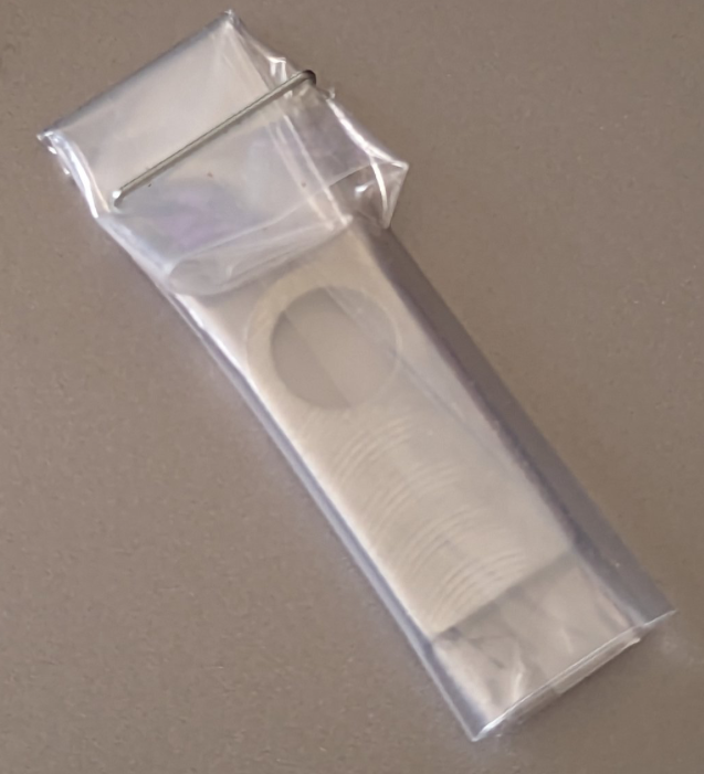

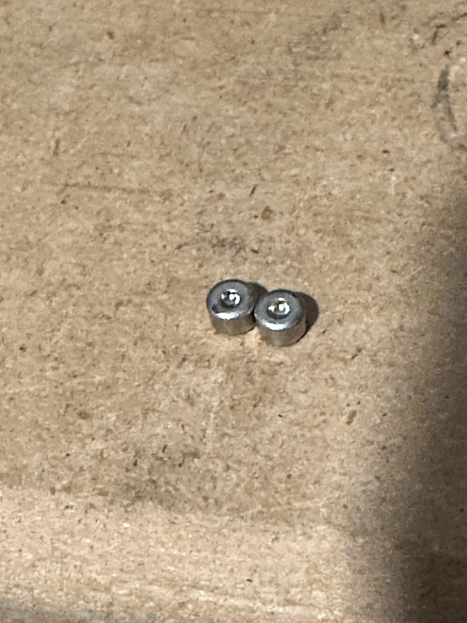

I didn't get a spacer with my CDG, sadly. Yours came with one?
The spacer was easy to miss in the bottom of the box, very small.
FYI- with a little modification to the Accurate mag I'm able to load 223 out to 2.540". That's enough for anything I've loaded so far.
Just checked all the packaging materials again. Even took down the boxes and shook out the padding. No spacer :(
You're talking about that little tab that sits between the action and the chassis near the the feed ramp, right? The thing Ted showed in one of his videos about mags he said we probably wouldn't need?
Yes the little Silver tab.
Here's the tab in the plastic bag that it is shipped in.
I don’t use that tab in my MDT ACC Elite and have seen success with Accurate Mag AICS mags in 6mm live fire and .223 during feed/cycling testing operations.
Just so I am certain, we're talking about these, right?
Thanks for the pic. Definitely did not get one of those tabs. I was very thorough to check everything I received since a few parts of my order got mixed up, and I had to work with ARC to get it straightened out.
Reactions: TheOE800
Yes & pick std feed lips for ARC's/CRF actions.

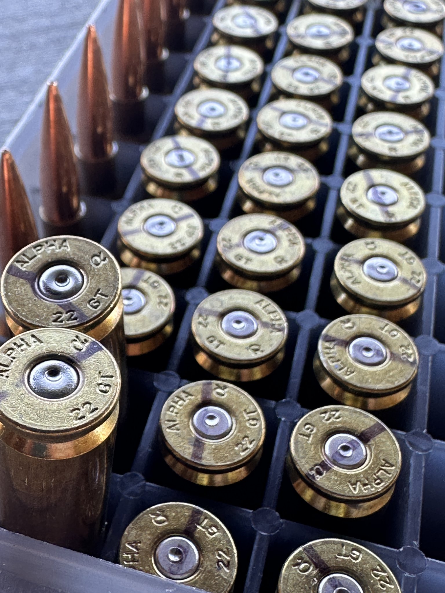

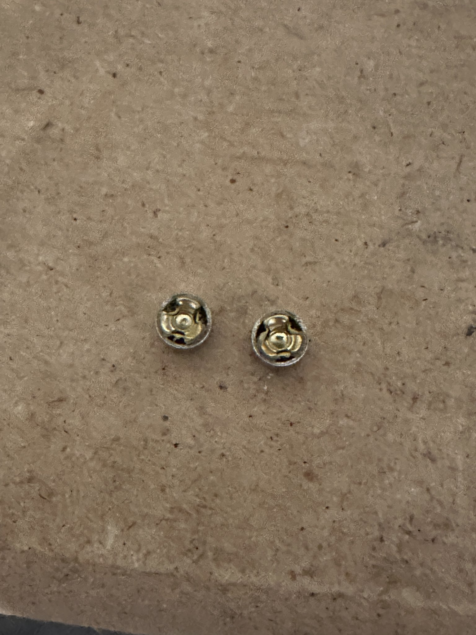

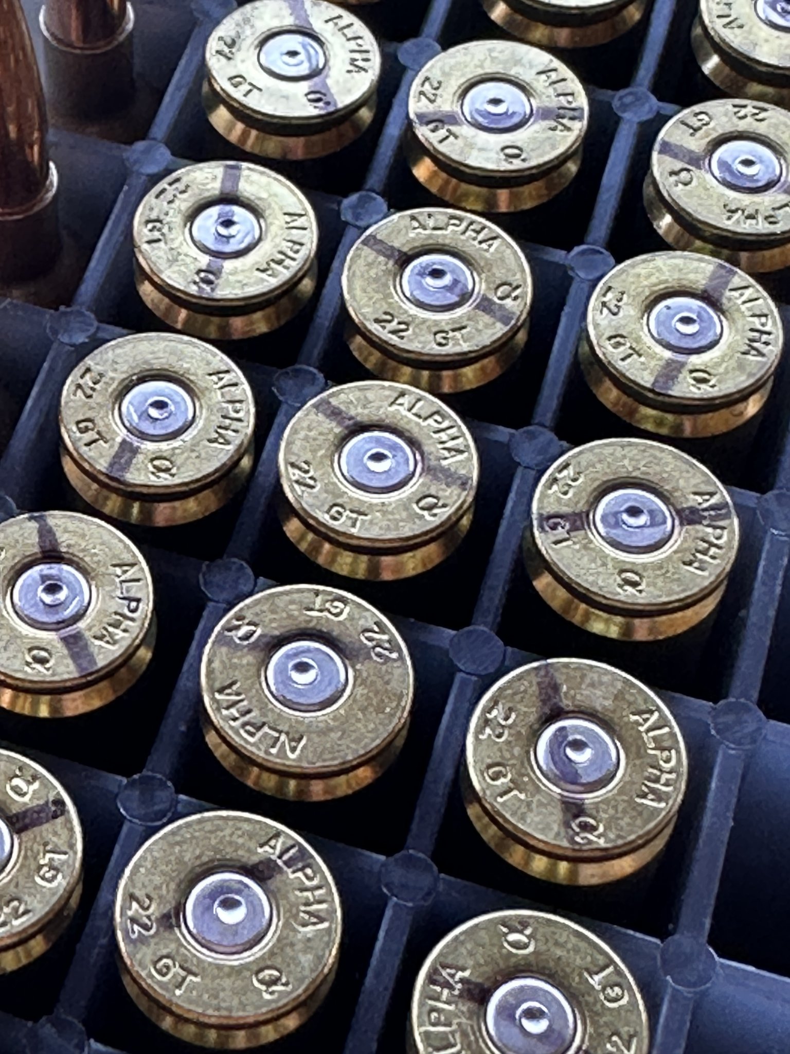

How deep are you seating the primers? Have you taken a cartridge that didn't fire apart to see if the primer fired?
I recently ran into a problem with large rifle primers (CDG action) where they had to be seated deeper than .004" and less than .010" deep or they had problems with not firing. Seating them .010" deep broke some of the primers (CCI 200). After taking them apart I found none of the primers had fired even after 4 or 5 attempts on some of the rounds. Seating them .004" deep wasn't deep enough, but they fired on the second try. I've never used large rifle primers before so thinking this was just due to my inexperience. Loaded my last batch to .007" deep and had no issues.
I use CCI 450s on my 6.5CM and never ran into any problems with duds. Seated them anywhere from .003" to .010" deep and never had an issue. So my issues with LRP may not be related to your issues with CCI 450s.
I have a feeling your ignition issues are not related to having to be seated 005-009 primer depth, I think you have something else going on. I seat all my primers to where I can feel slight crush to bottom of pocket. With lapua brass srp that's usually 003-004 deep, alpha srp 001-002. Adg lrp 003-004. This is all I have ever done for prob 20k rounds of rifle fire. Only time I've ever not had primers ignite, was headspace issues caused by a deep chamber/too much shoulder bump upon sizing, or the primers were 40 years old and not stored well. My CDG 6bra, Alpha brass cci450 primers are 001 below case head, prob 600 rounds never once an issue. Other cdg 65cm with lapua seated 004 bout 500 rounds, no issues. As long as a primer is flush of the case head, you're good. Seating the primer deeper into the pocket past contact to the bottom of the pocket is not going to do anything for cocsistency of ignition. Benchrest guys do experiment with primer depth, but that's an accuracy thing.
Measure the shoulder with you bump too one brass you're having issues with and compare that with a deprimed fired case. If you're fire forming to an improved chamber (think 6br to dasher) you may need to set a false shoulder, or jam bullets into lands 10-15k to keep case head from coming forward upon firing pin contacting primer.
Accurate-Mag top, MDT Bottom. with 80 grain .223
I removed some material from the front of the Accurate-Mag with a drill press to allow the COAL to clear the front.
What has your experience been with that MDT mag? Do you have feeding issues in the CDG?

I have used the metal/polymer insert .223 MDT mag without issue.
I have two of them and they work fine.
I don’t think I have ever seen a .223 mag without the polymer insert.

Unfortunately... I use those .223 magazines with my Mausingfield M7, my CDG is built as a .308. Both magazines work but I do think the Accurate-Mag are better.
Interesting, thanks. I have one that consistently fails to feed the last two rounds. I've modded it to make it work, but it took a bit of painstaking fiddling around with the feed lips. Seemed like the spring was too weak.
I just ordered a few Accurate Mags with regular lips to try out. I wish someone made an all-metal .223 AICS mag, but I haven't been able to find any this far.
You need a certain amount of round on top of the round to enable double to single feed and the width of the aics pattern makes that unsuitable for 223 sized brass, so even with all metal mags it will need a cover to fit the aics magwell, then there is the cost of the dies for the stamping machines, so the plastic insert is what you get
I was replying to @HemiPowrd as to his primer depths for consistent ignition. Your pin depth looks good in the photos, if the primer compound is properly installed in the primer and mandrel is good they should be popping. I haven't really looked that closely at a Cci srp's underside to see if there are visual anomalies present. I know I always hated decapping an unfired primer, fearing ignition, but nothing has ever happened, although I've only done it a few times.
