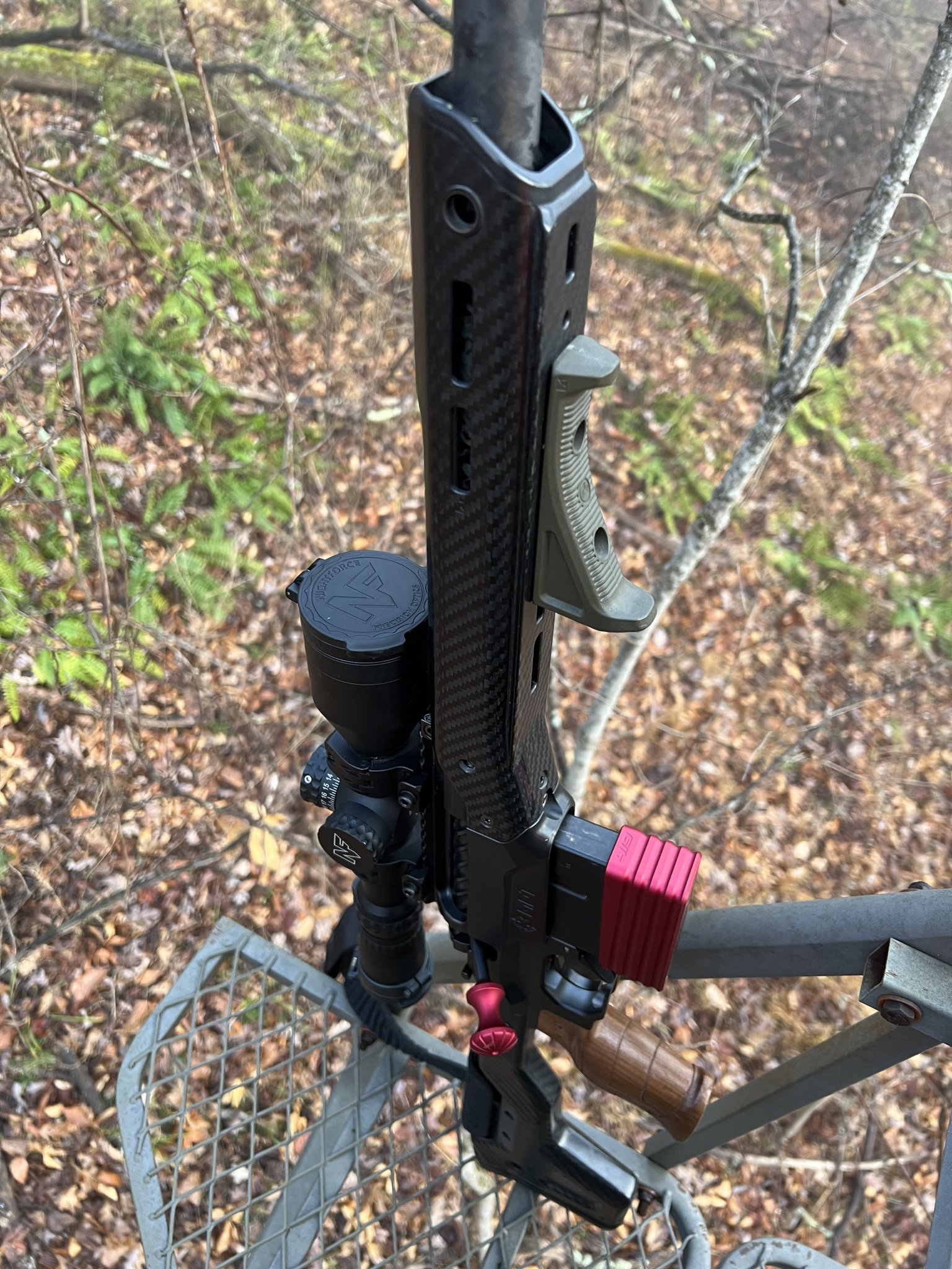

Are there any folding stock chassis that fit the CDG, where the stock folds to the right/over the bolt handle? I found this with some digging and was actively considering the Magpul until I found it; price was right, I liked the stock/chassis, Magpul is generally good...but if it doesn't fit over the bolt handle, then that's that, dead in the water. Is there anything else out there that'll work the way I hope it will? Hopefully for a grand or less? :D
I wound up YOLOing a Magpul 700 Pro anyway, figuring worst case I live with taking the bolt out of the gun and risk losing it. The whole reason behind wanting a right-folding stock was to keep everything together...less things to possibly fall out or get lost. But, I can tie a bag to the whole thing, so whatever...should be easy enough to keep together. If the bolt arm were bent down a bit more, I think the stock would close just fine.
Anyway - the Magpul chassis will NOT fit without cutting - both plastic and metal. The front of the trigger hanger interferes with the rear of the magwell, which is an easy fix; you can cut a notch in it, it's plastic and easy to do with ye old Dremel. Still need to check mag fitment though, which I can't do just yet, because...
The rear of the trigger hanger interferes with the aluminum chassis right ahead of the rear action screw...the notch that needs to be cut is fairly shallow, but it's a lot easier to do with a mill (and a machinist). I have neither, and evidentially don't have any decent metal cutting bits for my Dremel, so I need to get some bits and see if I can cut a notch without ruining things. There's plenty of meat there so I don't think anything other than cosmetic issues will arise. Famous last words...

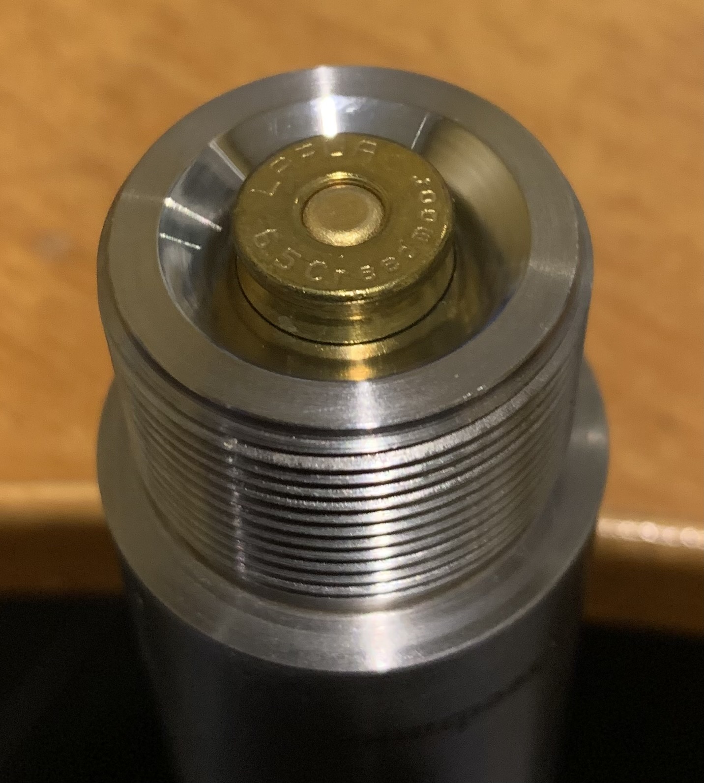

I have unfortunately been away for a bit. What is the general consensus on the 6 GT and the requirement for a coned breech?
Though not a 6 GT, I mocked up a CDG action with 6 Creed shot-out barrel on a Xylo chassis and cycled dummy rounds with good success.

PVA & Fisher T&C are 2 I can personally vouch for with a CDG coned breach.

Coned breach is not any harder than anything else, what I can tell you is they feed like butter. They all headspace the same. Win Mod 70 ran coned breaches forever.

It's because it's a 3 lug with the CDG having one of the lugs @ 6:00 o'clock. That low 6 o'clock lug is what optimizes it for AW mags, but you lose the feed ramp in the action. The other 3 lug ARC actions have the 3rd lug at 12:00 with a feed ramp @6:00. The bigger the case dia. the lower the chamber is in relation to bullet CL.
It's been reported that it'll feed Creedmoor & 308 without the coned breach, however 308 & under case size has a pretty high probability for the bullet to hit the breach face. They might load fine but why risk nicking meplats on the way in. I want the peace of mind knowing any flyers are caused by the nut pulling the trigger; not mechanically induced.
It's also been put to rest that your not giving up any case head support if the cone is done correctly. Starting with 12 in the mag I can feel it pick up about the first 6-8 after that it feels like I'm racking an empty bolt.

@357Max explained it well. Early pages have posts by @karagias. Has some cad models that show the geometry to better understand.
Not required for magnums. Required for 223 sizes.
