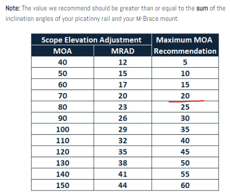

Doesn't that scope have 70 moa travel?
75 moa or 22.4 mils. I currently have my HD LHT on my Sig Cross with 0 moa. I can dial 15 mils up (wasting about 7.4 mils). 30 moa cant is 8.7 mils. I then mounted the scope on a Tikka T3X with 20 moa base and can dial 20.2 mils (wasting about 2.2 mils). Based on these 2 rifles I am confident that I cannot a 100 or 200yd zero on my 30 moa CDG.

Another option would be to buy an ARC 10 MOA MBrace mount and use the mount backwards to give you an effective 20 MOA mount. No waiting for a new action.
yep, that is one of my options too (but not very high on my list). Their 10 moa, 30mm option just went live this week but she's a heavy mount at 9 oz. If only Spuhr made their lightweight hunter series unimounts or Badger unimount in 10 moa this 30 moa CDG wouldn't of been a problem at all for my HD LHT.
Understood and I wondered if the weight would be an issue. Just for your peace of mind I have that exact some scope on a 20 MOA rail and have 6.5 to 7 mils down before I run out of adjustment.
Nice! When I started asking around I did get various answers. You are the 2nd to have enough under to make a 30 moa rail work. The majority did not have enough elevation (HD LHT owners and another guy with a Trijicon Tenmile) to make a 30 moa cant work so I'm playing it safe. Rather not find out after the barrel gets installed. ARC's general guideline chart and talking to them pretty much helped me make my decision to dump it or find a unicorn lighweight 10moa unimount.
Even if it did work with the 30 MOA rail you'd be maxing or almost maxing out your scopes adjustment - not a good thing.
Reactions: AznTactical
You could order a 20MOA mount, run it backwards and use your rifle. If you want to get a different action you can order it now and when it comes in you can sell your original and the mount for almost what you paid for them.
ARC also told me that I am very unlikely to get a 100 or 200yd zero when I called them asking about a 10 moa Mbrace (which was not available in a 30mm) last week.
Use a 20 MOA mount and put it on backwards, LOL.
