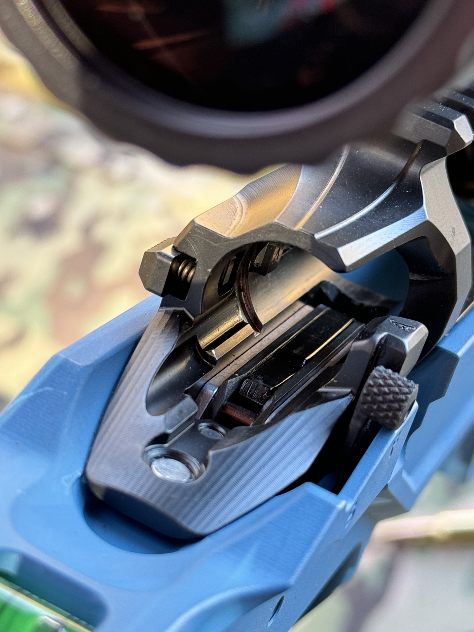

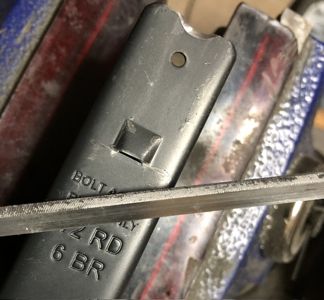

what did you do to the AICS mags? receive the back so of the mag wall a little? love to see some pics. I have the same recipe as your pic. foundation with M5 metal and the stupid AICS mags are not loving life at all.
I thought I posted this early last year, but you caught me fitting another this morning.
First I give it clearance for the back of the CDG receiver. Then using a safe edge file, take a few thousands off latch catch until the bolt doesn’t drag on the feed lips.
They still run great in my AW cut & standard AICS Impacts also. Almost all my comp guns are in Foundations with Hawkins M5 DBM with their standard mag latch.

this was literally my plan of attack.. thanks for the info! not sure why we cant get adjustable mag latches for M5 bottom metals. MDT makes one but its backorder for no acceptable reason.
are you running the mag stop in the front receiver bolt?

All you need to do is trim the rear action screw, it sticks out a little far and doesn’t allow the bolt to cycle. 2 minute job on a bench grinder. And adjust the mag latch another 2 minute job. Done.

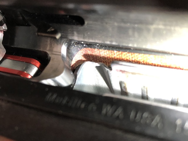

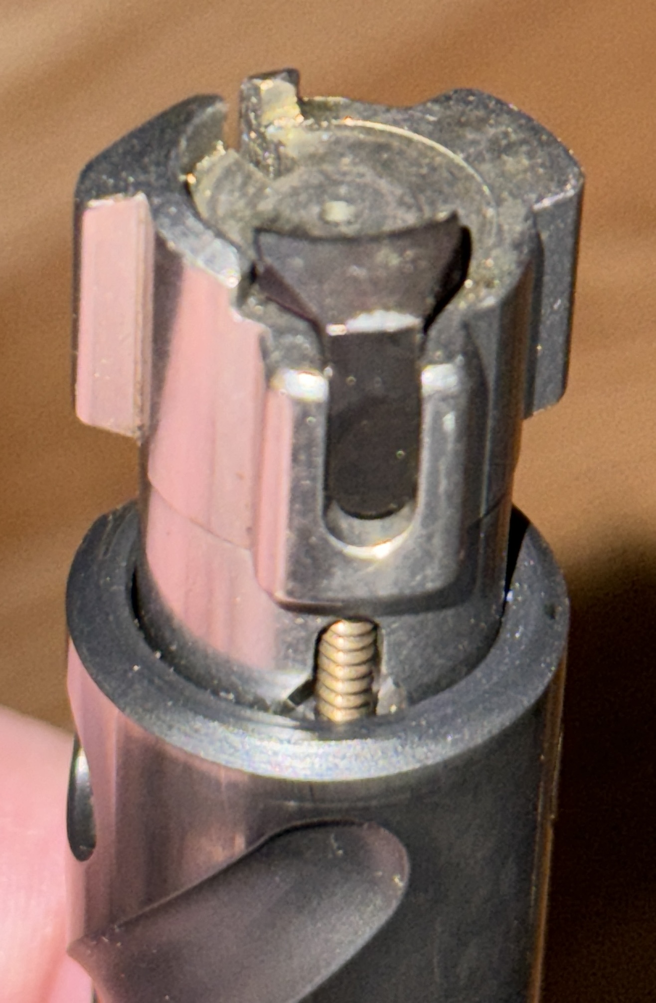

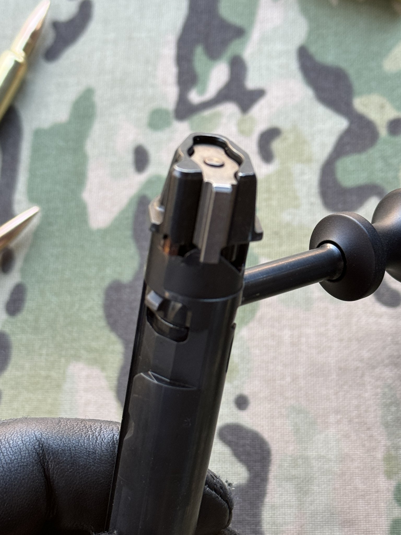

Got the rifle home… swapped out the original extractor and bolt parts… pulled the bullet from a case, and put an empty case in the barrel:
With the original extractor configuration it fires without issue…
No idea what is causing problems… but it may be assumed that the new extractor is hitting the conical breach somehow. ???
I don't think it's the extractor, but to check for rubbing put some sharpe ink on the face of the extractor and repeat. If it's rubbing the breech, you'll see some ink removed.

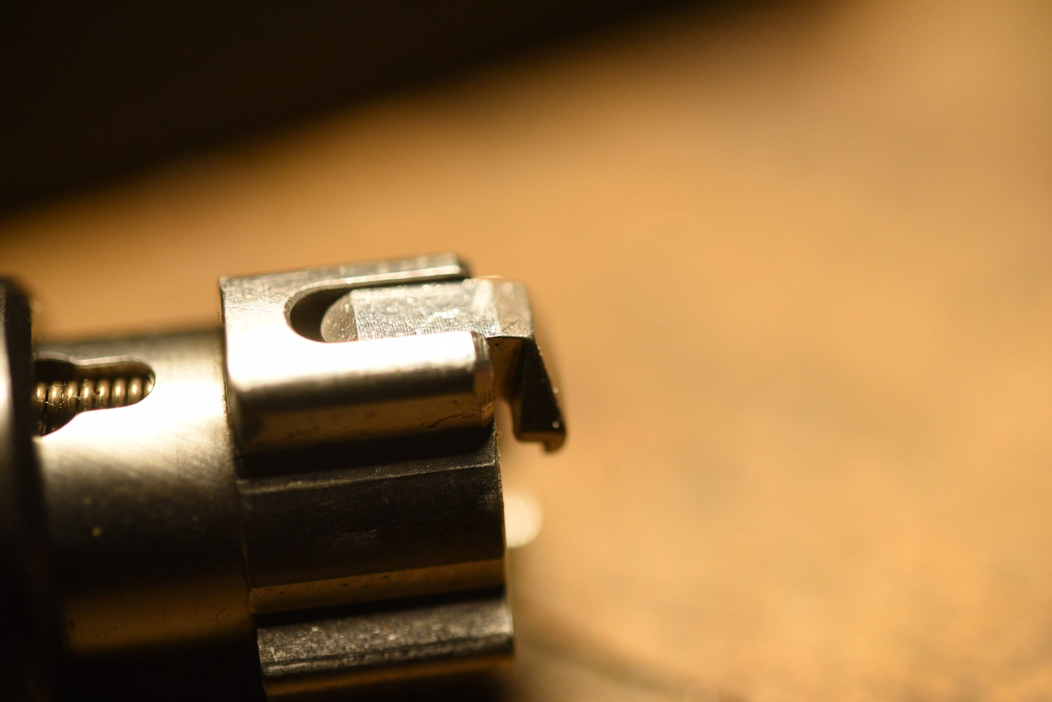

Yep check right here for the new extractor rubbing.
My original just touches & I haven't put the replacement in.
Read on here somewhere about the new replacement hitting the cone breach that was set up for the original extractor.
The ARC firing pins fit tight, so a little misalignment may well cause the pin to bind.

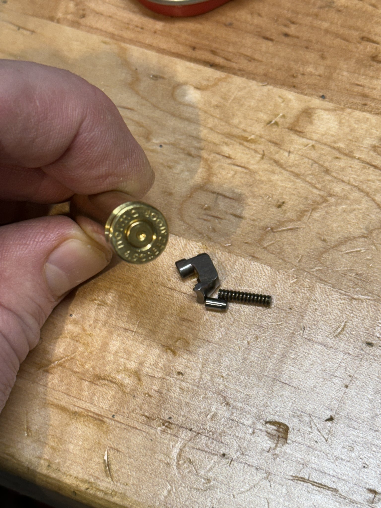

question:Is it possible to put the new pin for the pin/spring/extractor retrofit in backwards?
I note one side is beveled and the other is flat….
My recollection is that the flat side faces the spring and the tapered end goes toward the extractor.

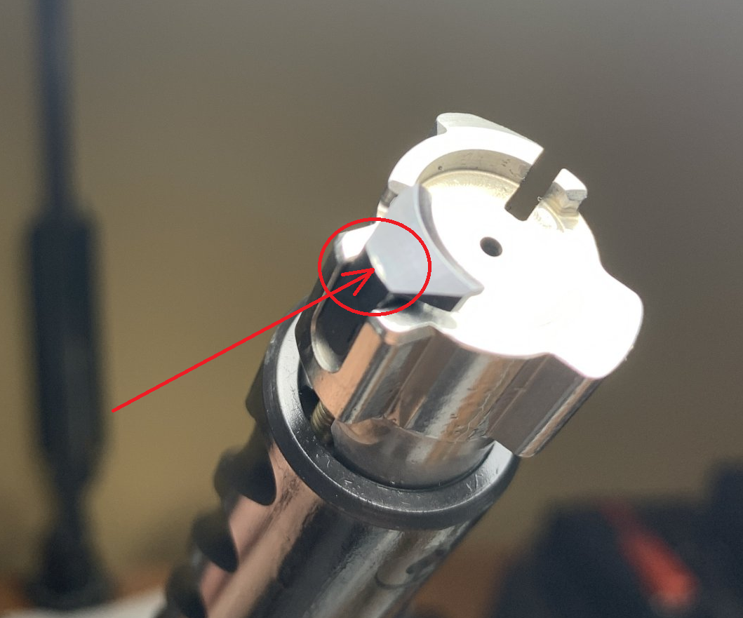

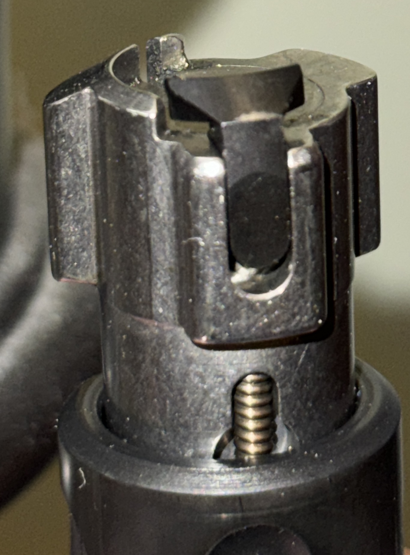

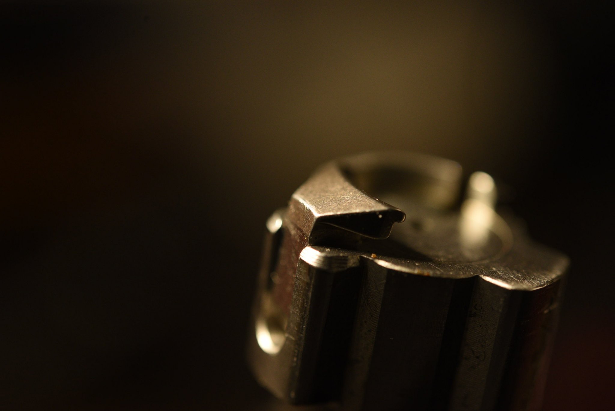

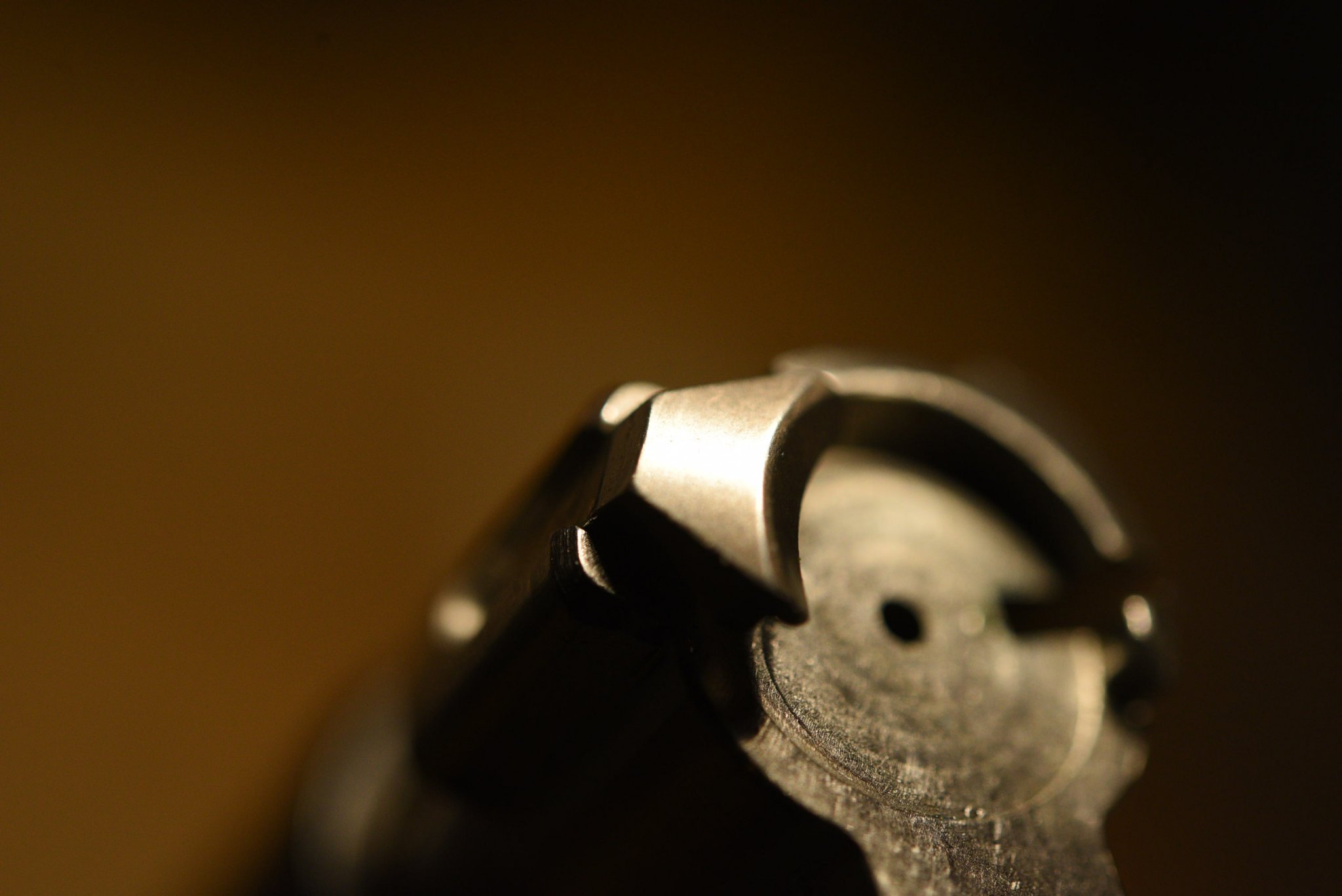

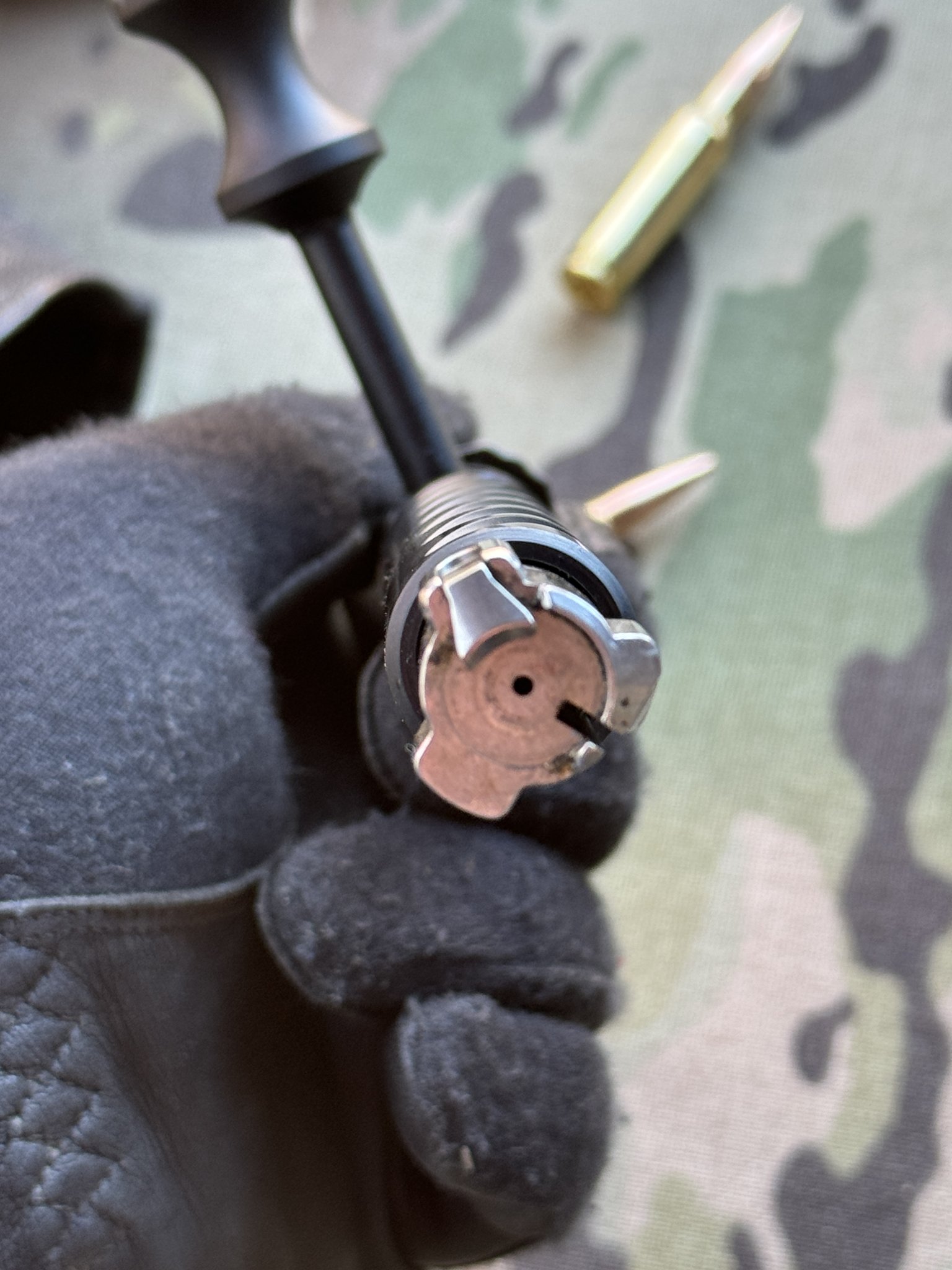

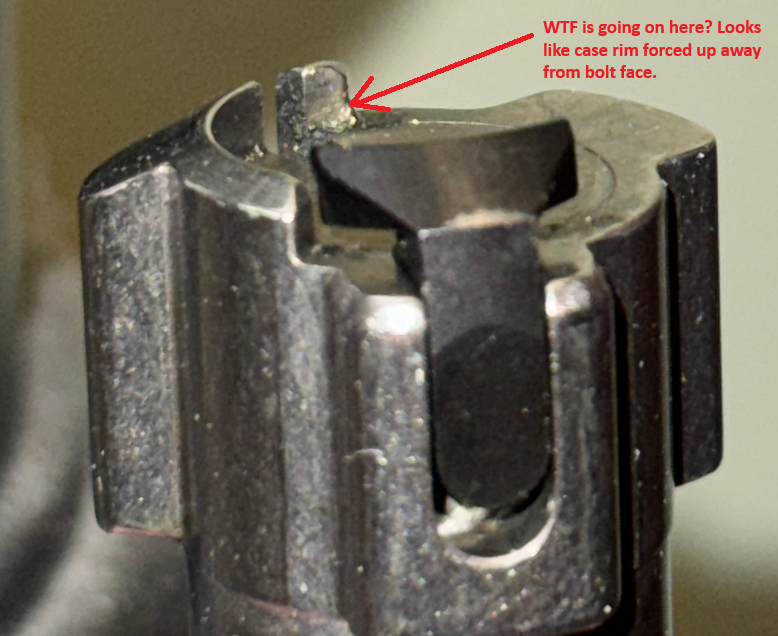

So I do have a little bit of rubbing going on according to my pictures…
The pictures don’t do it justice because it’s a very little bit when you’re looking at it with your eyeball… But the camera seems to make it look much larger than it is.
View attachment 8341268View attachment 8341269
For what it’s worth: PVA finished the barrel for me, and it’s one of their Osprey barrels.
Those pics of the old extractor...so its black...or is it the new one which is silver??? Hard to tell from the pics.
And, I'm not sure what it hitting a bit on would do to firing pin freedom of travel or headspace. Did you have resistance when closing the bolt with the new part? I ask because the in battery should be fully in battery...no?
Reactions: DubfromGA
If thats the only place its rubbing, 5 seconds to break the edge on the extractor with a file.
Dimensionally , the extractor should be the same with the exception being the notch for the dowel pin. And, as noted earlier in this thread, I think the extractor popped out with some people running magnum calibers.
I posted photos of the extractors earlier in this thread.

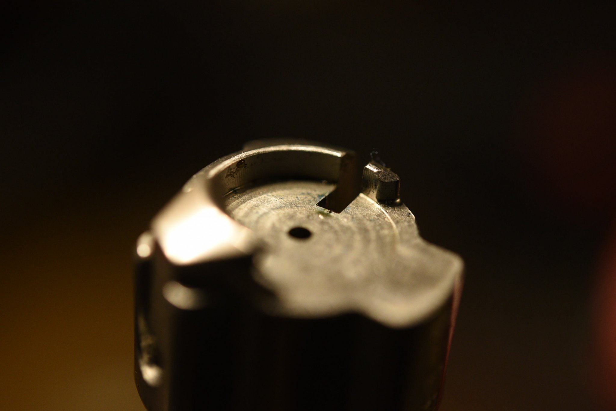

Mine is also a PVA Osprey.
From your Picture I now suspect the new extractor was forcing the case head over & up off the bolt face.
Edit: I see brass @ that location in your second pic.

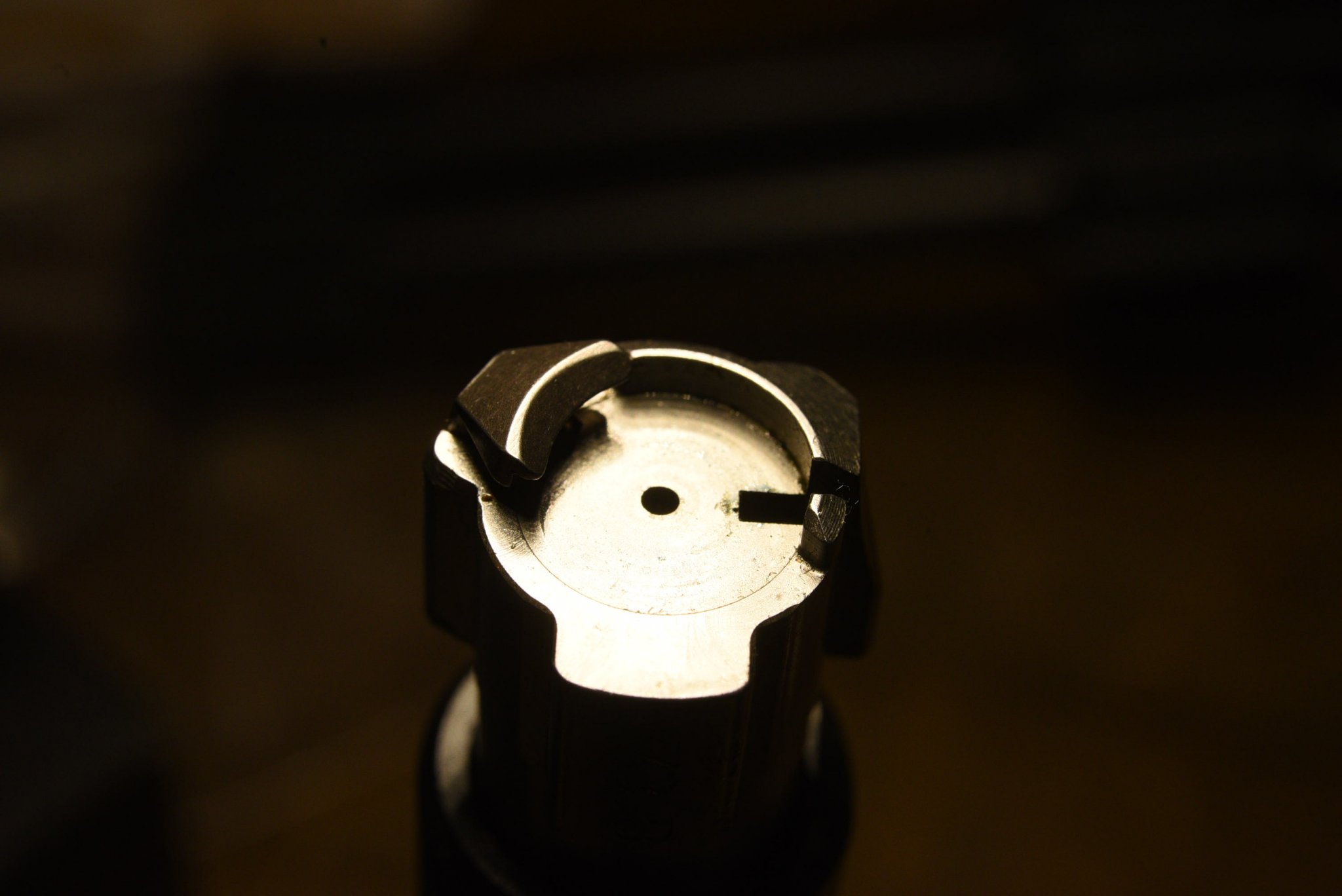

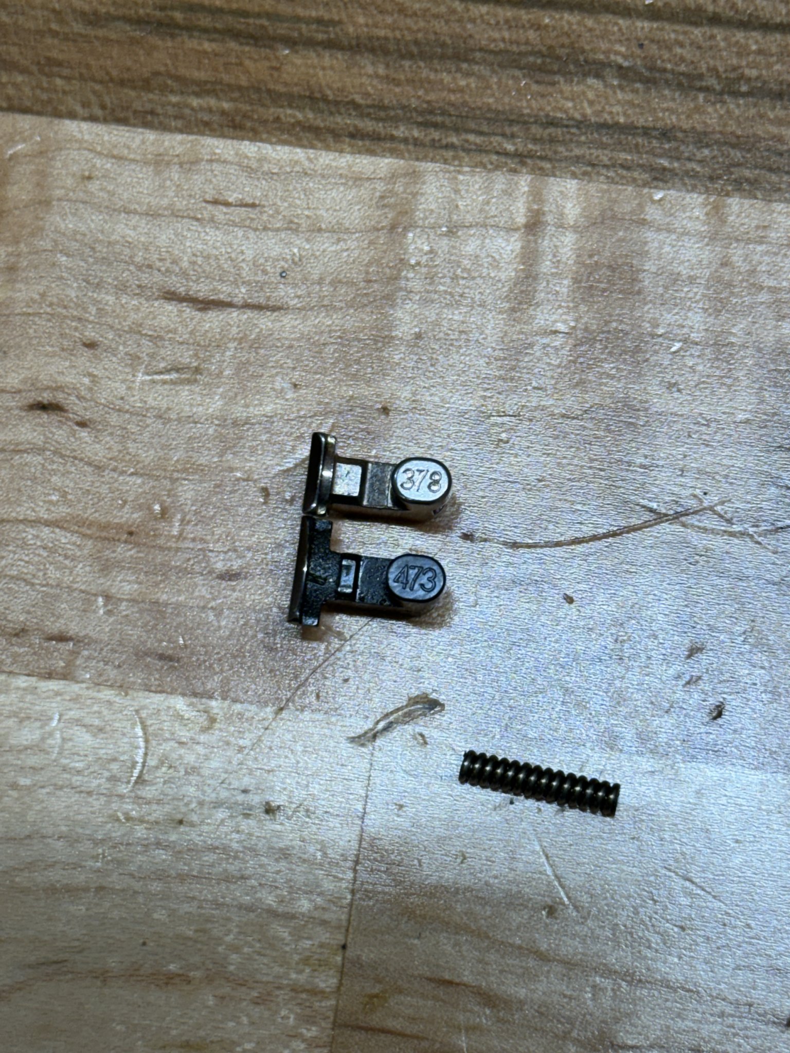

Interestingly, that bolt says 473B on it, and my other one is a 473.
There is a slight difference with how that piece of steel was machined between the two.
I have figured out what the problem is and the problem is is that one of the two extractor they sent me says 378 on it:
That would explain it!
Glad you figured it out.

Per e mail from ARC regarding the orientation of the pin behind the extractor. The tapered end of the pin should face the spring. As mentioned in post 6366.
ooops, wrong again. Its my super power.
All - here it is and I just got it backwards...it makes sense that tapered end would go into the spring.
