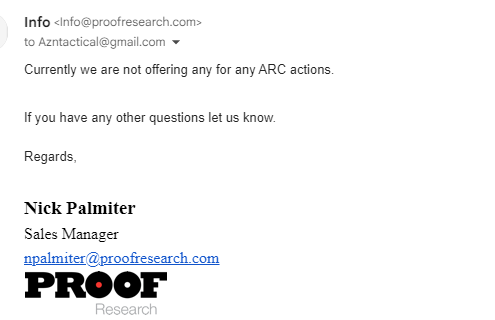

I reached out to Proof given the desire here and am happy to say, "We ... are working with ARC." The response appeared to reflect CDG only.
Proofs are (hopefully) on the table bois.
Might be old news but 1+ year later and Proof is a no bueno for prefits.

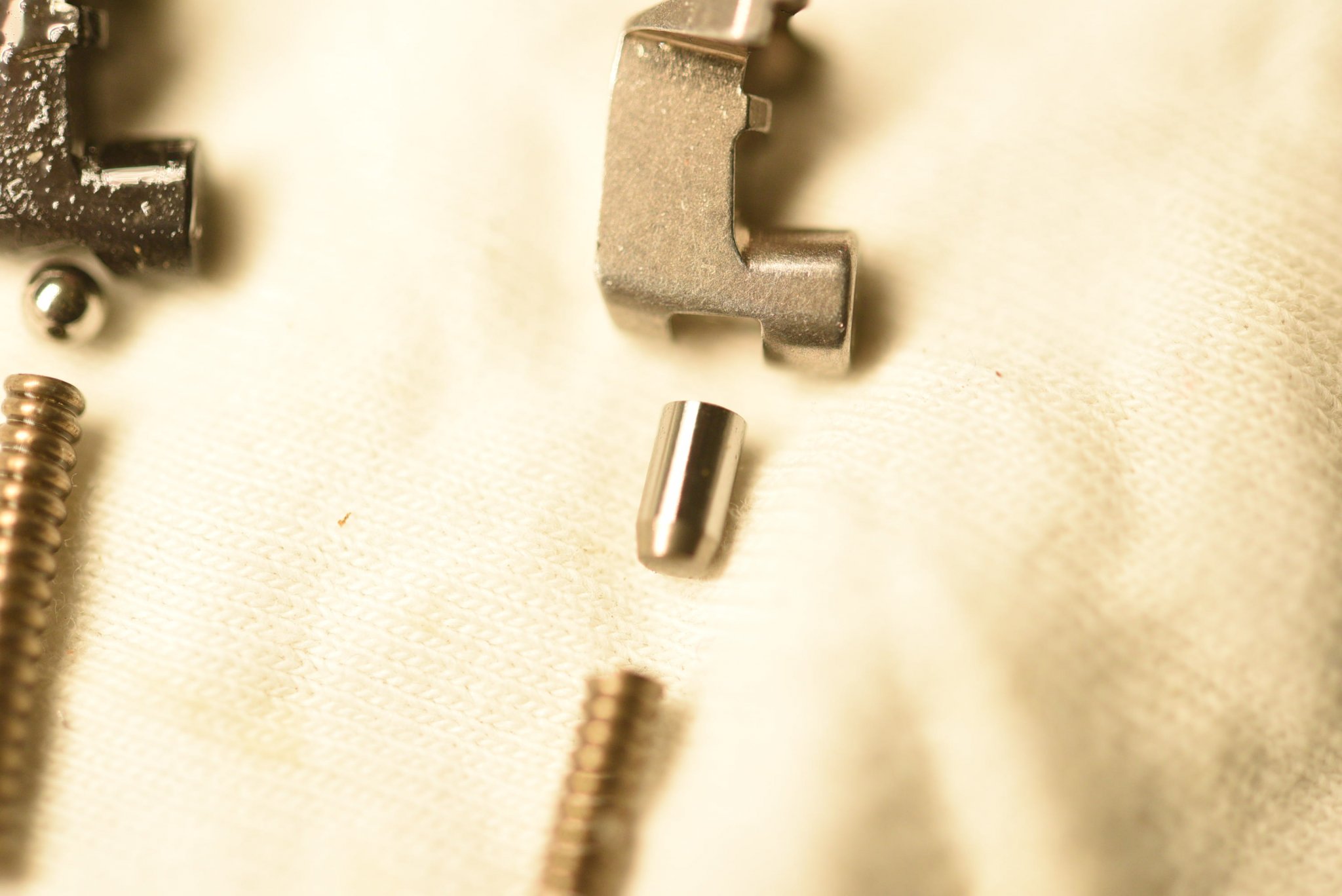

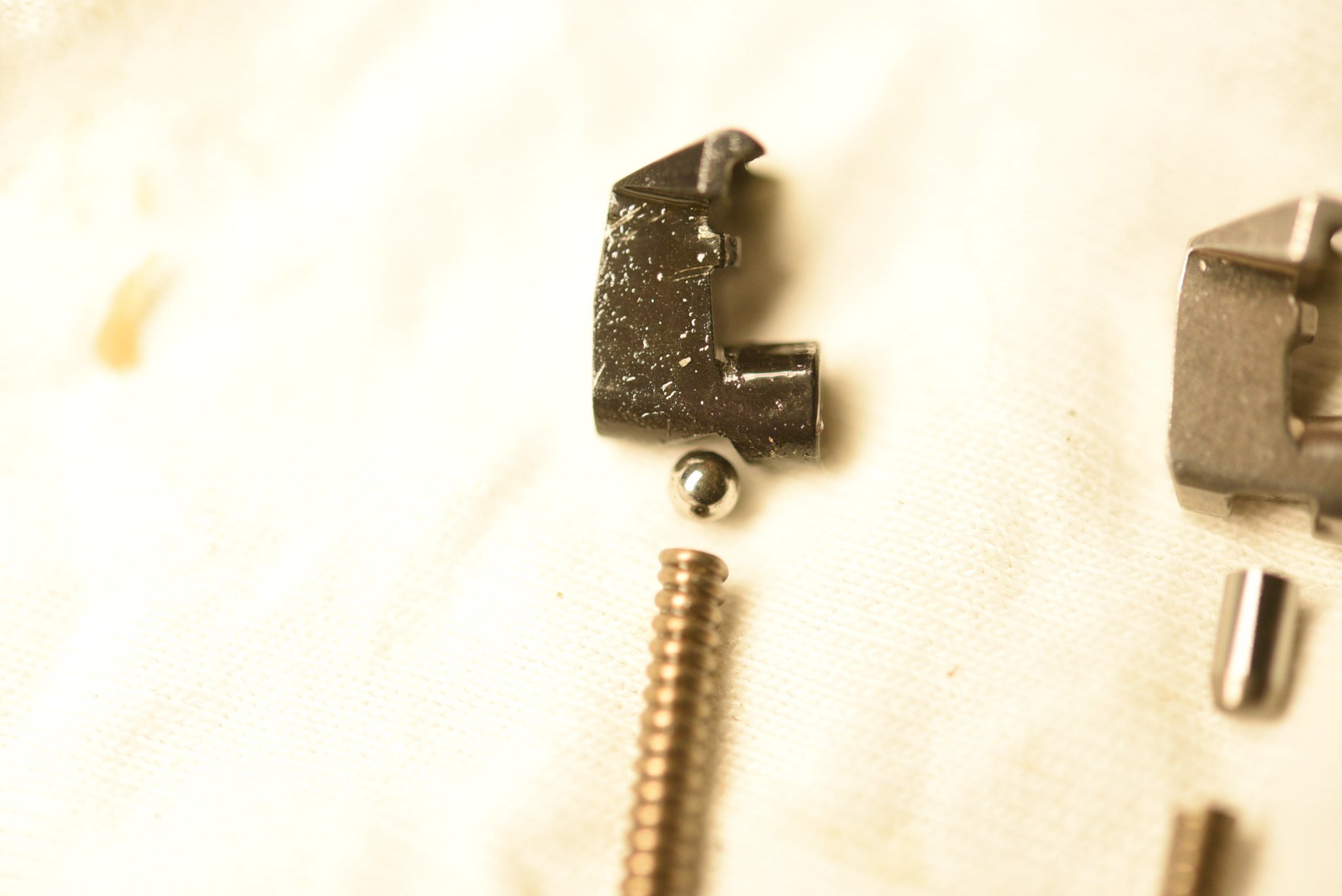

For those that are curious and like to look at pictures...if they aren't already posted in here. The original extractor is black with a ball and longer spring. The updated extractor is silver with a tapered pin ( may not be oriented correctly in the photo .....I didn't look at YT vid prior to taking photo ) and shorter spring.

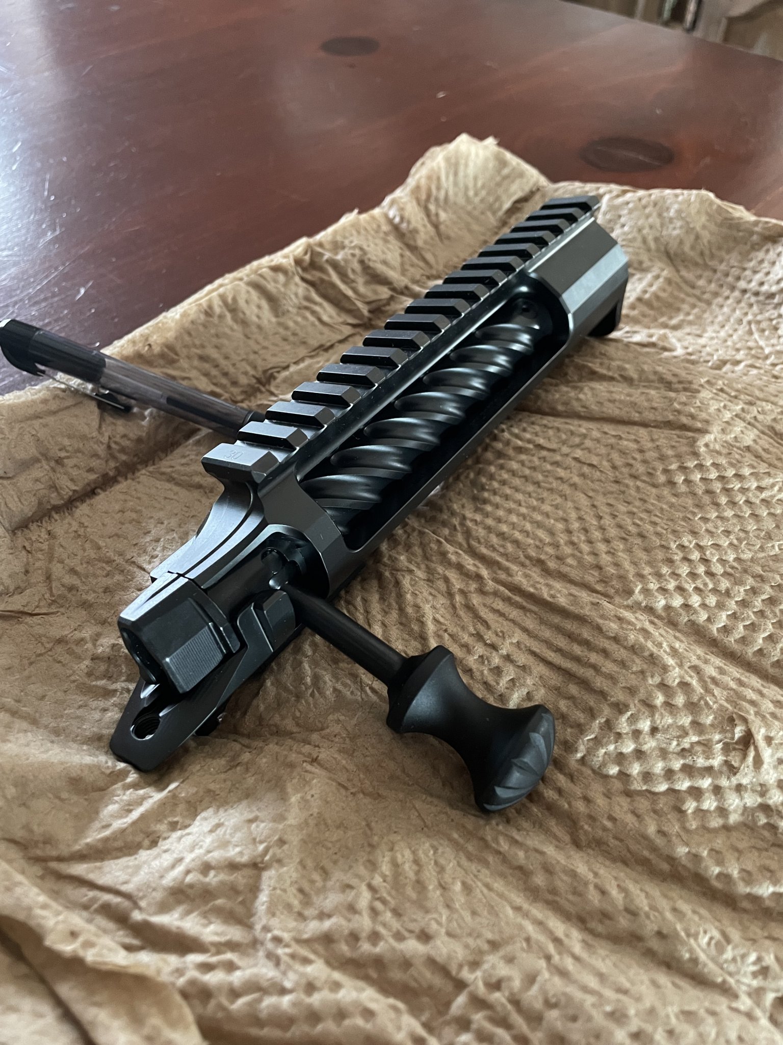

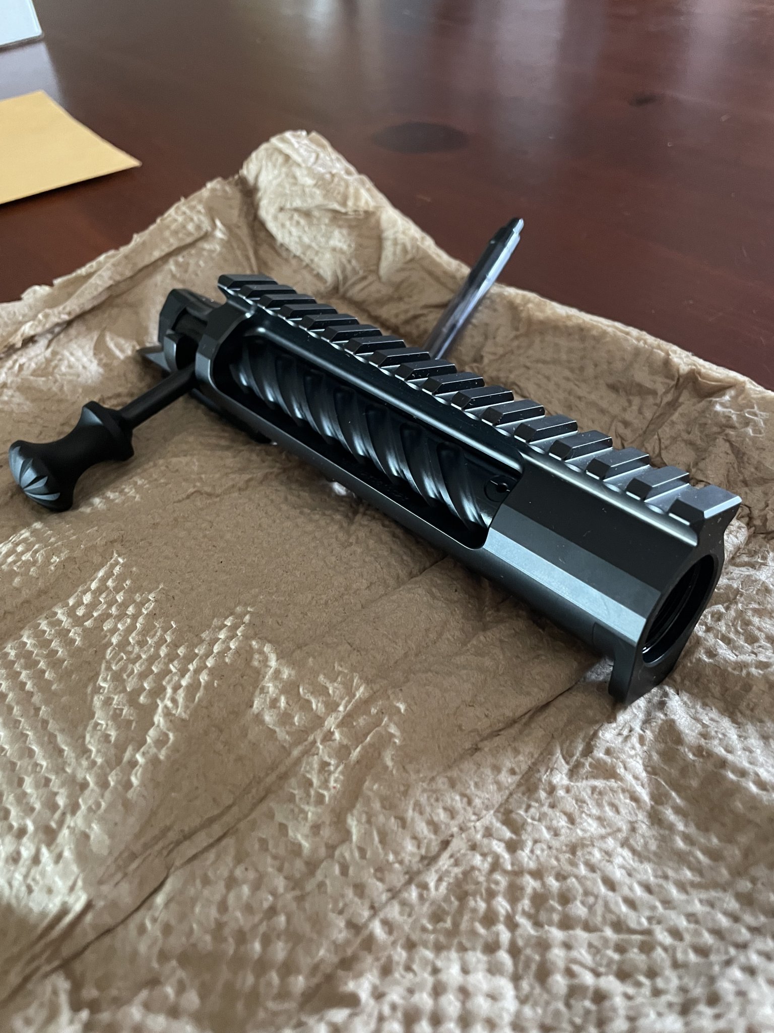

Picked up one of these for my first bolt action build. I was nervous about removing some metal and slightly modifying my existing chassis to make room for the trigger hanger. It was completely unnecessary, took maybe three minutes with the dremel and 1 $2.89 screw from the hardware store.

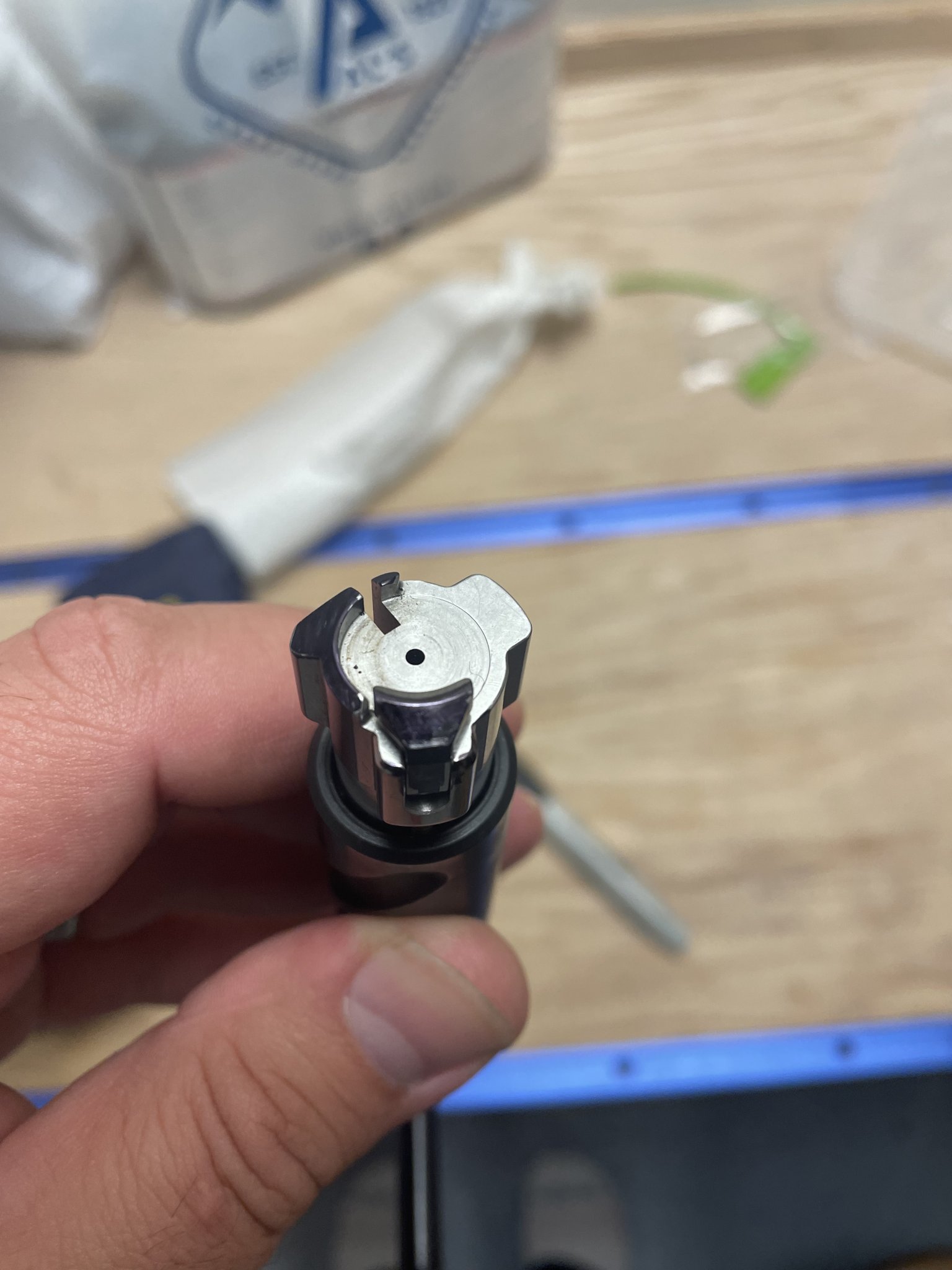

My love for this action has wained ever so slightly. I haven’t had to tinker this much with a custom action before. It’s not terrible I know but it’s getting ever so slightly annoying. First the trigger hanger, then I had to remove material from mdt’s shortest mag latch as well as my mpa adjustable mag latch, and now I’ve had to modify the new extractor because it interfered with the conical breach.
Yes they are all minor, it’s taken me about 2 hrs total for the mods, but it’s gotten to the annoying side of things. I really hope that’s the end of it and I forget about it once I get shooting it some more.

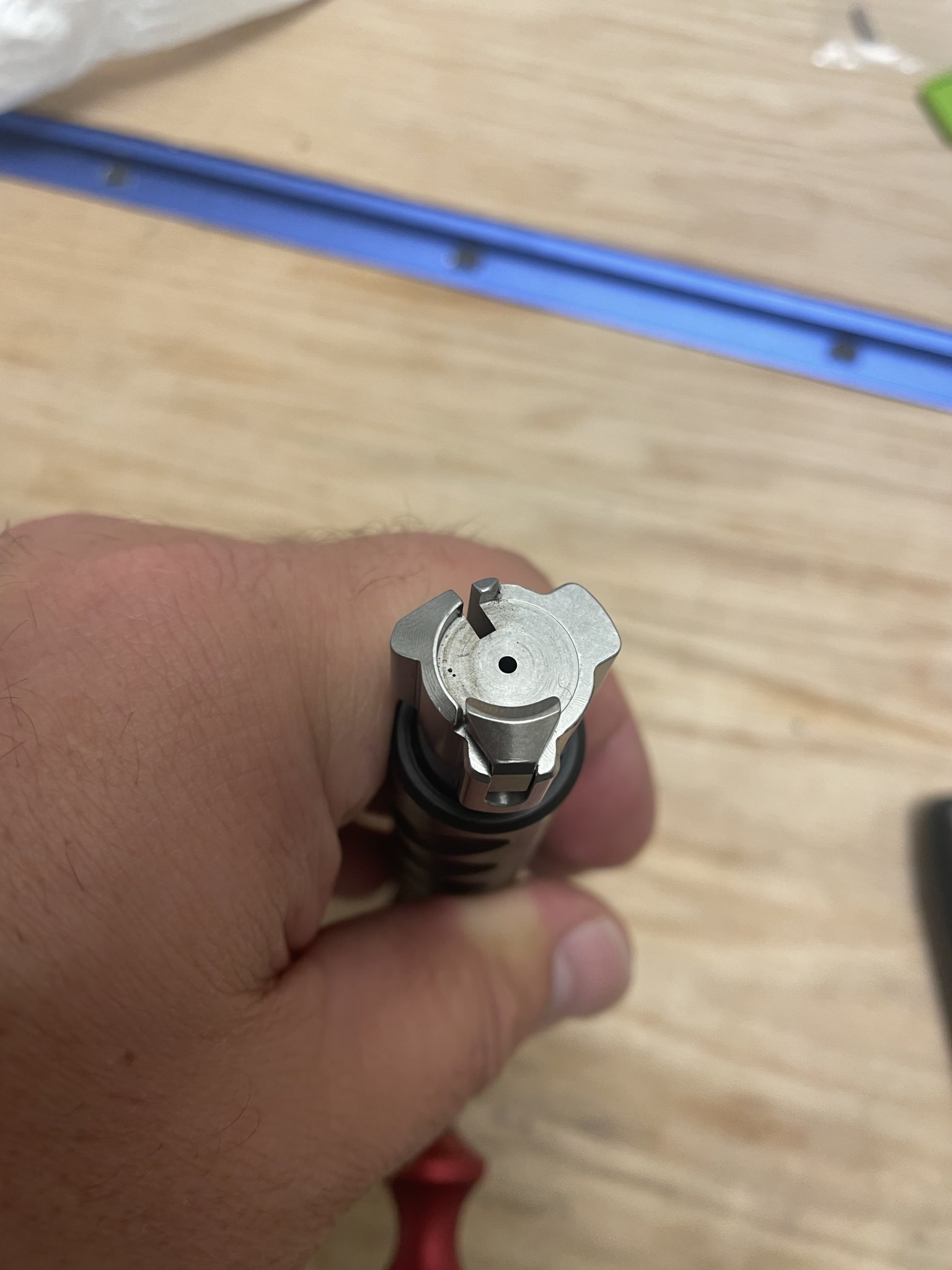

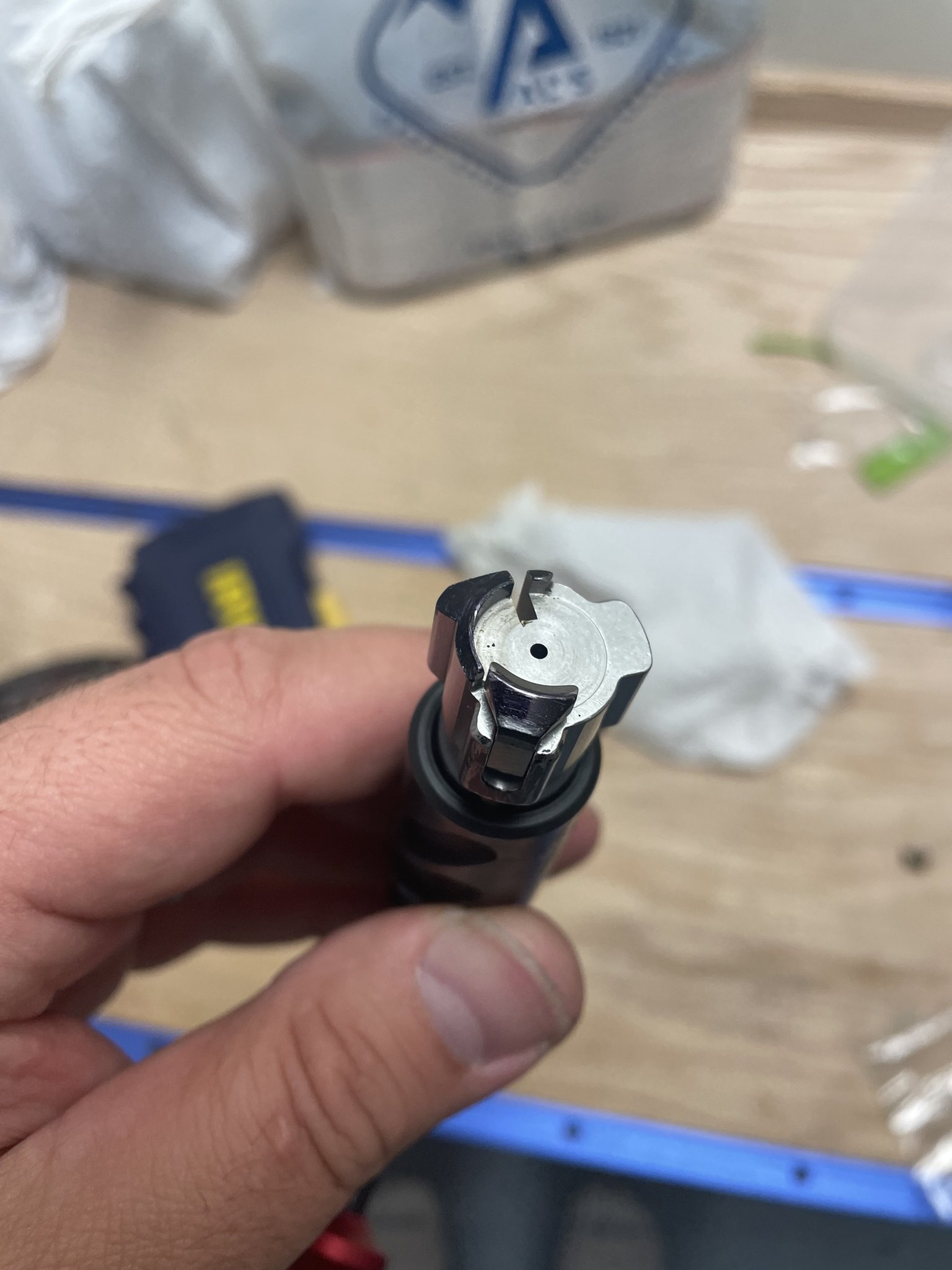

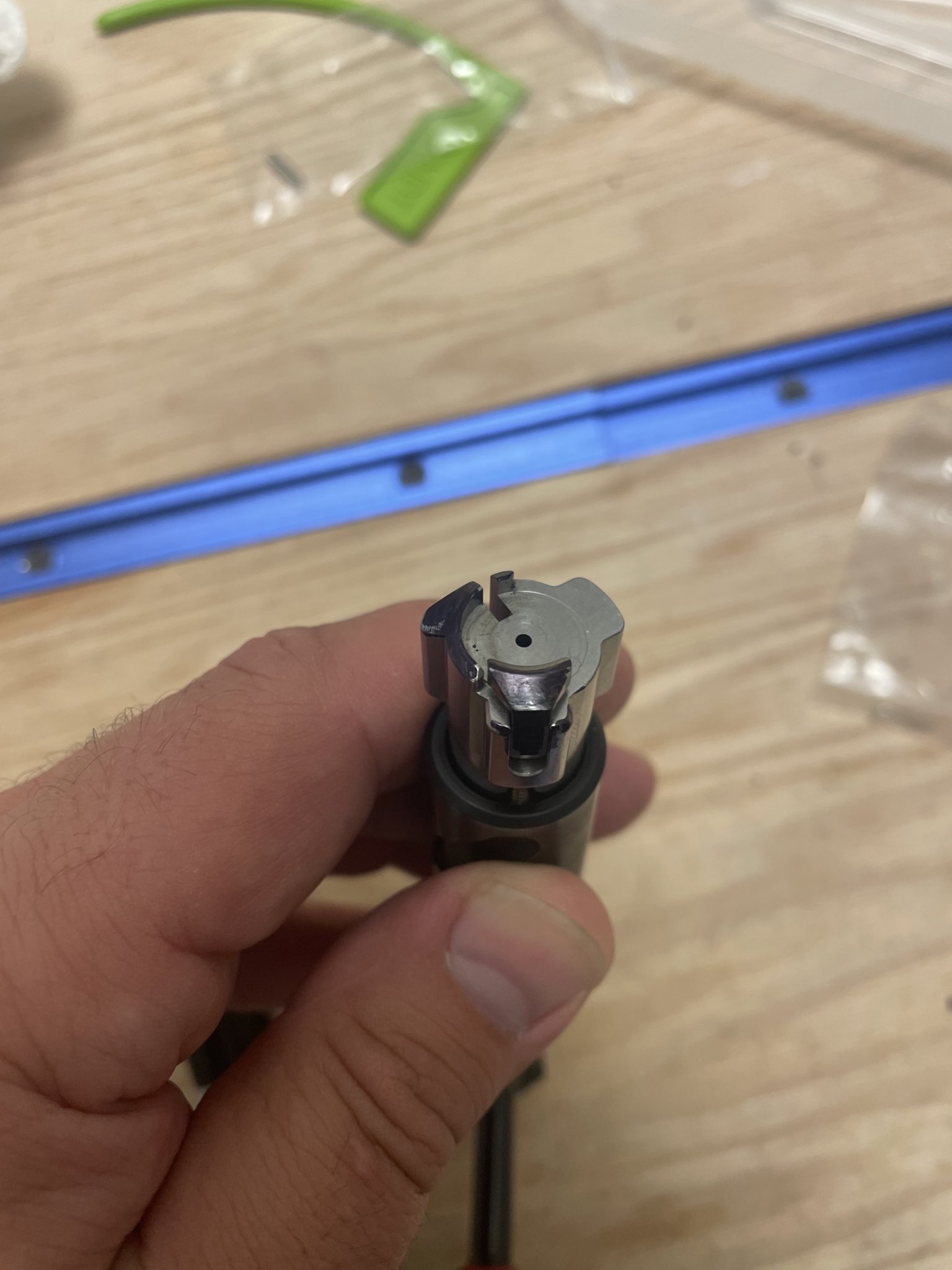

Here’s some pics of me fixing the extractor, it took a lot more removal than I expected.
Some sharpie, a file, and some buffing got it back to running smooth though!
There didn’t seem to be as much of a radius at the corner, and the whole ejector wasn’t as much radius as the original. As I removed the corner, more and more started contacting.

A little more info please, Was this a barreled action? From where? Was this a Prefit barrel? From where? What trigger did you have to remove material from the hanger with?
It was a barrel put on by a very competent and well known gunsmith. He used a tool to make the conical breach as opposed to a cutter and compound angles I guess? Suppose to be better and more precise. Not a machinist so don’t know how this is accomplished. There was zero issue with the original extractor, the new one has a geometry that is slightly different. You can see it just looking real close. I have one of the earlier models so the trigger hangar hadn’t been revised yet so with a timney trigger it requires some removal.
Gotcha, I did not realize that you changed the extractor AFTER your barrel was chambered and installed.

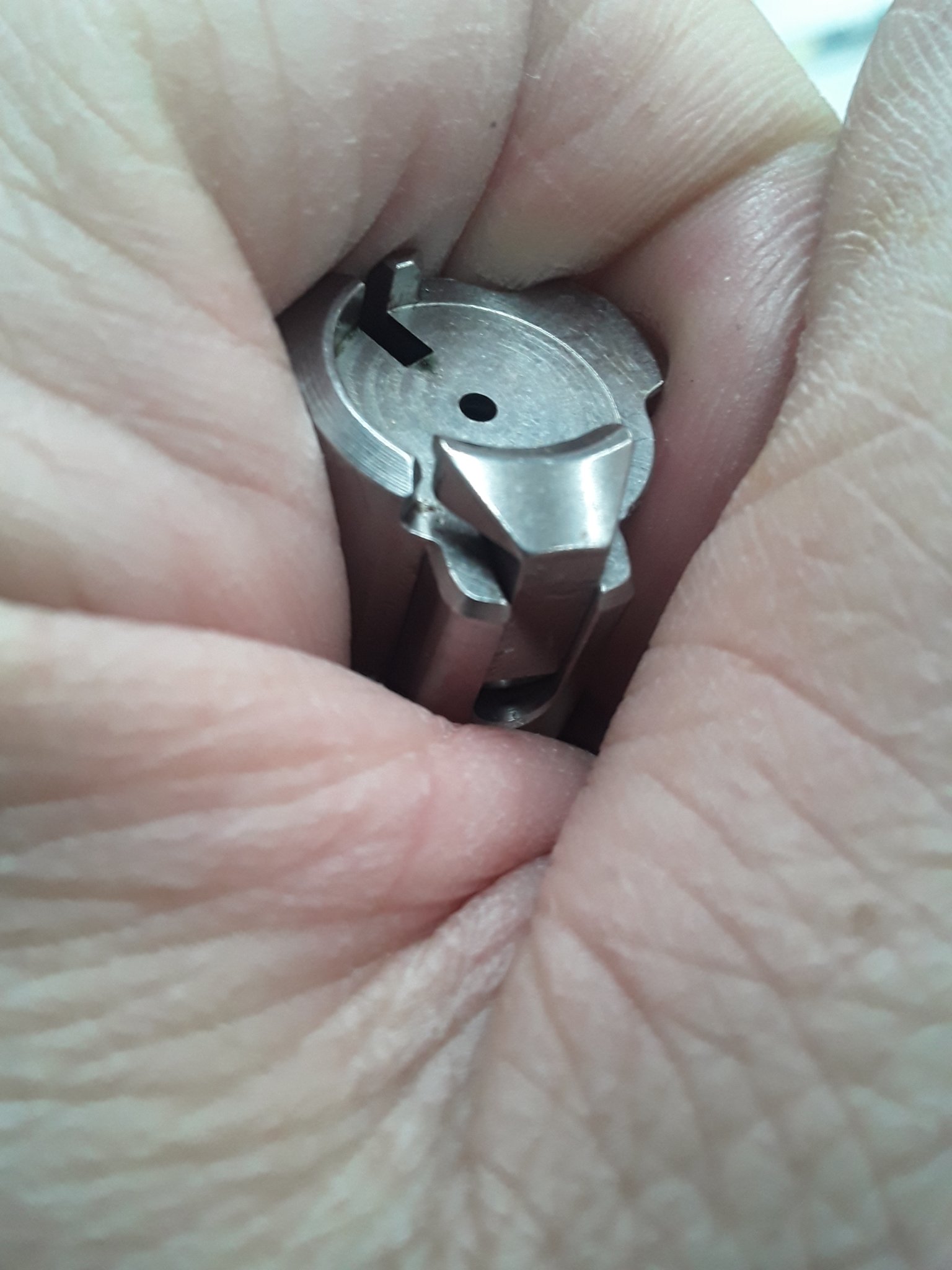

I had to reassure myself that i wasnt wrong. Grabbed the bolt today and yes, no issues with clearance. And some really bad photos of the lug. Its not flat .

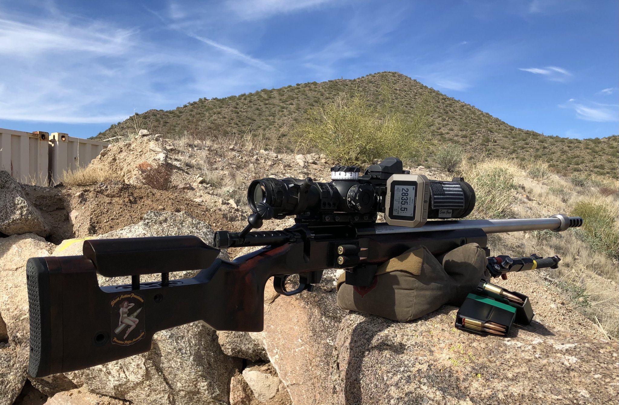

Anybody build a 6BR with one of these yet. Curious how it runs with the AW mags and had kit?
Considering doing the CDG in a foundation stock in 6BR.
I spun a PVA 6BR on a couple of weeks ago. Sitting at 247 rounds on it now. Not one issue running AW’s or MTD BR AICS’s. (MDT’s require a little mod)
