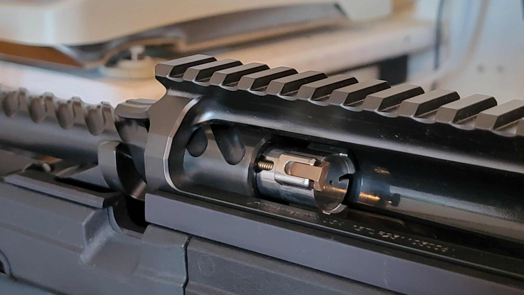

For all of you who have the CDG action, how has it been and how does it compare to other actions from other companies? Is it worth the money to go with an aftermarket action or with a Tikka T3x action for my rifle build?
I have a tikka, origin, lone peak, and CDG. I’ve posted a few videos on YouTube, but with only 50 rds on the action here’s my quick take.
It’s not quite to the level of my lone peak but it is very close! I prefer it over the origin and the tikka, but here’s my negatives, and they are absolutely not deal breakers! I’ve had to modify both my mdt acc latch and my MPA ultralight latch even with the adjustable latch. Not a huge deal, just slightly annoying.. This is with AICS MAGS, and Ted says as much, but it’s still just a little annoying. Luckily the mpa latch still has enough adjustment it works with other actions but the acc I have to swap latches back and forth if I want to use another action.(I’ve ordered aw mags 3 times now and they all get cancelled cuz “out of stock”) at a local match, another person running the CDG had maybe 1 piece of brass per stage go forward of the the line, and with the skiff of snow it was harder than other actions to locate brass, but I have that issue with my origin as well. My particular action seems to throw at the 3 o clock no matter how hard I run it. YMMV.
All in all, of the three you mentioned I would personally pick the CDG every time. The origin is my second choice and tikka is close behind. At this point it really is ford vs Chevy vs dodge though as they are all similar price and fit/function.
That’s the only negatives I’ve found, and they’re debatable as to whether they are actual negative or not, other than that this CDG is amazing in my book!
I ordered the lightweight as soon as I got the email I like it so much. The features are cool, the action is well made and smooth, it just depends on what you are looking for really.
Hopefully that helps, just go buy one and don’t look back!

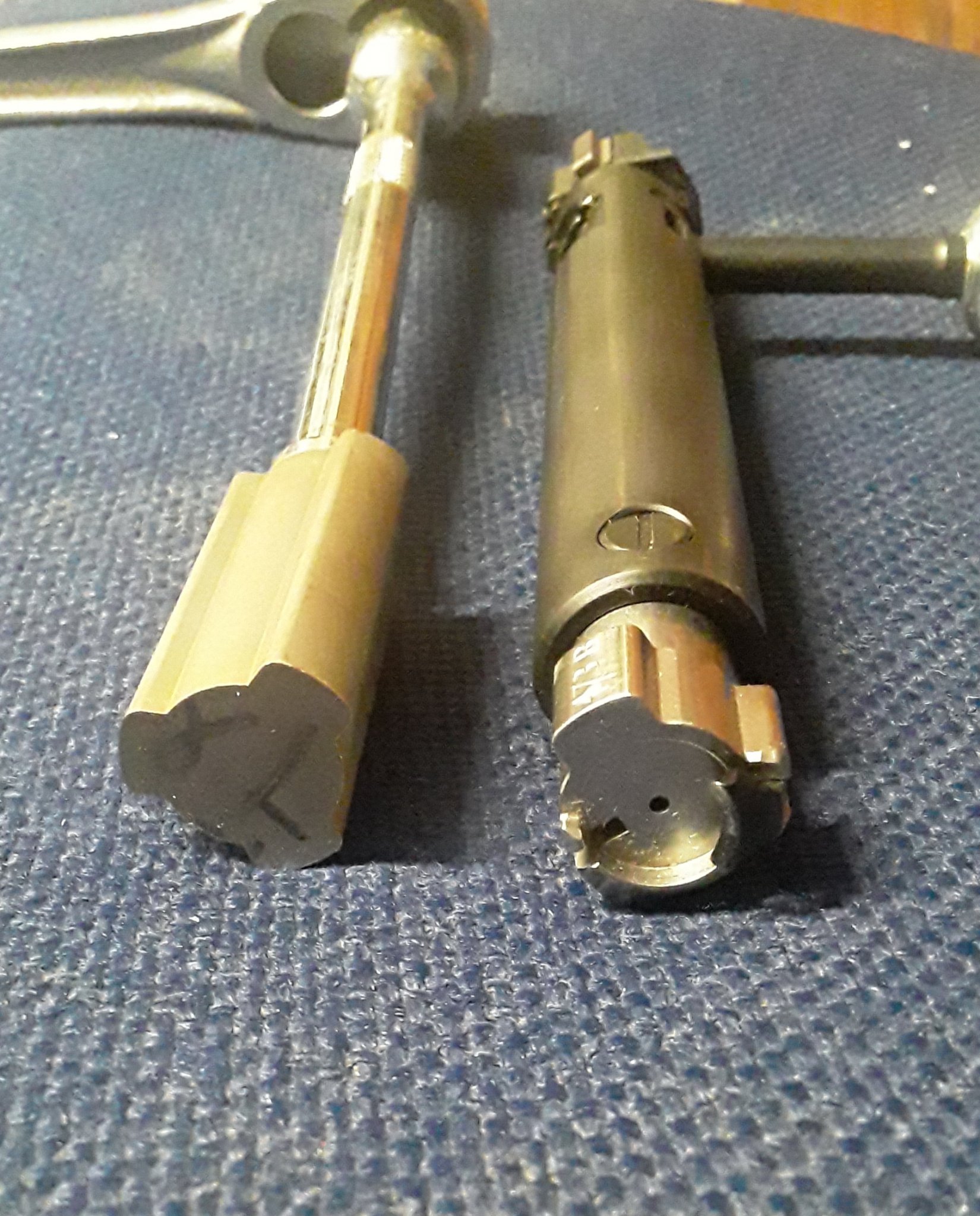

What are your tricks to get the bolt back in?! It always is a hassle for me!
Here is my struggle lol I’ve found having the action in a horizontal orientation (as if it were in a rifle level and normal) helps, make sure the ejector is positioned in so the back doesn’t get caught on the bolt face. Then jiggly wiggly
Good luck!

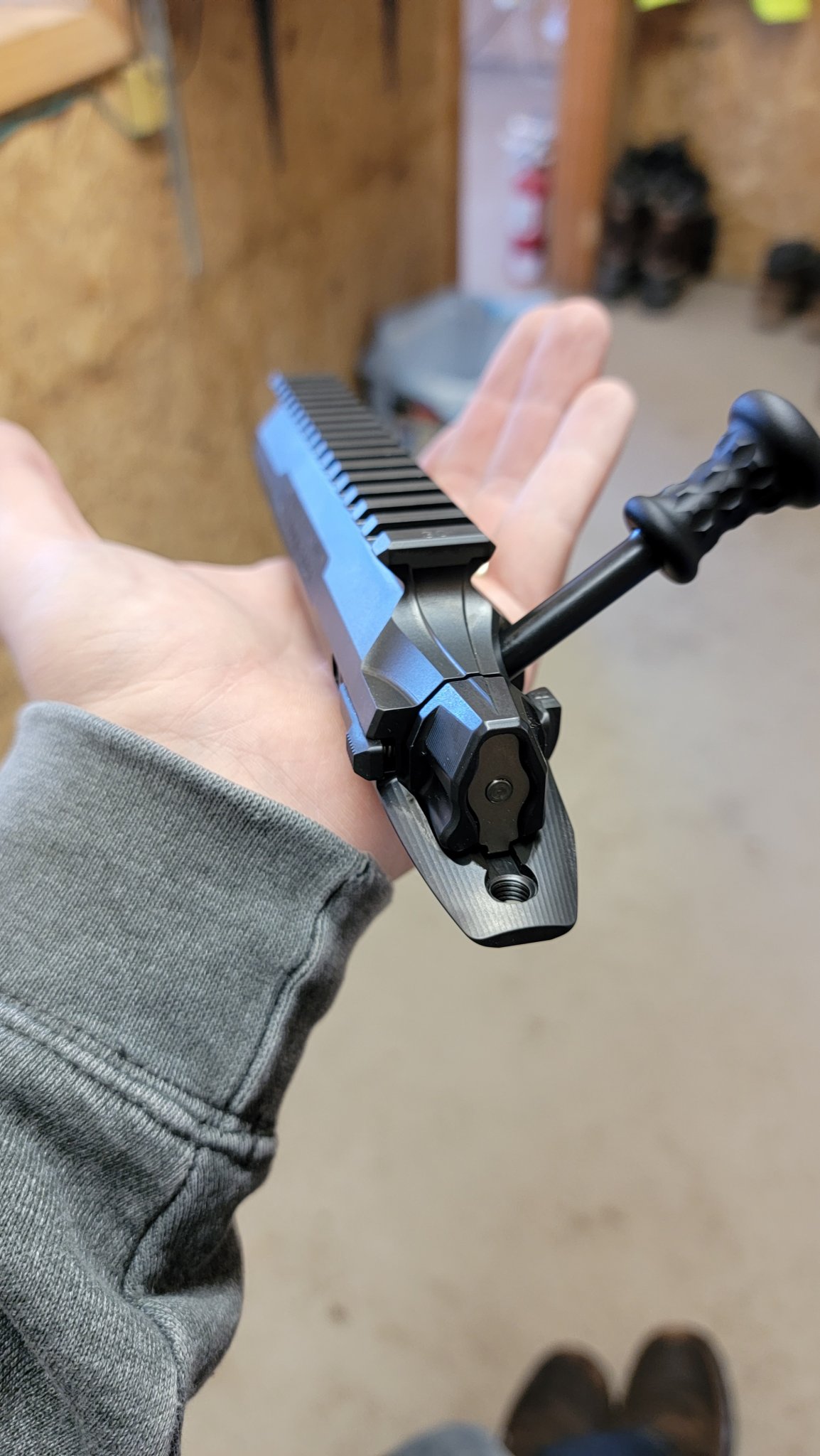

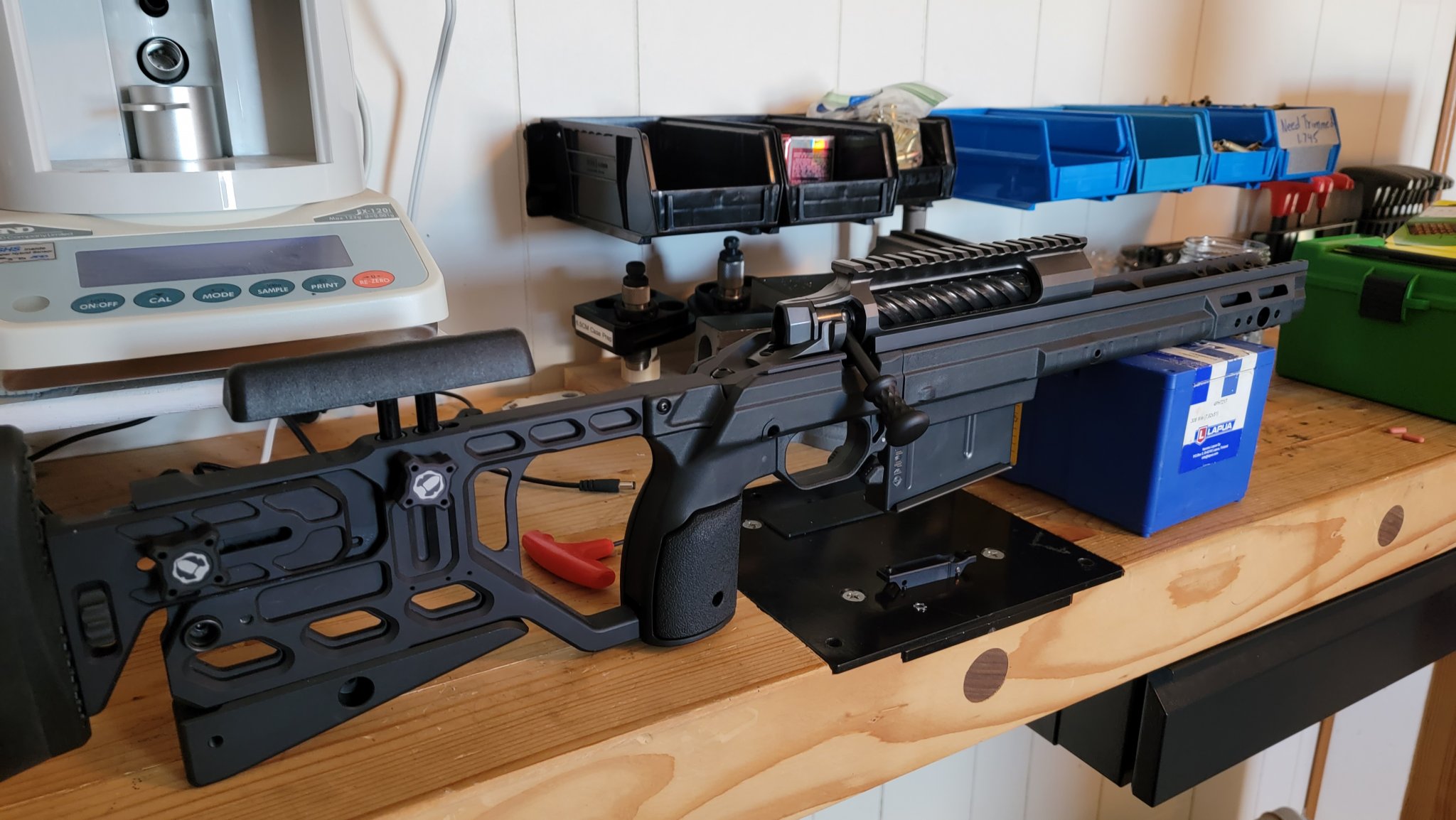

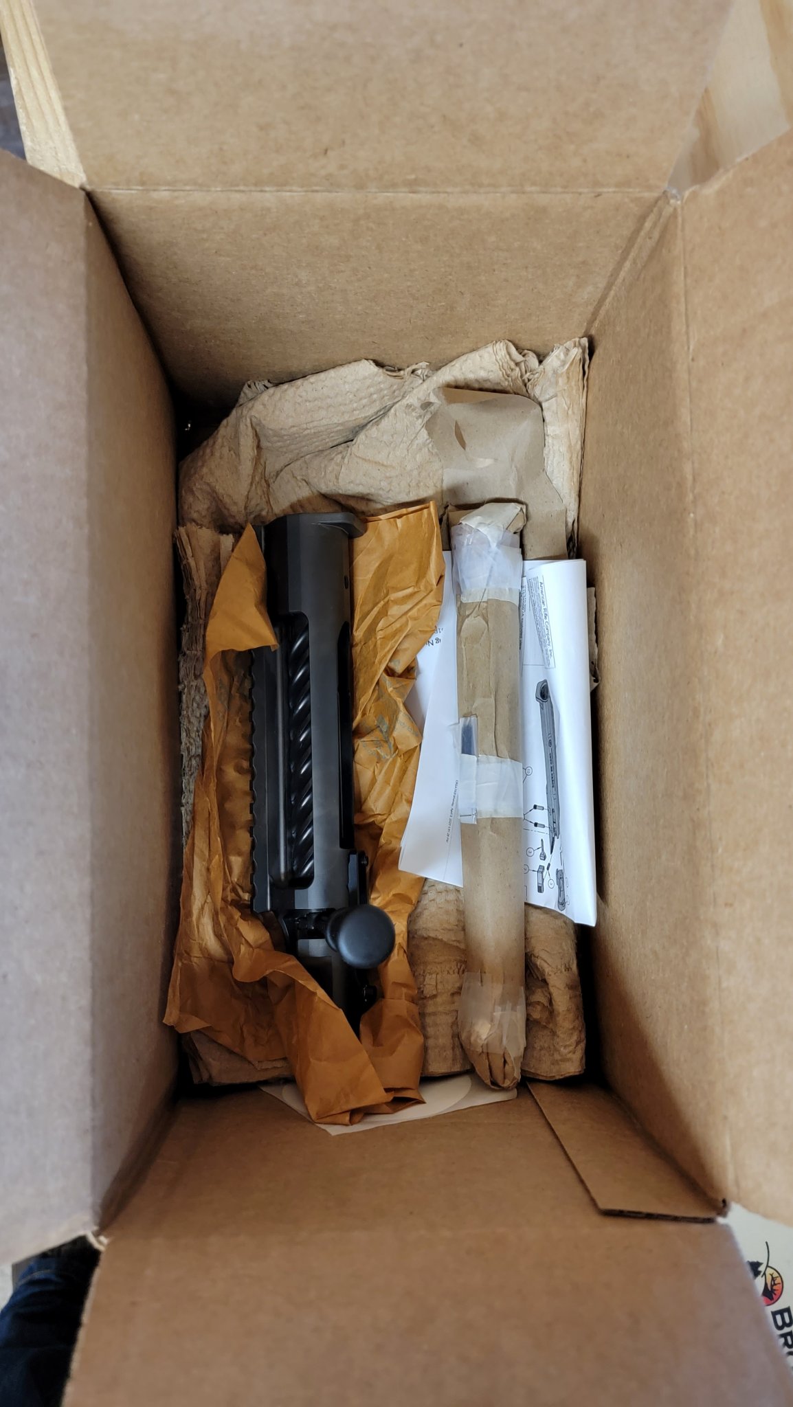

I've got good news and bad news.
The action looks great in the W3!
The actions doesn't fit the W3 lol.
I'll have to do some digging to find what others have done but if I have to change chassis it won't be the end of the world.
Functionally the action seems awesome. I don't love the exposed extractor spring but we'll see how that does long term. I don't even know what could happen if dirt got in there.
There are machining marks all over this thing, is that a problem? Meh. Not to me but it helps explain where cost savings are.
The finish also doesn't seem completely even but I'm not sure if that's just needing oil on some parts. Regardless I'm planning on having it cerakoted with Accuracy International 'Salted Carmel'. (Im not actually sure what that color is called so I just made it up)
The action feels a lot like a seekins action, at least the ones I've messed with. Doesn't seem to have a ton of slop, even all the way open.
For a 3 lug, the CDG seems to be super smooth even without a trigger.
This is just my "Hot Take" so take it for what it is...
...Now you guys can roast me...
ETA: Found this post
Post in thread 'ARC Coup de Grace Builds' https://www.snipershide.com/shooting/threads/arc-coup-de-grace-builds.7173019/post-10930733
Also, tried taking the bolt out and yeah it sucks to get back in.

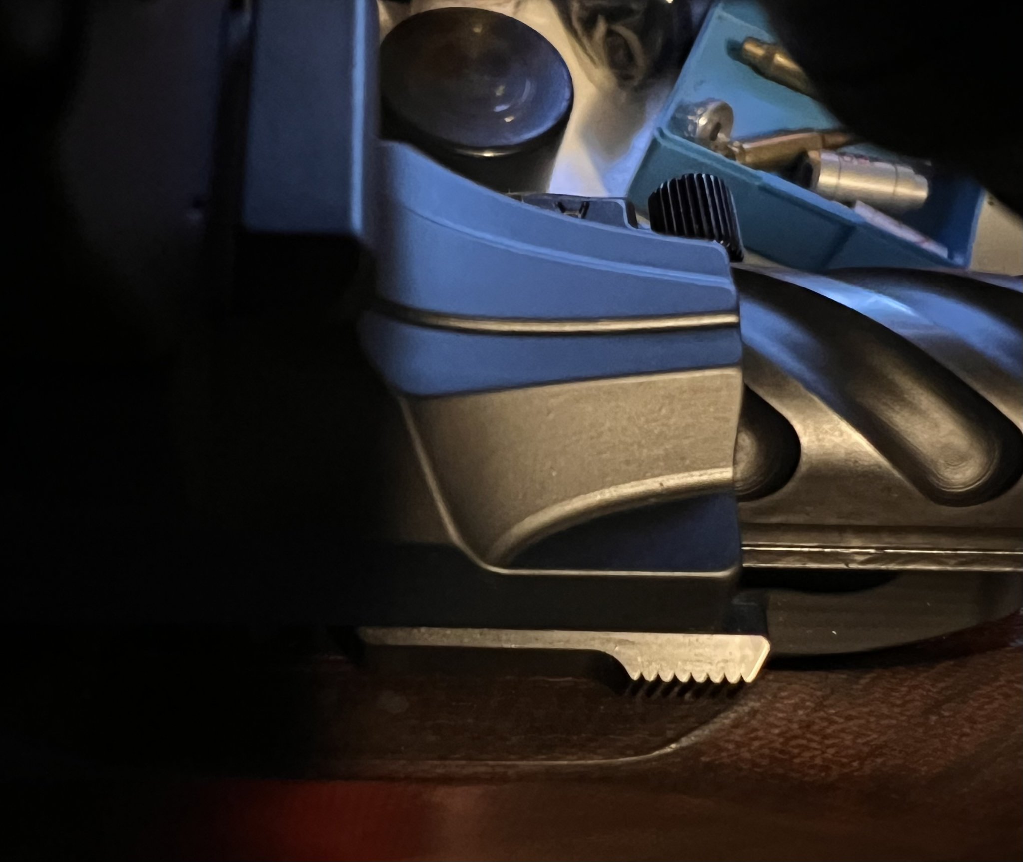

It seems some came out with marks and most did not. Mine for example doesn’t have any marks that I can find and the finish is very nice.

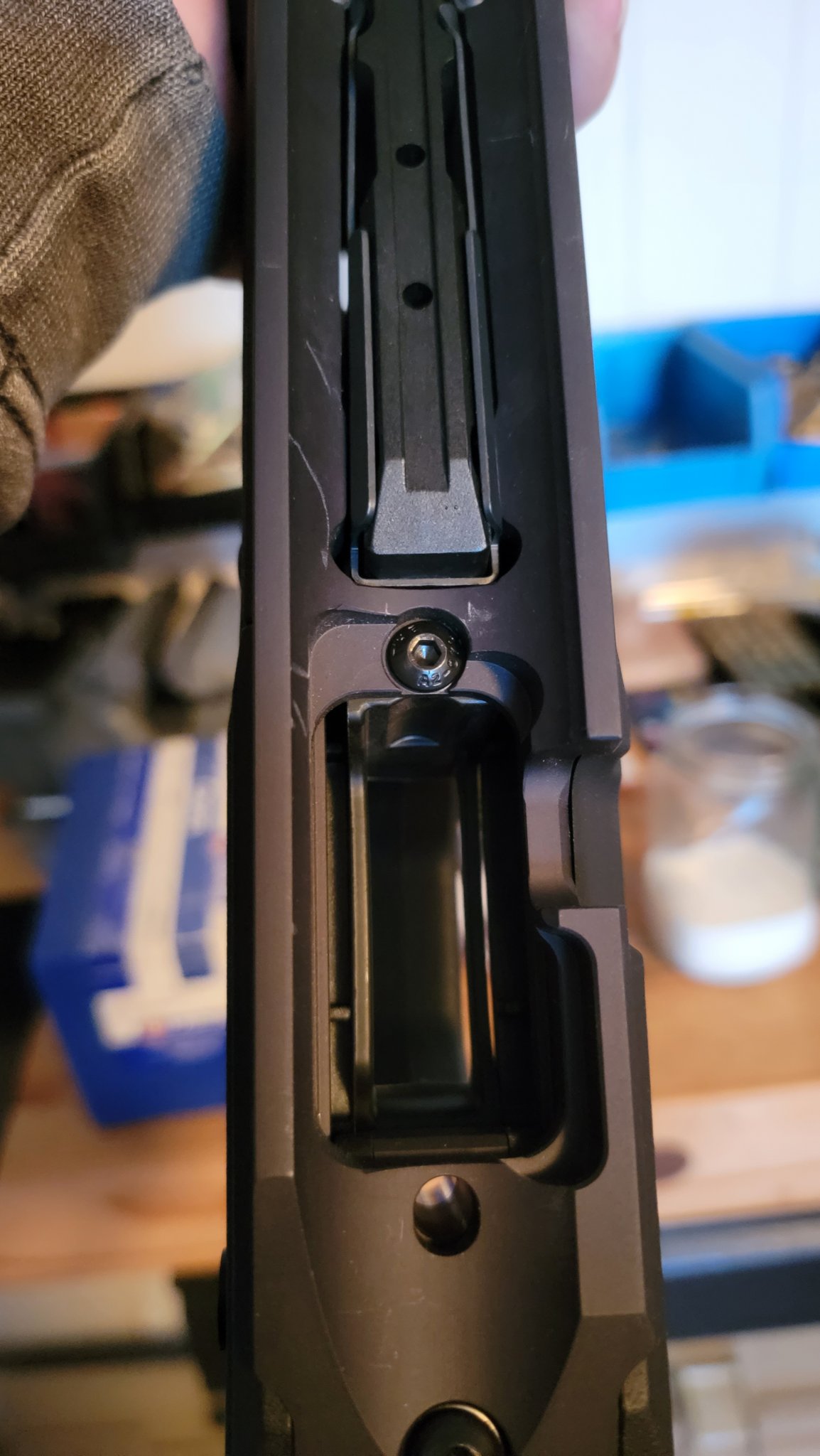

@Jackomason - What is causing interference to the W3, trigger hanger?? Shouldn't be to hard to fix that.
Forward of the trigger there's a screw. I edited my post to add a link on how to fix it.. not too bad and should even give me some practice on the mill.

It looks like your tang has similar marks, the rest of my action is covered in machining marks. it's not going to ruffle my feathers but I know some people would care more about that.

I had to do that with a bravo. 7 axis dremel to remove some material ( the high stuff to the right of the screw head) and replace screw with a flat head and countersink the hole a bit to accommodate the flat head screw.. After adjusting the hanger I had to remove some from the back of the mag well as well.
The lower material is the right hight though, right?
