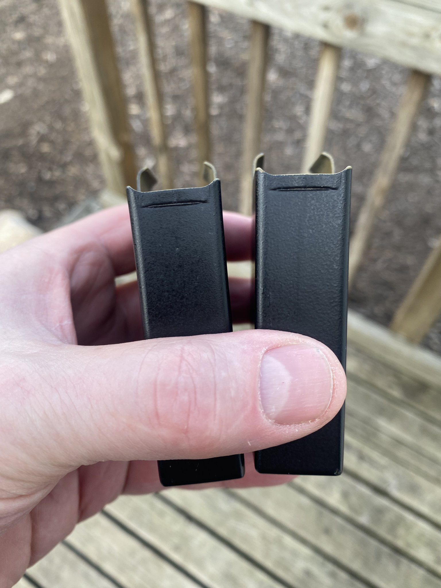

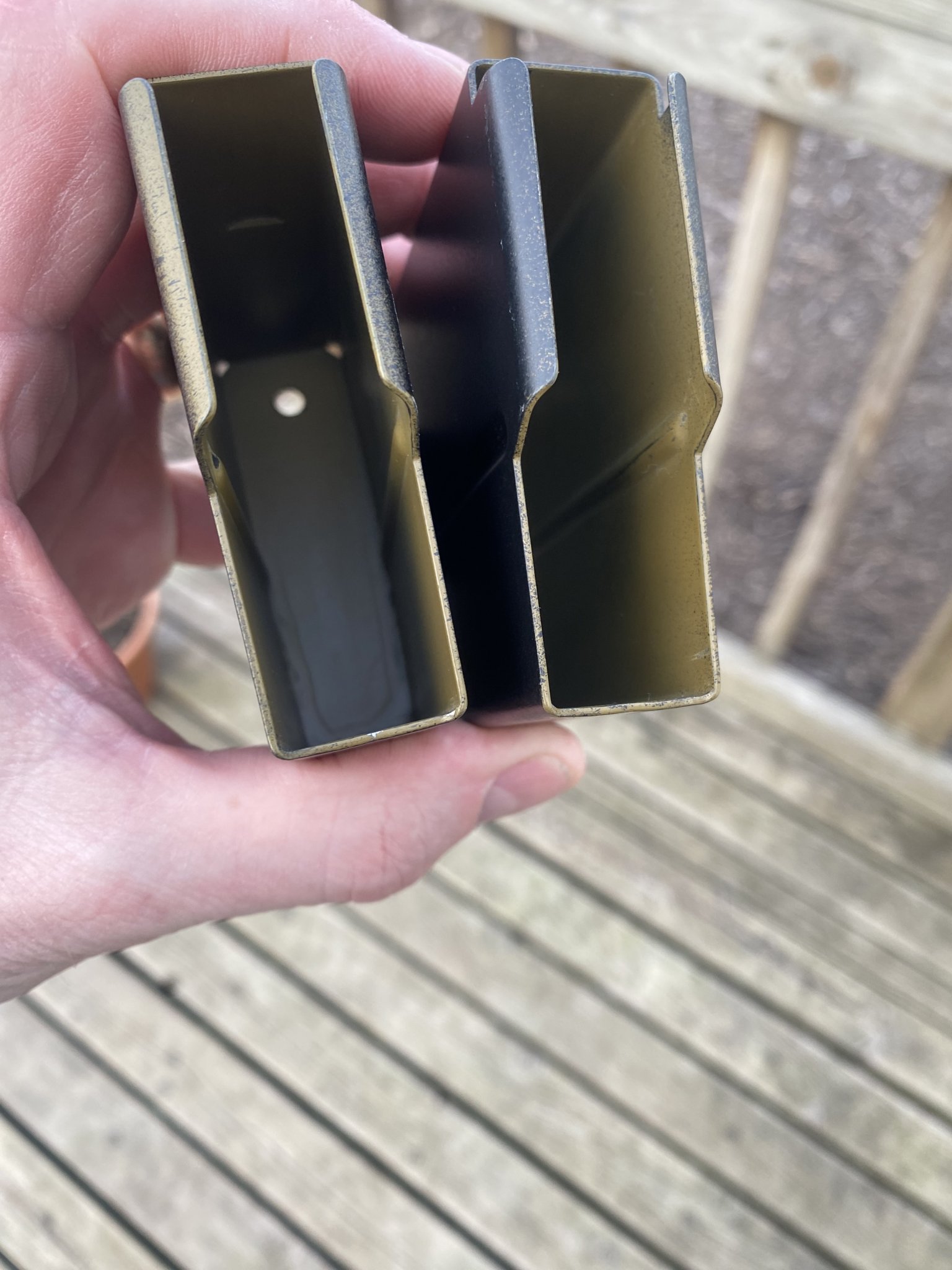

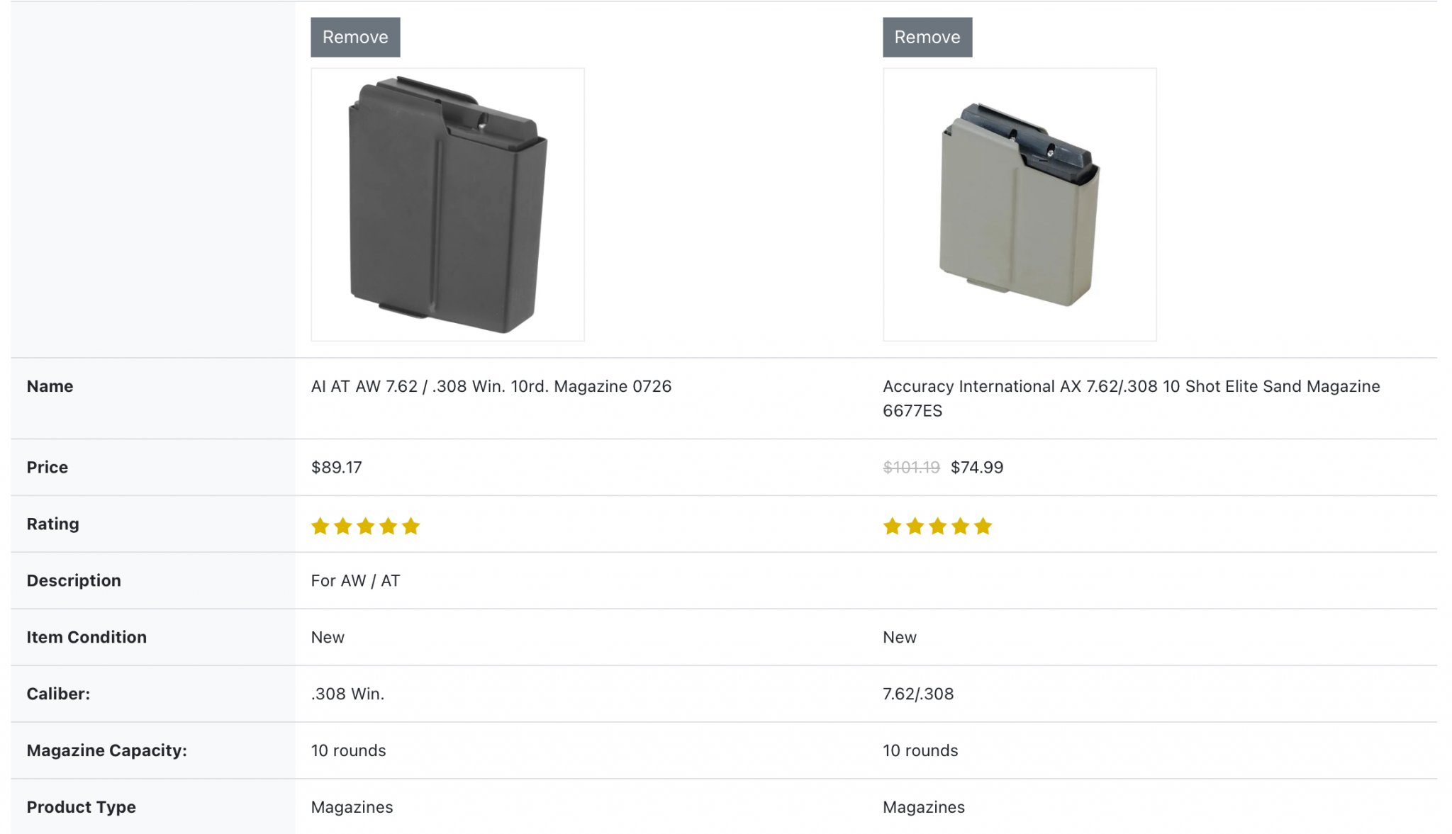

What’s the difference. I must have missed it.

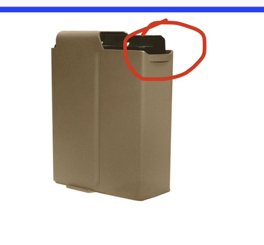

The AX mags have a little lip on the front that needs to be tapped flat. I used them for years with my AIAT.

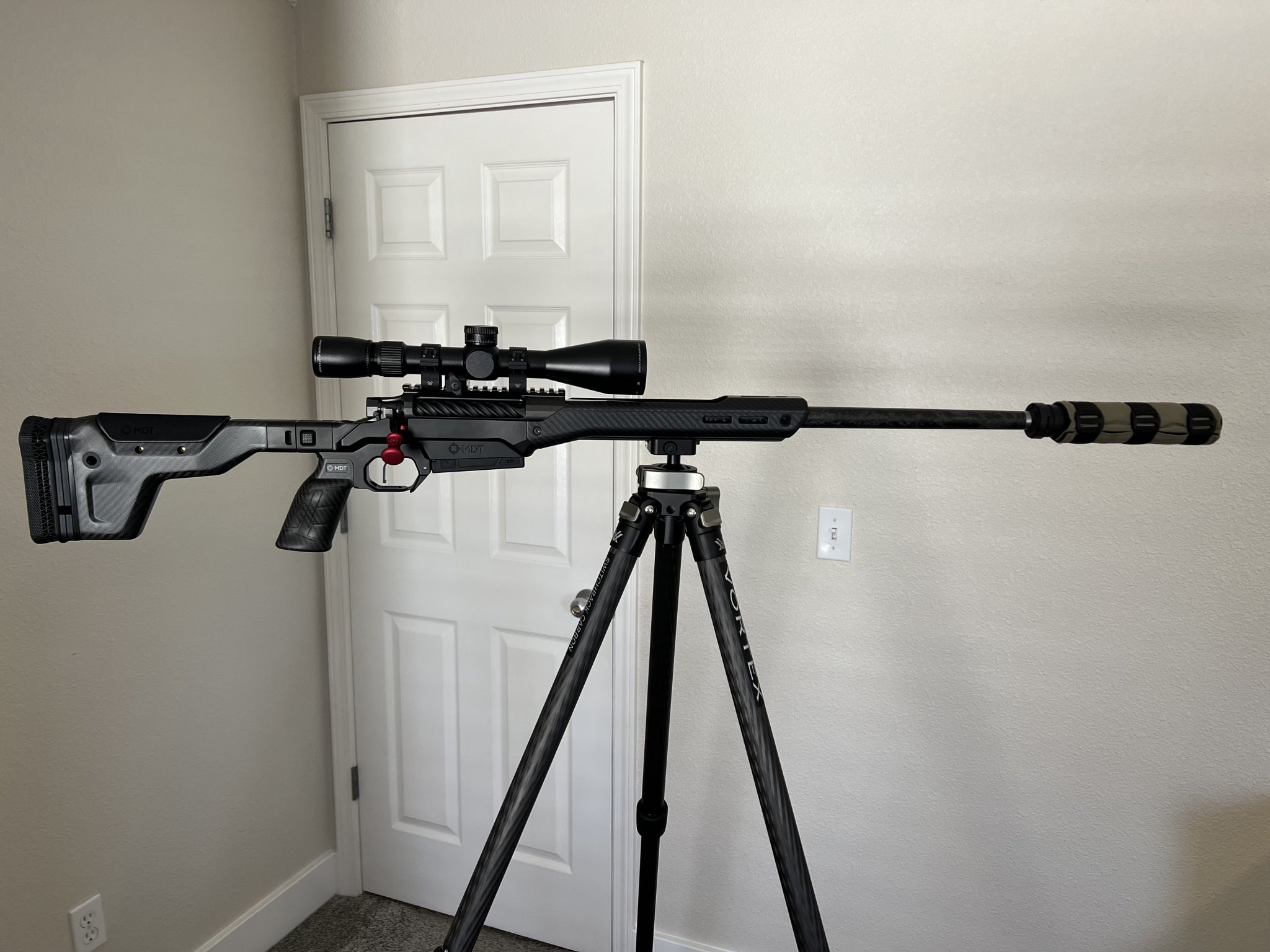

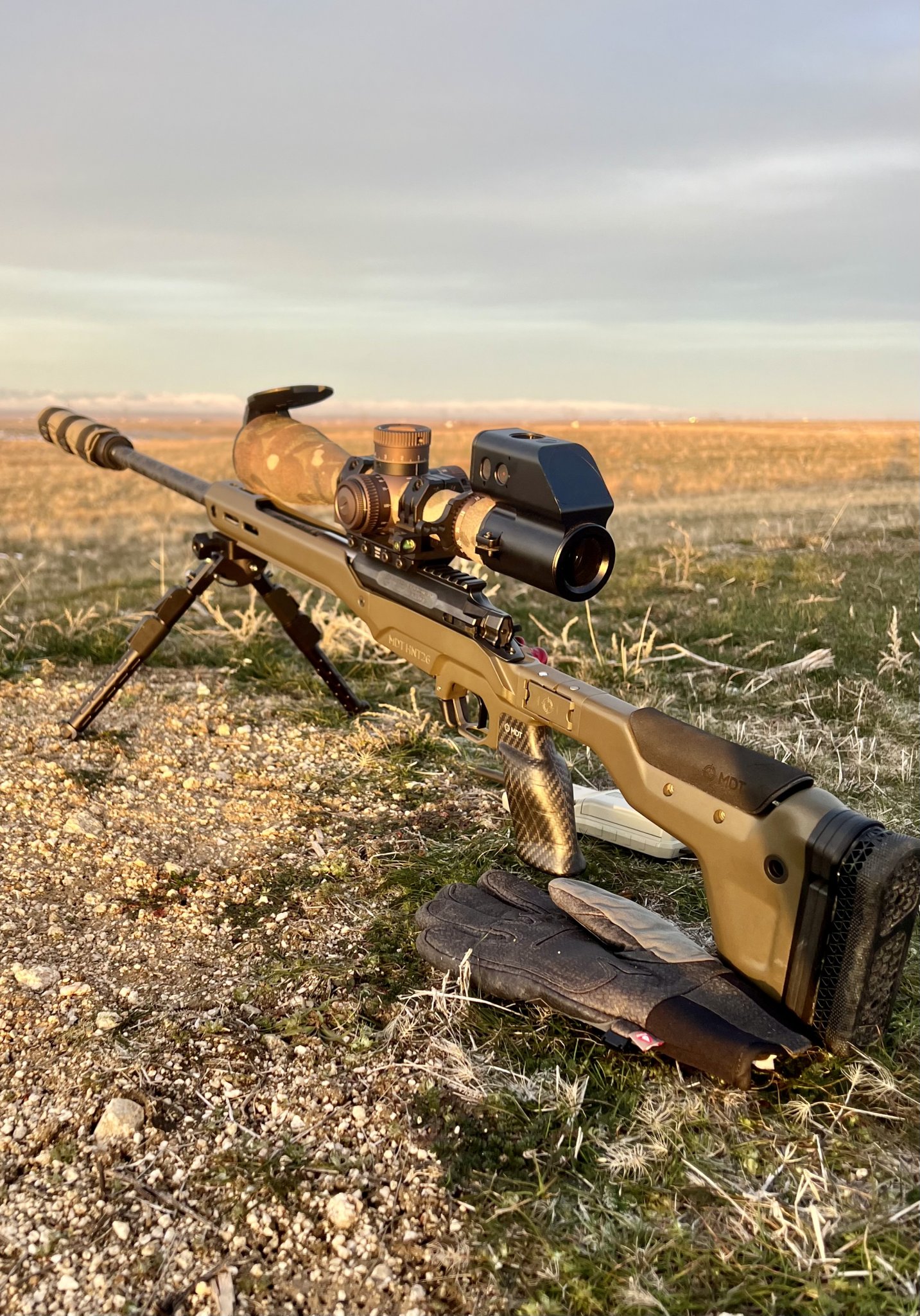

I got my 7prc coup de grace put together. My 22 creed build is giving me fits with the magazine though! AW mags are nowhere to be found. I am fine hacking on a mag if anyone has any suggestions of where material should be removed.
Flatten the lip at the top front of the AX magazine et voila you have an AW mag!
AIAX magazines with the lip tapped back in.
Got an AW mag and now the 22 creed feeds like a dream!

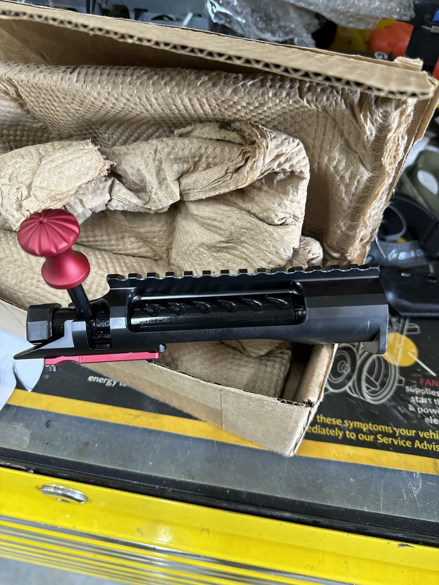

Came in today !!!!!!
Sooner than I anticipated. (y)(y)
Only 2.5 months.
Barrel expected in the next week or two.
Forgive my goofball post.
This is the first non-barreled action I've ever worked with....and I'm mighty enthused.
Fingers crossed that the prefit stuff allows precision & self-sufficiency. It sure as hell offers a wide range of versatility.

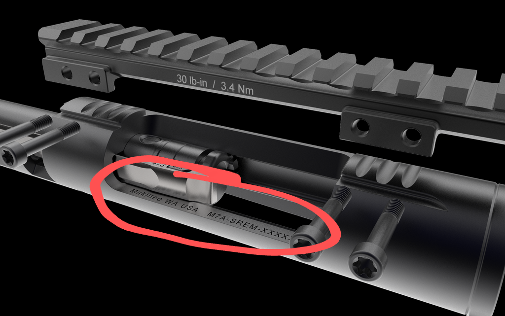

If it's like my Mausingfield, it will be along the top edge of the action port.
Nice & clean serial characters, too.
I wish my 1911's each had such cleanly executed lettering....except for my Colts. I like them as they are.
Got it home.....ole man cheater specs on.....🧐.....bamsucka....same location as on your Mausingfield. (y)
