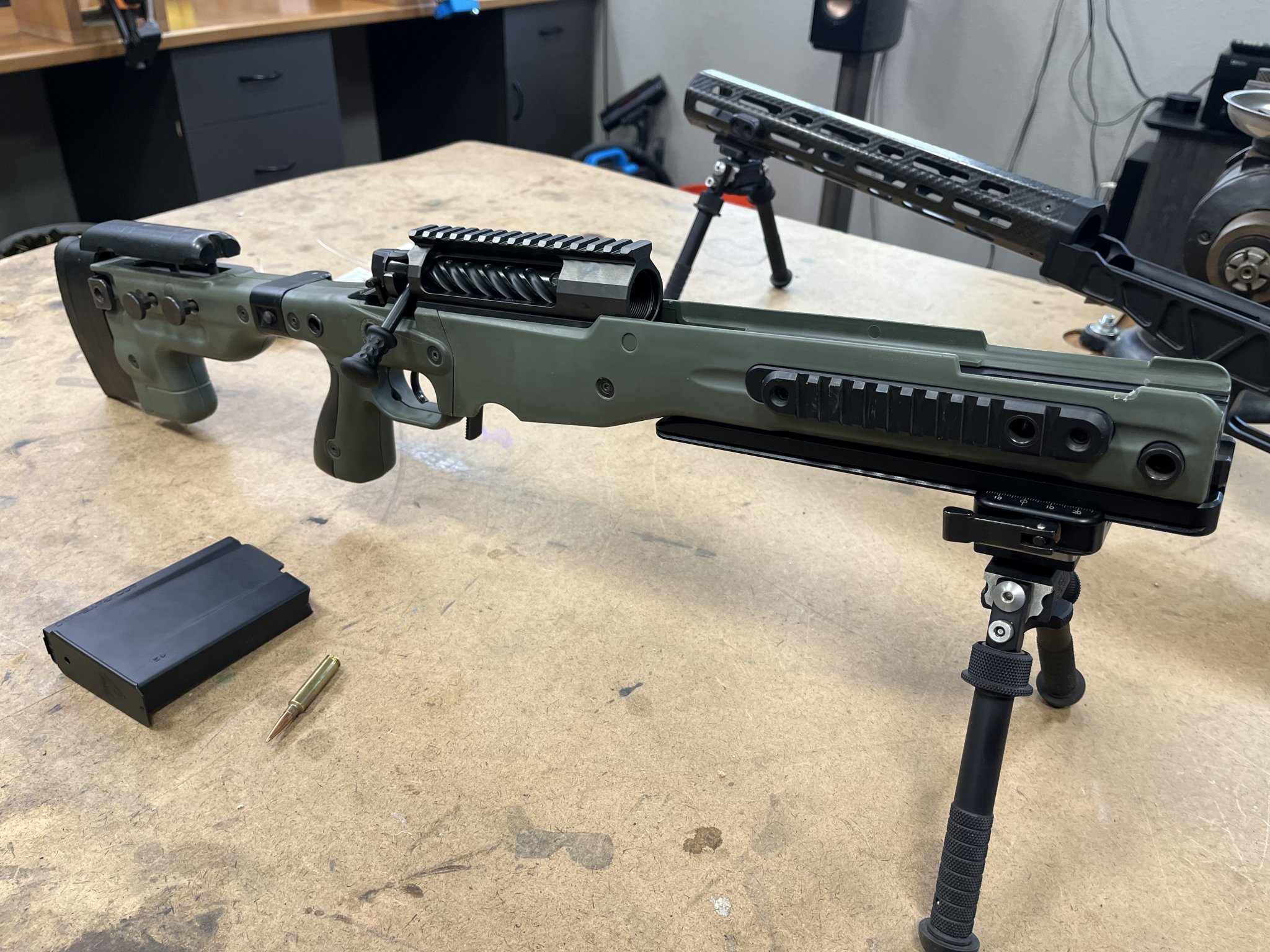

Here’s what it too to get my CDG to fit in an AICS-AT chassis.

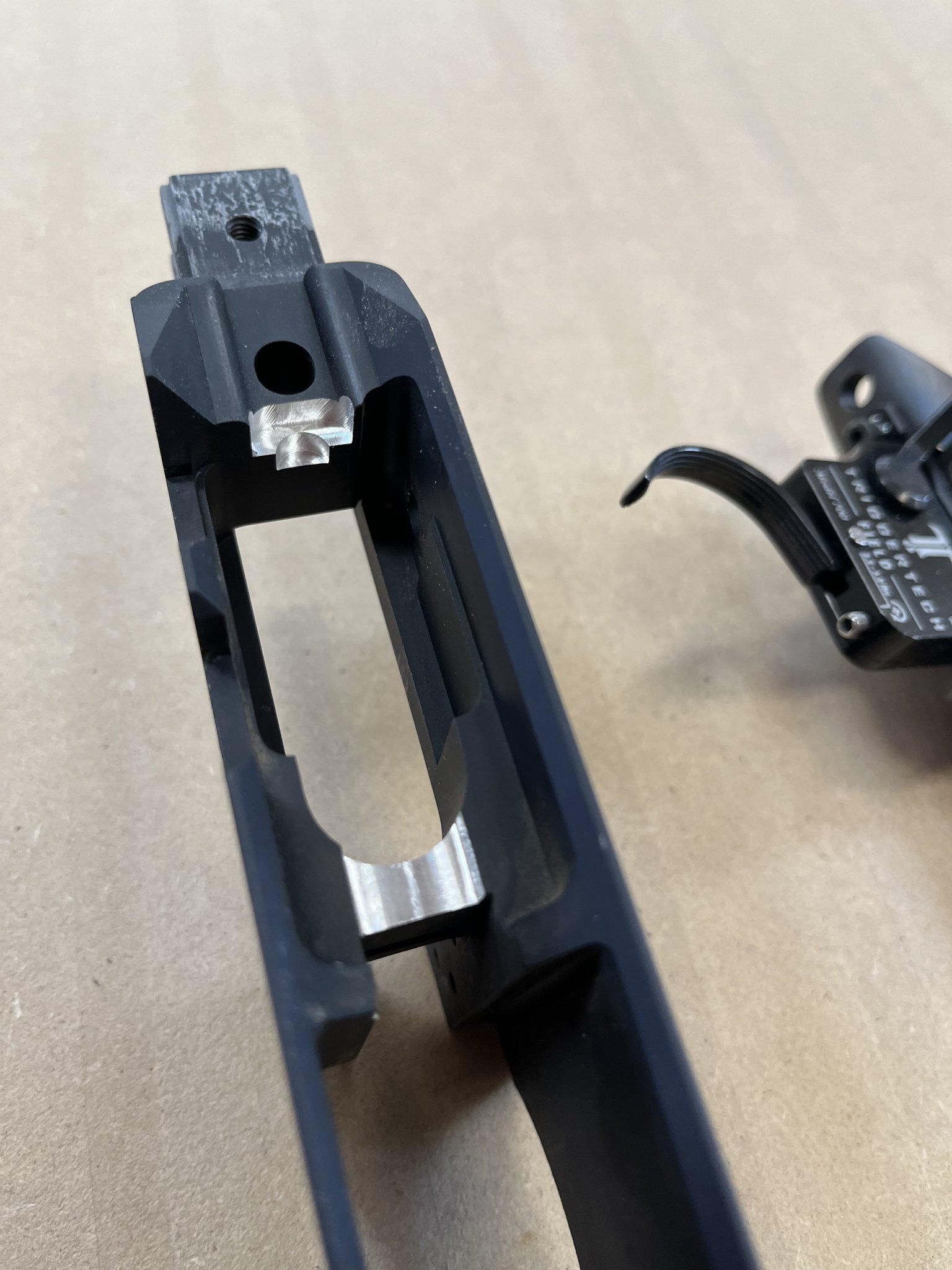

Alright I finally had a chance to really use this action. Shot the snake river 2 day match (day 2 only due to my primary gun having ammo issues) and I had some very aggravating experiences.
Wondering if anyone else has had anything similar. I am running a triggertech diamond set at over 1 lb, with he pivoting bolt handle so I’m sure that’s the root of the problem, but 3 sperate times I had the firing pin fail to cock. It would chamber but when I pulled the trigger nothing would happen. Open and close the bolt (not moving it rearward) still nothing. Run the bolt and on one occasion, gun went click on a new round but did not hit the primer, no marks at all on it.
I had about 300 rds on the rifle before the match with zero issues. Anyone else run into anything remotely similar? I’ll put the fixed bolt handle in and see f I can get it to replicate the issue but I really like the feel of the pivoting bolt handle a lot more.

Switch triggers not bolt handles. The problem is in the sear ht & bolt handle wont change that.
Sounds like something is wrong with the trigger sear engagement ht. IIRC the hanger only shifts for/aft to tune out cock on close. There are definitely differences between triggers. I'm running a Huber in mine, never an issue in 700 rounds.
For example I just put together a NRL light hunter built on a Mausingfield M7. The Huber sear height was to high causing a bit of drag and cock on close. Switched to a TT Special & all is well. TT sear ht is lower than Huber in my particular instance.

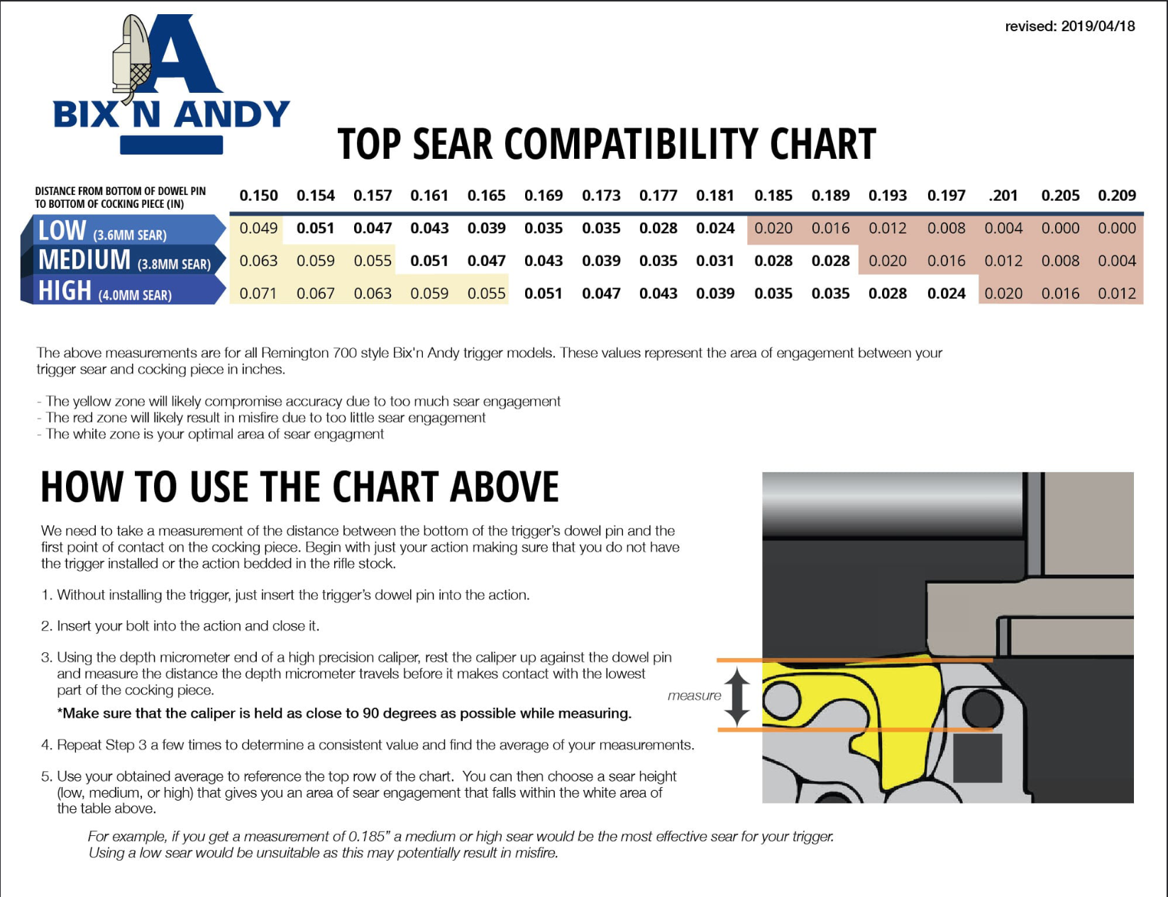

Any experience with bix n Andy?
Reactions: pingunit
I do not.
They have 3 optional sear heights. I wouldn't hesitate to use them if I ran into the issue & couldn't resolve it with a trigger swap.
I've use the bix reference chart when setting up or trouble shooting a trigger.
Anyone having troubles in their CDG should start here and measure actual sear engagement.
I run a 2 stage TT in my CDG at a healthy 1.5 lbs pull weight and never had an issue. I do have a 4oz TT Diamond that I have used for thousands on rounds in my Nuke 2.0 with the 19lbs striker spring and all CCI 450s.
I did have problems with sear height with my RimX and the TT Diamond and rather than mess with the cocking piece I got a BnA with a low sear which I think solved the issue (so far).

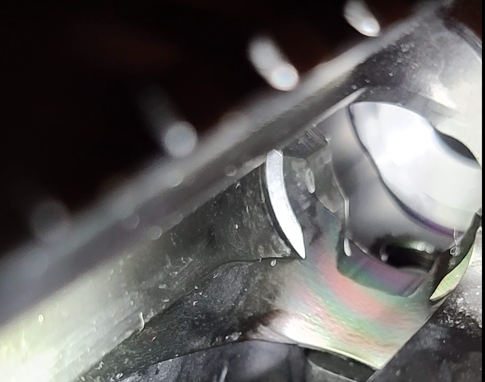

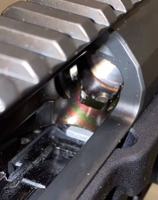

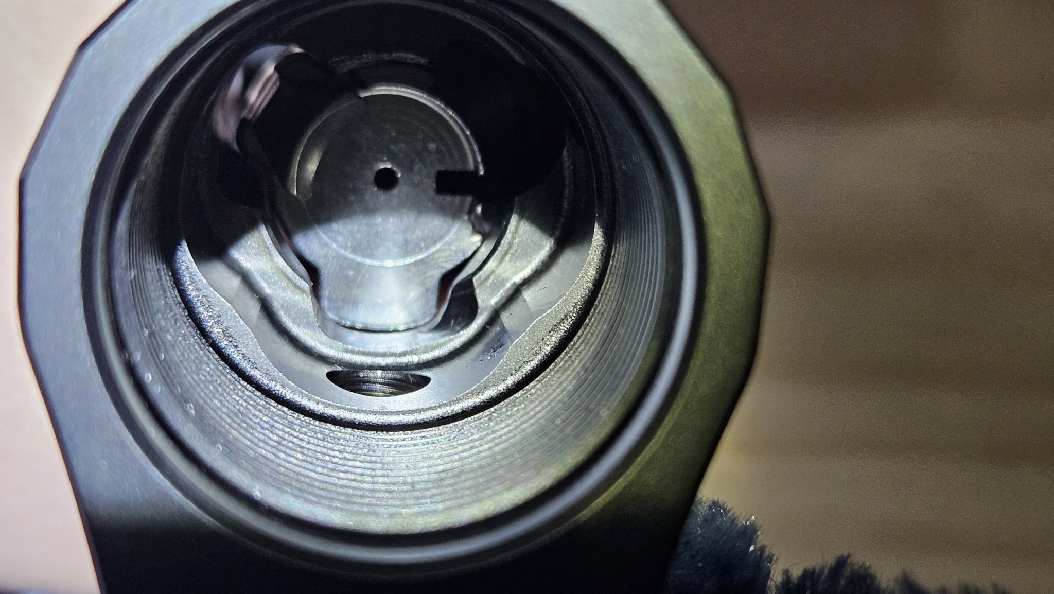

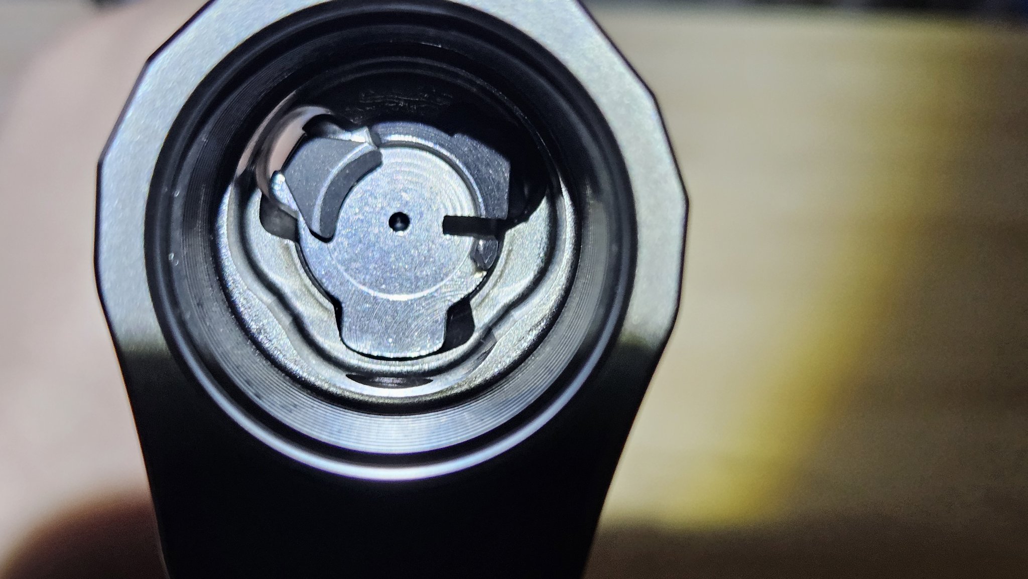

Alright I am ready to get my hand slapped in the cookie jar... Has anyone elses feed ramp and the part of the action between the lugs and threads turned rainbow kind of like an oil slick? I noticed it after cleaning the barrel. My initial thought was CLR discoloration since I used 4 patches during the cleaning process, but I don't know how it would leak that much with how conservativeI am in how much I apply to patches and the angle I had the rifle tilted at to force it to run forward. I also applied some CLR to another surface on the action and let it sit for a similar period of time and it did not react this way which has me absolutely puzzled as to what might have caused this. Would appreciate in knowing if anyone else has seen this before. I haven't gotten to cleaning the actual action yet so apologies for the dust and crud in it, but I did get a shitty picture of it. Thanks in advance
I want to preface this by stating that I did contact ARC and they did explain to me that this is normal on some CDG actions. I received my action this week and have slight interference at the 6 o’clock lug when cycling the bolt. While it’s barely noticeableI it occurs in areas I see wear marks 1) on the receiver just behind the mag cut out 2) on the ramp pics provided. I didn’t go crazy cycling it 100 times when I got it just a few and stopped when I noticed the issue. They explained to me over the phone the spring tension from the striker spring can cause the bolt head to bias downward causing this contact. I am curious as to if anyone else experiencing this may have buffed these areas to smooth them out, or should I just let it be. Again ARC has great customer service and backs their product 100% If there is ever a warranty issue. This is more for my peace of mind as I continue on with my build.

I don’t have one myself but I would test what they say and take the firing pin out and then run the bolt, still tilting down dragging?
Great idea! After removing the firing pin and striker spring the contact to the rear of the mag cut section was nearly non existent. The contact at the ramp was significantly reduced by about half.
Reactions: pingunit
Rounds in a mag or even the mag follower also push the bolt up a little. The way the control round feed works, the case is pushing the bolt up as it gains control of the round.
I've got about 700 on mine with no wear showing at that bottom lug entrance location. If mine were I'd do a little blend/polish as needed.
Reactions: pingunit and lash
Thanks 357Max that’s reassuring. I had this in the back of my mind as well. I become a little OCD about things sometimes. I will touch it up with a blend and polish as you suggested. I’m still amazed at what the customer gets for the price point here.
Anyone tried a GrayOps mag?
Are you talking about the area between the trigger and mag well opening? If so I called ARC and they said that the DLC coating has worn and not to worry about it. If that’s not what you are talking about forget everything I said. 😎
Yes that Is one area I mentioned and I received the same answer from ARC as you did It’s normal. After torqued to spec in my Foundation stock and with a magazine inserted, no barrel, the action seems to run fine.
