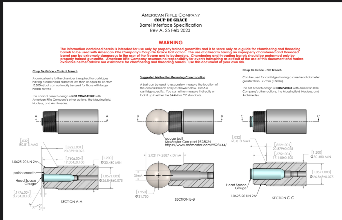

I have but one reservation about this action -the conical barrel.
The reason = 6mm arc in ar15 barrels have expansion at the base of the case. They have an unsupported rear portion of the case.
This is seen when resizing and you end up with either shaving end of case or bulging similar
bulging to the 45acp or other magnum straight wall cases like the 460 Smith & Wesson when they get over pressurized.
If this expansion is happening in a AR 15 style barrel, even though it is not over pressurized.
I realize this was talked about at the beginning, but wondering if other people have thought about this or ran the six arc or something similar and did you have expansion issues at the base of the case?
now the action has been out for a little while I’m wondering what thoughts people have on this?

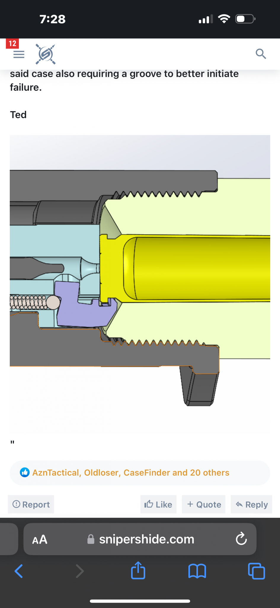

There is no unsupported section of brass in an in spec CDG chamber. Only the extractor groove is exposed.

Perhaps you missed the three or five times that this has been discussed and put to bed already. The conical breach actually supports the base of the case the same as a flat breach.
Yes, I’m sure it has 140+ pages with 3 to 5 post and each page. Sorry I missed it. I just looked through some drawings and I thought it showed more unsupported area but yet I found one at the beginning that actually shows that it doesn’t have any unsupported area anymore than any other barrel, so I guess I answered my question but thanks guys
Appreciate the response either way

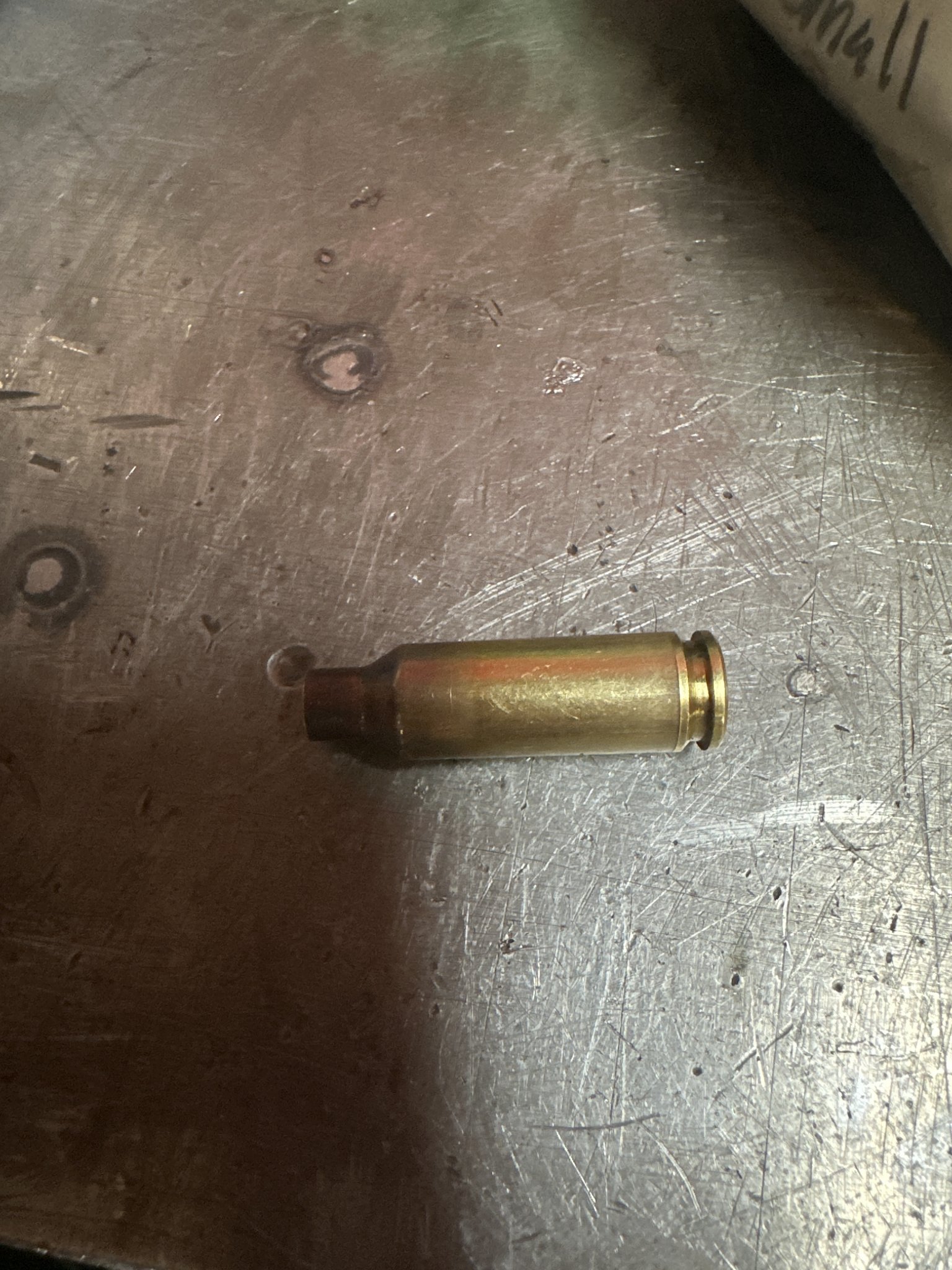

I have 45acp,44mag,357mag and have never seen a case like that.
Well, now you have 44 Mag

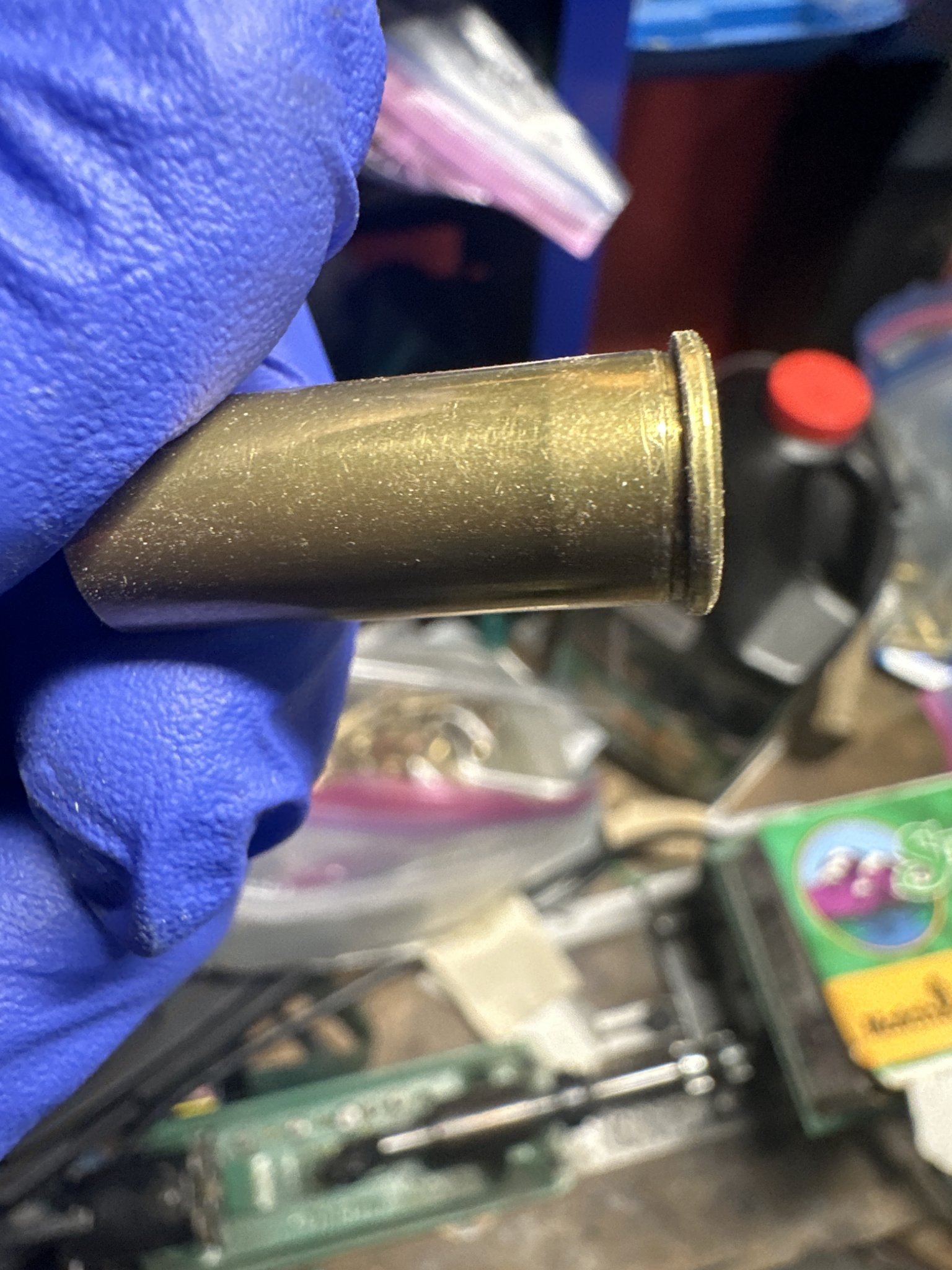

I’ve had 45 ACP range brass that I picked up and some older cases that when I’ve tried to reload … they had some definite bulging in the
last 1/4 of the case.
I know I gave an abrupt reply. Nothing personal. I was looking for that picture, but missed it somehow.
I did find this one though:
Notice that, if you do the math, the exposed case head to chamber distance is the same in both the bottom left and bottom right illustrations.

Yes, that is the diagram. I originally looked at and was basing my question on (far left diagram/photo ) I am shit for math lately must come with age or just facing stupidity?

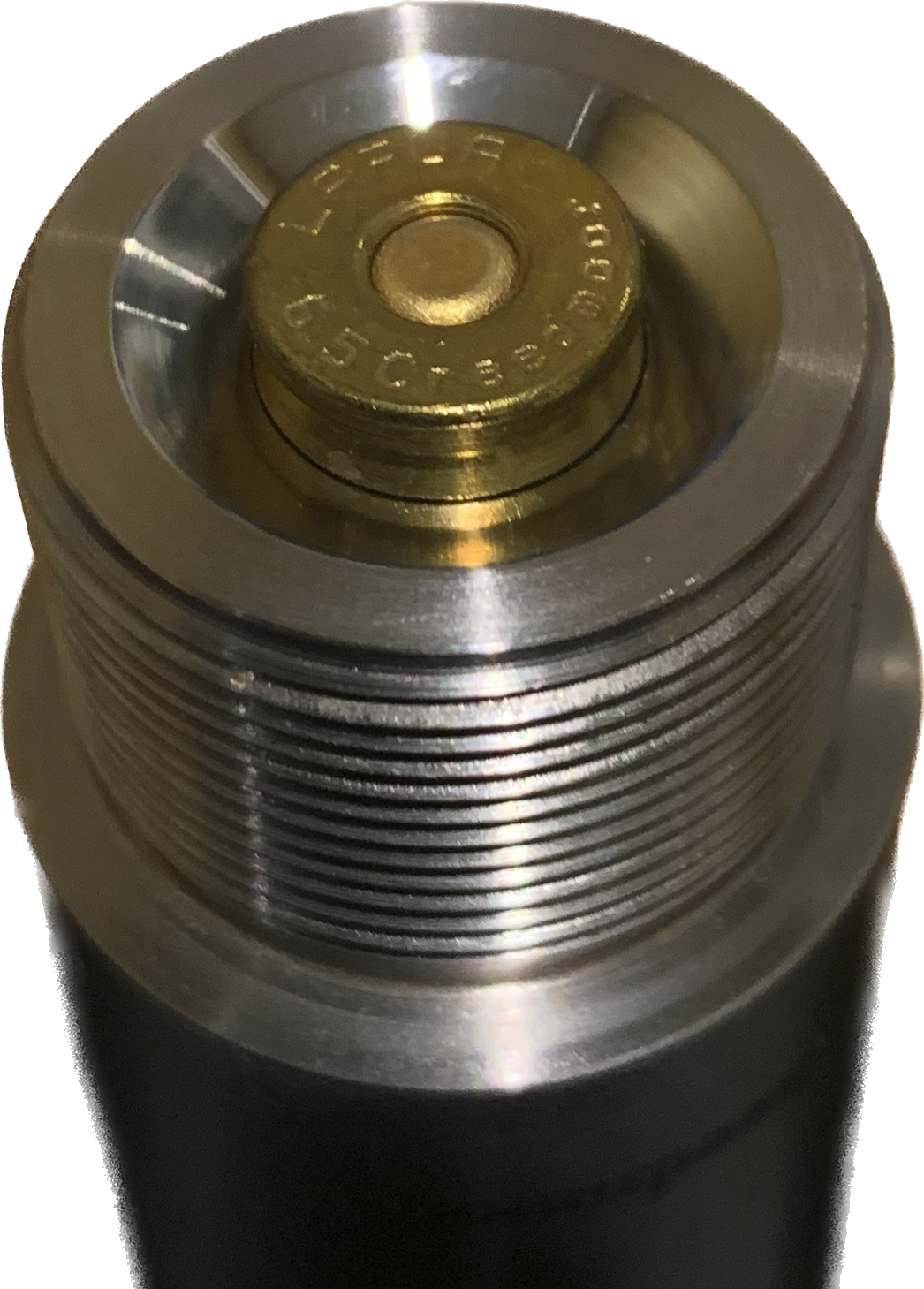

The problem your having with 6 ARC is a die problem.
Use a Wilson die & you won’t have that problem. The picture you posted of the 6 arc case is sized with a small base sizer or a Hornady which is a small base sizer (un-advertized). I’ve loaded the 6arc hot in a gas gun and never had a bulged case across 3 barrels.
Pic below is CDG barrel.

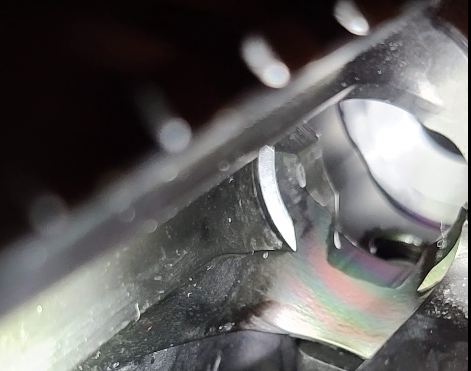

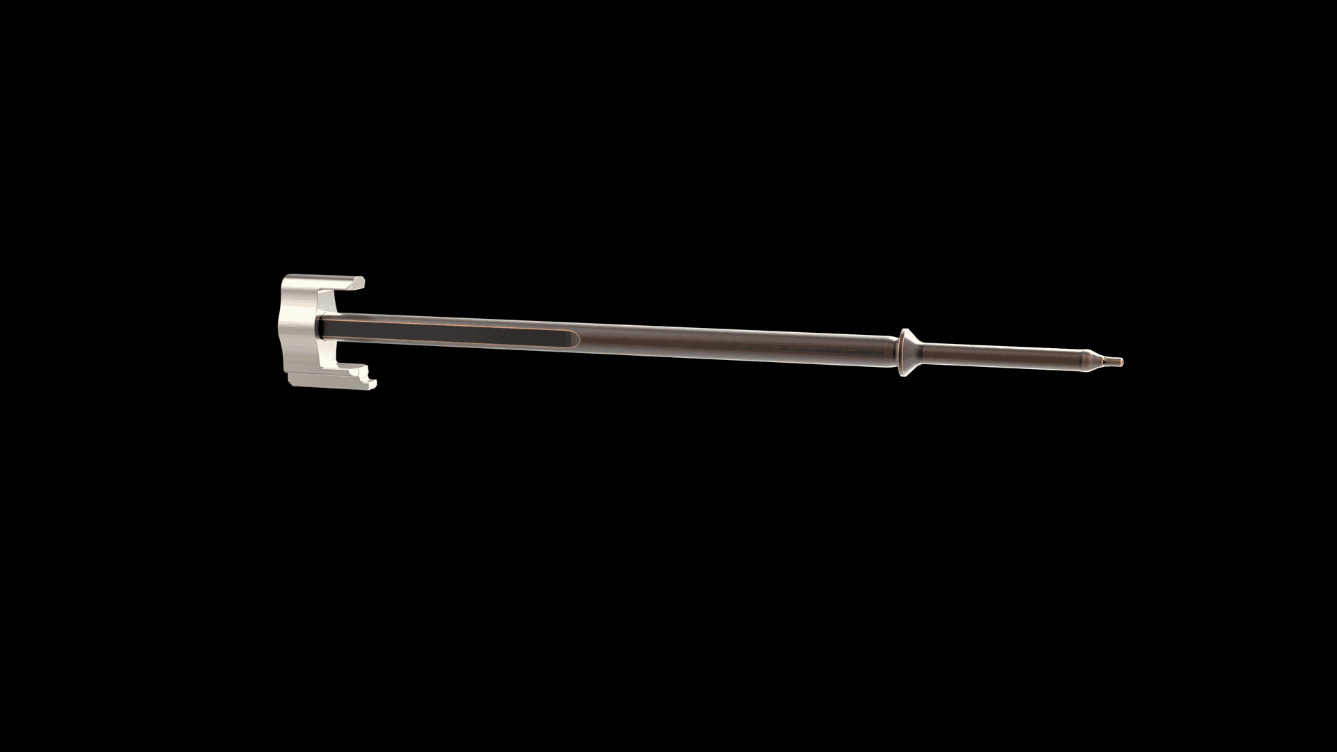

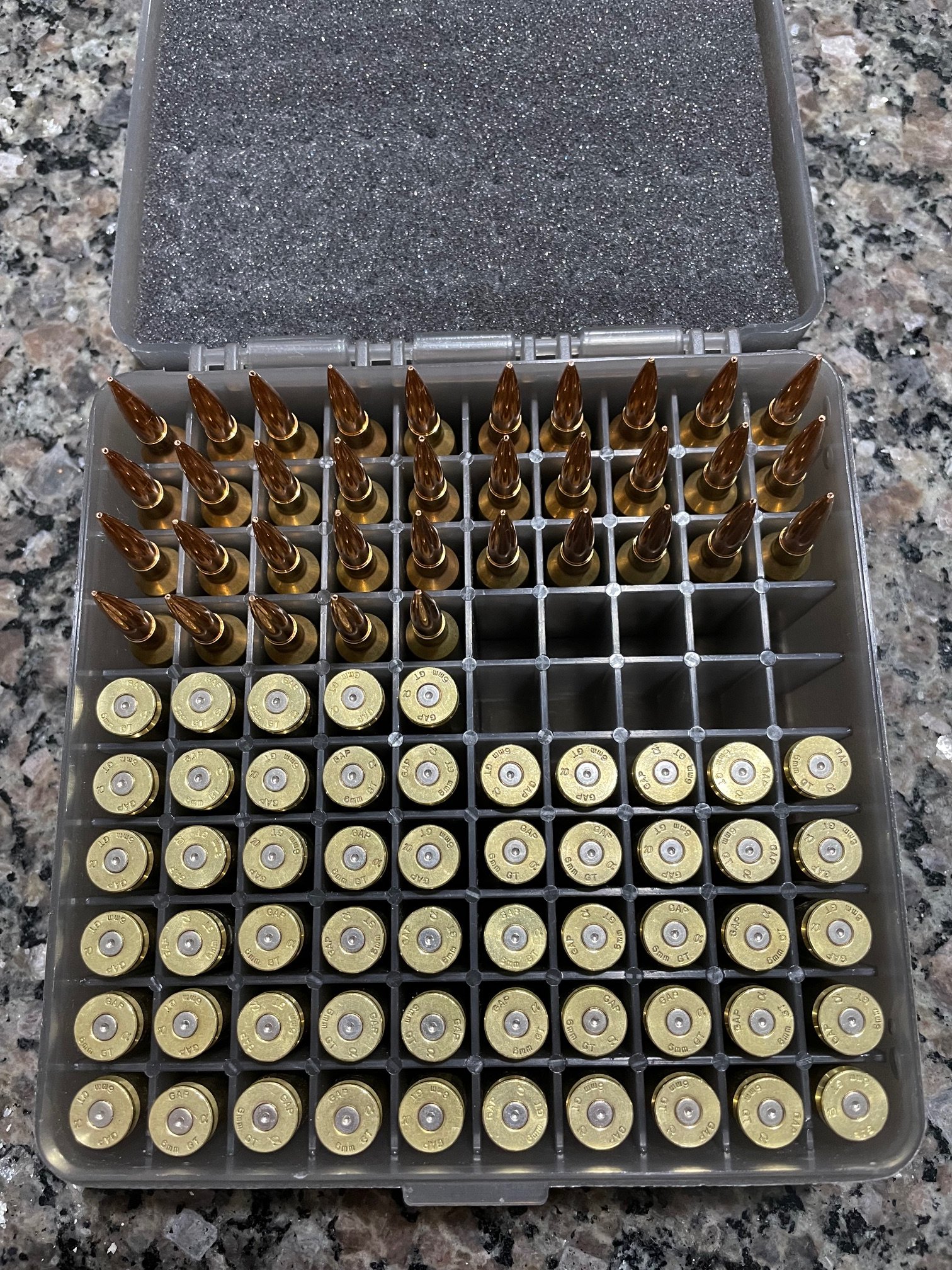

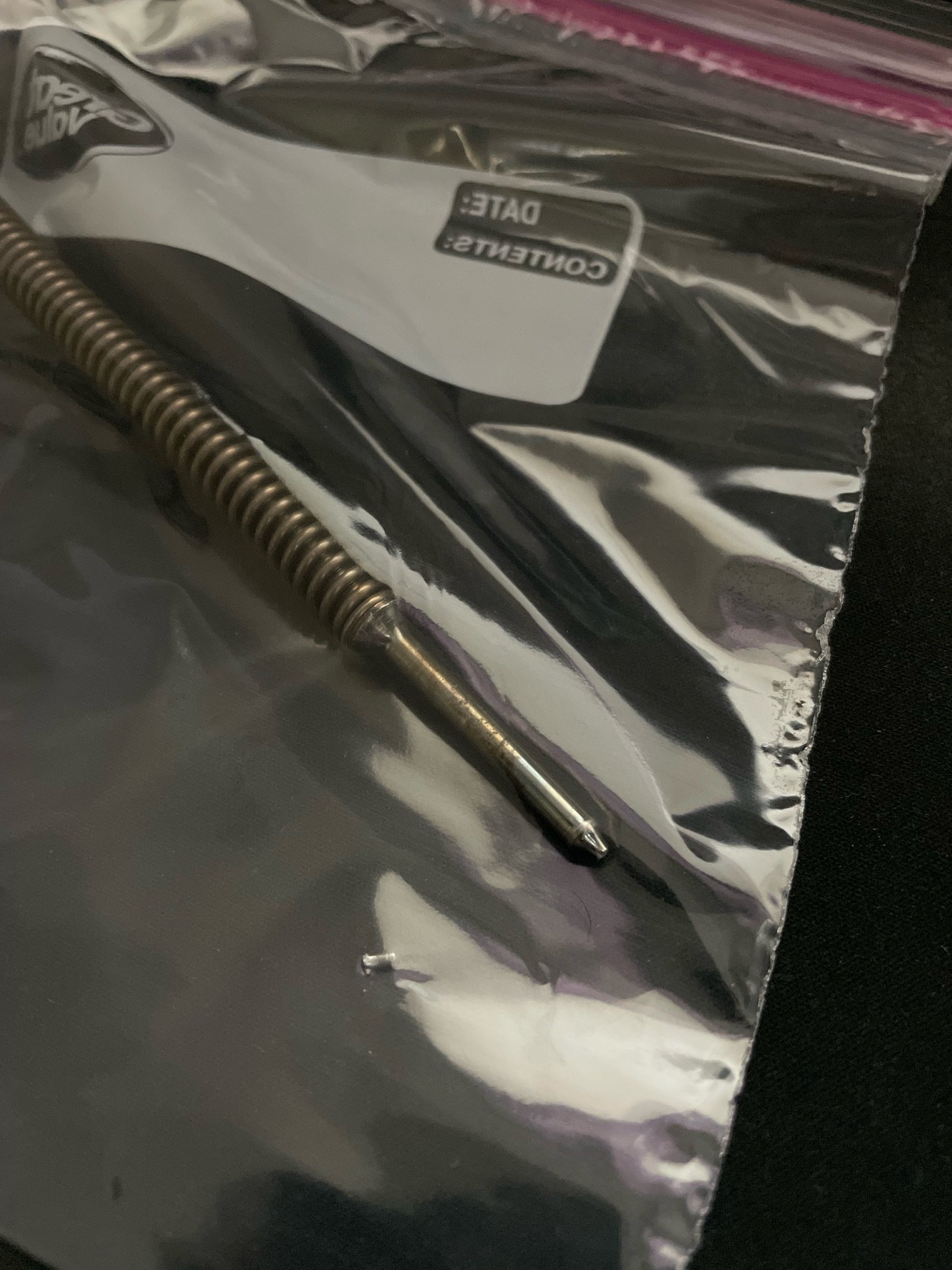

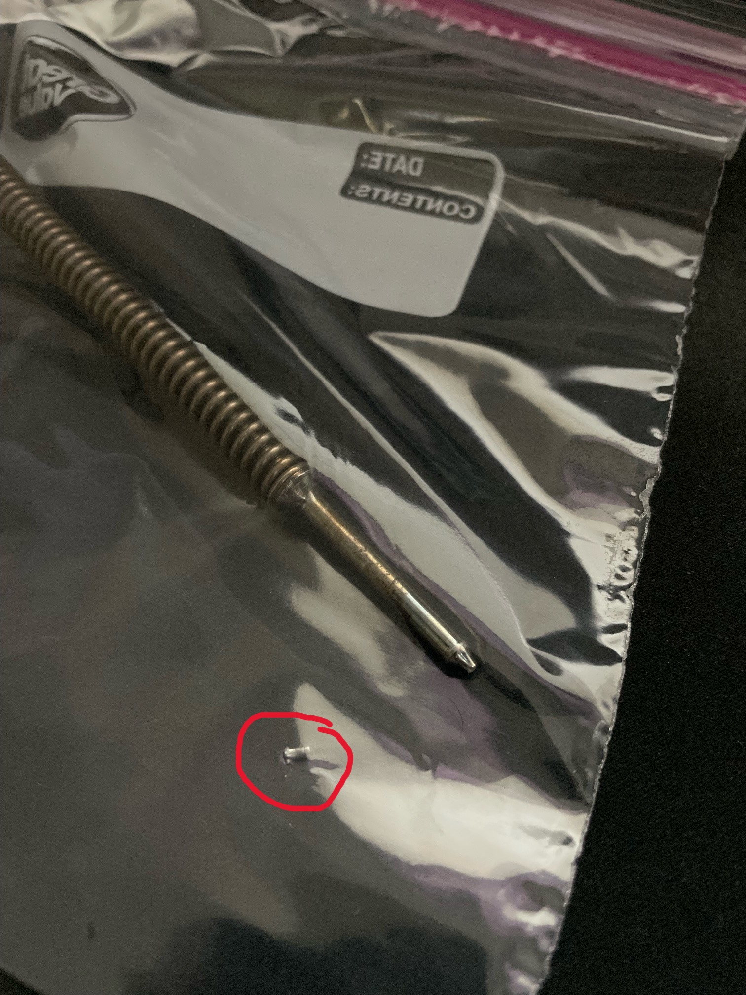

Hi I was wondering if anyone with a CDG action experience a firing pin being sheared?
Some back story, I had a local club match yesterday 5/5 and rifle ran fine without any issues what so ever (picture of brass after match). In preparation for a regional match I was going to clean the rifle as I always do before a match, and when I disassembled the bolt I had noticed that my firing pin tip was sheared off. Once I noticed that I went in to panic mode and immediately called American Rifle Company!
I highly praise the team at American Rifle Company as their customer service representatives helped me right away and understood that I NEEDED a replacement ASAP.
Reactions: Boatninja
Sheared....like broken in the middle and you had both pieces when disassembled sort of thing? And in your view the action continued to fire the ammo with the broken pin?
No just the tip. I honestly couldn't tell you, all my trigger presses felt consistent throughout the whole day. I did clean the bolt the day before the match and didn't notice cracks or nothing. If it did break during the match I didn't notice any weird flyers at all.
I have 962 live fire and ball park 1-2000 dry fires on the action.

Do you have a barrel vise and action wrench? If so you should take your barrel off and put a sized case in the chamber to double check that you don't have any of the case body that's unsupported(like in post picture #6964). I agree with most here saying that there shouldn't be any unsupported case body if everything was done properly but the picture you shared screams unsupported case.
I don't see any unsupported case in post 6964. I can see the extraction groove cut as well a a reflection of the case.
